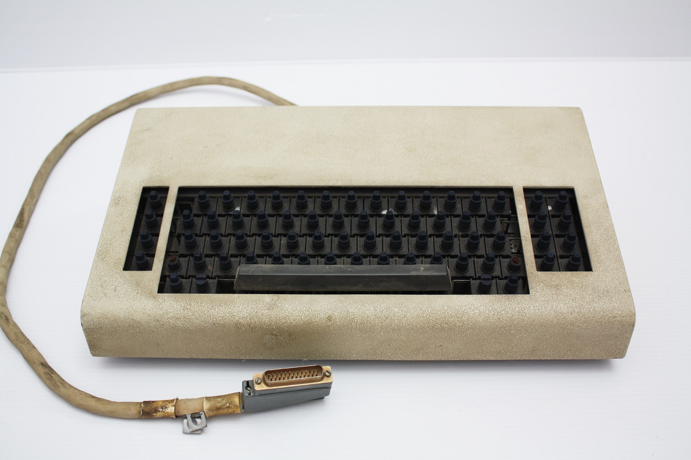

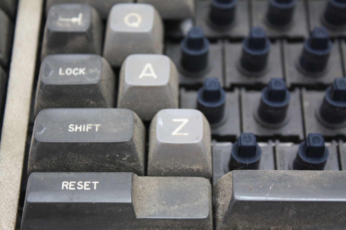

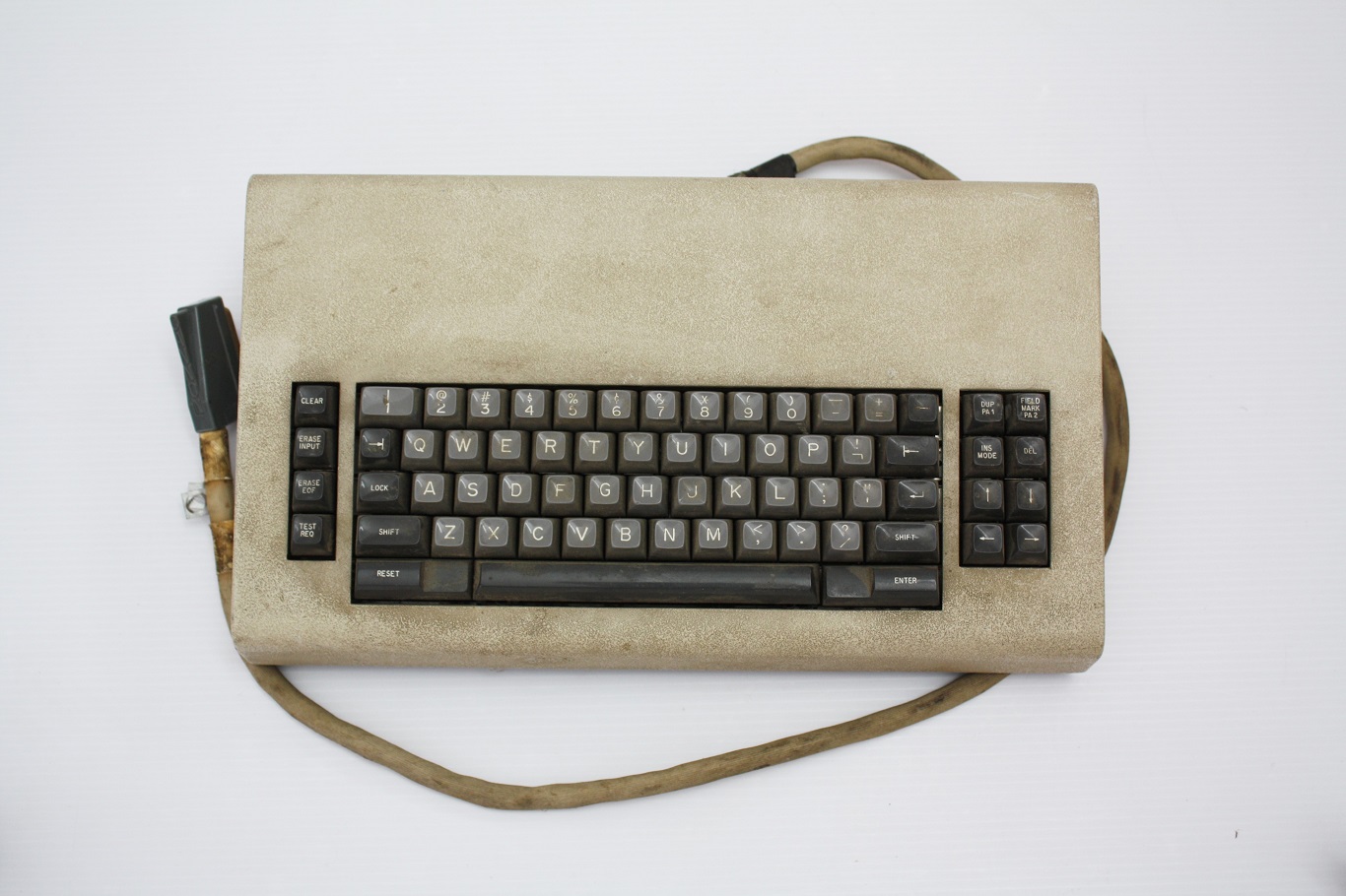

I recently acquired an IBM keyboard that was pretty dirty but I felt I could clean it up and refurbish it quite nicely. I knew this to be an old IBM keyboard but there are two variations of this keyboard including Webwit's 5251 keyboard with IBM beam spring key switches and Seebart's 3277 keyboard with Micro Switch key switches.

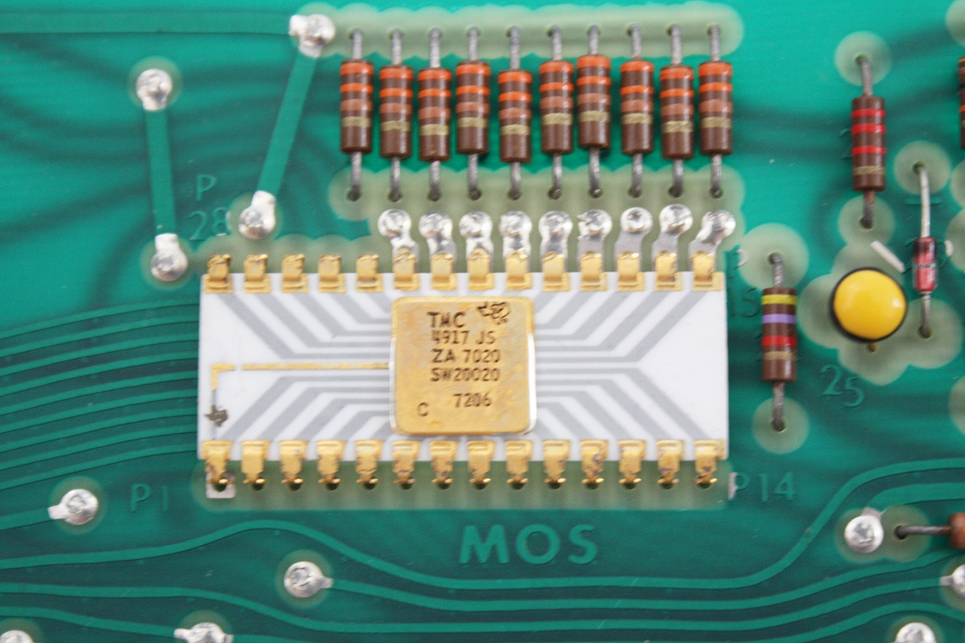

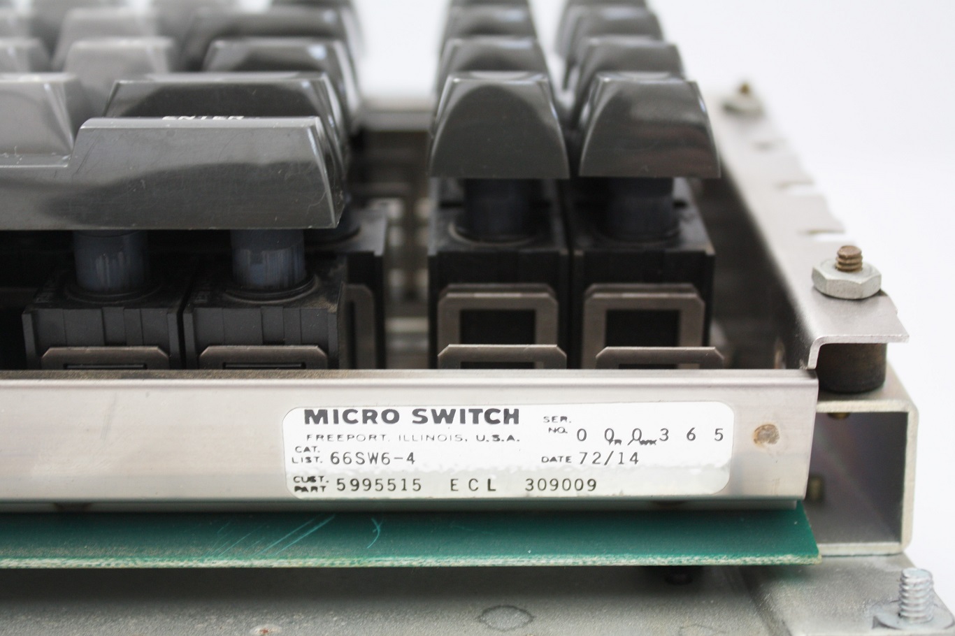

This keyboard is from the 14th week of 1972 according to the Micro Switch keyboard assembly identification and this is further confirmed through the date codes on various integrated circuit components. The Texas Instruments keyboard controller from the sixth week of 1972 and the IBM “key clicker” circuit board is dated August 18, 1972. Since it has a part number stamped on the bottom plate of this keyboard, I refer to this as the IBM 2621364 keyboard.
In researching information, this keyboard was found in the IBM 3277 Troubleshooting Guide found on Bitsavers here. This is known as the “typewriter keyboard” model.
Pics of the keyboard as I received it:
IBM 3277 typewriter keyboard - Dirty top view
IBM 2621364 - Dirty top view.JPG (284.85 KiB) Viewed 7180 times
IBM 2621364 - Dirty side view.JPG (217.56 KiB) Viewed 7168 times
IBM 2621364 - dirty key caps removed.JPG (280.13 KiB) Viewed 7168 times
IBM 3277 typewriter keyboard - Dirty key cap view
IBM 2621364 - Dirty key cap view.JPG (299.83 KiB) Viewed 7168 times

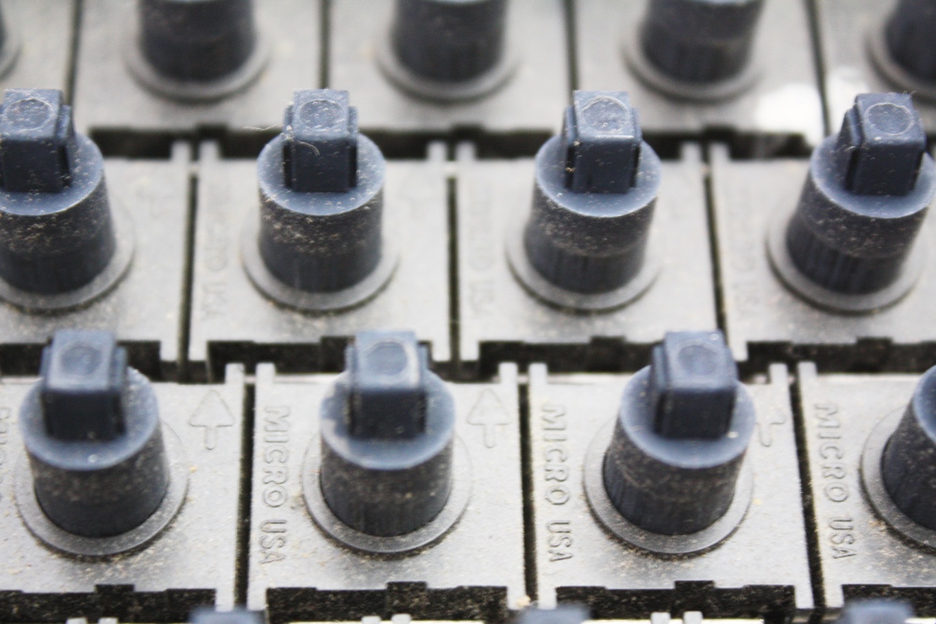

IBM 3277 typewriter keyboard - dirty dusty sliders
IBM 2621364 - dirty dusty sliders.JPG (348.04 KiB) Viewed 7168 times

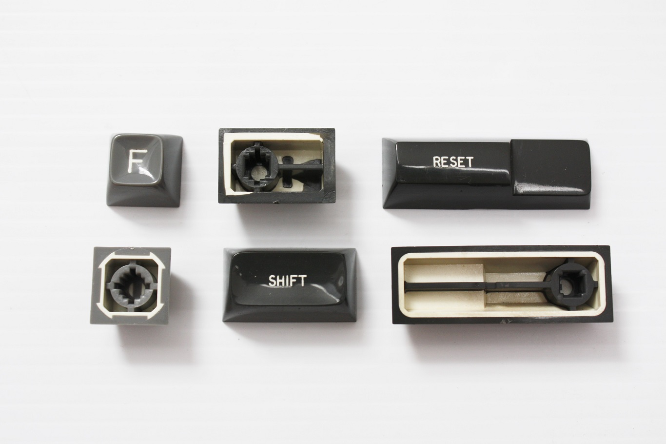

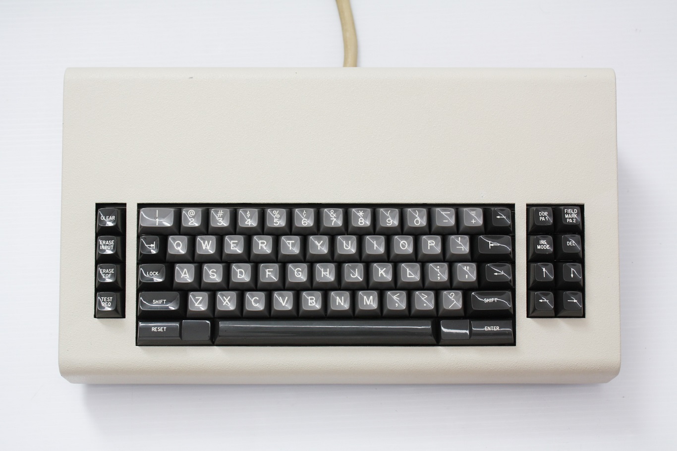

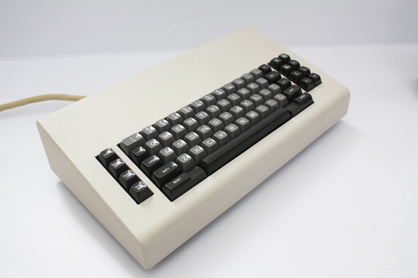

Here are some pics of it cleaned up. More pics can be found at http://vintagecomputer.ca/vintage-ibm-2 ... -assembly/
IBM 3277 typewriter keyboard - keyboard top
IBM 3277 typewriter keyboard - keyboard top.JPG (262.49 KiB) Viewed 7156 times

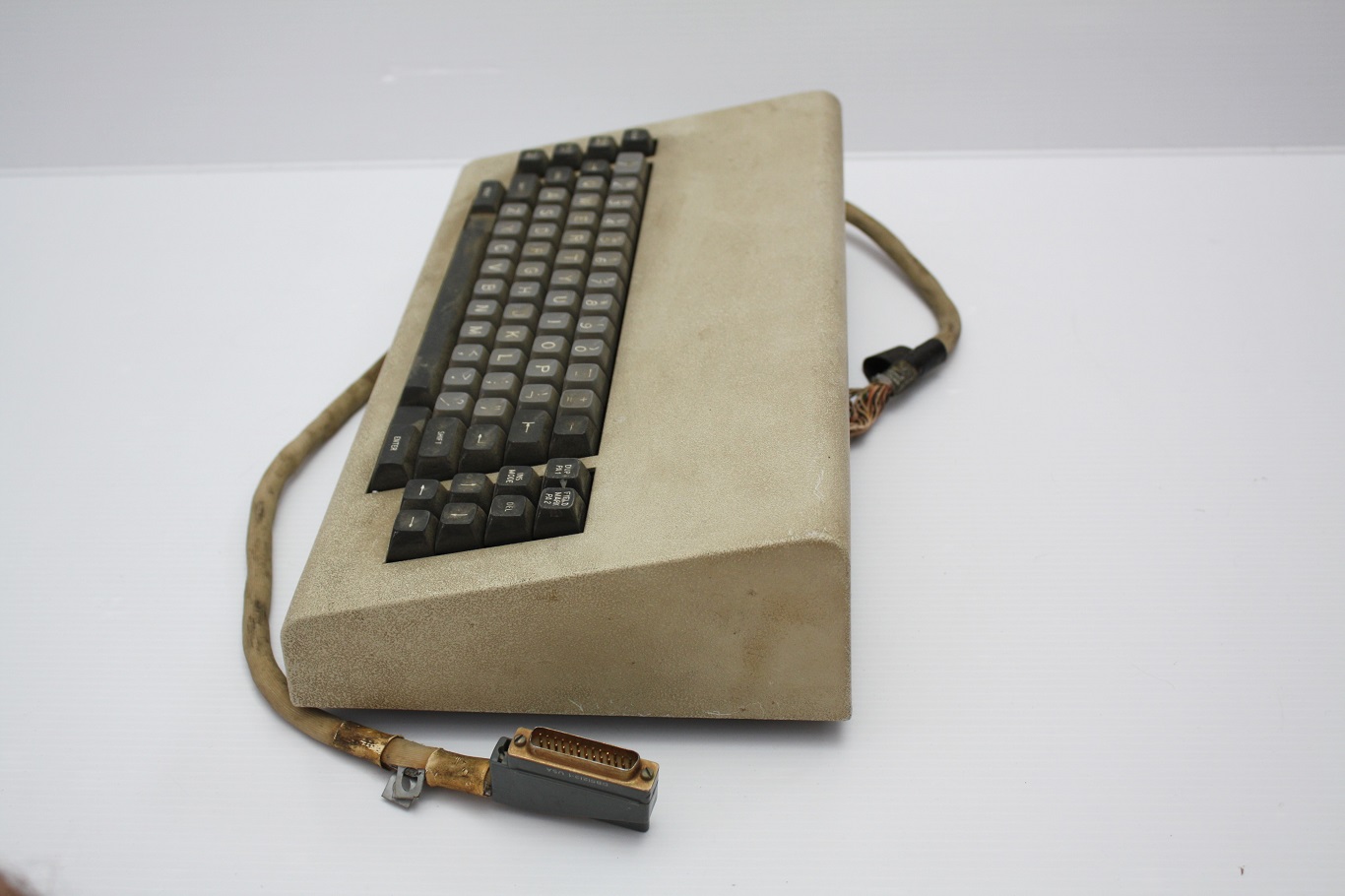

IBM 3277 typewriter keyboard - keyboard profile
IBM 3277 typewriter keyboard - keyboard profile.JPG (210.1 KiB) Viewed 7156 times

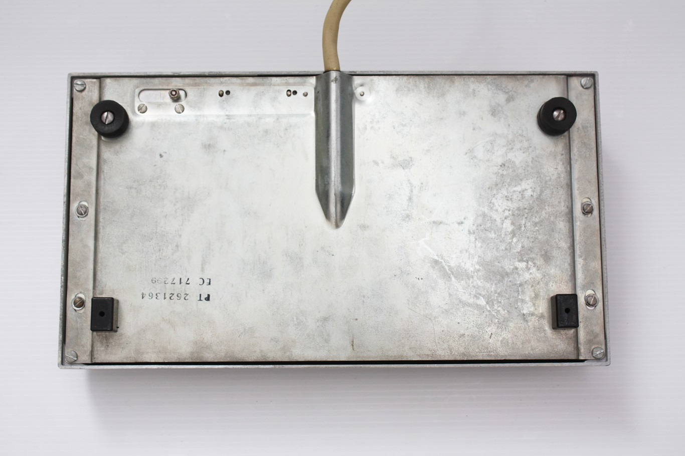

IBM 3277 typewriter keyboard - keyboard bottom
IBM 3277 typewriter keyboard - keyboard bottom.JPG (270.77 KiB) Viewed 7156 times

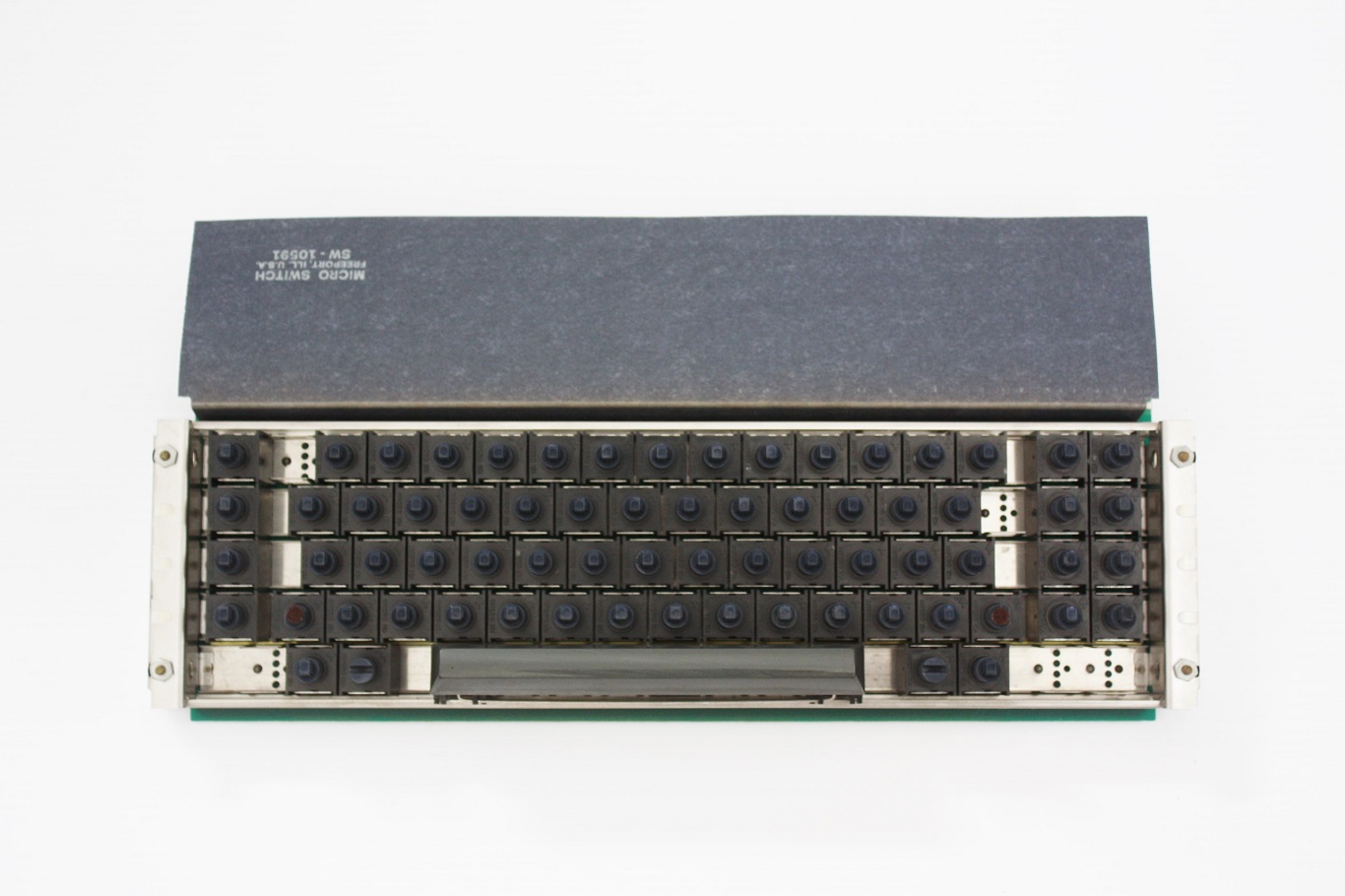

IBM 3277 typewriter keyboard - Micro Switch keyboard assembly with paper cover
IBM 3277 typewriter keyboard - Micro Switch keyboard assembly with paper cover.JPG (225.63 KiB) Viewed 7156 times

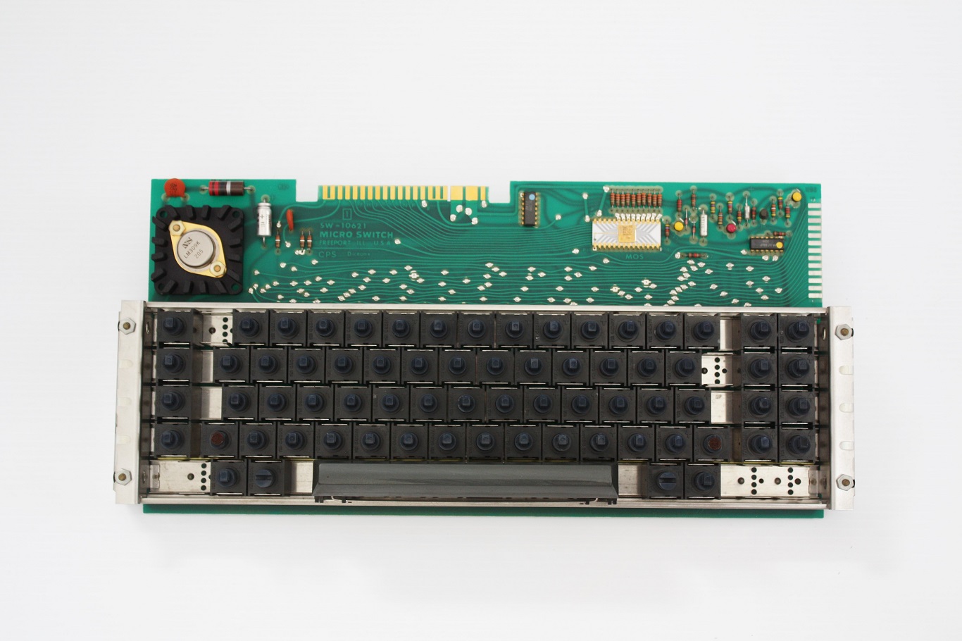

IBM 3277 typewriter keyboard - Micro Switch keyboard assembly without cover
IBM 3277 typewriter keyboard - Micro Switch keyboard assembly without cover.JPG (264.13 KiB) Viewed 7156 times

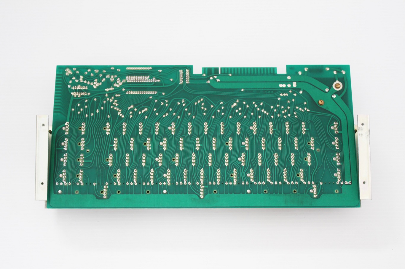

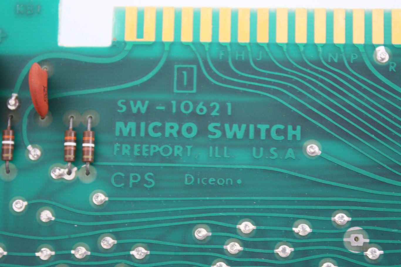

IBM 3277 typewriter keyboard - PCB back
IBM 3277 typewriter keyboard - PCB back.JPG (293.42 KiB) Viewed 7156 times
IBM 3277 typewriter keyboard - keyboard assembly markings
IBM 3277 typewriter keyboard - keyboard assembly markings.JPG (357.93 KiB) Viewed 7156 times
IBM 3277 typewriter keyboard - keyboard controller IC
IBM 3277 typewriter keyboard - keyboard controller IC.JPG (367.36 KiB) Viewed 7156 times

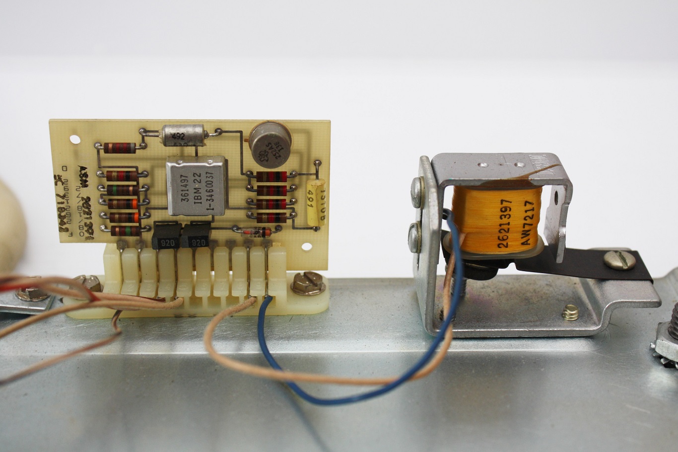

IBM 3277 typewriter keyboard - clicker circuit board
IBM 3277 typewriter keyboard - clicker circuit board.JPG (278.06 KiB) Viewed 7156 times
IBM 3277 typewriter keyboard - keyboard assembly identifier
IBM 3277 typewriter keyboard - keyboard assembly identifier.JPG (268.88 KiB) Viewed 7156 times

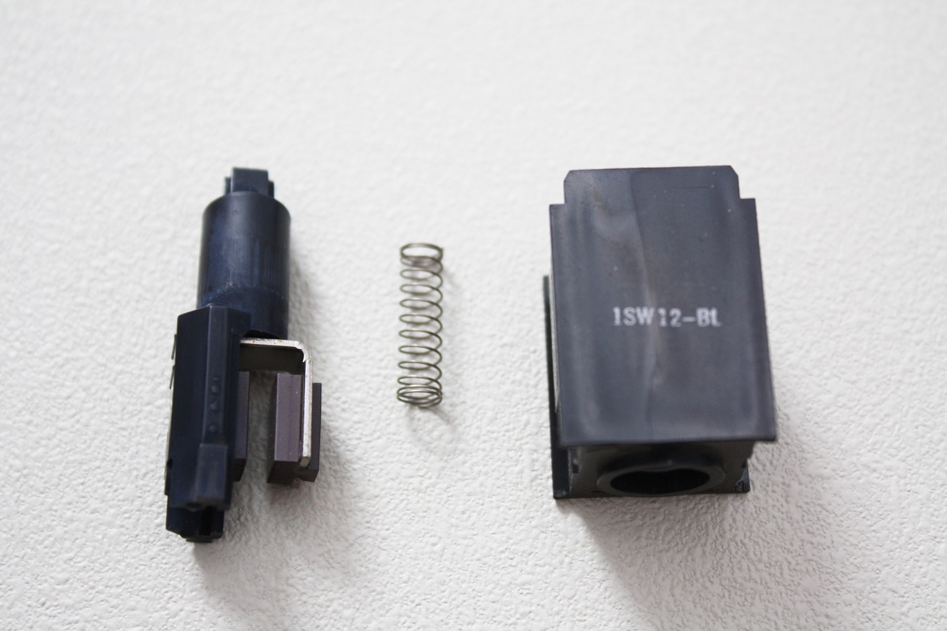

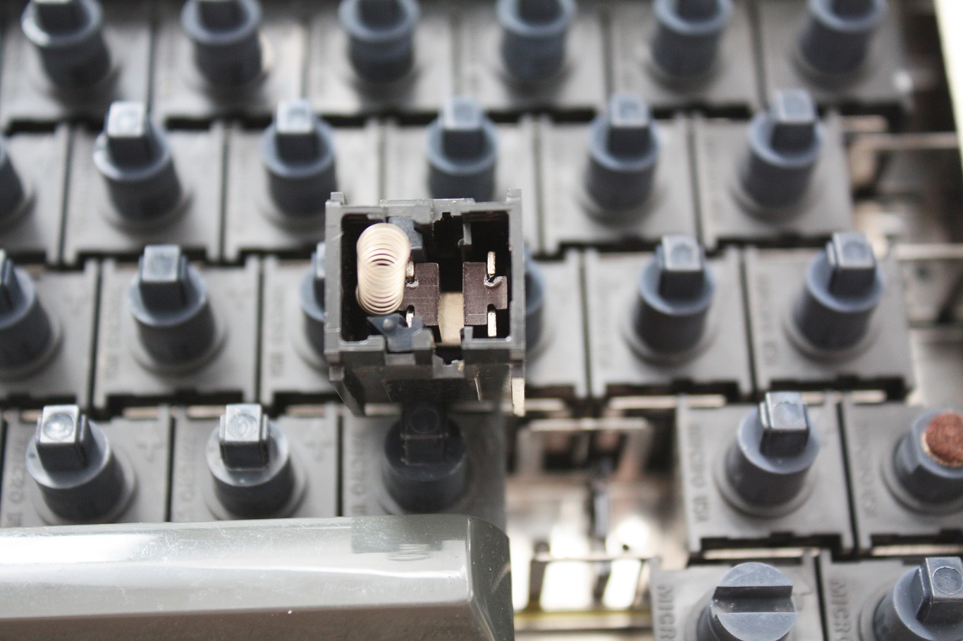

IBM 3277 typewriter keyboard - key switch taken apart
IBM 3277 typewriter keyboard - key switch taken apart.JPG (247.72 KiB) Viewed 7156 times

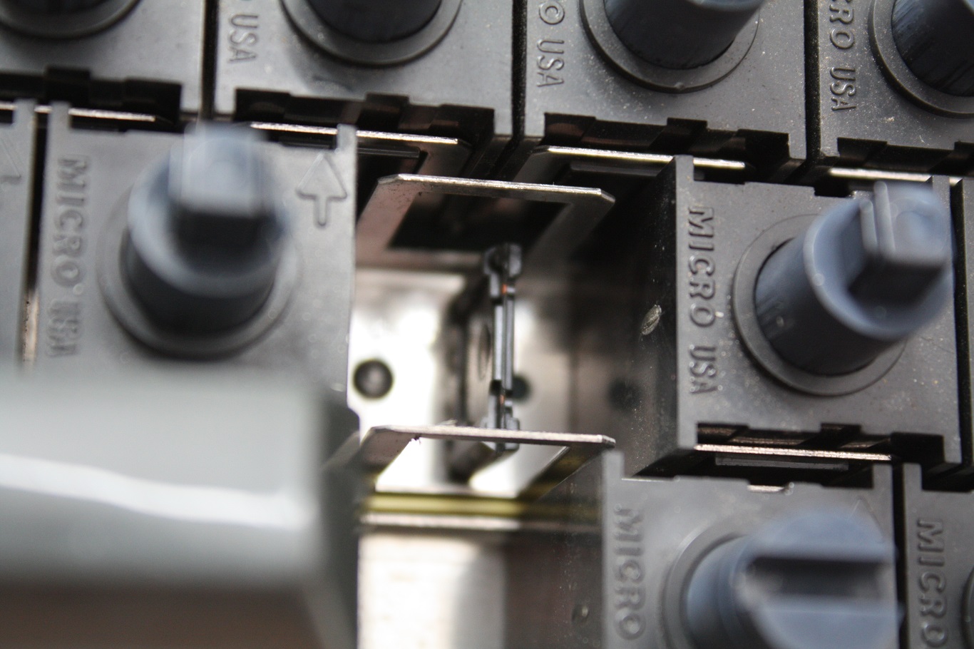

IBM 3277 typewriter keyboard - bottom of key switch removed
IBM 3277 typewriter keyboard - bottom of key switch removed.JPG (310.17 KiB) Viewed 7156 times

IBM 3277 typewriter keyboard - key caps
IBM 3277 typewriter keyboard - key caps.JPG (174.01 KiB) Viewed 7156 times

matchison
05 Jul 2016, 02:41
Damn, I'd be happy if I got either variation :O. Great find.
05 Jul 2016, 02:50
Could've sworn it'd be a beam spring =o . Either way, a really nice find! :)

Beautiful little keyboard. You can definitely tell the beamspring and microswitch apart from the shape of the keycaps alone; they all have a slightly different shape/domed top.
Hopefully you can find the beamspring one too in order to get a pair :mrgreen:

By the way, considering they were a bit dirty, what were the switches like? I've found the Honeywell ones can get really scratchy when dirty.

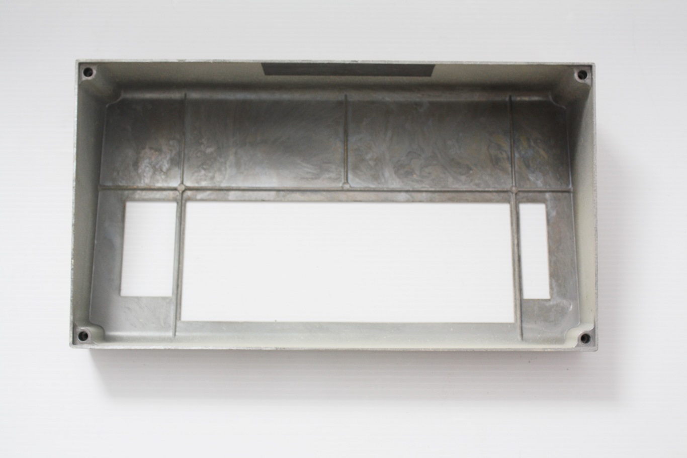

I'm not sure if Webwit has posted any other pics of his keyboard but it would be interesting to see the differences. There are differences even to Seebart's keyboard but it may be just a matter of different revisions. The obvious is that Seebart's key switch stems are turquoise and mine (although it's very difficult to see) are almost a deep purpley blue better seen in the fourth picture from the top. It's not black in appearance but may be an oxidized black. Along with the solenoid/clicker PCB being mounted standing up, the magnesium alloy case interior is not painted white as Seebart's is shown here. There must have been a few revisions of this keyboard.
Interior picture of the case

Chyros wrote: By the way, considering they were a bit dirty, what were the switches like? I've found the Honeywell ones can get really scratchy when dirty.
I have more than one hall-effect keyboard and these are pretty smooth but I find they bottom out pretty easily. I should check if the key stem colours have any bearing on weight. Because this keyboard has a "clicker", one might be included to stop pressing when they hear it do it would feel "buttery smooth" for a touch typist.
Question for Webwit, if he's watching. Did you get an Xwhatsit controller working with your beam spring version? I would imagine that if you did, it would work perfectly with this version too. They should both be speaking the same protocol so I may be able to get this to work.
06 Jul 2016, 14:25
Awesome snuci, easily the find of 2016. Even if these switches are filthy as hell these are extremely easy to open & clean which is the big difference compared to "regular" Honeywell Hall Effect. Pretty obvious. :D
IBM 3277 typewriter keyboard - key switch taken apart.JPG (247.72 KiB) Viewed 6992 times
The central point to me really is that IBM obviously commissioned Honeywell (Micro Switch) for some orders while using their own Beamspring for others. dorkvader touched on this in my original thread, IBM was obviously aware of the disadvantages of Beamspring in terms of airborn dirt (contamination shield hello?) and hence went with this instead.
