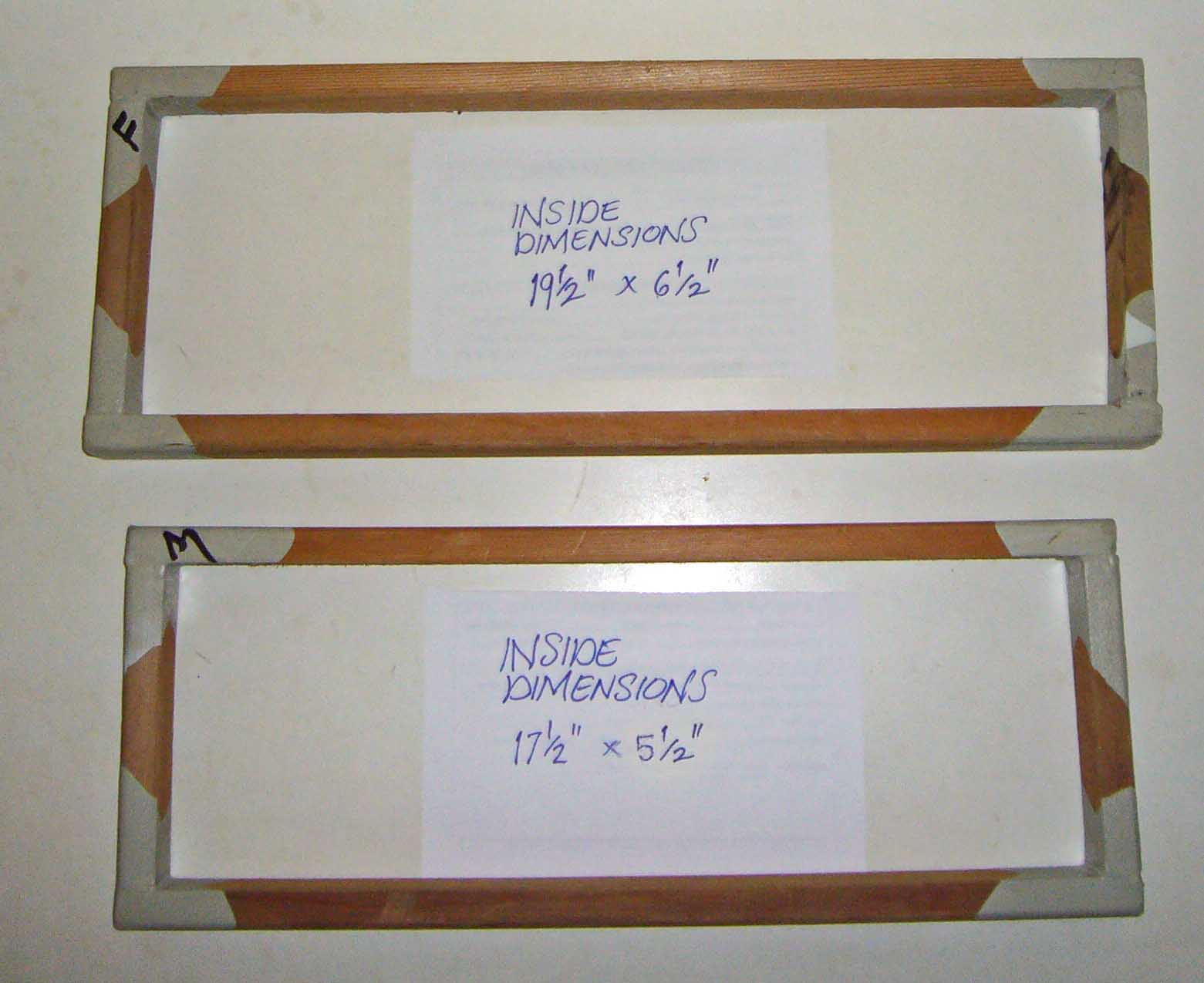

Having done at least a dozen Model M bolt mods, probably 2 dozen, I can verify that hammers not properly seated is the most common problem. The part that makes a grown man cry is that you have to install all of the key stems to test it, and take them all back out again to make adjustments. And it is at least as difficult on the Model F, if not much more so.
In fact, there have probably only been a few instances when I got it right on the first go, and it is not unusual to take multiple iterations to get it right. You can test the key to see and hear whether the actuation feels and sounds like the other keys. An improperly seated pivot plate ("flipper foot") seems approximately like an improperly seated key stem.
Do yourself a favor and build a frame out of scrap wood to hold the barrel frame while you are re-assembling.
There is one "fix" that can work, occasionally, if the "ear" is not far out of position: remove the key stem, press straight down onto the foot with a toothpick or chopstick, and attempt to move it laterally just a millimeter or so. On the rare occasion, you get lucky and it drops into place.
- IBM-assembly-frames-e.jpg (105.71 KiB) Viewed 2182 times
