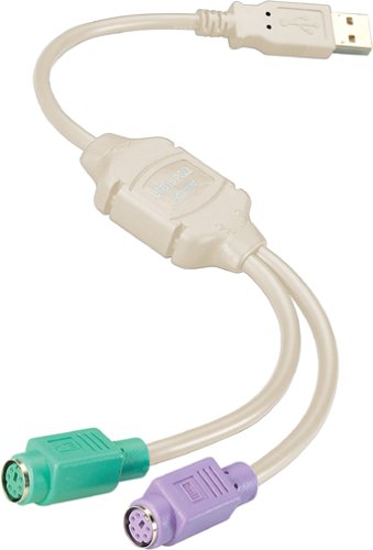

alh84001
v.001
04 Jan 2017, 19:07
I _think_ that any adapter that has two PS/2 connectors one one side and that bulge in the middle is active. That's speaking just from my own experience. Let us know if you encounter one that isn't. :mrgreen:

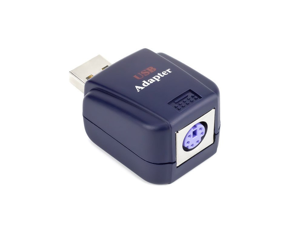

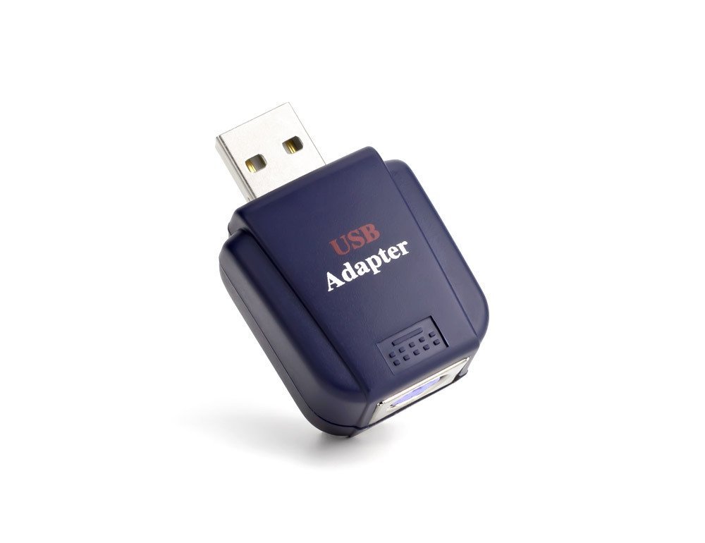

stan
24 Jan 2017, 02:53
I had this connected to my Model M from a 2011 MBP, but it stopped working after couple weeks.
This (below) works - I'm using it right now.
You can get it from Amazon.https://www.amazon.com/Sewell-Active-Ad ... +to+ps%2F2
There's another USB to PS/2 adapter that looks exactly like this one but costs $3 more. I went for the cheapest (see URL above) and it worked.
