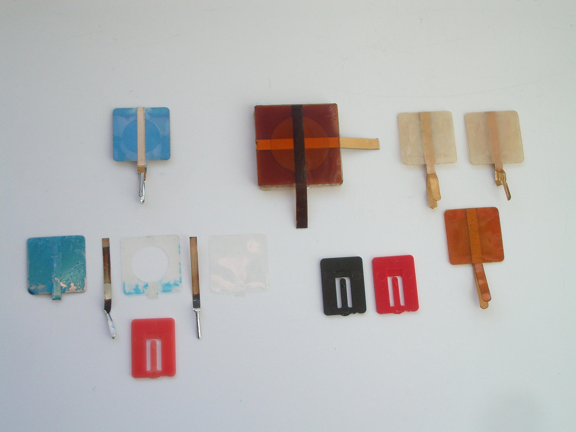

Poor Old Mr. Alps
The idea of a near-zero-motion modular actuator assembly was not their idea either. In fact, the membrane keyboard came first! The oldest known near-zero-motion actuator is that of Datanetics DC-50, and it was simply a way to put their even older (1969²) membrane system ([wiki]Datanetics elastic diaphragm array[/wiki])¹ into a discrete switch. DC-50 is not a true membrane system: it uses true metal contact, in a sandwich:
  1. Stainless steel backing plate
  2. Gold-over-nickel-plated cadmium copper alloy switch contact/terminal
  3. Mylar spacer
  4. Second switch contact/terminal
  5. Mylar cover
At the top left, you can see a production version. I got four of these, and one was in bits, so I finished off the disassembly. Some sort of blue adhesive holds the steel plate on, but the Mylar parts are seemingly affixed using invisible adhesive. (The brochure simply refers to "thermo-activated adhesive".) Below this is a pink actuator, which will look very familiar.
Top centre is a chunky cardboard-backed experiment, and to its right are two beige versions, one in bare form and one with the lead-outs stamped to form strengthened switch terminals (except one has snapped off at some point in the last 44 years). Both variants are fully working, but the beige one was quite stiff. Below these is a golden-brown version that doesn't work. Below all of these are alternate colour actuators.
In 1972, while this was being developed, the technology was licensed to Futaba. Meryl's notes don't say precisely what was licensed, but this may be where [wiki]Futaba MD series[/wiki] came from, since MD series is the most similar design, albeit without the hysteresis present in DC-50.
Alps SKCC seems to be from around 1979 onwards, so unless their switchplate goes back further, they appear to have come into this game fairly late. Their design is of course very different to both that of Datanetics and Futaba, but the overall idea is exactly the same: sealed or partially sealed contacts with near-zero movement that are operated by a perpendiculator. (A new word: something that converts motion in one axis to motion in a perpendicular axis. Also functions as a motion reducer, which I wanted to call a motion condenser but I settled on [wiki]motion reducer[/wiki].)
¹ if anyone actually understands their membrane system I'll be well impressed. I don't think even Meryl still remembers. It's ludicrously complicated, with about seven layers, and it looks like it was simplified over time to something far more akin to what we know of as a membrane keyboard today
² the wiki says 1968 but Meryl's notes say 1969 — I need to double-check where I got 1968 from

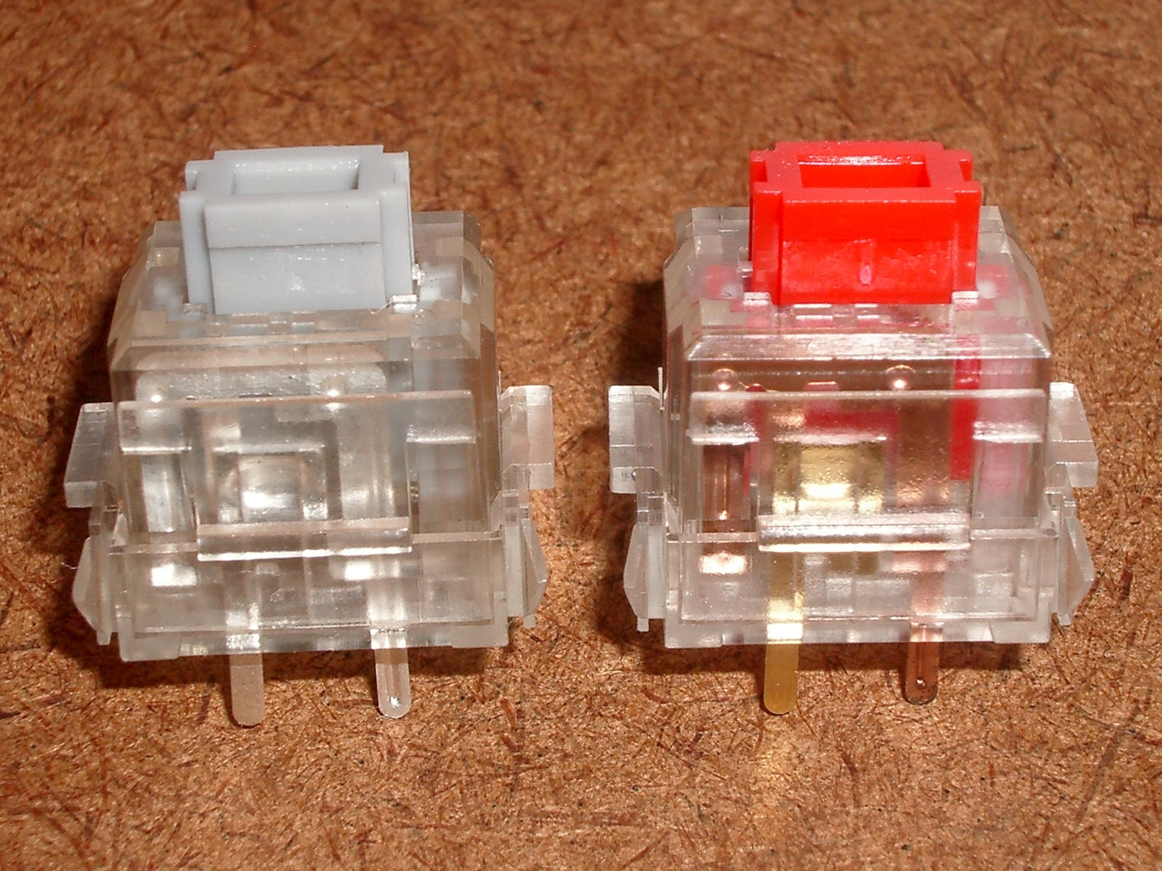

Can I make a wish for keyboard research 2017?
What did Matias do to the [wiki]Alps_SKBL/SKBM_series[/wiki] design to 2.5x it's lifetime rating from 20m to 50m?
Where do these switch ratings come from anyway and who verifies them?

seebart wrote: Good question, I am generally quite skeptical regarding these ratings...
Especially when they all SOMEHOW exactly match the rating of Cherry switches, who gold-plate their contacts for a 50m rating ...

Wodan wrote: Can I make a wish for keyboard research 2017?
I asked Matias this for the Tactile Pro video. They use gold-plated copper contacts (originally silver-plated steel, which I also have a few of). Most companies, even small ones, test them in-house.

Chyros wrote: I asked Matias this for the Tactile Pro video. They use gold-plated copper contacts (originally silver-plated steel, which I also have a few of). Most companies, even small ones, test them in-house.
That would make a lot of sense. Did they release a new revision recently?
The ones I got look like that:
wiki/Matias_switch#Gallery
And that is still super silver ...
They are the silver-plated steel ones. The new copper ones look coppery, there's really no mistaking them.
02 Jan 2017, 20:50
The Matias pictures on the wiki are from 2013. I've never added any photos of the newer switches.
The reflectiveness of the shell makes them something best left to someone else to photograph, but I did post this picture in my own switch collection:
Within my own collection, only the linear switch uses the new materials. The grey slider quiet click switches are still the old materials. I did wonder what the change was about.
