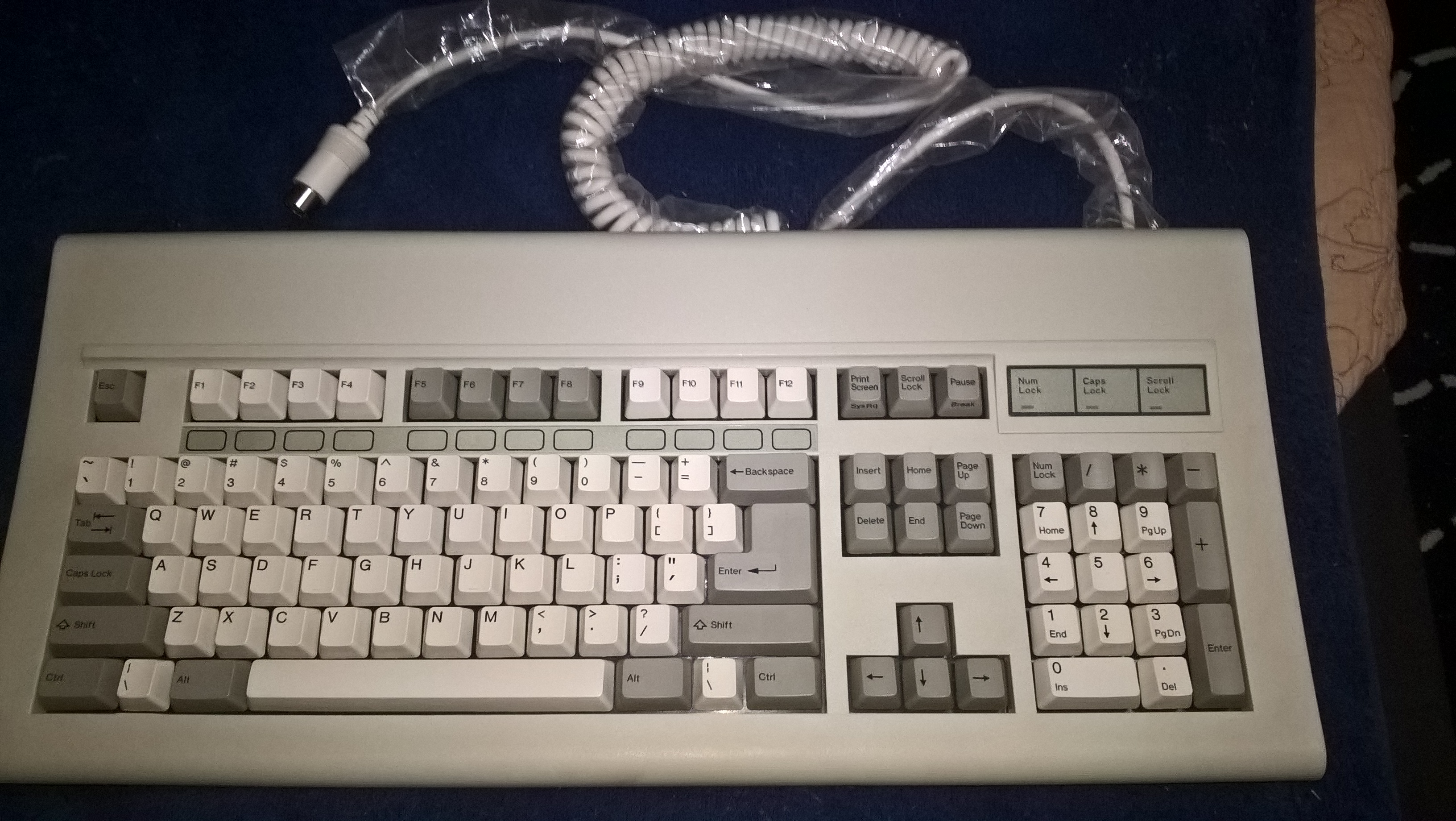

Fairly interesting board found recently.
  • Layout; large Enter, window-keyless with duplicate pipe keys in place, similar to the Focus FK-8000 KeyCal(but with default mapping/left keycap)

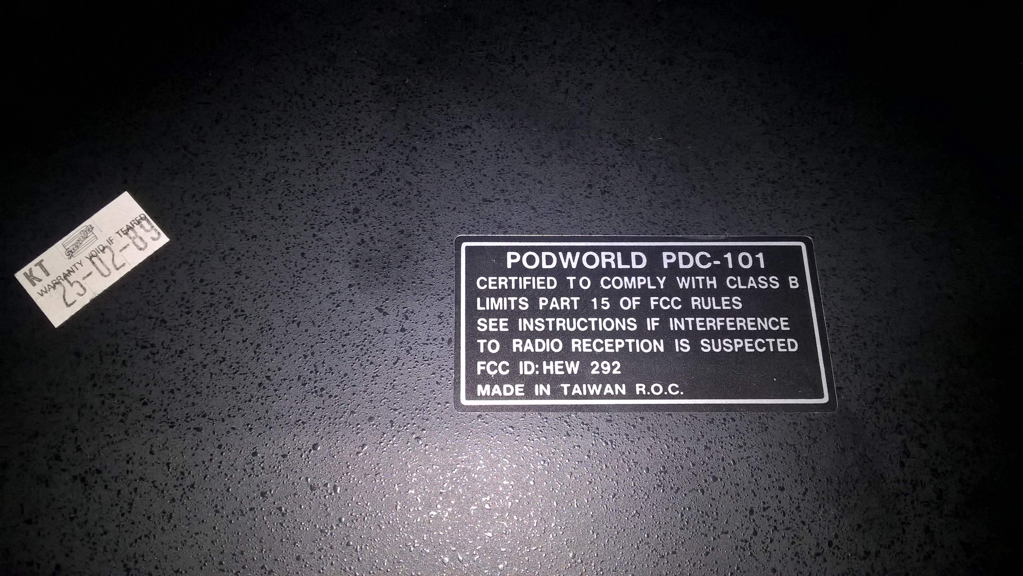

  • Dated 25-02-89 -warranty sticker on back-plate.

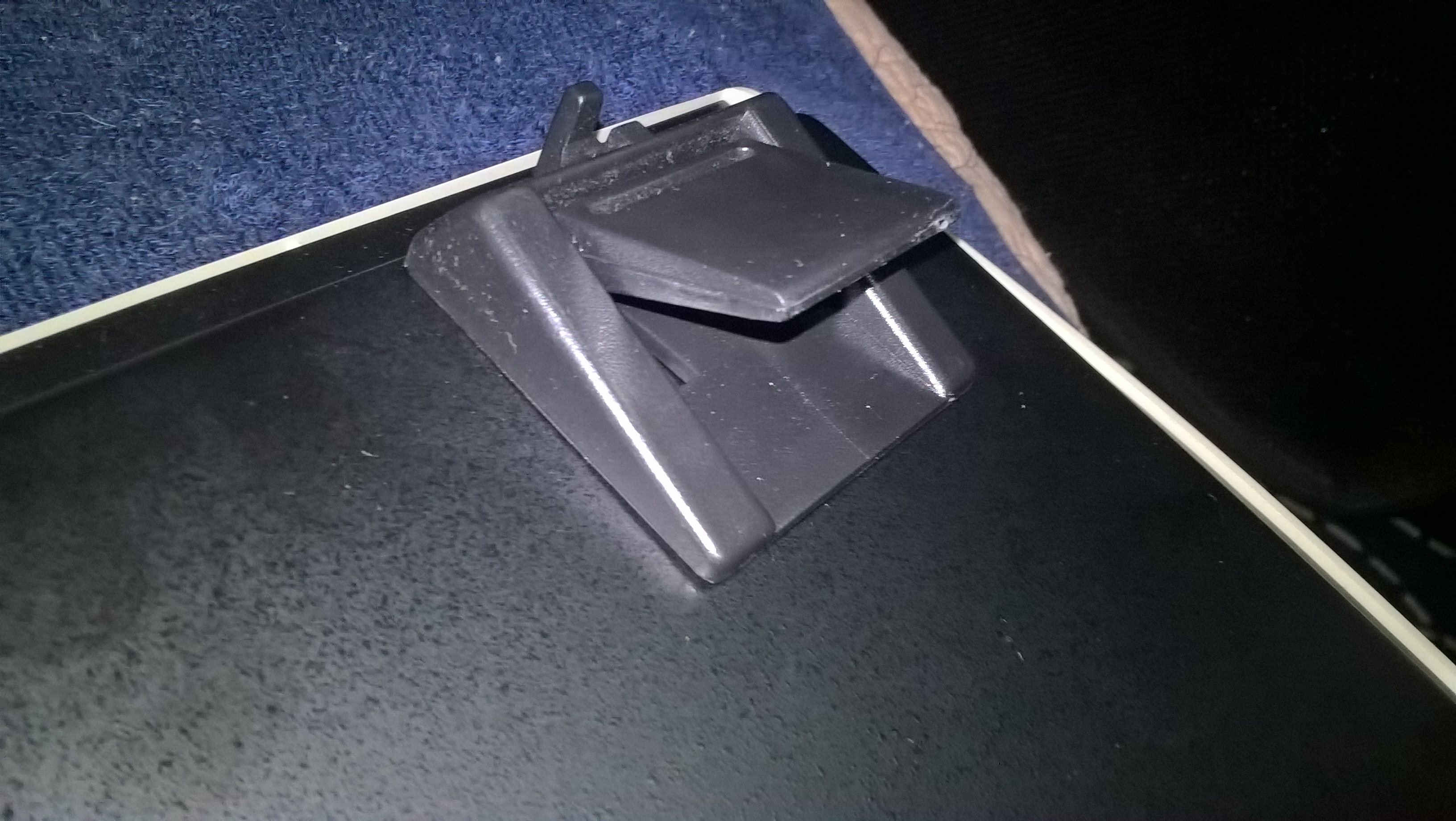

  • Seems to have the same style large flip-out feet with cable holder as the Focus FK-727 and the Northgate OmniKey*, but in black and without rubber.

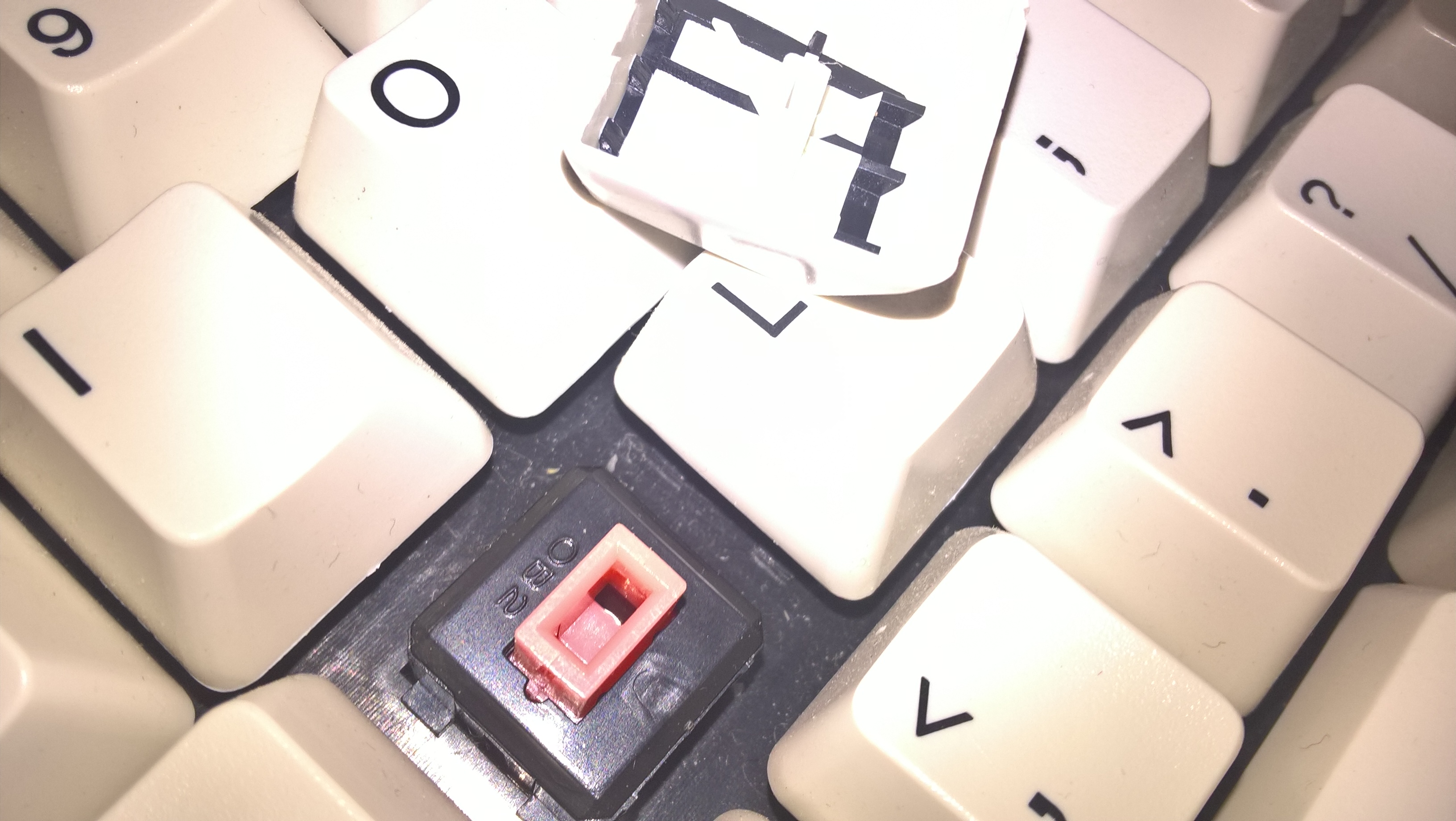

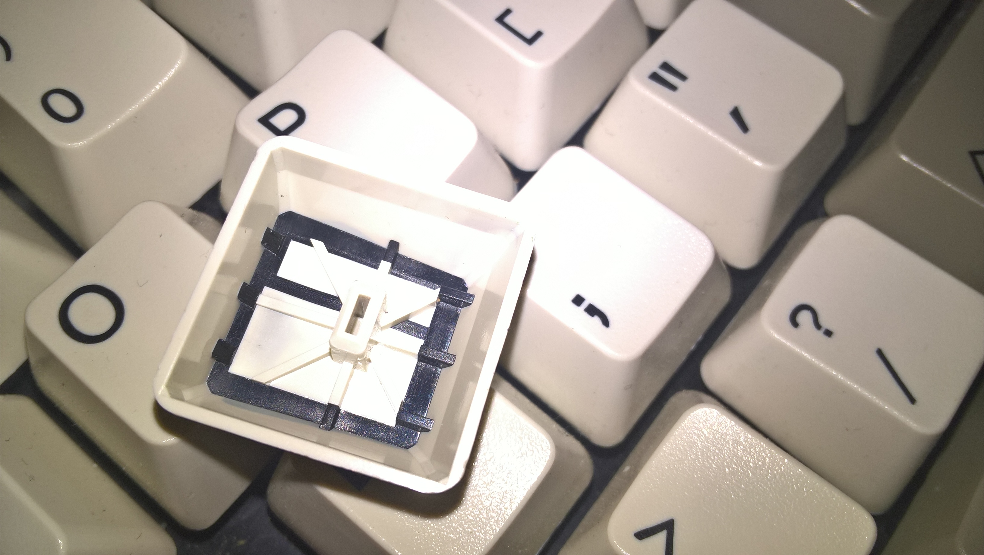

  • Keycaps appear to be double-shot ABS?
  • Switches seem to be the same "O"-series KPT-like switches noted in a similar board, under the same FCC ID.*
    >They have the same seemingly random "OXX" markings as above, but are all "OBX"*
    >They are black with pink sliders, are clicky and quite loud, and are fairly uniform except for the TAB key which is quiet -likely due to malfunction.
  • 'Solid' feeling construction, with metal back-plate.
  • 5pin DIN
  • Possibly a typo in the FCC ID — according to the FCC, there is no "HEW" grantee.

The wiki entry for the FCC ID

Interesting board.
Certainly appears to be a FK-555 clone.

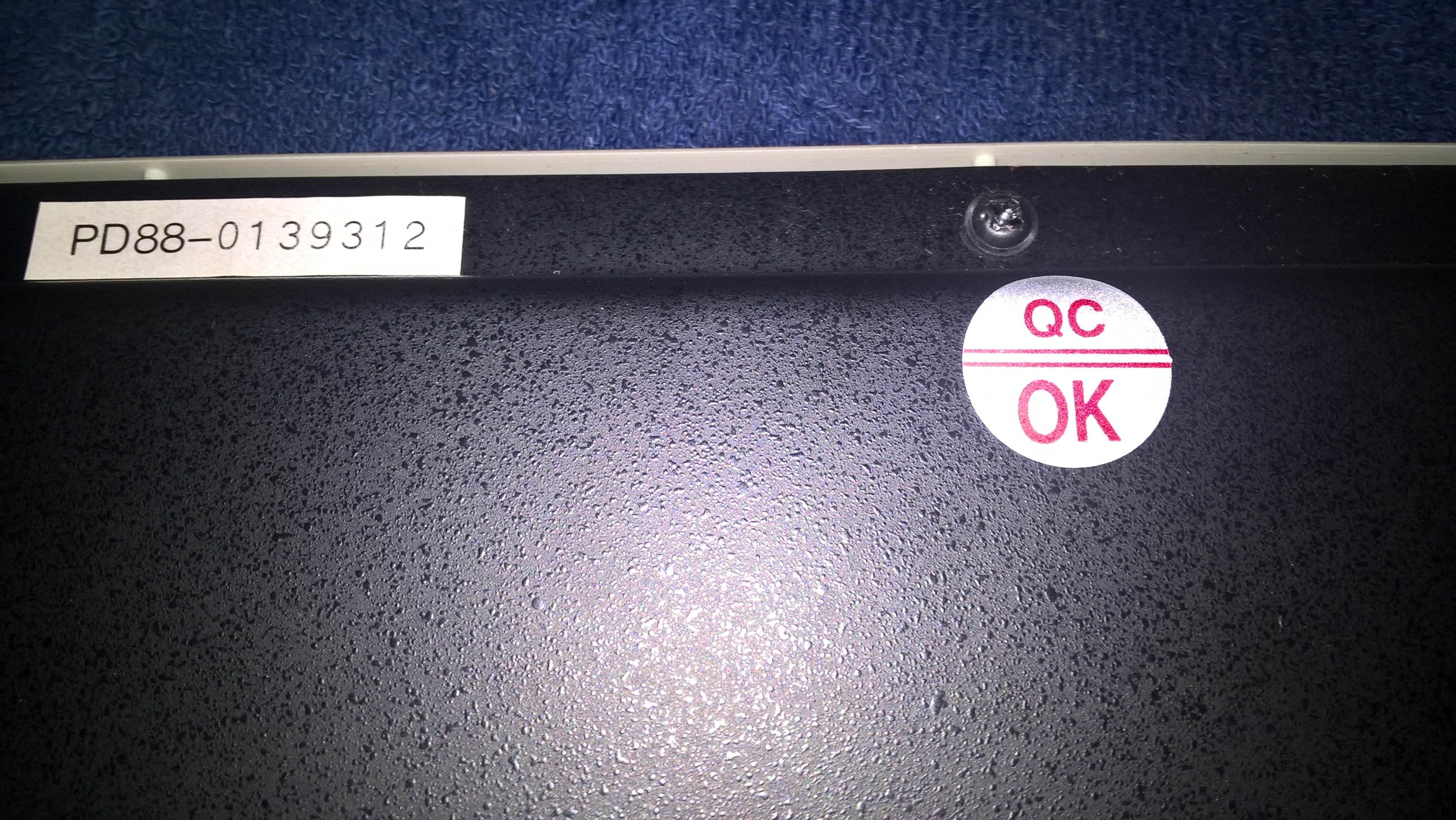

23 Feb 2017, 09:24
Interesting — it has a PD label on the back in the same format (albeit not the same typeface!) as the label on the matching keyboard with [wiki]ProWorld Cherry MX clone[/wiki]s:
https://geekhack.org/index.php?topic=46705
I've seen that style of label before (in the style of the one on the ProWorld keyboard) but I seem to recall that it's normally just digits. In Asian abbreviation, "PD" could denote either "ProWorld" or "PodWorld".

05 Mar 2017, 17:26
Also:
So, the manual for the SKB-5150C (with ProWorld switches) lists alternative PDC model numbers, and the PCB is marked "PD".
It does therefore appear that ProWorld and PodWorld are related or the same.
