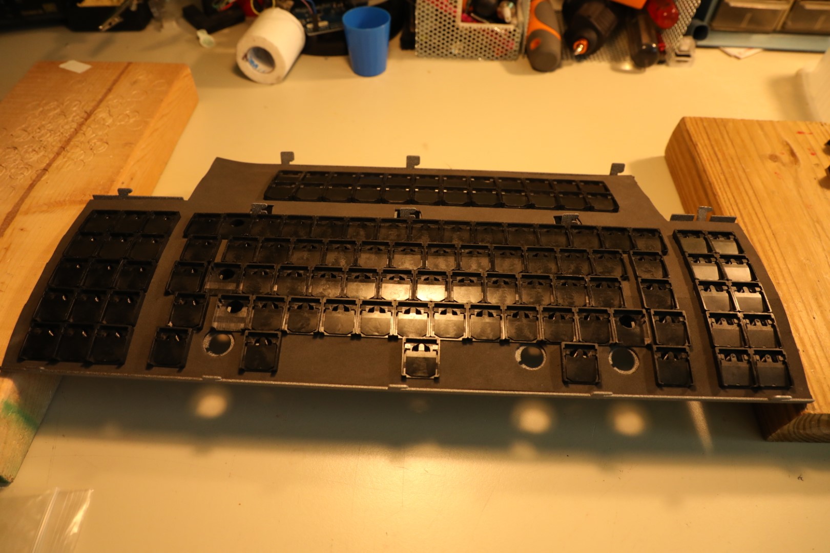

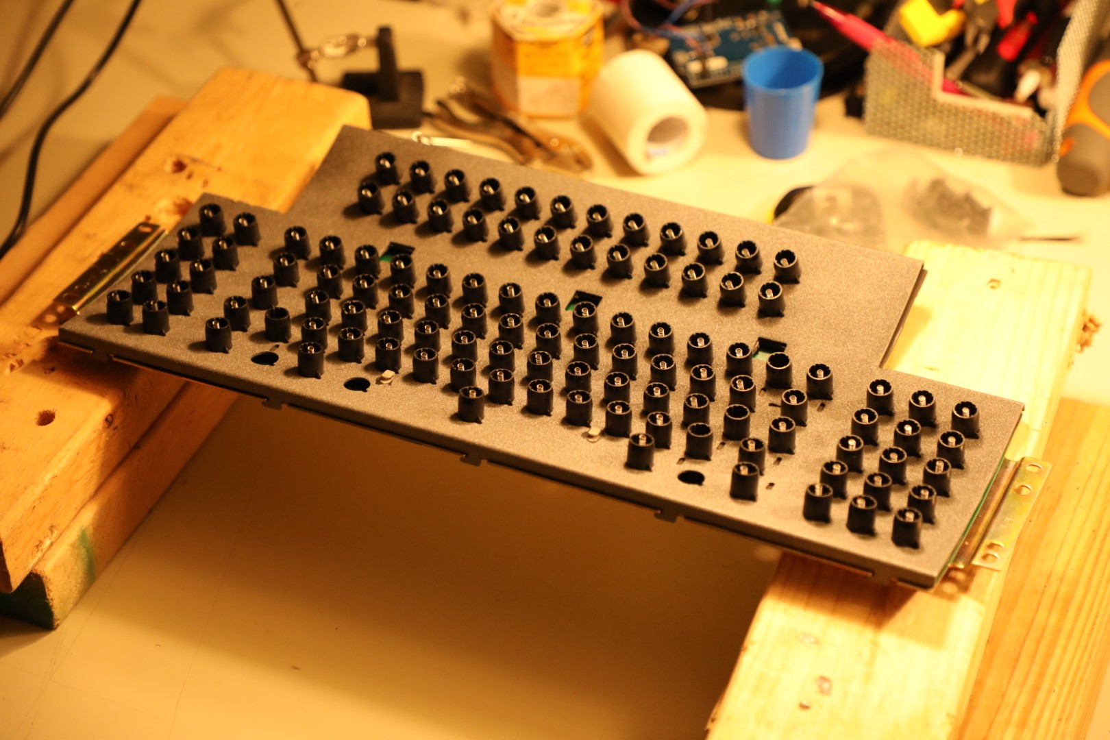

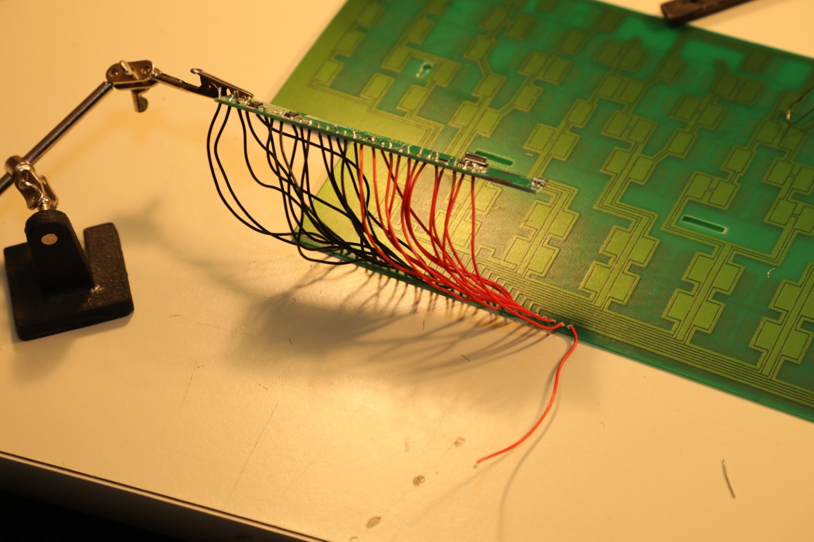

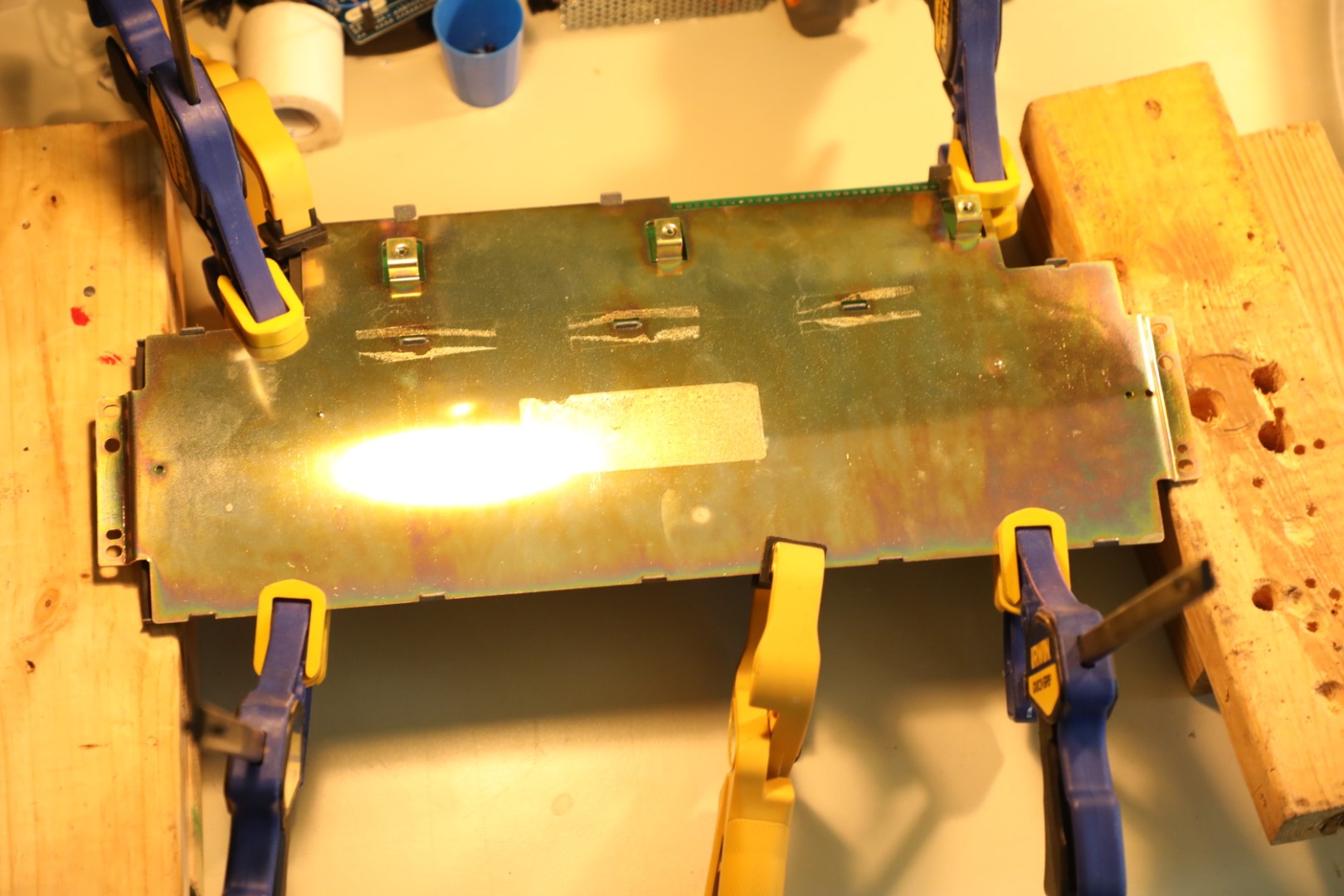

Here are a few images from my Unsaver build log:
