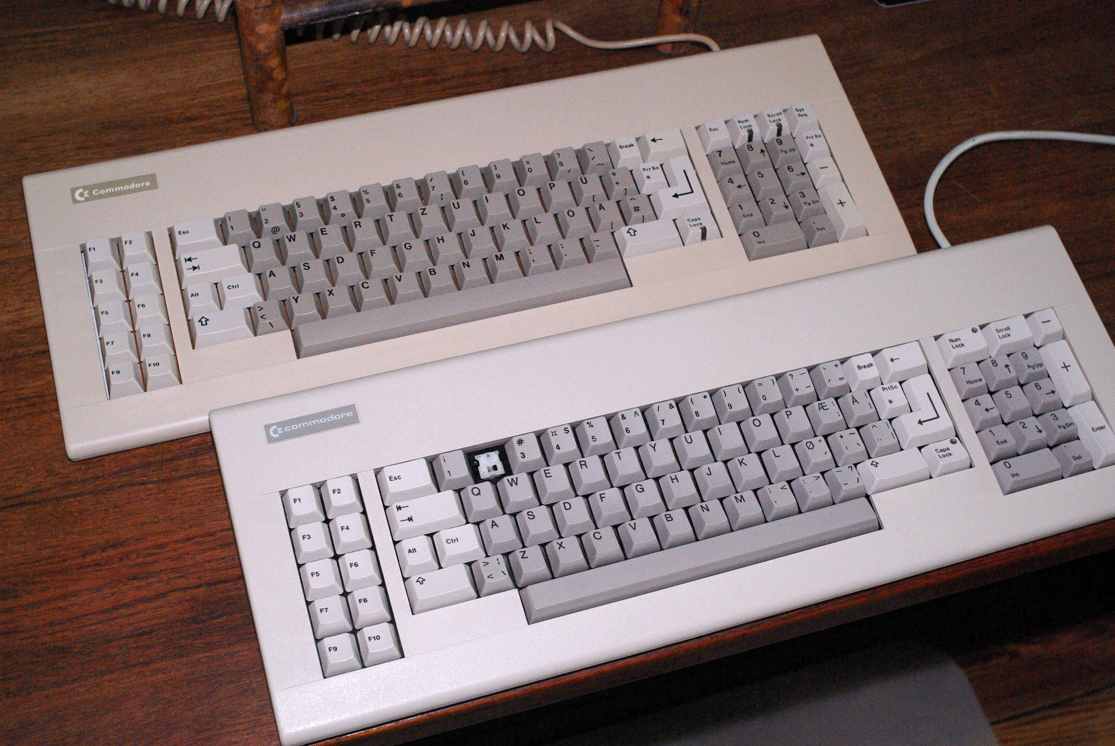

Half-Saint wrote: I presume this is an XT keyboard and I took it because of Cherry MX switches and key caps.
There are at least three versions of this; notice how the num-pad top row differs;
The top one with the two ESC keys and speaks AT protocol while the bottom one is XT and in this case is the NMB version that is more uncommon than the Cherry version with MX blacks. All three versions are PCB mount but the cases are very sturdy, no flex. I'm never quite sure which one is PC-5 and PC-10.

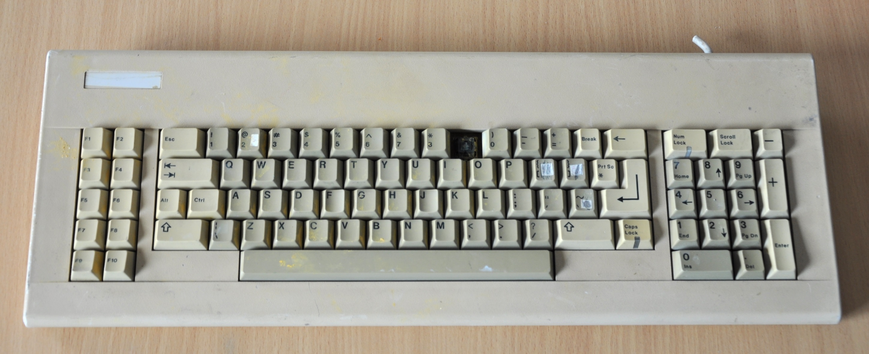

Here's the one that I have in all it's dirty ugliness!
17 May 2017, 16:30
Yeah that's pretty beat up but as long as the PCB is OK it's not dead. Have you been able to test it?
Half-Saint
17 May 2017, 20:00
Not yet. Need to clean it up first.
