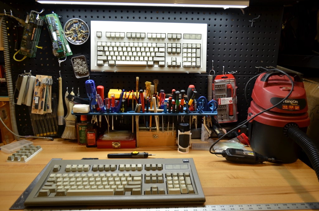

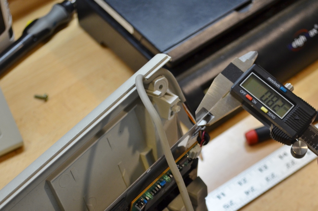

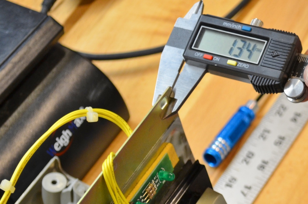

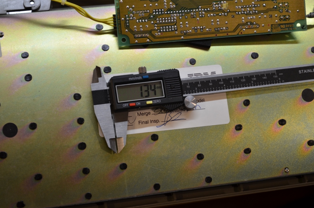

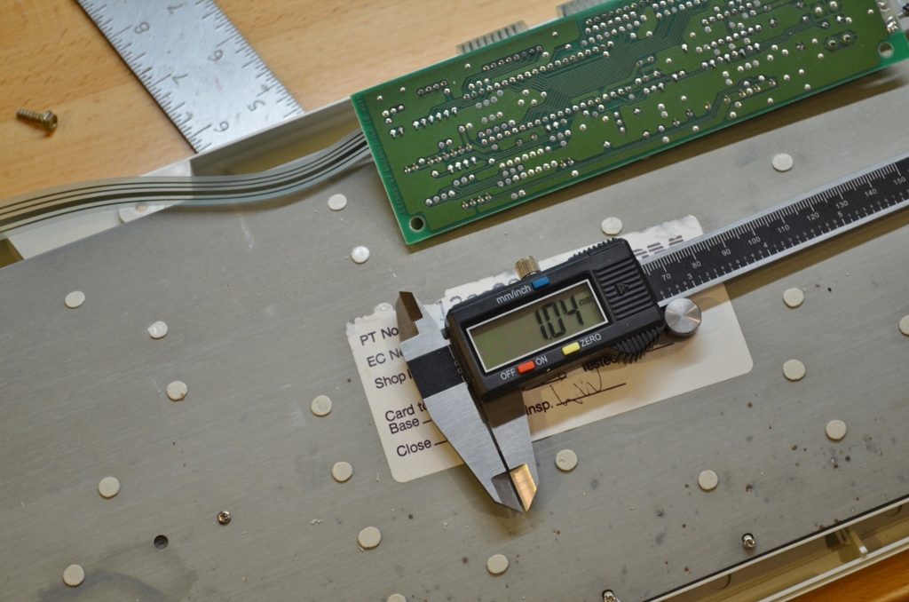

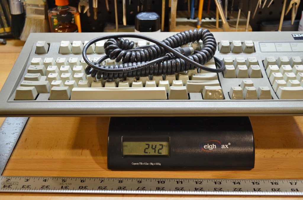

I reorganized the ClickyKeyboards workshop this weekend and did not get a chance to do the usual work of IBM model M keyboard restoration, but instead I made the time to collect some technical data on weights and measurements comparing three different model M keyboards.

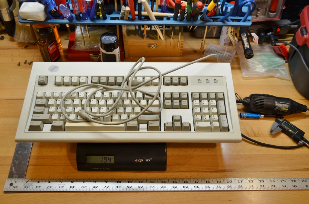

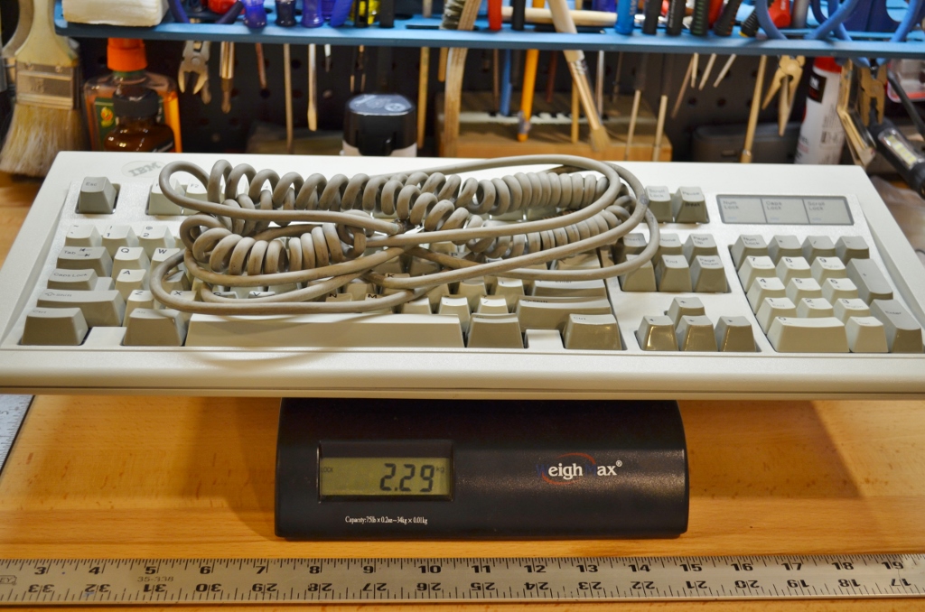

WEIGHT (with cable) 2.42kg 2.29kg 1.94kg
WEIGHT (no cable) 2.26kg 2.10kg 1.89kg

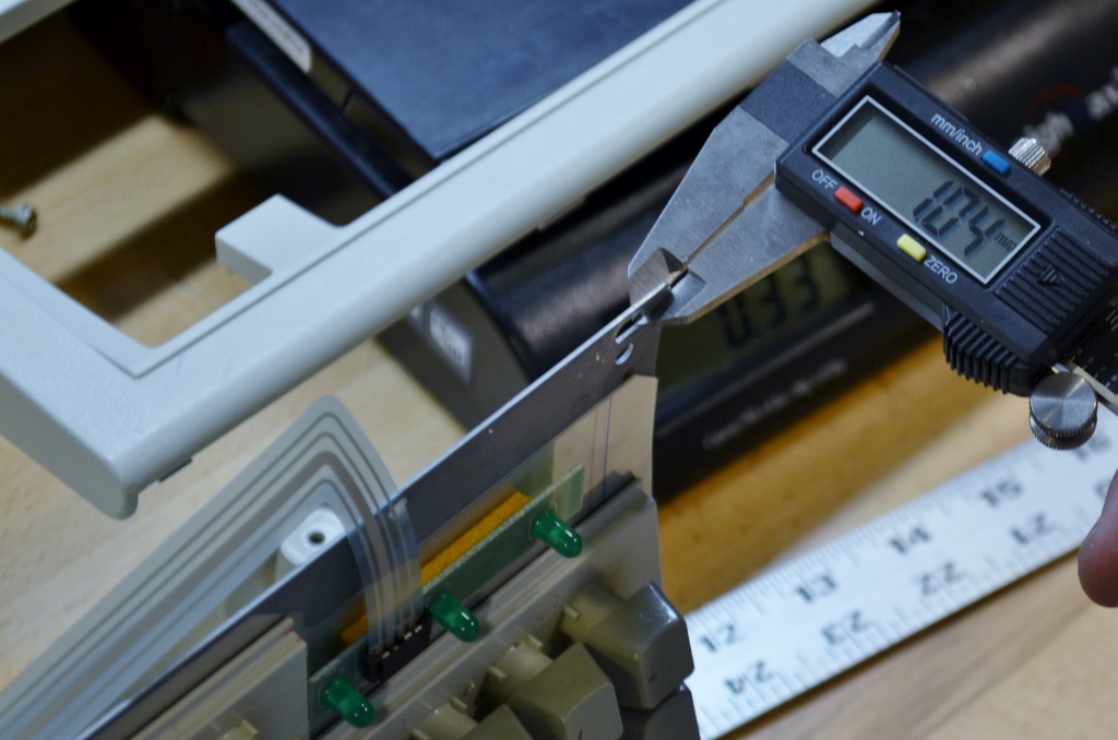

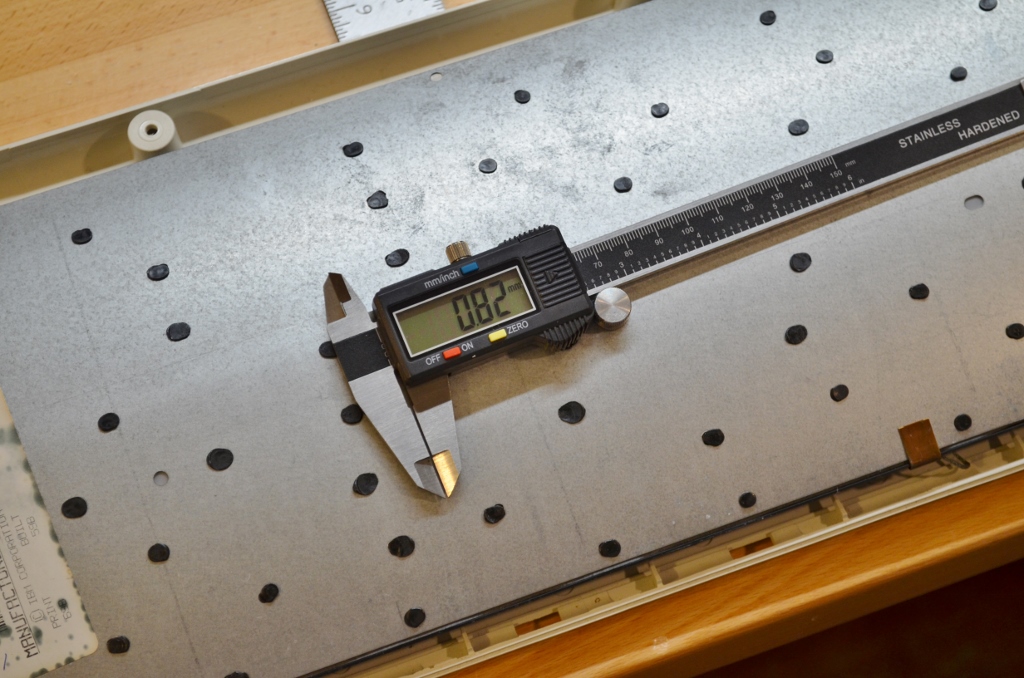

PLATE THICKNESS 1.34mm 1.04mm 0.82mm

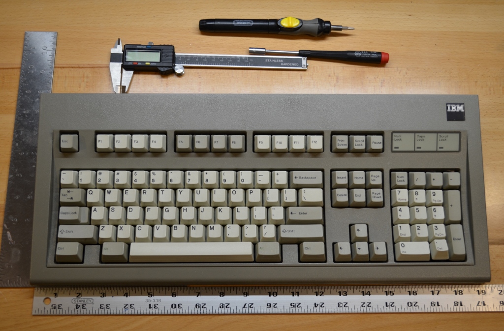

1388032 (10 NOV 85)
1391401 (30 SEP 89)
42H1292 (09-09-96)

Thank you for this analyze!
Is the weight (without cable) variation is only due to the plate tickness variation?

The weight of the keyboard was measured both with and without the cable.
The 1388032 was originally bundled with the black SDL to AT cable.
The 1391401 was originally bundled with the extra-long SDL to ps/2 cable.
The 42H1292 has a permanently attached ps/2 cable.

That's interesting, I didn't know about the plate thickness.
