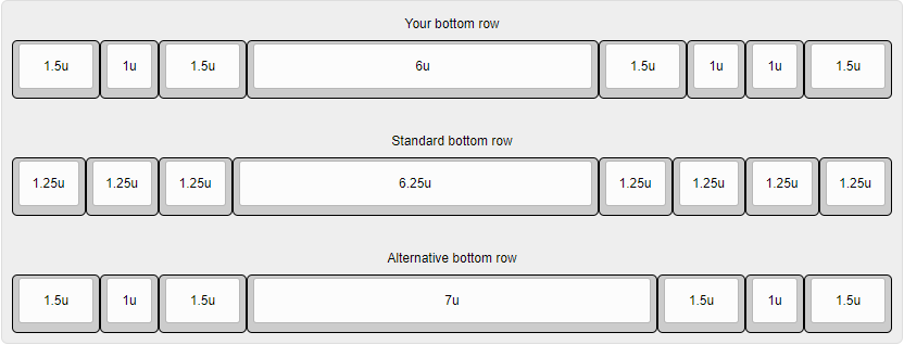

So the keyboard you have has a bottom row like this: 1.5u - 1u - 1.25u - 6u - 1.5u - 1u - 1u - 1.5u, where 'u' designates the Size (Unit) of a standard keycaps like the ones used for the alpha keys.
Normally standard ANSI sets have a 1.25u - 1.25u - 1.5u - 6.25u - 1.25u - 1.25u - 1.25u - 1.25u bottom row, some times they also have keycaps for a 1.5u - 1u - 1.5u - 7u - 1.5u - 1u - 1.5u bottom row.
Bottom row styles.PNG (9.91 KiB) Viewed 8042 times

Nuum wrote: So the keyboard you have has a bottom row like this: 1.5u - 1u - 1.5u - 6u - 1.5u - 1u - 1u - 1.5u, where 'u' designates the Size (Unit) of a standard keycaps like the ones used for the alpha keys.
I see. And how can I go about buying key caps for such a configuration? Would i have to get it custom made?

razzlesama wrote: I see. And how can I go about buying key caps for such a configuration? Would i have to get it custom made?
Your only problem is the 6u spacebar, all the other keys should be readily available in most shops. I honestly don't know where to get a 6u spacebar outside of specialized group buys. Custom manufacturing will be very expensive!
