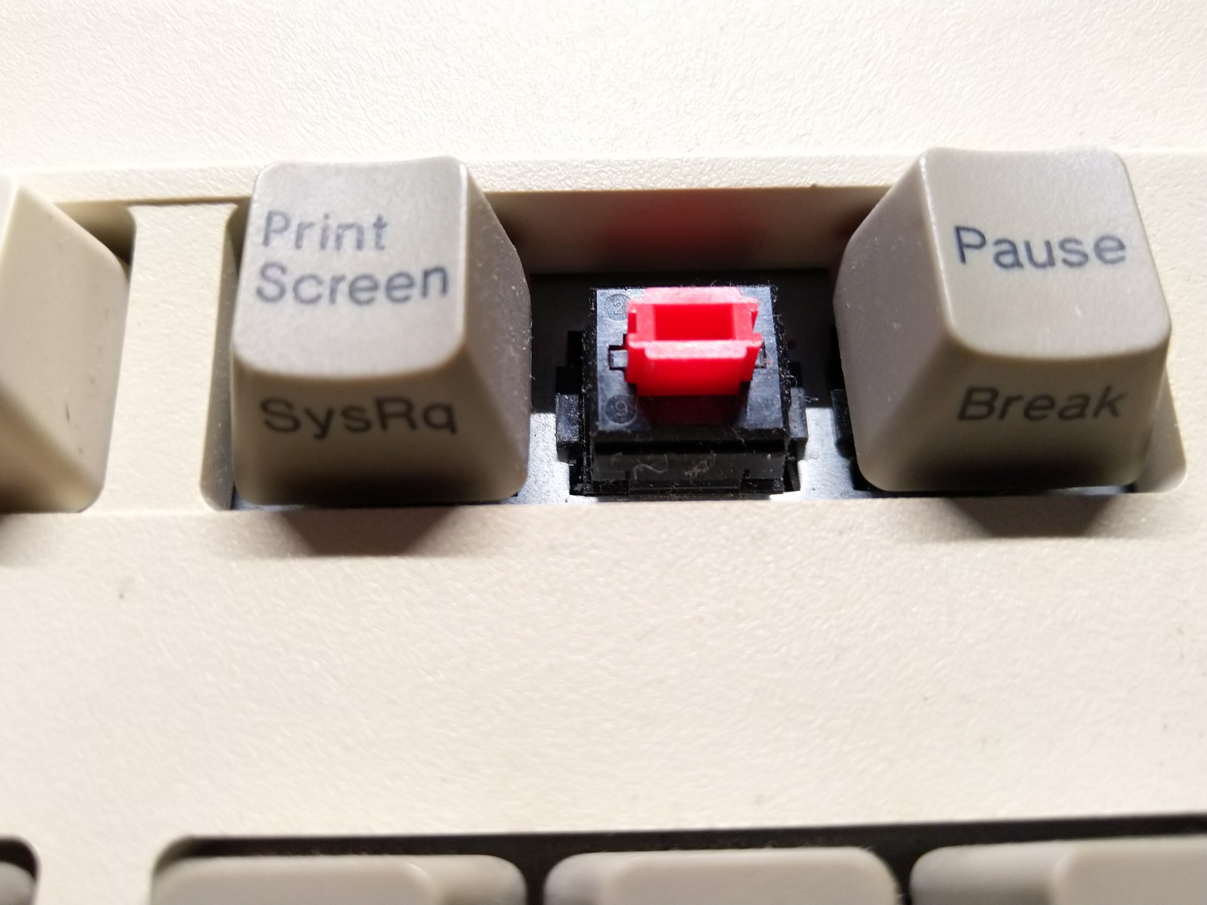

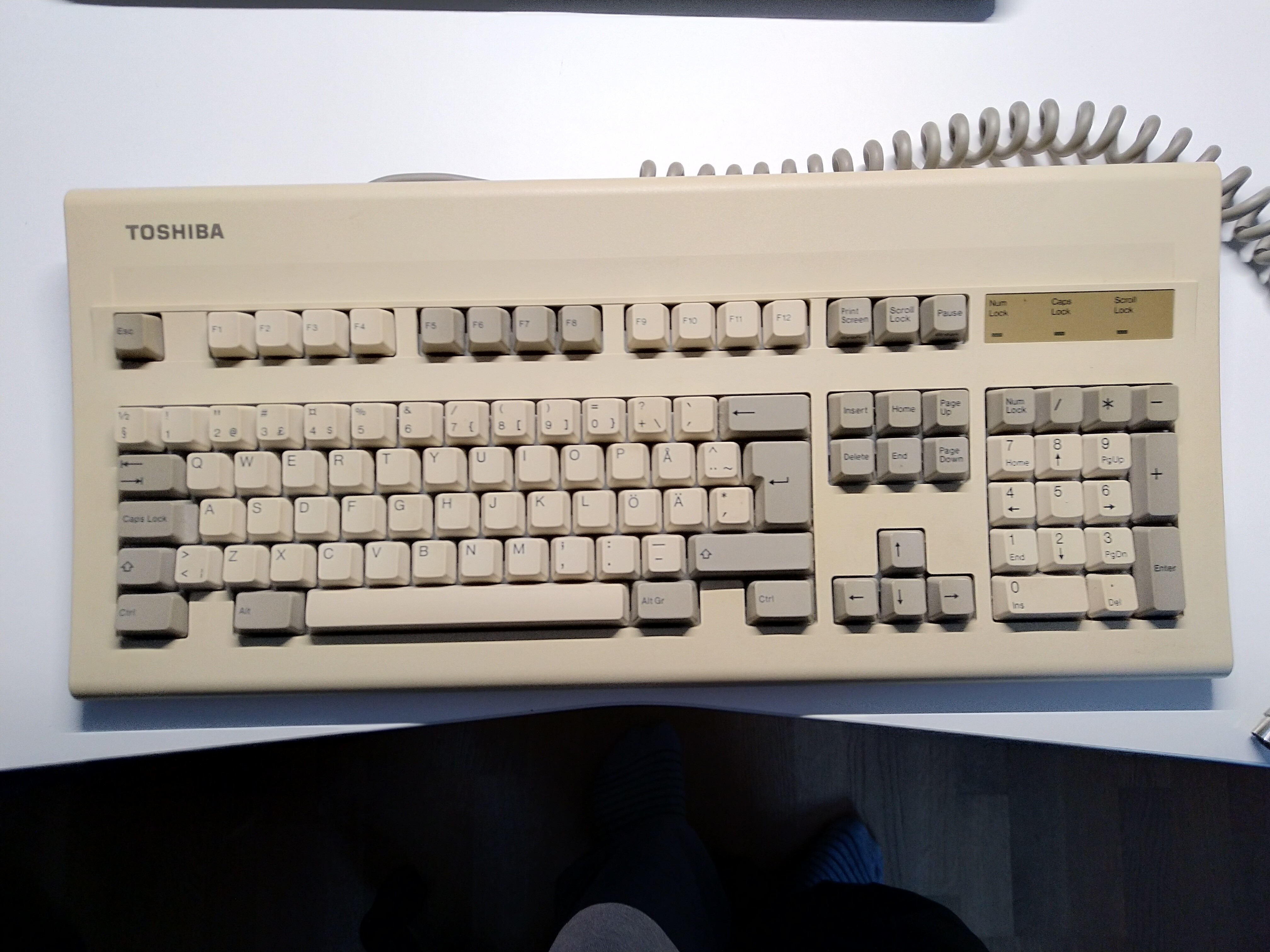

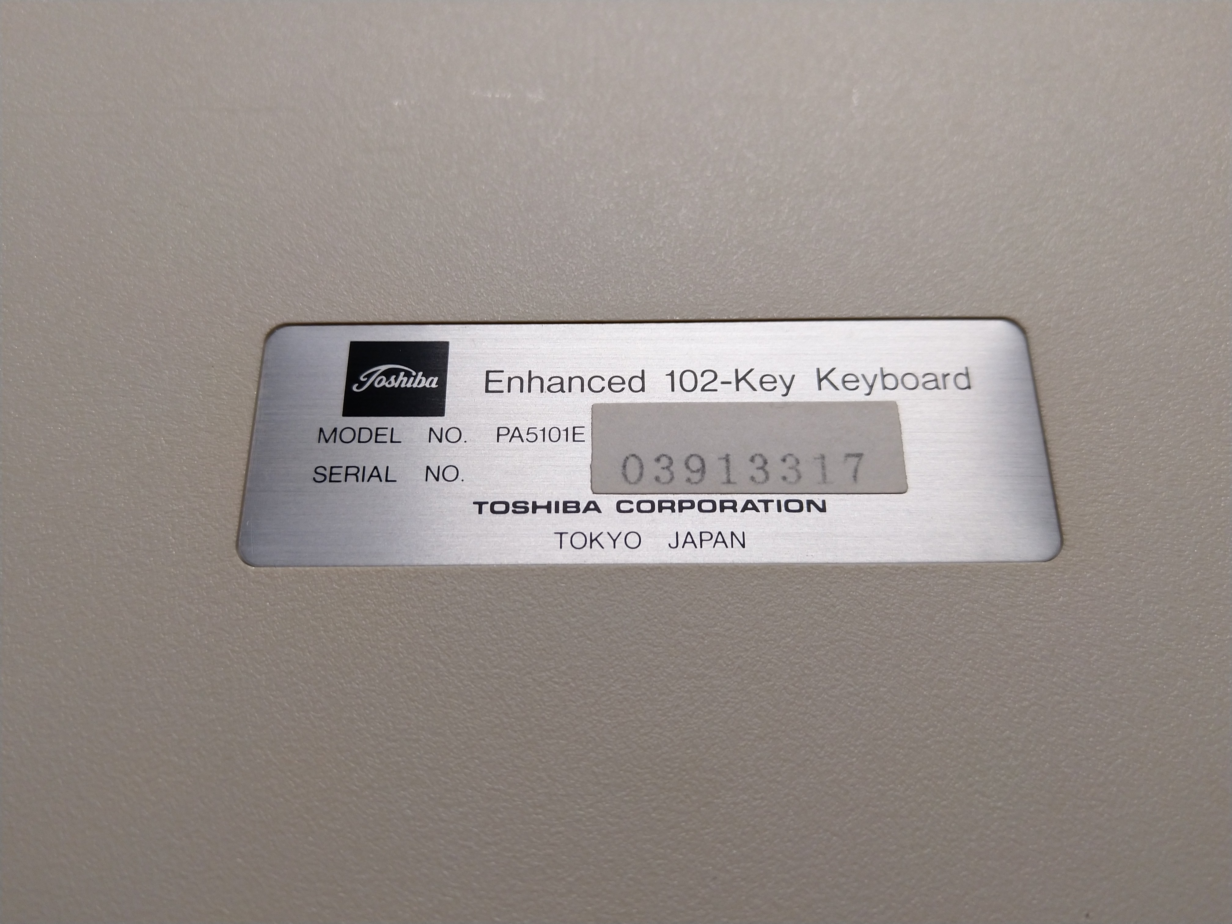

I recently noticed that this Toshiba PA5101E keyboard (photo gallery) in my keyboard scrap yard^W^Wcollection can't be a rubber dome keyboard because it makes clicky noises (movie, 37 MB).
So I removed a key-cap and found what looks a lot like a red-colored Alps switch to me. Only that there never were any red Alps switches according to the Deskthority wiki. Alps SKCM Orange come close, but mine are clearly red and clearly clicky.
So I wondered if they could be some Alps clones, but the only clones with red stems I found are
  • Matias switches which always seem to have clear switch housings while my keyboard has black housings, and
  • Tai-Hao BSW 045WHN switches which have a red stem and black housing, but the housing looks different, especially with regards to labels and tabs on the side (see below).
Another reason to believe they're original Alps switches are the following facts:
So these switches seem to be red and clicky Alps SKCM switches which so far haven't been documented in the Deskthority wiki and nobody over at Reddit's /r/MK knew of them either.
Anyone here has seen red Alps switches before? Anyone else has a Toshiba-branded Alps Bigfoot keyboard for comparison?
And how should I proceed? Should I just add these findings to the DT wiki? Or should I wait until someone else finds another such keyboard to get some statistical significance?

This could potentially be a sort of White Alps prototype, that's what I and some others at the R/MK discord thinks. The click leaf is similar to white Alps' and it uses a short switchplate. Hella awesome find!

A couple quick questions. 1) Have you unsoldered a switch from the PC board and checked the bottom of the lower housing for an Alps logo? 2) Is there a mold number at the bottom of the keycap slot on the slider?

I would suggest taking as many pics as possible (example: http://www.deskthority.net/wiki/Alps_SKCM_Green ), and desoldering one of the switches and send them to somebody who can make a force graph :)

mcmaxmcmc wrote: This could potentially be a sort of White Alps prototype, that's what I and some others at the R/MK discord thinks.
Hrm, things which IMHO speak against a prototype theory:
  • German layout, not the probably most common layout (US ANSI) and nothing Japanese either.
  • Not branded as ALPS but as Toshiba.

Unfortunately I don't know where I got that keyboard from. %-) Chances are high that it was one of the keyboards my father gave me in a bag a few months ago and said "he doesn't need them anymore". So I assume they're from a company where he worked decades ago and in whose electronics dumpster I already found a working (but dirty-sticky) Cherry G80-2100 (which I still have) back then. At least I haven't any better explanation. :-)
Oh, and the springs in these red Alps seem stronger than those in white Alps. We had two vintage white Alps keyboards at the meetup today, too, and compared directly. :-)
And I at least cleaned the case and the key caps, so it's now cleaner than on the first pictures. Nevertheless most people at the meetup noted that the switches still feel sticky. So it's now my "sticky-clicky red Alps keyboard". ;-)

green-squid wrote: I would suggest […] desoldering one of the switches and send them to somebody who can make a force graph :)
Hrm, until now I was strictly against desoldering switches from that keyboard as I don't want to destroy a rare vintage keyboard, but with regards to the force graph, you've got a point there. Then again, I'm currently not aware of anyone in my circle of keyboard enthusiasts who can do a force graph.

So, from what I heard, this seems like an alternative to white alps... a heavier variant. How tactile is it by the way? (I vote for force curve.)

  • Did you check the inside of the upper case? There may be date codes/part codes/etc on it.
  • That PCB doesn't support an ANSI pipe/backslash key. There's a cutout where the contacts and traces for that would normally go. Also, it appears to have traces/contact points for a full-size left shift, split backspace, and ANSI enter (likely a big-ass enter with the switch in the ANSI spot).

Red Alps is an awesome discovery! Can I ask about the keycaps from the board?
Their make and design could help determine a date/place of manufacture.

I would desolder a switch and see if you can see alps branding on the bottom of the housing. I think they are genuine, the internals look it but hard to tell 100%, if they are alps they are later ones due to the white switch plate.
We need a force curve comparison to white alps!

I think it could be that Toshiba commisioned Alps to make red clicky switches for its own products but looks like it was a limited supply run similar to the larger alps brown switches unearthed earelier in the year that appear to have been made just for a single board.

Why do i think it's just Matias red linear stems with the dampeners removed put into a clicky alps switch? I can't see the picture that well on my bad monitor but it looks like there was a space in the sides of the slider for the dampeners.
I also tested putting a red linear Matias stem into a blue alps it works. It's just a hoax i think and not real at all.

Sup wrote: 27 Jan 2019, 22:09 Why do i think it's just Matias red linear stems with the dampeners removed put into a clicky alps switch? I can't see the picture that well on my bad monitor but it looks like there was a space in the sides of the slider for the dampeners.
I don't think it looks similar to Matias sliders.

Come on it's not a hoax, I was at the meetup and know the owner.. Really unlikely.. and I examined and typed on that board.. Actually I did not find the switches interesting because unfortunately they where really sticky and dirty, but it might be worth it to desolder them and ultrasonic clean them.. Really nobody else has a similar Toshiba board? :)
