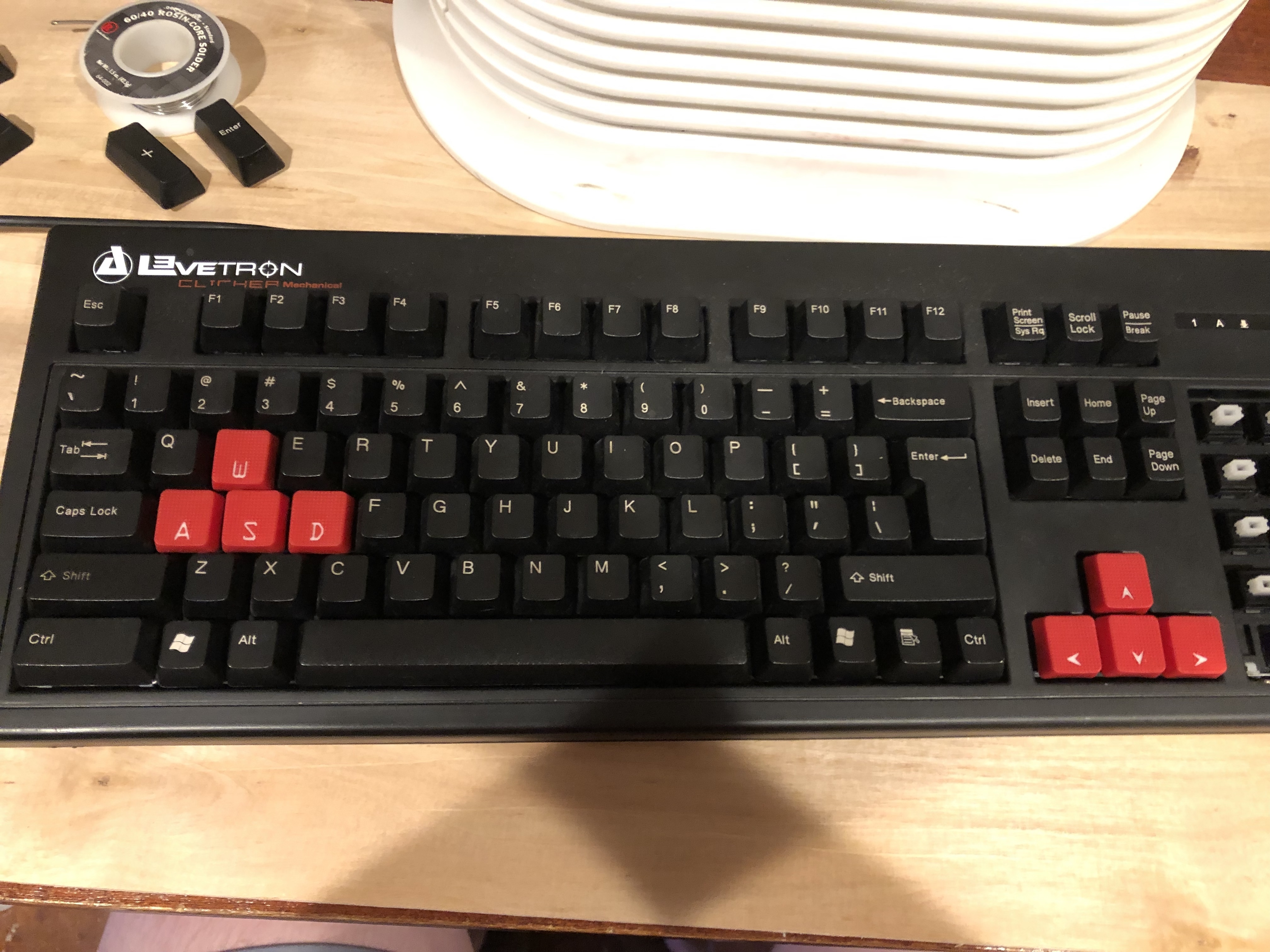

Hello all, recently I ran across my first mechanical keyboard again, the Azio Levetron Clicker. This keyboard originally came with the Tai-Hao Alps style switches, however after 3 years of heavy use and 3 more years of intermittent use, some of the keys began working incorrectly. Specifically, the D key and the E key were acting up and would not always trigger. Many of the keys had also seen a decrease in tactility, and because of this, in conjunction with testing out a Matias Tactile pro at a local Microcenter, I decided to swap the switches on this board. Below is some of the process, apologies in advance for not going more in depth.
The process began with the keyboard as I had it
Keyboard initially
Keyboard initially

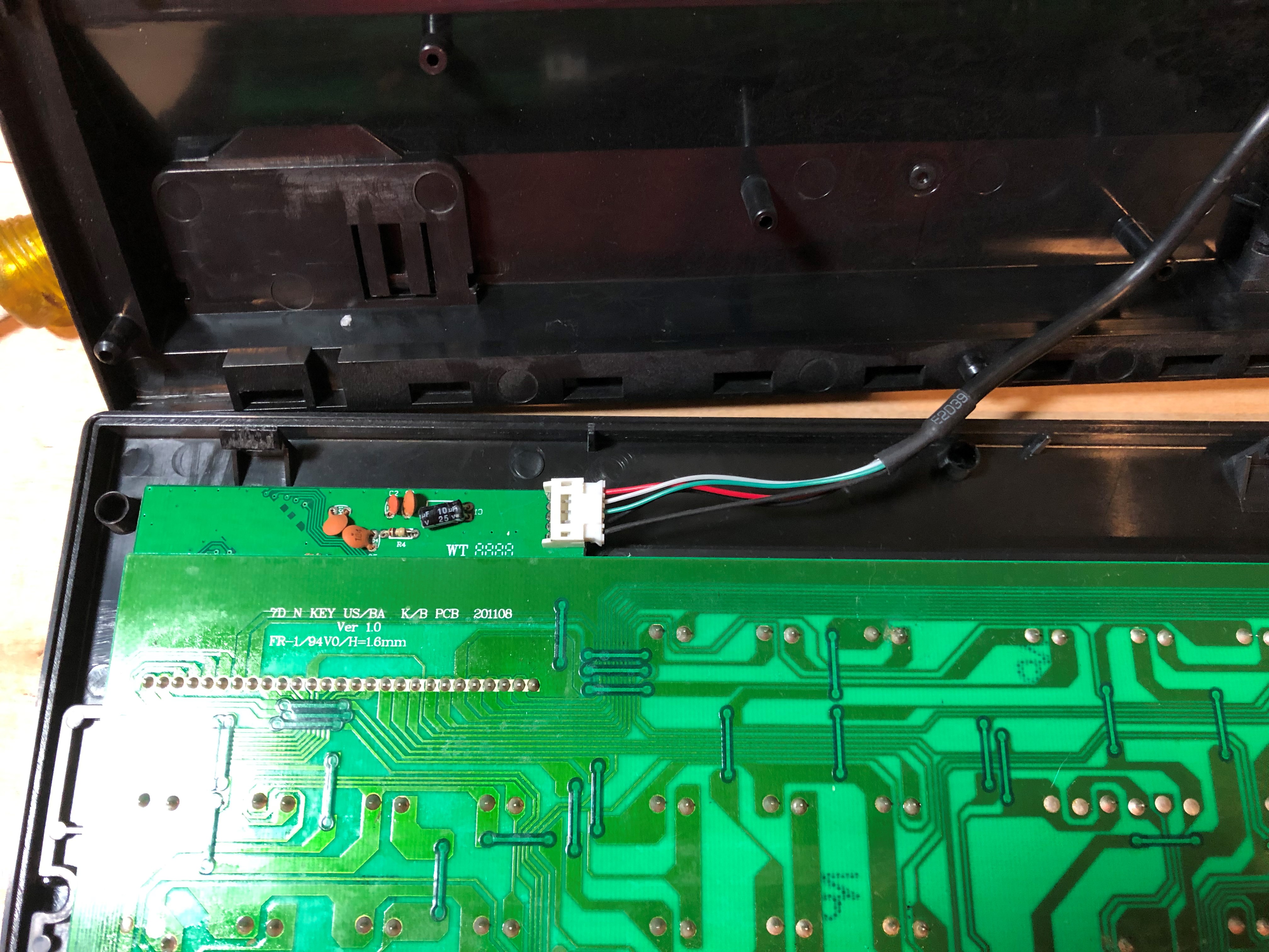

The keyboard opened using three plastic clips at the top of the case, which upon releasing revealed the controller
Opened case
Opened case

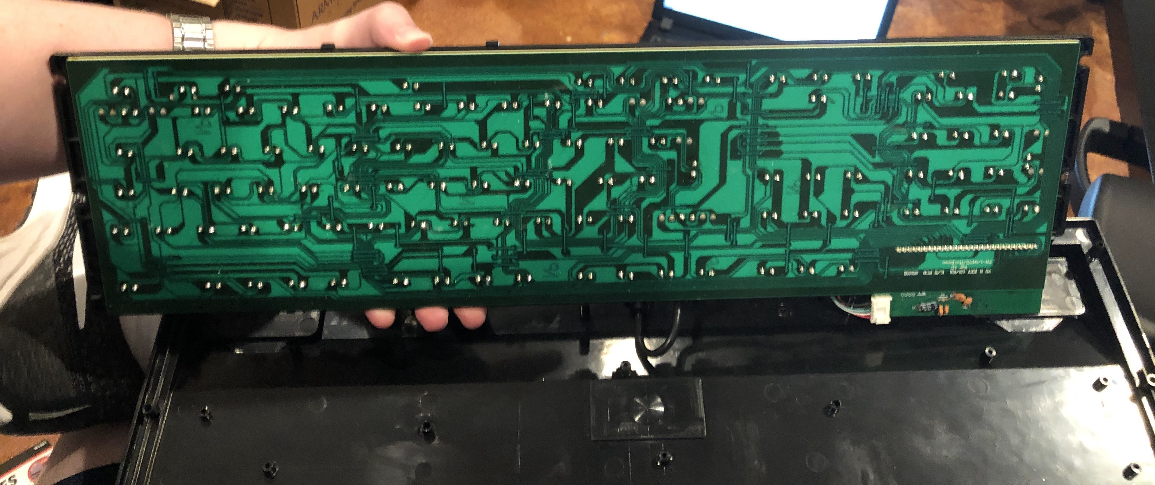

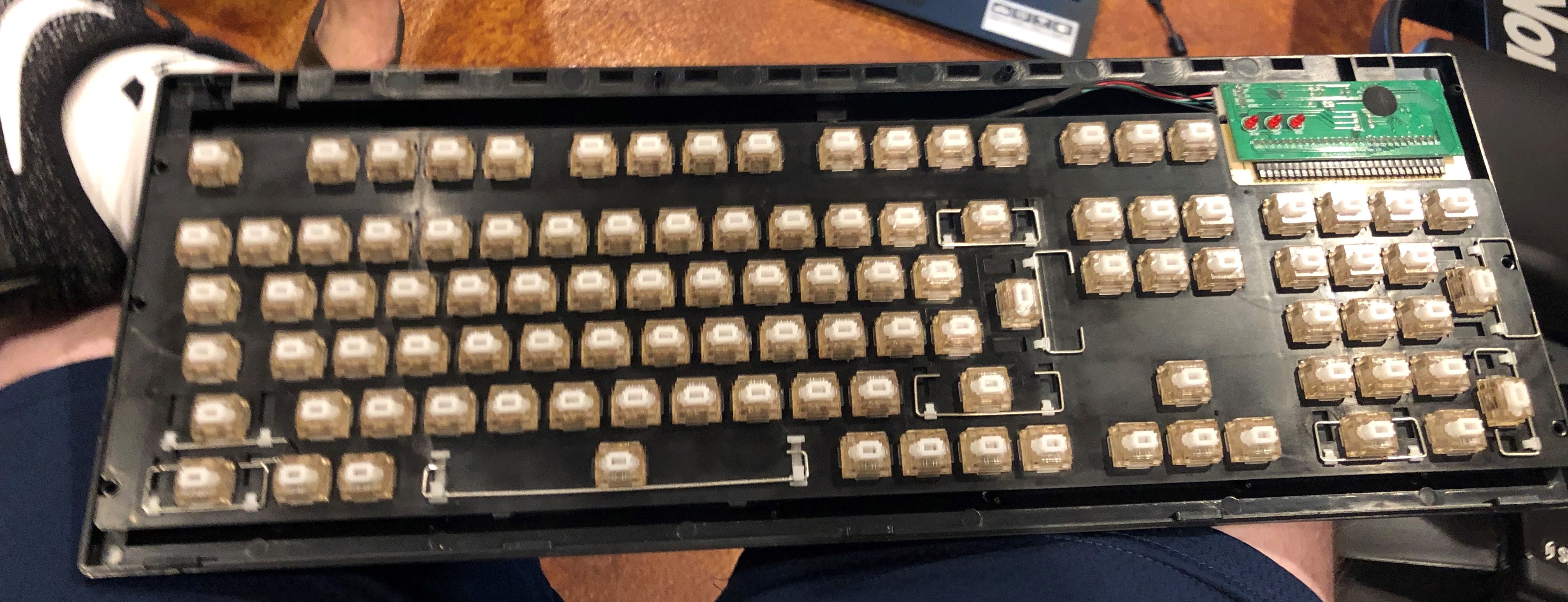

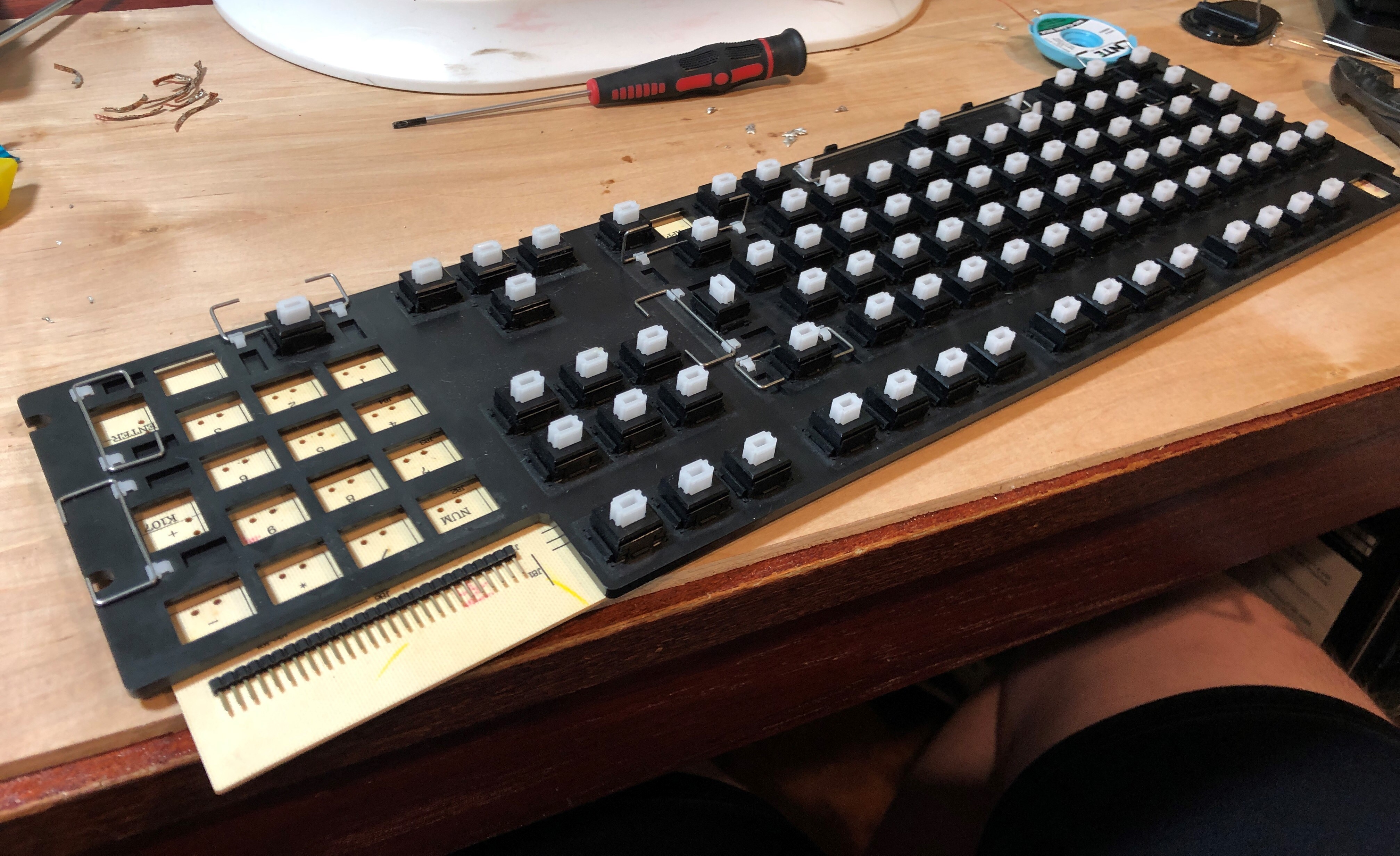

I began desoldering the switches, using desoldering wick and then gently removing the old switches from the mounting plate with pliers
Desoldering
Desoldering

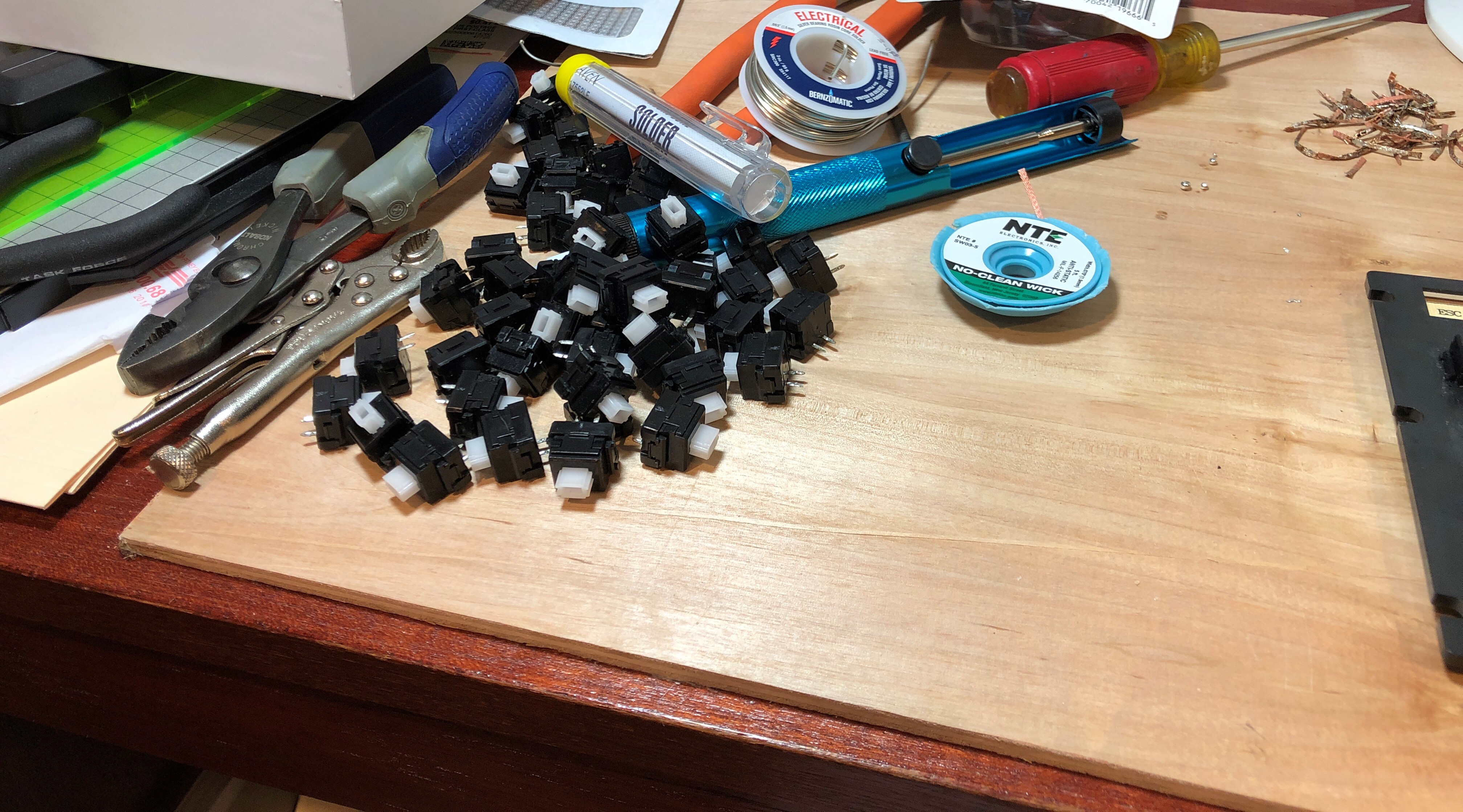

Desoldered switches
Desoldered switches
Unfortunately, I didn't get a photo of the bare pcb, but the plastic mounting plate was held onto the board by the switches alone. The PCB can be isolated from the rest of the keyboard pretty easily, since the micro controller slides off of the pins without any trouble.

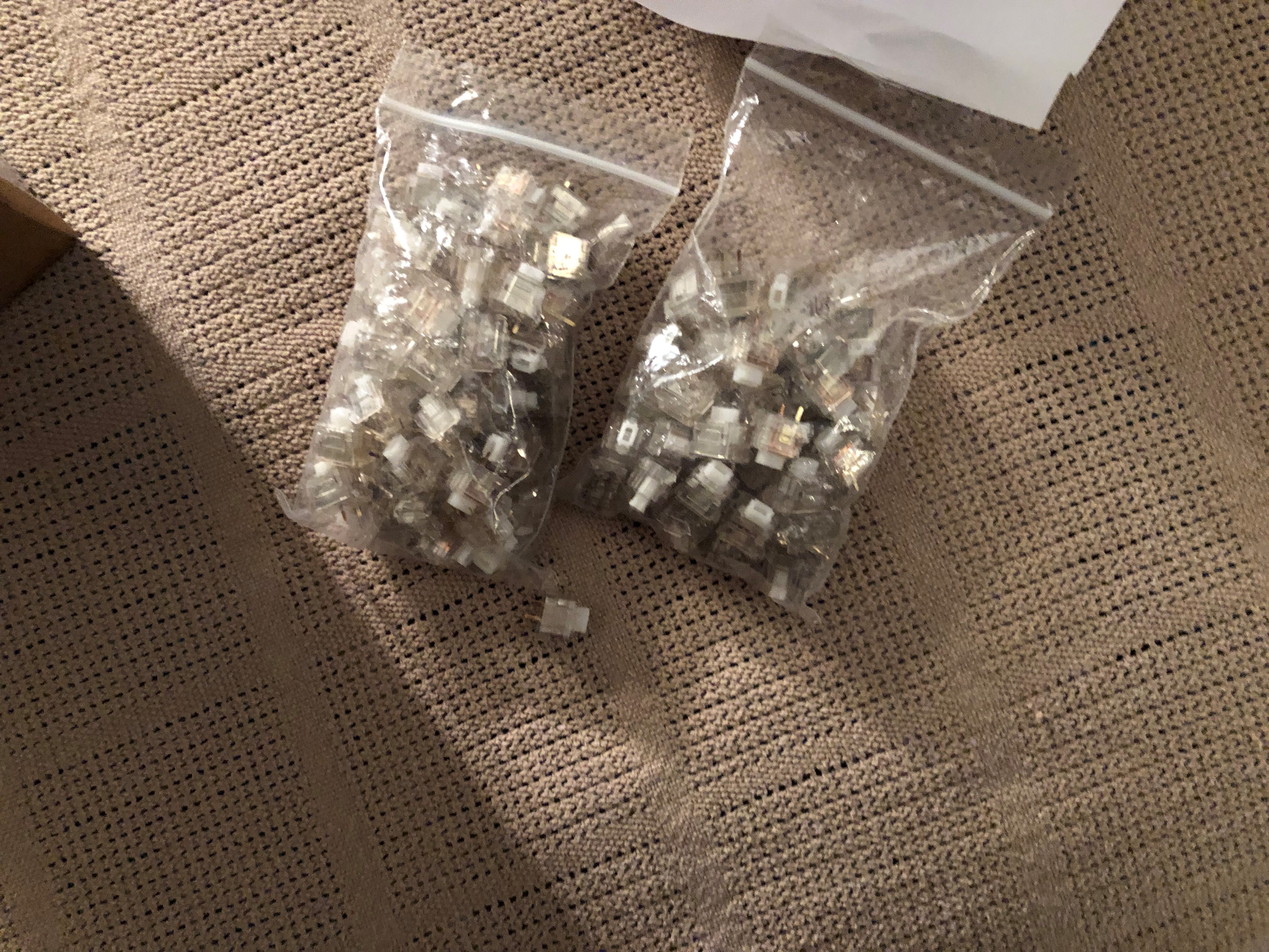

My Matias switches had arrived the day before, I ordered 120 switches in case I messed any up since this was my first major soldering project. Once the desoldering was complete, I checked the board for any stray solder and gave it a quick wipe with some rubbing alcohol to remove the grime that had built up over the years.
The switches upon arriving

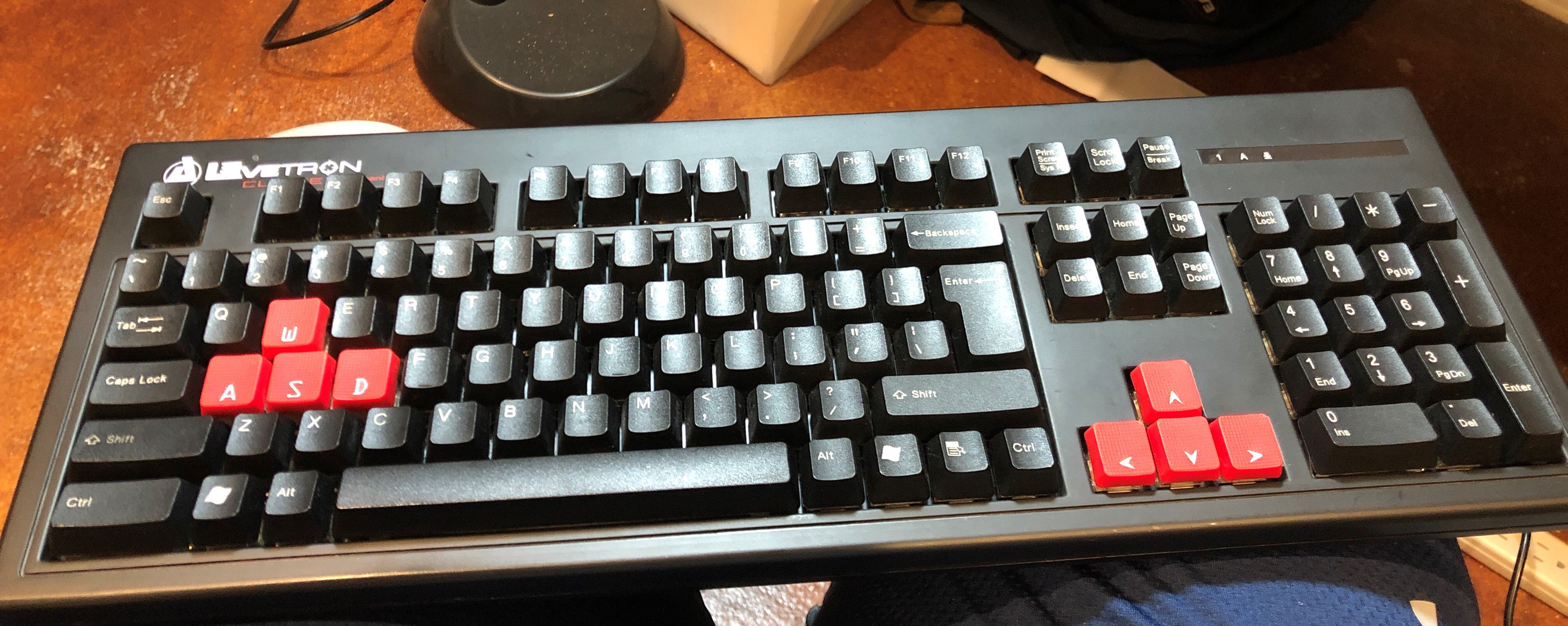

After all was verified to be in working order, I reassembled the keyboard and put it into my setup. This is now my new daily driver, taking the place of my Logitech G710 blue, as the Matias Click switches feel much nicer to me.
The fully reassembled keyboard
Overall, this was a rather fun first keyboard project, and surprisingly the new switches fit right into the board. The keycaps fit pretty well and although I might replace them with some others in the future due to the rubberized keys, they work well enough for me at the moment. If you happen to find one of these boards or have one lying around, they make for a pretty decent inexpensive platform for Alps style switches. I'm very satisfied with the new switches and look forwards to using this new keyboard more in the future!
