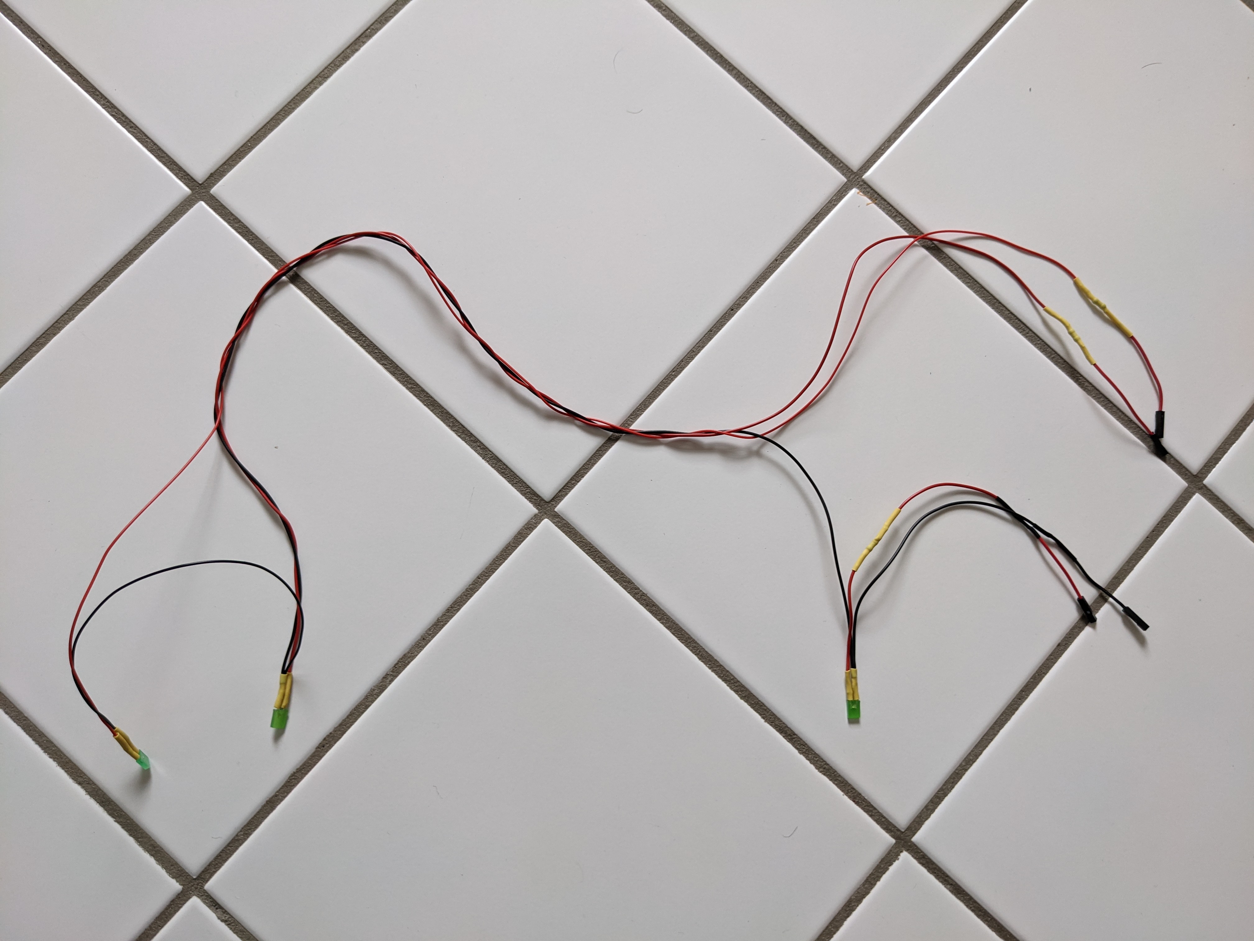

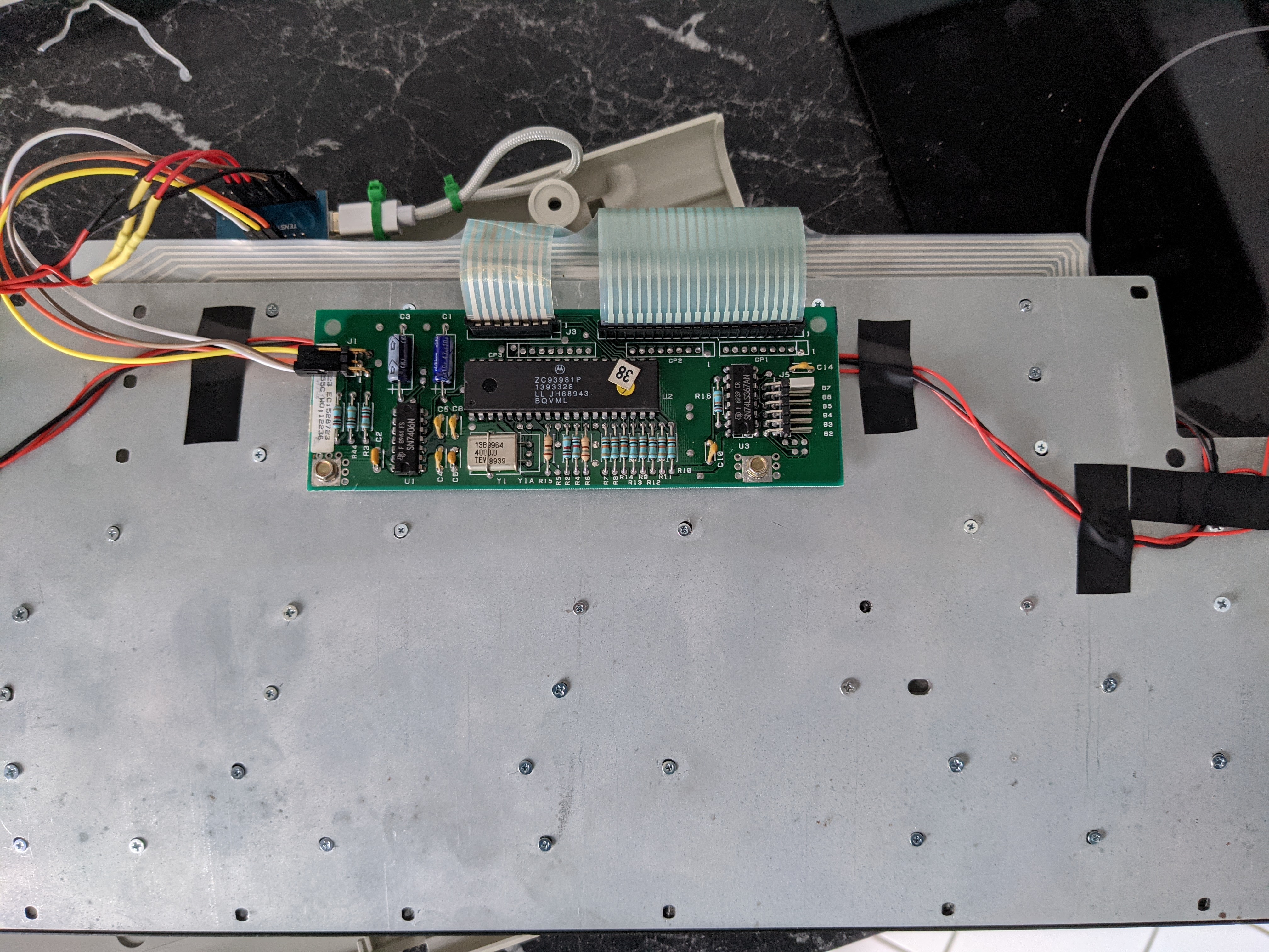

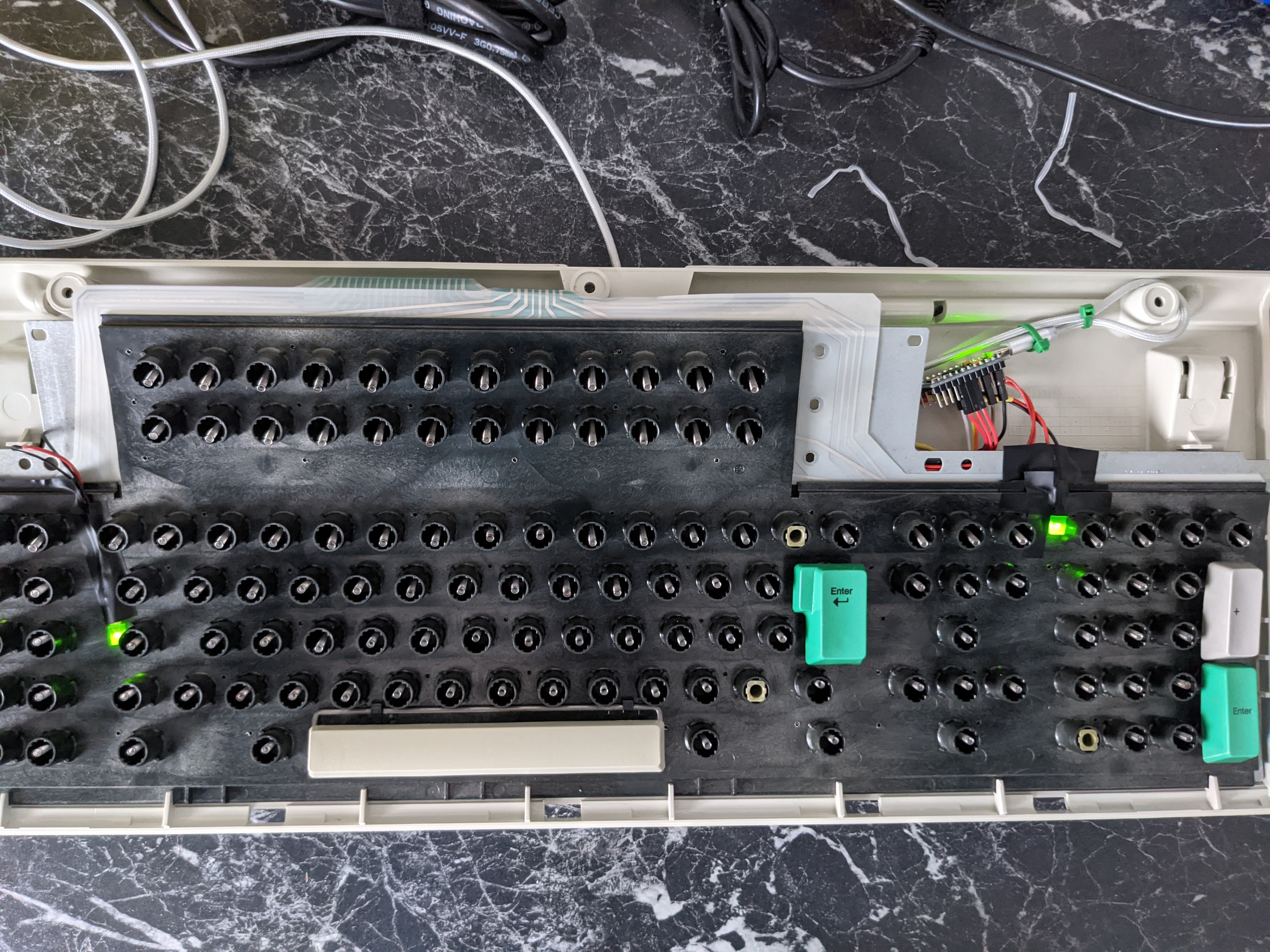

Today I have a free day so I could work on my M122. I've done a screw mod cause of some missing rivets and the need to change the single plus key to a double width one as on every number pad.
After that I soldered some kind of cable harness. Not the prettiest but it works. Partially assembled and a quick test shows a working "LED mod". :P
