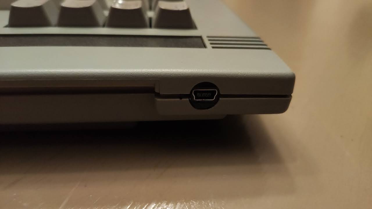

I've been filling my quarantine boredom with a lot of keyboard projects. With a couple exceptions, all of these have been fully run through, ultrasonic cleaned, sous-vide retrobrighted, lubed, plates repainted, internally USB converted, etc.
In roughly chronological order:

My PCB design
Apple M0110A
I got a NOS-ish one with Mitsumi switches but was pretty disappointed in them. Robbed the guts from an SKCC model and got a PCB design from a guy on GH.

Unicomp M
This had been through a couple rain storms and unfortunately there was a bit of rot on the membrane.
Protype
Also rained on before I found it but luckily there was no corrosion. It speaks a non-standard serial that didn't want to play nice with hardware UART so I went with a controller swap. The IC was the same footprint as a Teensy++ 2.0 so it turned out pretty tidy.
Also needed a normal-ish layout quieter board for the office.
Filco
Came with knockoff Alps that were pretty bindy and didn't have the nicest tactility. Threw in some Matias quiet clicks that get the job done.

jsheradin
27 Nov 2021, 19:05
hellothere wrote: 27 Nov 2021, 18:40 Hey, someone else did a Wyse 60!
Did you use a Soarer's WYSEverter or something else?
WYSEverter indeed. There's just enough room inside to cram a controller and a USB extension cable.

You even lubed the 2645 ITW magnetic valve switches? how about the keyfeel after? I think it should be good enough for the long travel switches before that but curious about the result also.
jsheradin
28 Nov 2021, 03:02
John Doe wrote: 28 Nov 2021, 01:24 You even lubed the 2645 ITW magnetic valve switches? how about the keyfeel after? I think it should be good enough for the long travel switches before that but curious about the result also.
They're pretty long travel with a stiff spring (something like 80g I'd guess) but being so tall they bound up easily. I was very sparing with the application and they turned out great IMO. It completely eliminated the binding and squeaking that it had.
I have another one of these boards (part of a complete 2648A terminal) that is almost unusable with how much it binds despite looking decently clean. The squeaking is hilariously loud too; board honestly sounds like a bag of mice.
