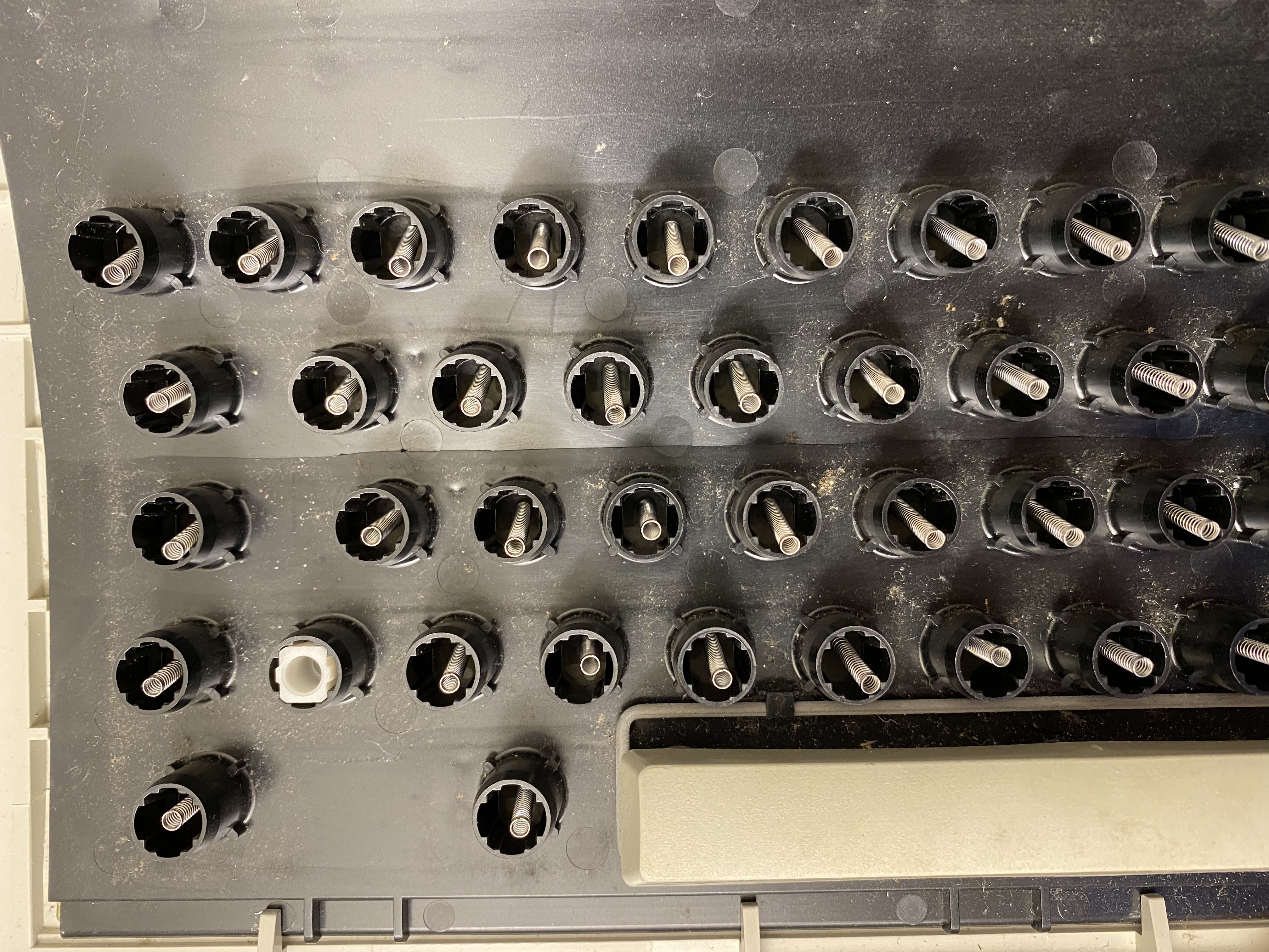

25 Jun 2021, 16:26
E TwentyNine wrote: 25 Jun 2021, 15:30 If the crack is that bad it's possible the rest of the plate is just as fragile.
I think you're on to something there. The crack itself doesn't go all the way edge to edge yet, but it looks as though there are a few others that dream of being cracks when they grow up... Kind of leaning toward replacement at this point.

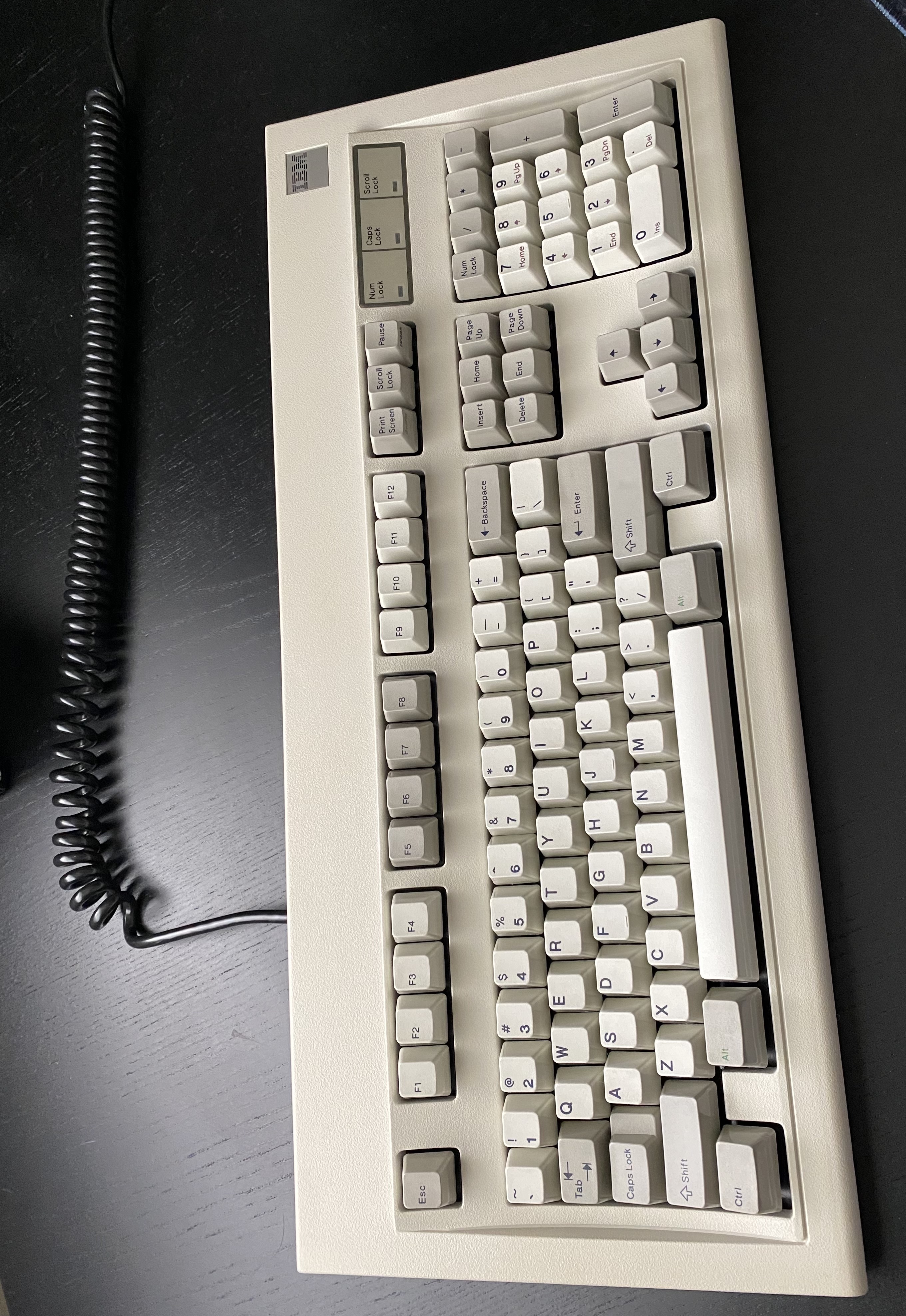

Really appreciate everyone's suggestions and information. It was very helpful to know that Unicomp would just stick a new sandwich in my case (don't want) and that the new barrel plates would require janky stuff or replacement of my beautiful wire stab keys with janky Unicomp keys.
I was particularly inspired by these quotes above to try to do this as cheaply as I possibly could. I decided to use the 1/16" drill and M2 flat head screws I already had rather than buying a 1.5mm drill bit and M2.2 screws. I had a box with M2 x 4, 5, 6mm which turned out really convenient. I used the 4mm in the very bottom row of holes, 5mm above that, and 6mm in the middle, which helped me to grab the barrel plate despite the depth of the plate curve. I figured the rounding error of difference between these and the ones referenced in the forum wouldn't make a difference and I was right.
The old blanket was in good shape so I decided to use it. Needed some painter's tape around the edges of the plate to hold the blanket snug while I got everything lined up. This was easy enough to remove even after everything was reassembled. I had to do the bottom section a couple of times because I'd knock a flipper out of alignment or forget that some of the holes don't need flippers because that's where wire-stab keys go. Eventually I got the bottom to be ok.
The top half of the barrel plate was slightly challenging because the break was right on the thin section with the most curvature. Eventually it ended up not quite perfect but close enough. I used my handy dandy Model M opener to push it down into place and then went over the crack a couple time with Testors sniffing glue and a tiny paint brush. I did the same on the section where a crack was forming to reinforce for the future.
I tightened the screws just to finger tightness and that seemed to be fine because all the keys worked just fine and feel perfectly even on the first try. One thing I discovered in this process that was that each flipper had a unique number on the top right side of it. Don't know why and I can't recall hearing about this before.
IMG_0730 copy.jpg (2.38 MiB) Viewed 6585 times
Again, thanks for all the help for a cheap restore!
Filthy old Silver Badge: $104 including tax/shipping
Restoration materials: $3 for sniffing glue (plenty left over to get high with)
5.5mm slim driver: $7
Parts/tools on hand: sunk cost; no new expense
Total: $114 and I'm very happy with that!

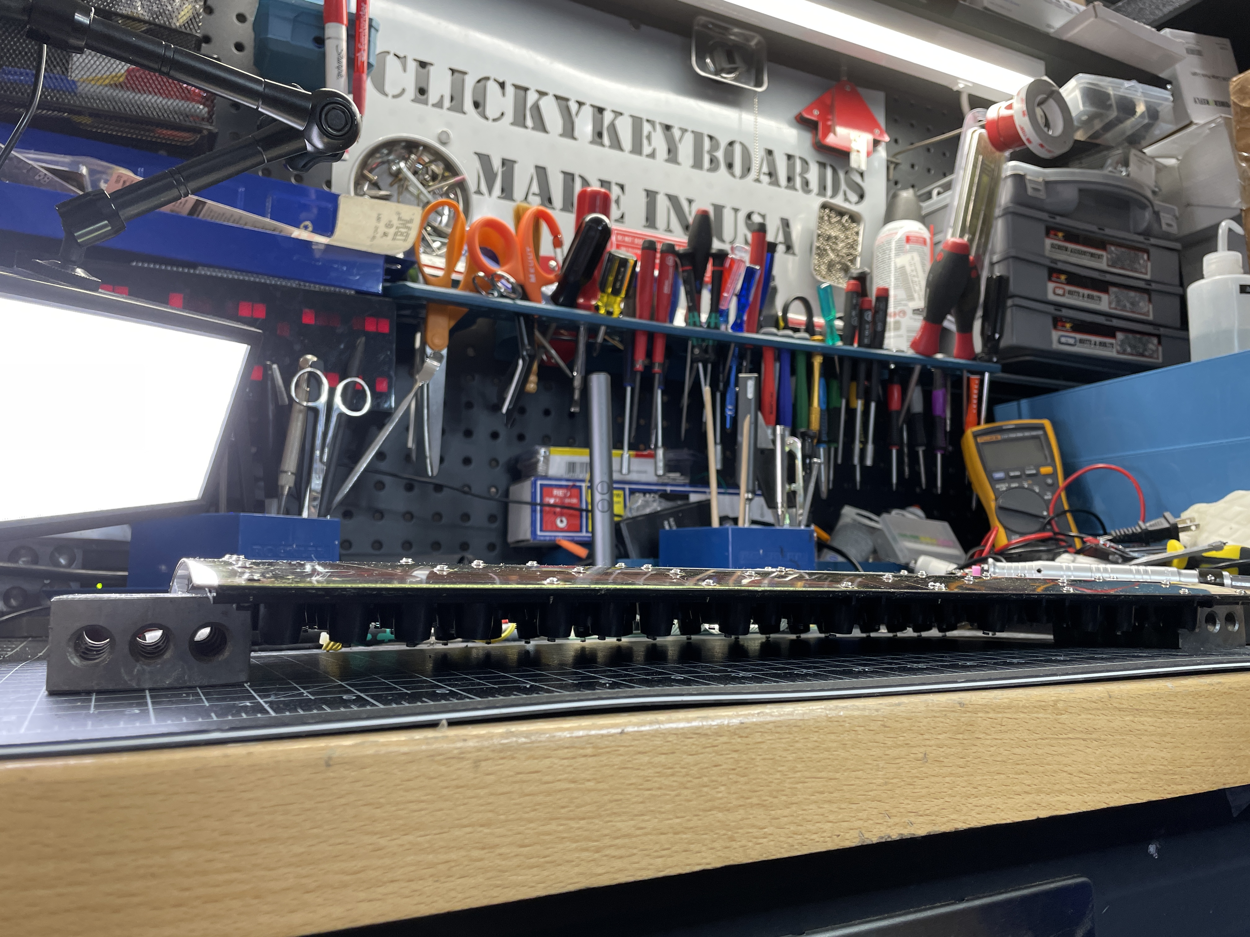

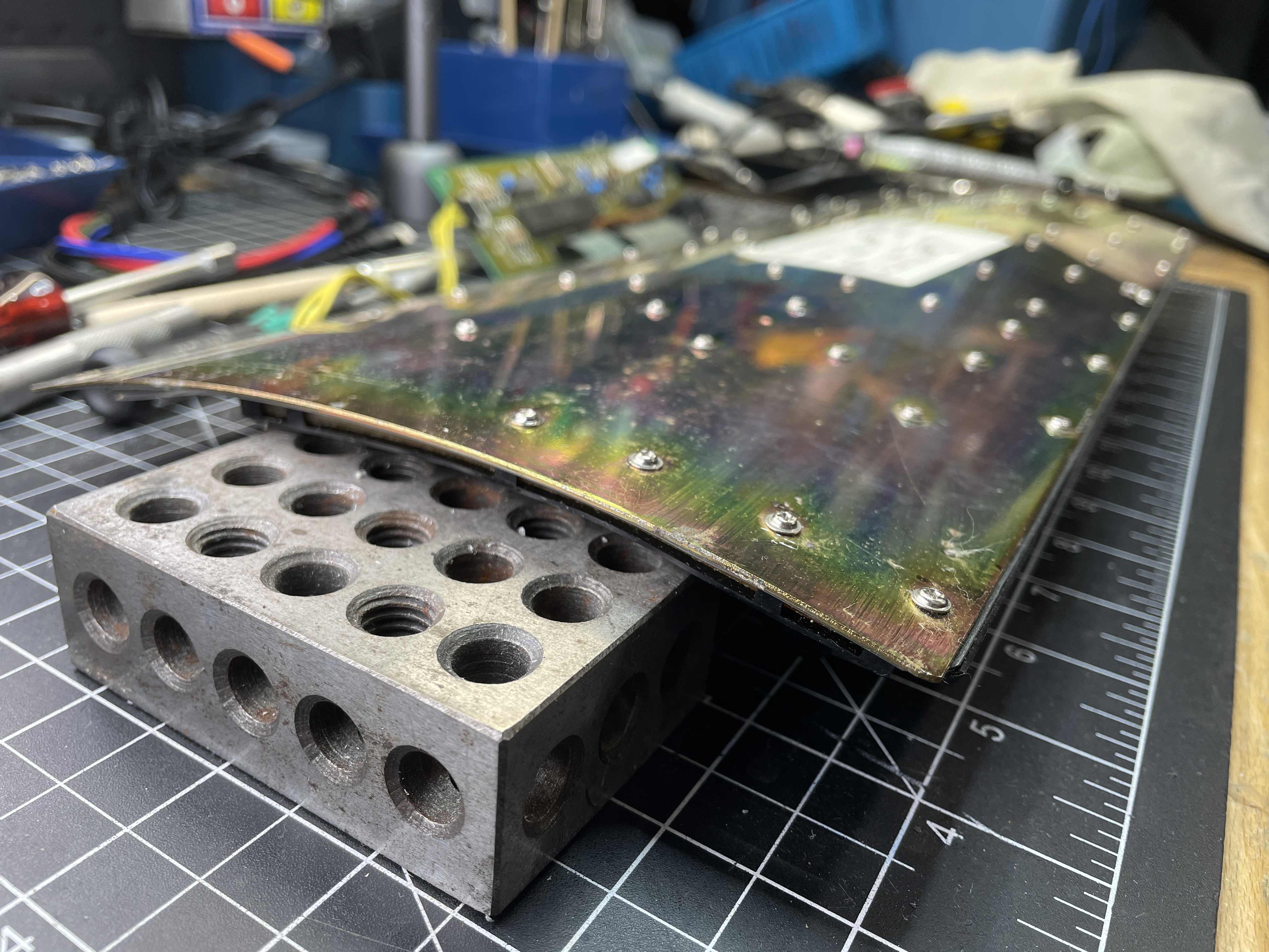

29 Jun 2021, 15:09
Another variation on a theme.
1-2-3 steel blocks (16 oz, .45kg/each) work well to elevate the internal model M keyboard assembly.
The small steel blocks are dense and heavy enough to keep the frame parallel and flat to the workbench and to prohibit excessive moving during mechanical drilling and reassembly.
