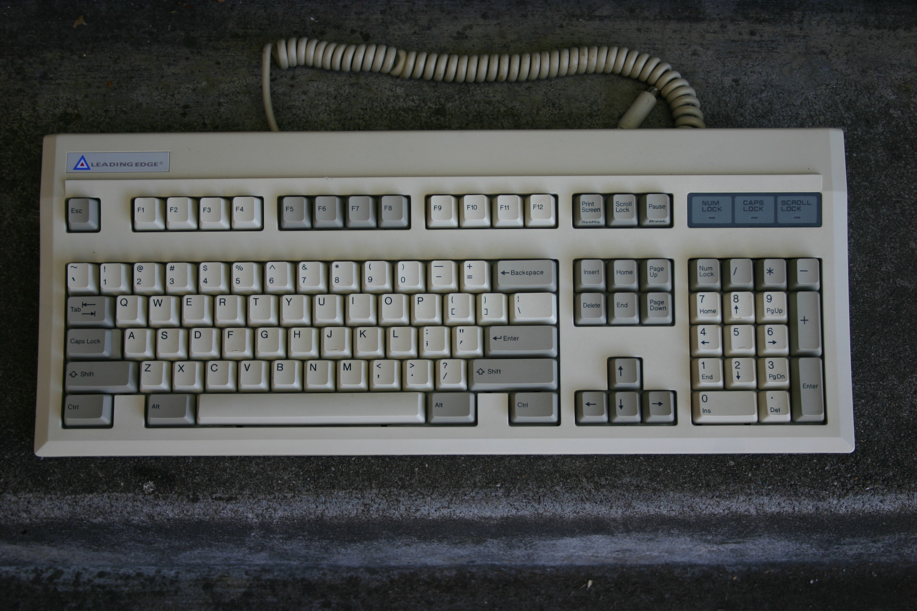

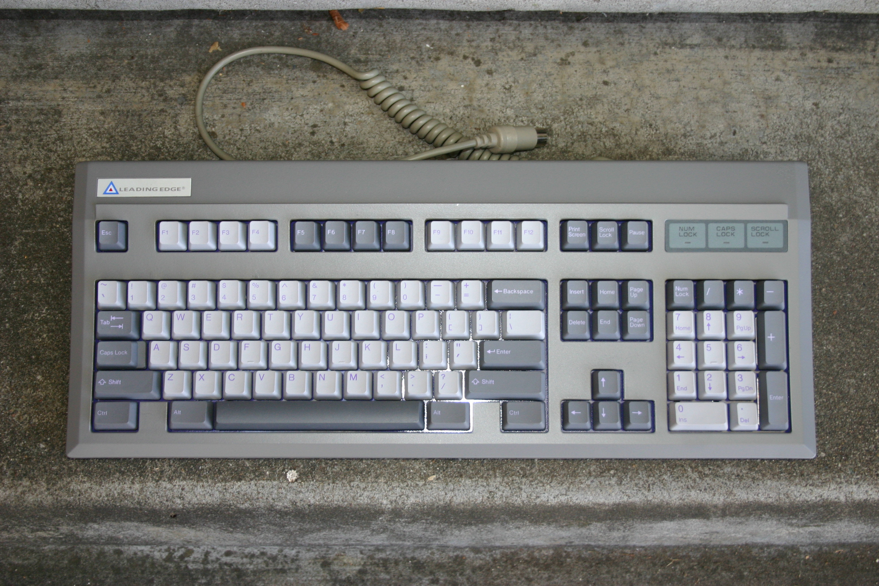

I've been patiently looking for a Futaba keyboard with a decent layout, and finally found one, a Leading Edge AK-1012. I had one of these previously, but I wore the legends off the caps. Surprisingly this one has double shot caps. I'm a careful ebay shopper, but it still takes a bit of luck to find a keyboard that's immaculately clean inside. This one has zero shine on the caps, zero rust or dirt inside, and just a bit of irregular yellowing on the edges of the case. I doubt it has ever been used. The switches are uniform and very crisp. And it still had the protective clear sticker over the badge.
The case on my other one is less yellowed, so that's an easy fix. But since it still works perfectly I don't want to toss it. So I'm thinking of painting the yellowed case and finding a set of aftermarket MX caps to replace the originals. Which brings up the question, does anyone know of a set of MX caps with the big step on the CapsLock and 1.5u Ctrl and Alt caps? I don't know a thing about MX stuff, or even where to look. I'm wide open to color. Note the difference in the CapsLock caps between the two keyboards. The one I'll need is the version with the bigger step.
AK-1012 like new inside
CapsLock on the one I owned before
AK-1012
AK-1012

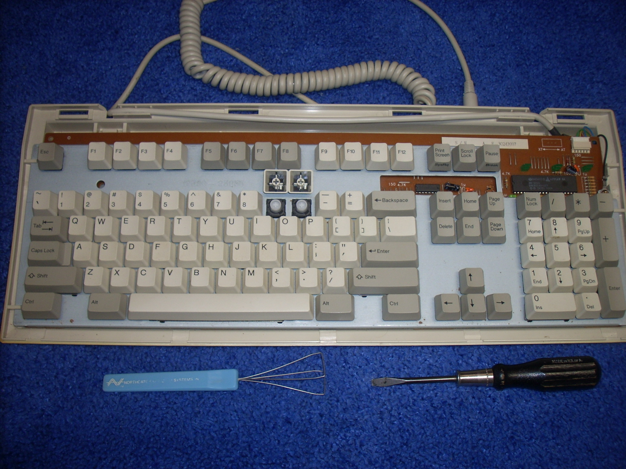

I will probably have to keep the spacebar; thanks for that suggestion. I opened up the two keyboards and there are a couple surprising differences. First, one spacebar has the guide post on the left side, the other is on the right. Second, the plate on the double shot one has a wide slot for the CapsLock switch in either position, while the other one will only take the switch in the "MX cap" position. The PC boards on both have pads for the Caps Lock switch in either position. Cases are the same, so swapping things around to make one stock and one custom is still a possibility as long as the keycaps stay with the matching plate. But I'm still unclear on the stabilizers.
From what I've been told the stabilizers on aftermarket MX cap sets could be one of several types. I'm mostly familiar with Alps, and getting inserts to fit the MX slots isn't a problem. But I've been told that some cap sets take Costar-type stabilizers, and I don't think I can use those because the 1012s don't have slots in the plate for those. So...how can I tell which type of stabilizers a particular aftermarket MX cap set uses?

Cases swapped. Result--one very clean AK-1012 with an unyellowed case and double shot caps. The other awaiting a painted case and custom caps.

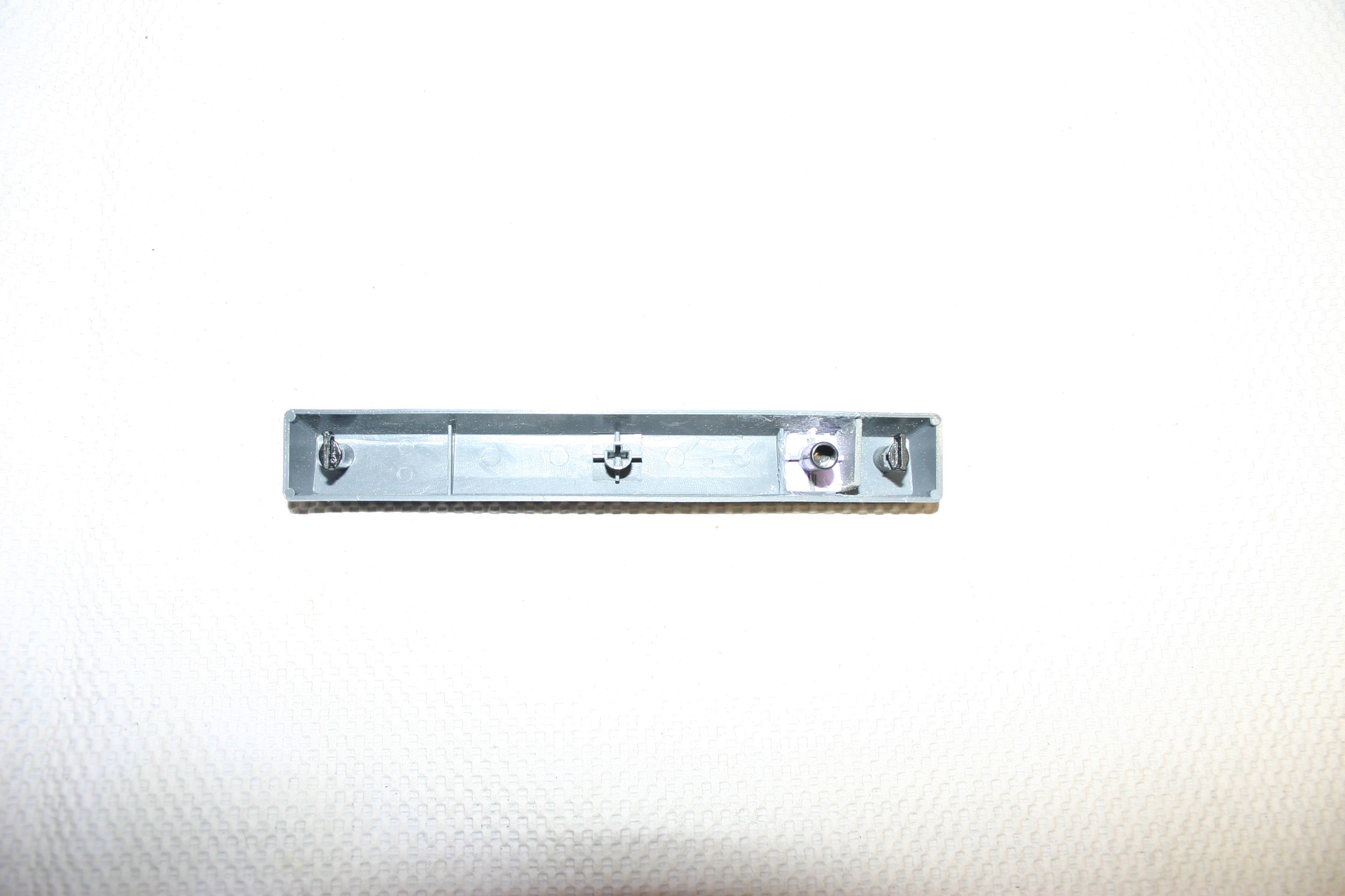

Looking closer at the stabilizer pin on the original Leading Edge spacebar it fits into an MX mount. So I'm thinking I can carve down one of the "extra" MX caps from Tai Hao and glue the mount part to the bottom of the new spacebar in the right place and make it work. The original stabilizer wire has the right spacing for the new spacebar and the other stabilized caps "should" all work with new (MX) inserts, which I have here someplace.
So...I need to glue the MX mount onto the new spacebar (I'll practice on one of the extra ones first) and dig out the inserts for it and the other caps. Paint the case (Duplicolor probably) and it should be good to go. We'll see. Thanks to all for the help and good advice.
edit: If anyone's still reading this I was curious about what glue works best on PBT? I've glued ABS with ABS plumbing cement with great success, but I don't know if that would work on PBT?

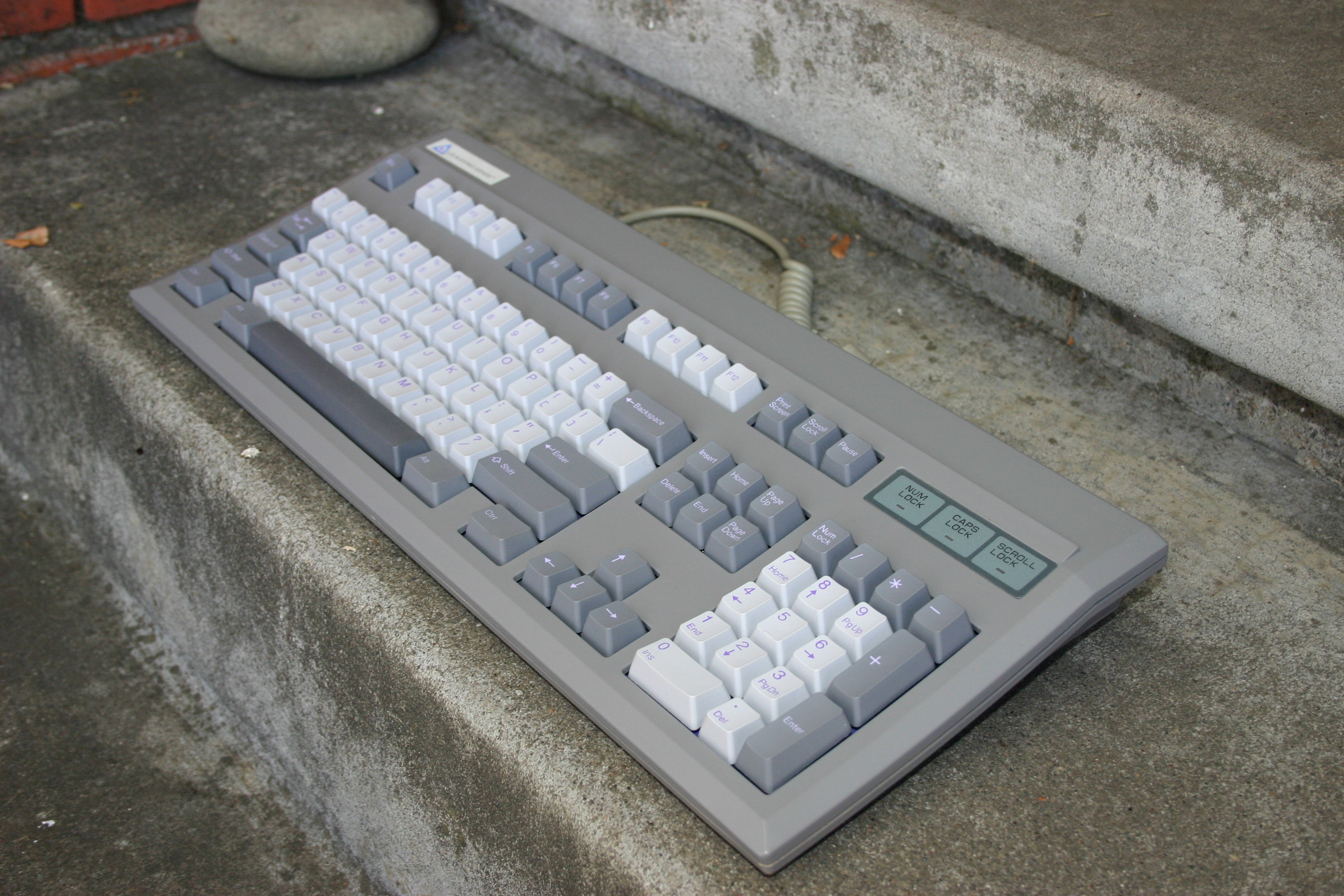

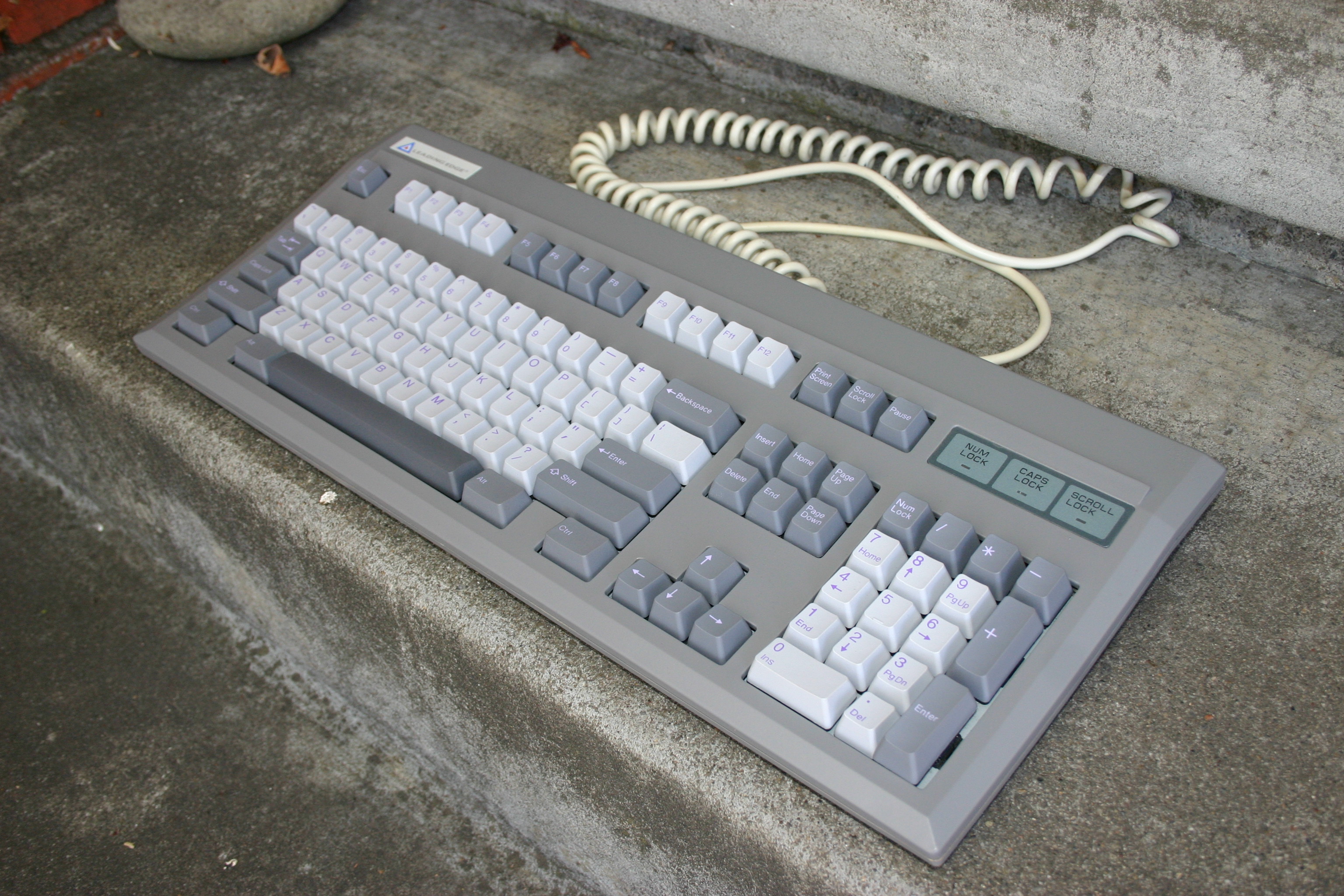

Latest: The yellowed case is painted, caps installed, back together and working nicely. The guide pin on the spacebar actually fits into an MX cross mount, so I carved down one of the extra caps from the Tai Hao set and glued the stub to the bottom of the spacebar using Loctite 454 plastic gel adhesive. One chance to get it in the right place (I didn't practice on a junk cap first) but I got lucky. The stabilizer inserts are from a Monterey Alps board. Wires are the originals from the Leading Edge. Still to do - matte clear over the gray paint on the case, prep and paint the plate, and change the cord to a gray one. The spacebar looks darker in the photo (this is my "other" camera, my photos always suck...) than it does in real life, I'm good with that. Thanks to all for the help and good advice.

Update: The case is now oversprayed with two coats of Rustoleum matte clear. I'm hoping it protects the gray underneath. Regardless it really smoothed out the base coat of gray and improved its appearance, so I'd recommend the matte clear on that basis alone. Here are a couple outdoor photos. I need to read the book on my camera. Dozens of settings, most identified only by an unintelligible icon in the menu. I still need to find and swap a gray cable, and possibly sand and paint the plate, but otherwise I think I'm done with this one.

Thank you, I'm very happy with the results. I'd like to thank hellothere for suggesting the Rustoleum paint and the matte clear top coat, and Tai Hao for being wondefully helpful (again) in putting together the set of caps I needed.
The best part is that I saved two keyboards by making two good ones out of two bad ones. One had a badly yellowed case, but nice doubleshot caps. The other had a nice case, but printed caps with many of the legends worn off. So now I have the gray custom one, with painted case and Tai Hao doubleshot PBT caps, and a bone stock one with a nice case and doubleshot caps. Both with Futaba MA switches, of course.

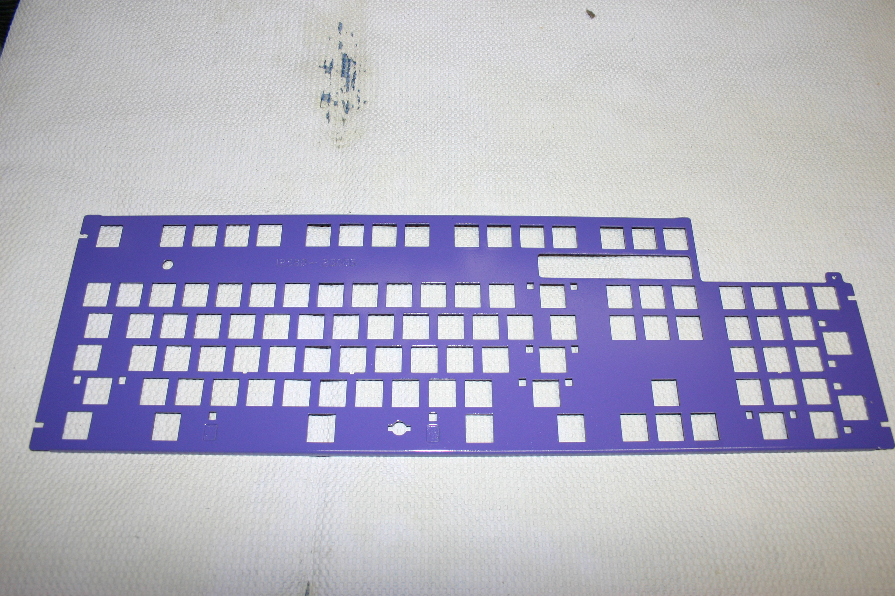

edit: Typing on the AK-1012, cable is now gray, all can sleep better now, including myself. (..to paint the plate, or not to paint the plate? I know, I'll paint it purple!)
Polecat
23 Aug 2022, 06:04
Just in case anyone thought I was kidding...
Also a shot of the keycap scrap glued to the bottom of the spacebar with the guide post installed.
Apologies for the crappy photos, and thanks to my old friend //gainsborough for inspiration on painting the plate!

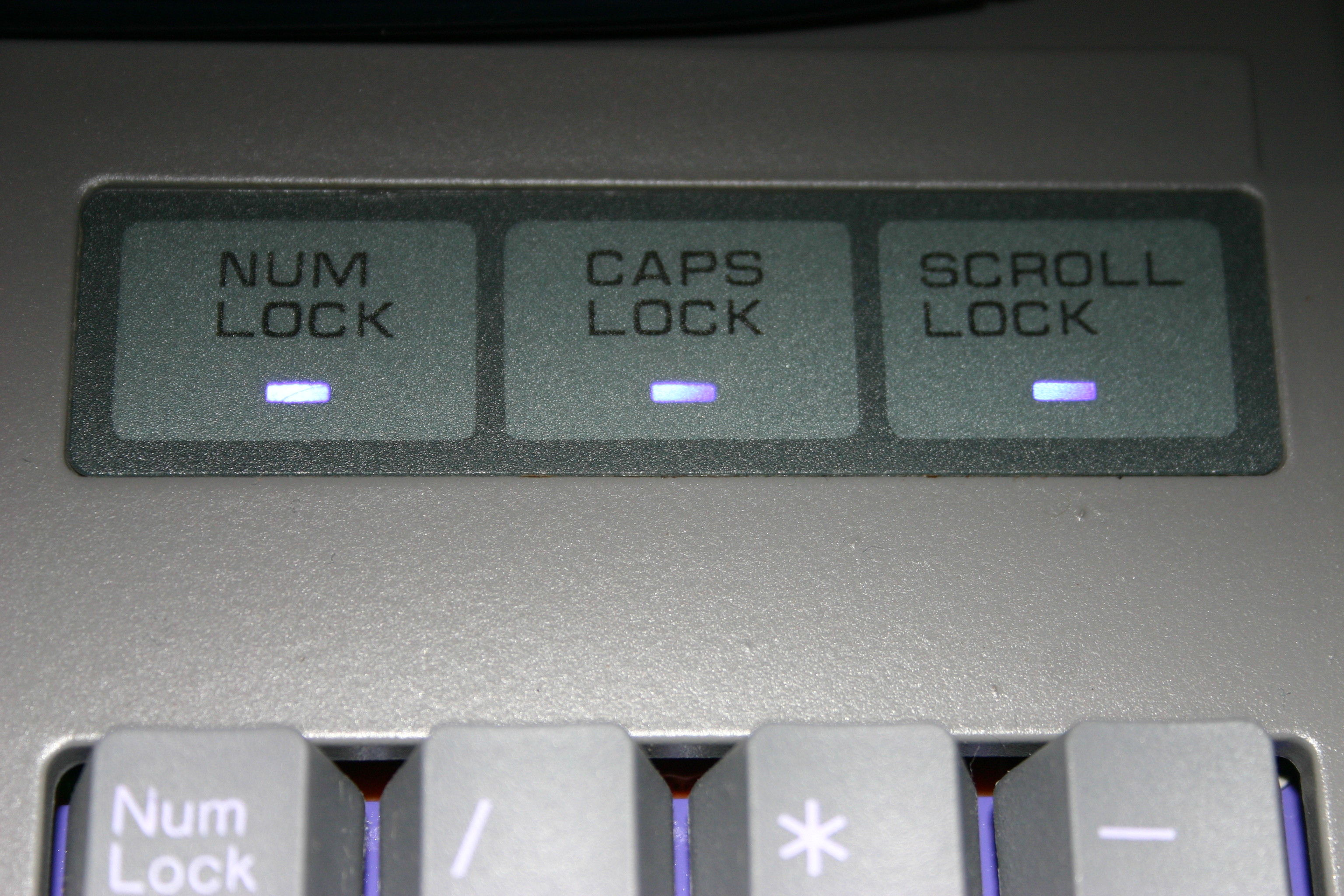

Next comes the purple LEDs and reassembly of the caps and case.

Purple LEDs, purple plate, gray cable, done. I learned about MX cap sets and stabilizers and gluing PBT from this one. And using matte clear as a topcoat on a painted case, but I won't have long-term results on that for a while yet.
