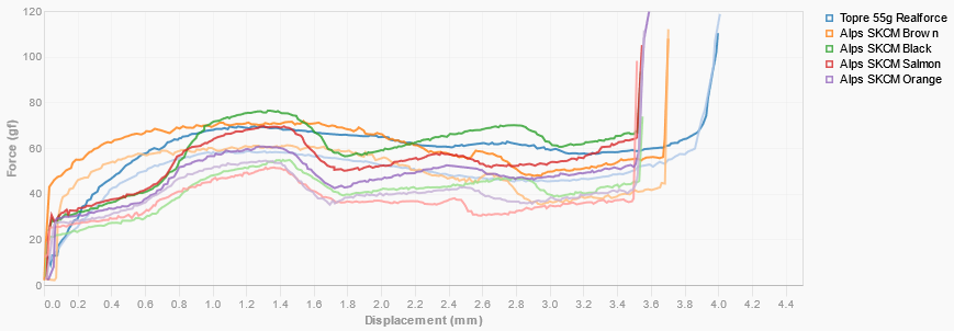

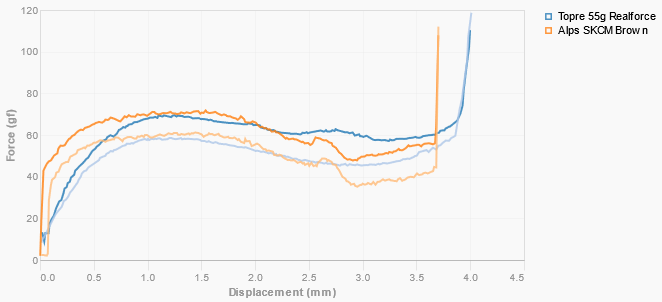

Their force curves seem to bear this out as well. I just compared against 55g Topre on a hunch because they seemed pretty comparable just from memory.
55g topre vs skcm brown.png (34.11 KiB) Viewed 14215 times

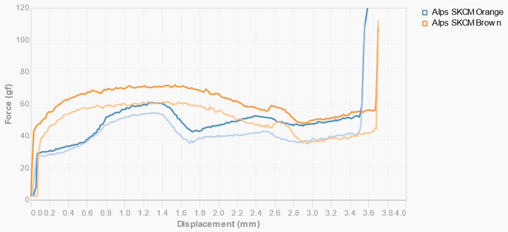

Later tactile Alps have sharper curves.
55g topre vs skcm tactiles.png (73.75 KiB) Viewed 14215 times
I actually prefer that since it makes them a little more unique, but to each their own.
