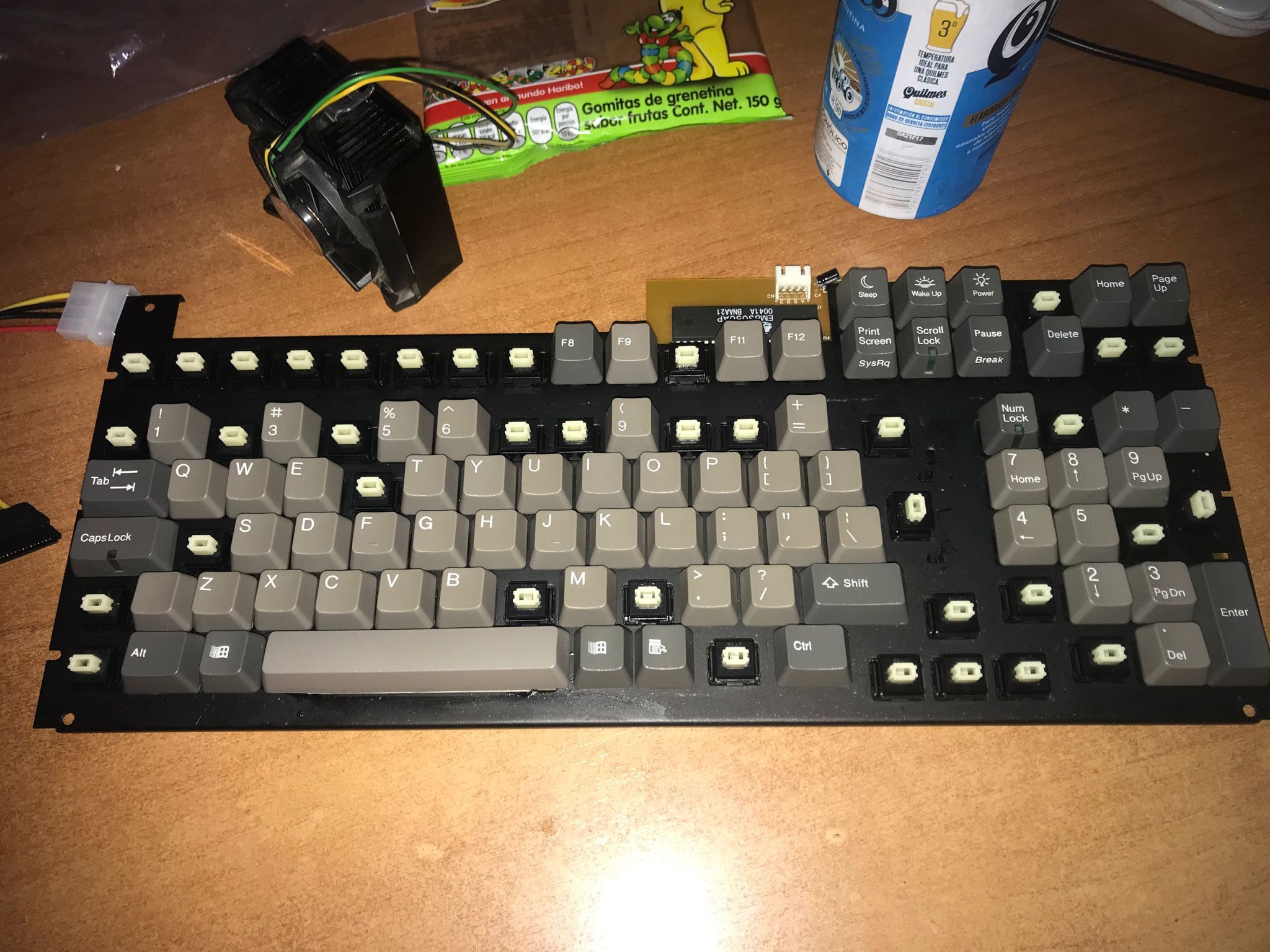

Hi,
A few weeks ago purchased an old portable computer to restore it and convert it into a retro master race pc, but has been all bad luck it arrived wasted in the post and the case required a lot of glue and fixing and other issues.
But to make things worse the keyboard that looked ok resulted in being in very bad shape.
From what I found on the wiki the switches are Alps White SKCL.
Lots of keys have a wrong feeling they take time to move up after being pressed and were bindy, but all of them activated and clicked so the first thought was that some kind of dirt or gunk was in them so I washed the keyboard in hot distilled water using a little detergent and rinsed it well after.
While the keyboard was wet all keys feel ok so I was very happy with the result, but 3 days later when it completely dried up and tested, 80% of the keys feel bindy and will feel wrong when clicking.

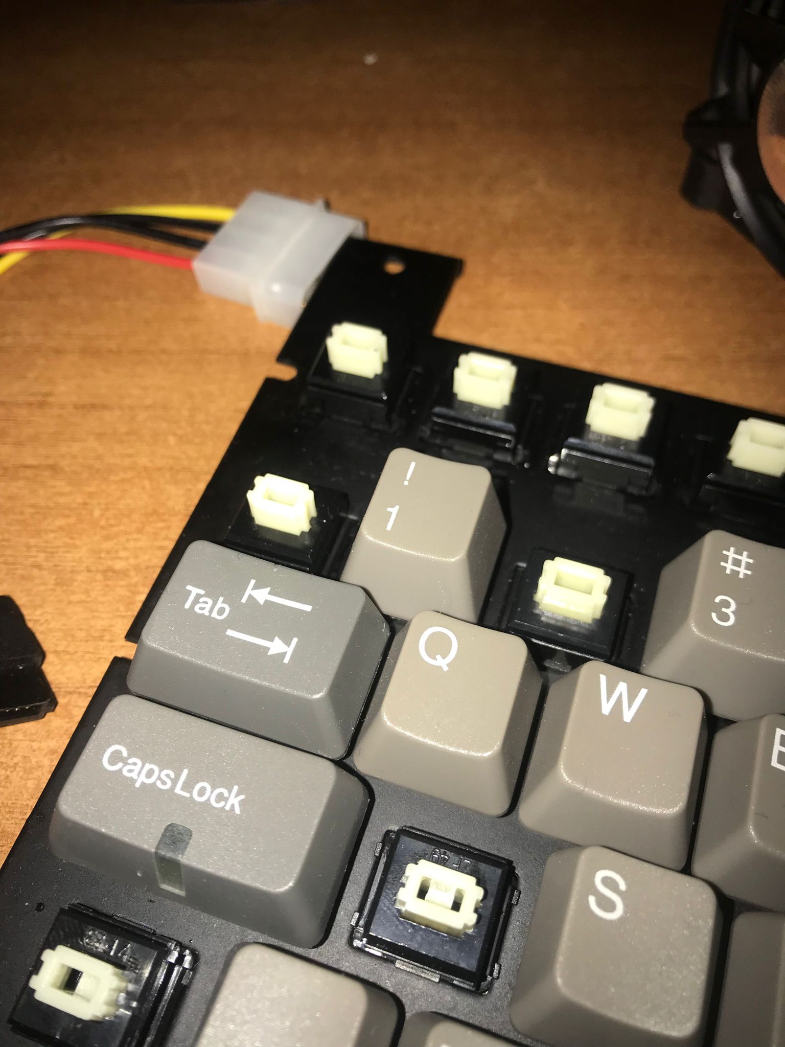

In the picture removed the keycaps from the worst-feeling keys but they are even more that feel bad.
Now looked on eBay for replacement switches and they are expensive from my calculations have to purchase like 50 switches to replace the bad-feeling ones and this is expensive!
So looking on the net found some threads that talk about lubrication inside the switches and that by cleaning them remove the lube and make them bindy.
So added white lithium grease to a couple of them and magically they started to work fine! :D
Before continuing to mess the switches up need to ask what is the issue here and if the lithium grease is the correct "fix" ?.
Any information will be helpful.
all the missing keycaps are bad feeling keys.

Be warned that those are not Alps switches, they're "4 tab" clones of some sort. Based on the keycaps I'd guess Tai-hao. If you're planning on wax boiling you need to be careful about temperature since they might melt at a lower point than actual Alps. I'm not sure anyone has tried those before so you might be the guinea pig. I've tried just about everything on a wide variety of boards and wax-boiling is consistently very good.
I think wax+wet lube is the current meta but just wet lube (such as white lithium) is fine as long as it feels good to you.

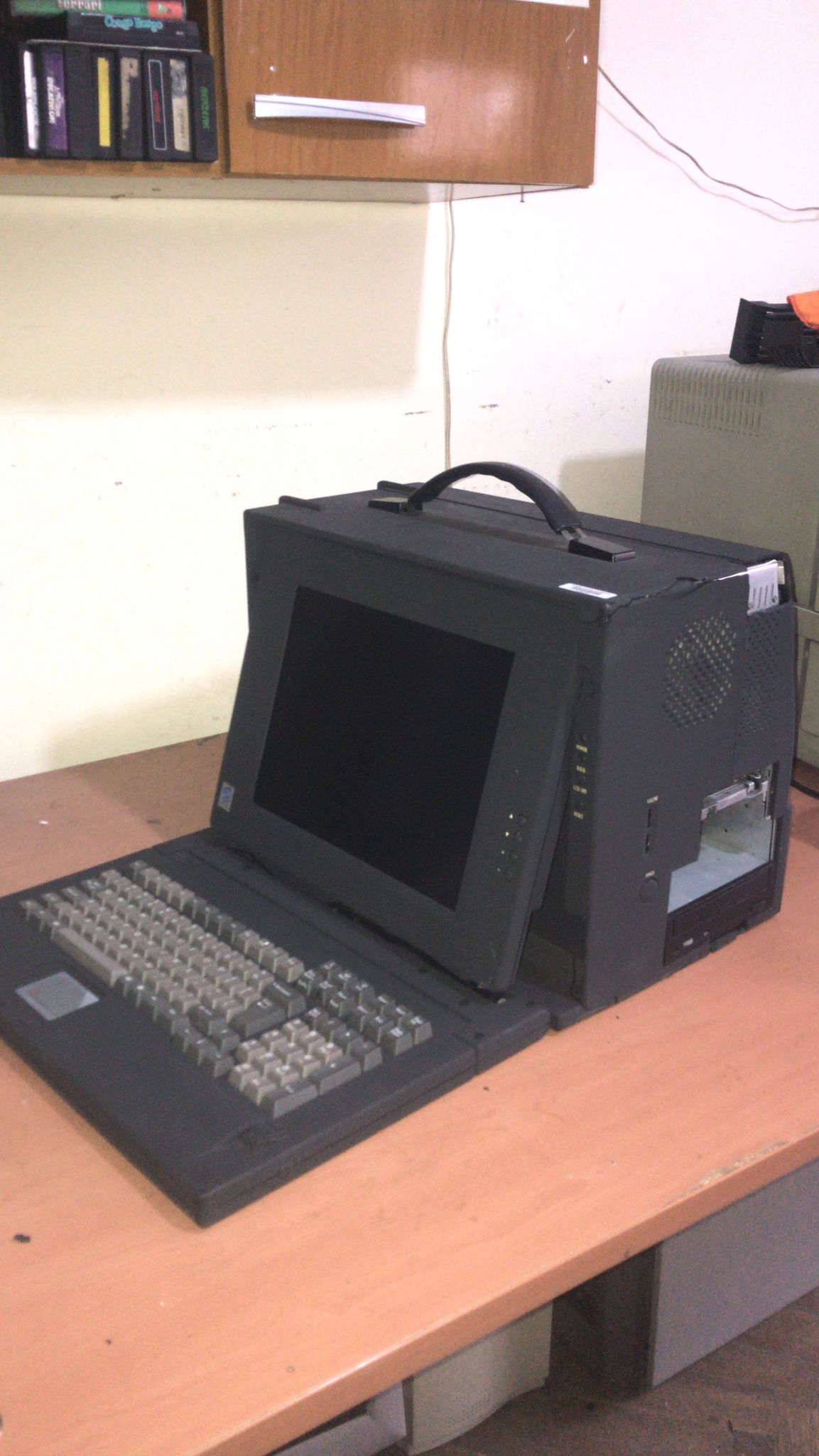

browncow wrote: 02 Jul 2023, 10:22 how's the computer itself? it looks like something from Dolch, judging by the colourscheme, did it come with some guts or just the case? It's very interesting, what are your plans? Also the board is quite simmilar to an alps clone 19" rack board i got. I wonder if same company made these boards.
There's no branding on the luggable, the computer is complete but nonworking purchased it for a project. But started badly the computer arrived having heavy damage during transport and has been fixing the case that was all broken.
The touchpad doesn't work, and the screen is very dim seems to be very used, ordered a new LCD display and controller touchpad power supply (almost all the guts are going to be replaced).
Going to install a dual Pentium III and 2 voodoos that I have in SLI.
Have done this to another 3 similar luggables, and is a lot of fun.
