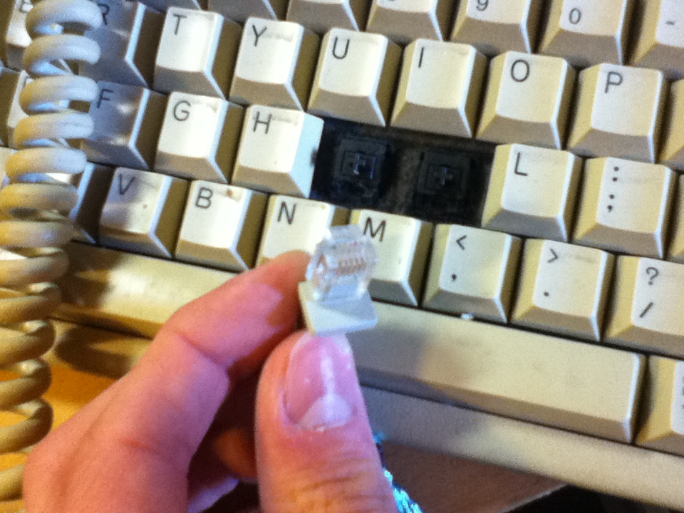

Sounds good. I really found a keyboard with MX black switches in our house, but when i had a closer look.. life can be cruel T_T (sorry only iPod cam)
There is no way to adapt this to PS2 right^^
31 Aug 2012, 15:19
This time you're right, those are MX blacks :D
Mind posting a picture of the whole board?

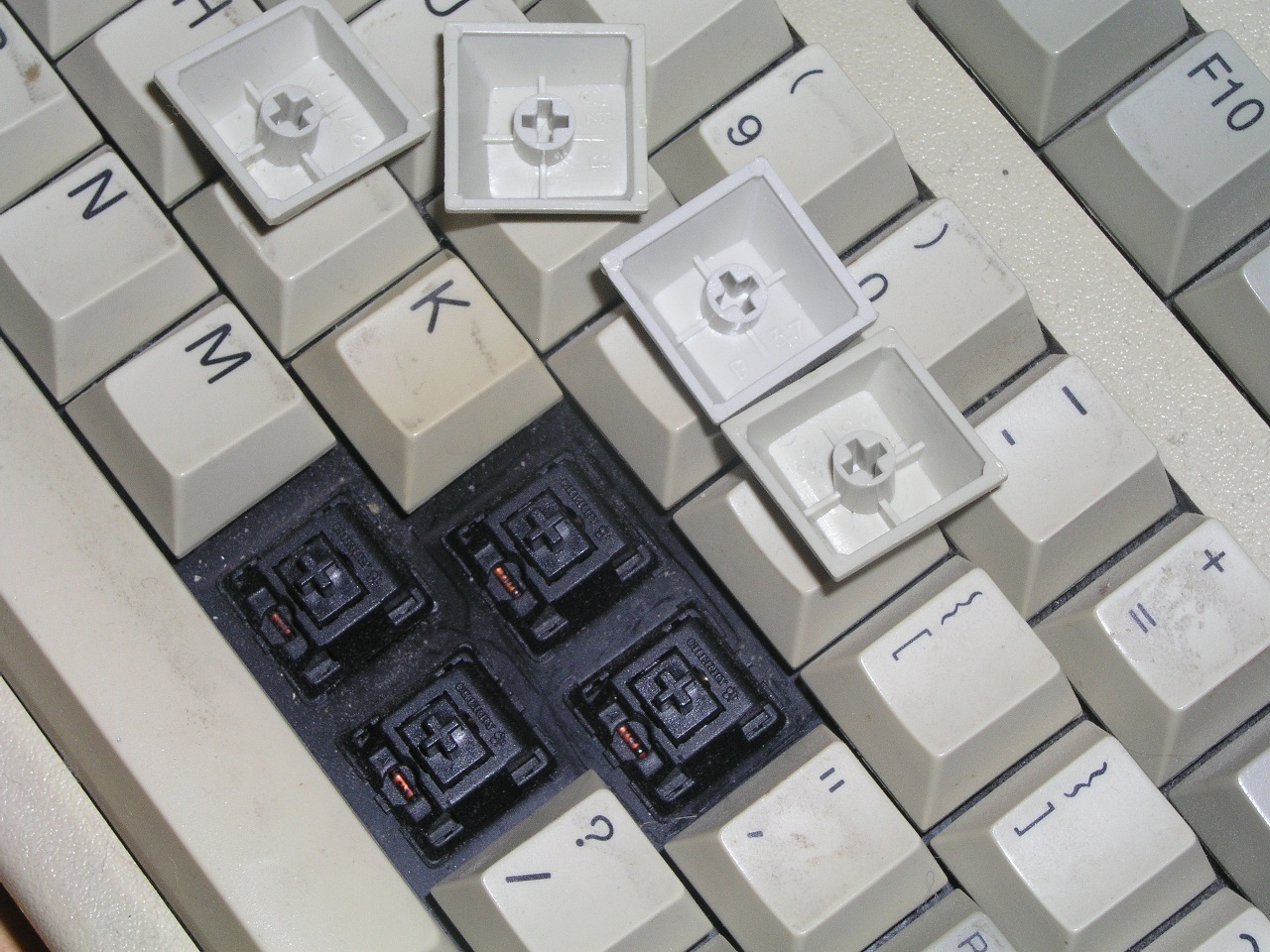

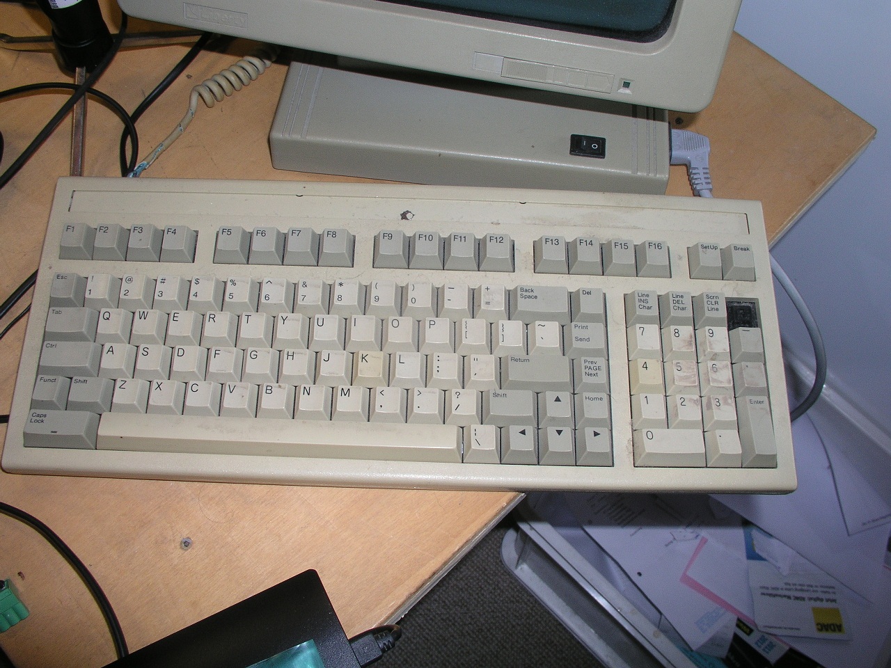

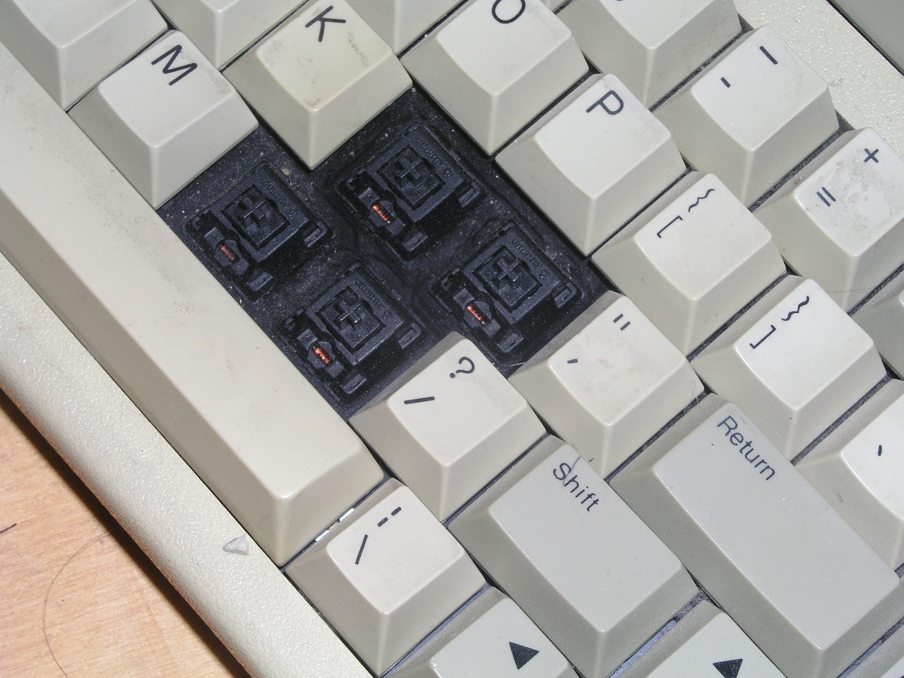

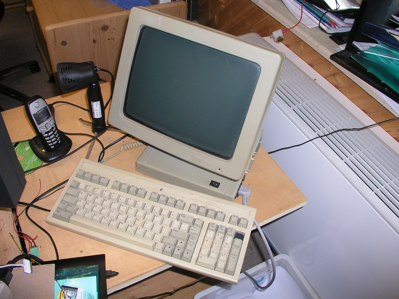

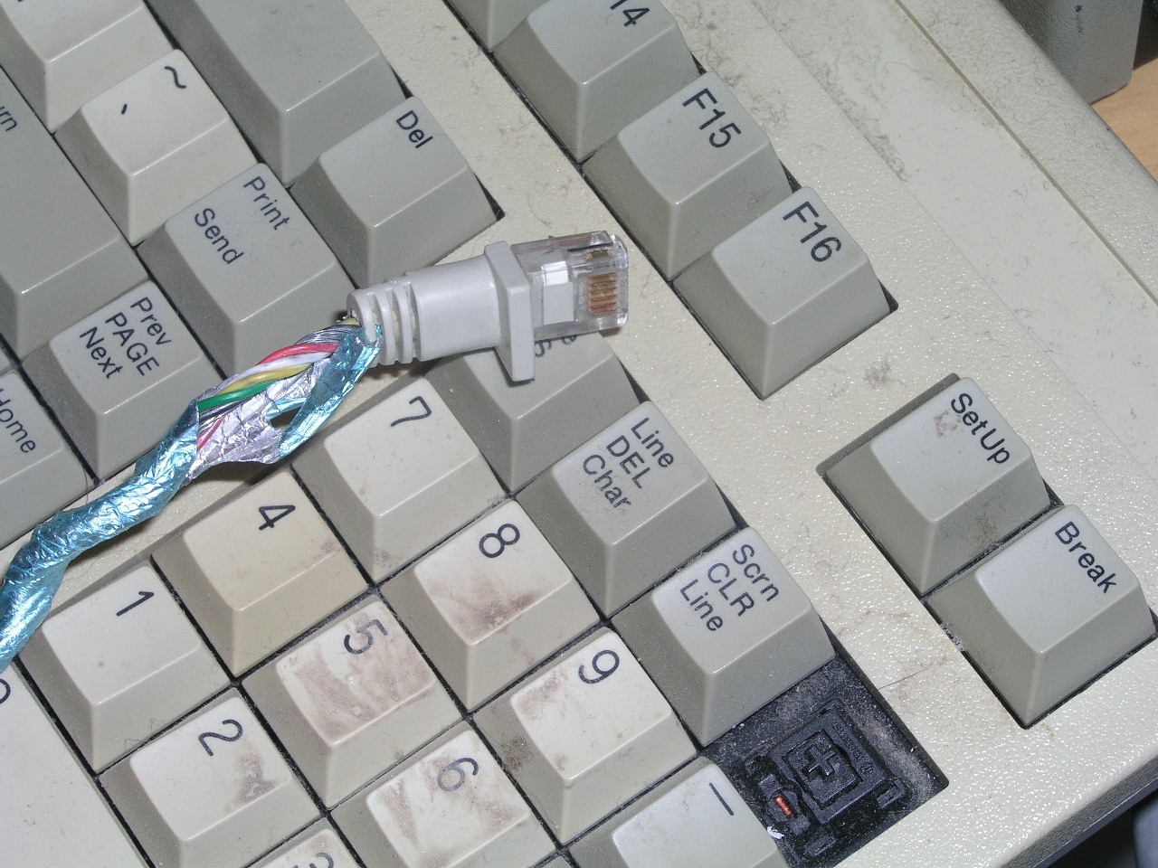

'course not, here are some digicam pics, but beware this thing is REALLY old :D (note: F13-F16 :shock:)
Also found a sh*tload of old keyboards, Cherry G83 etc but nothing mechanical in sight. (Why do we have more than 20 keyboards at home?)
damorgue
31 Aug 2012, 15:41
interesting layout, especially for being so old. They compressed keys in there everywhere but still chose to use a huge space bar
Hook it up to a teensy and you'll have it programmable too.
31 Aug 2012, 20:23
Looks like the exact same layout as a Wyse ASCII keyboard, for a text terminal. There are probably several other terminals that have the same layout, or very close to it.

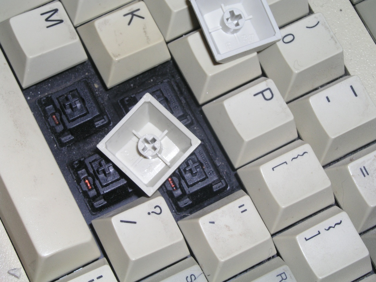

Interesting key caps. The shape looks the same as Cherry's own caps, but the font is different. Could we get a picture of the inside of a key cap?

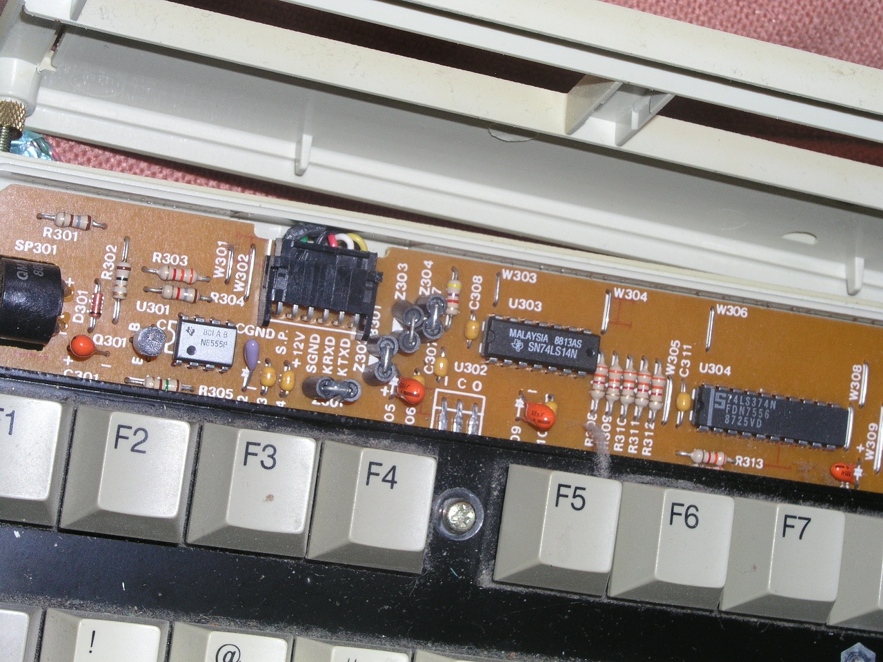

Do I spot a diode in there? If so, the keyboard might even be NKRO, at least if the controller was made properly. Only getting it to work with USB will be some hassle, we don't know yet what protocol it talks to the terminal or computer it belonged to.
Certainly a keeper if you want to invest somewhat and keep it original. Oh, and it might need some cleaning...

the whole terminal unit is still working if that helps, I think my father still uses it for testing sometimes. So, I hope I can use the keyboard as we don't have another one with this interface.^^

Thanks for the pictures. Oh, these keys are not even made by Cherry. When I look more closely, I see that the edges are actually sharper than Cherry's keys.

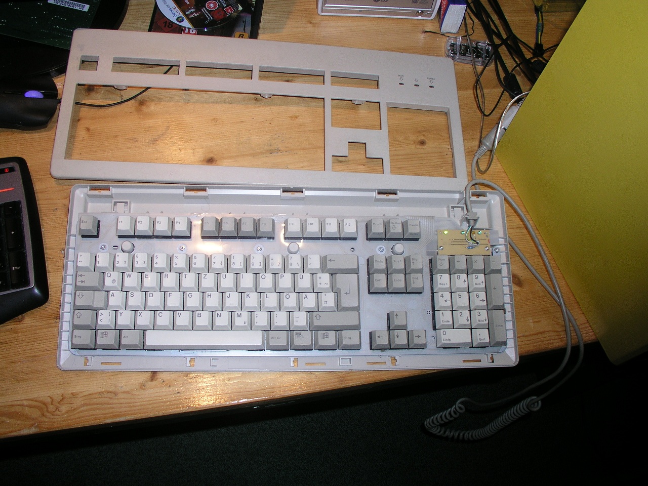

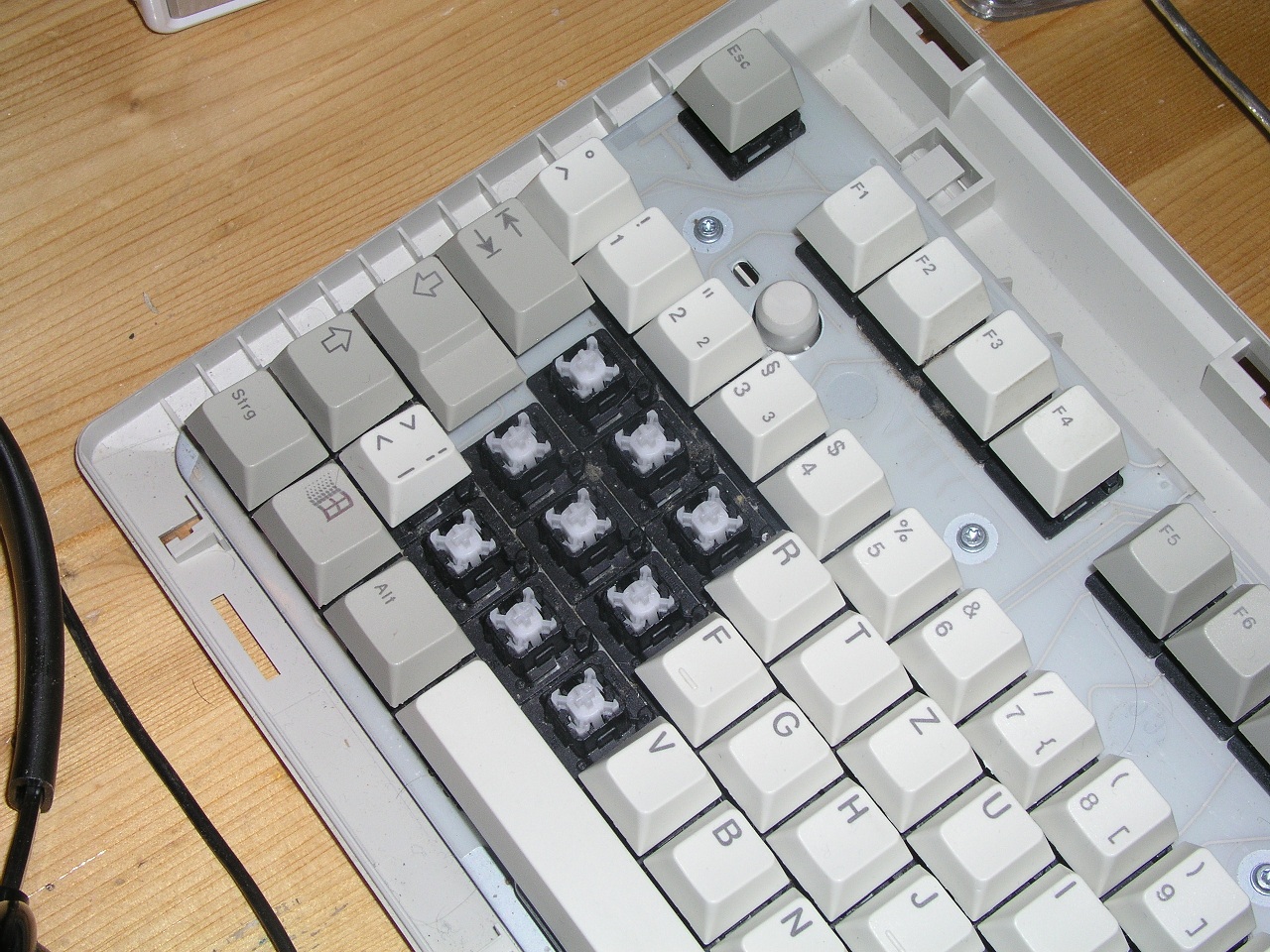

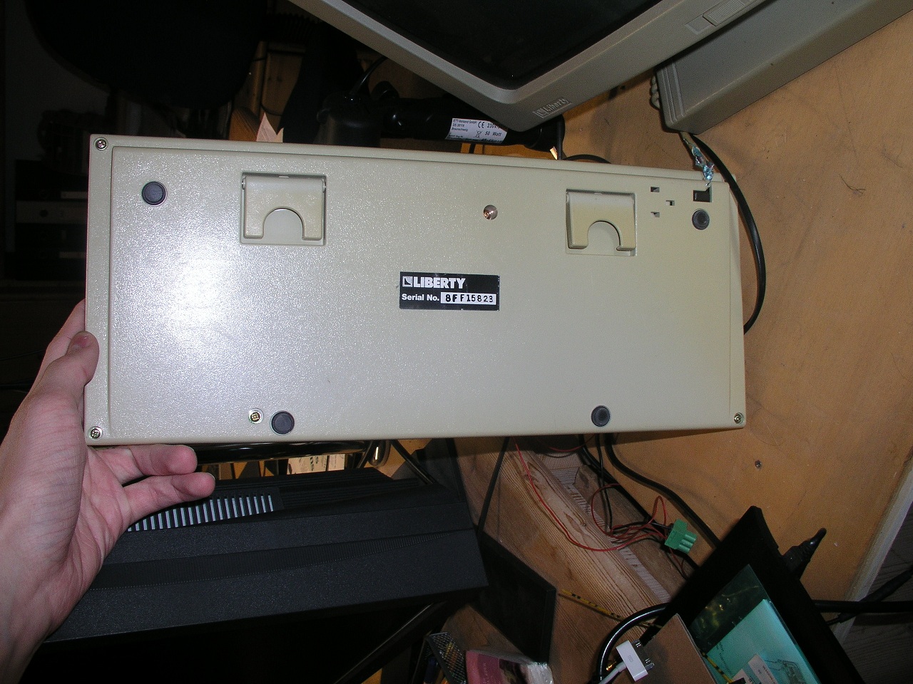

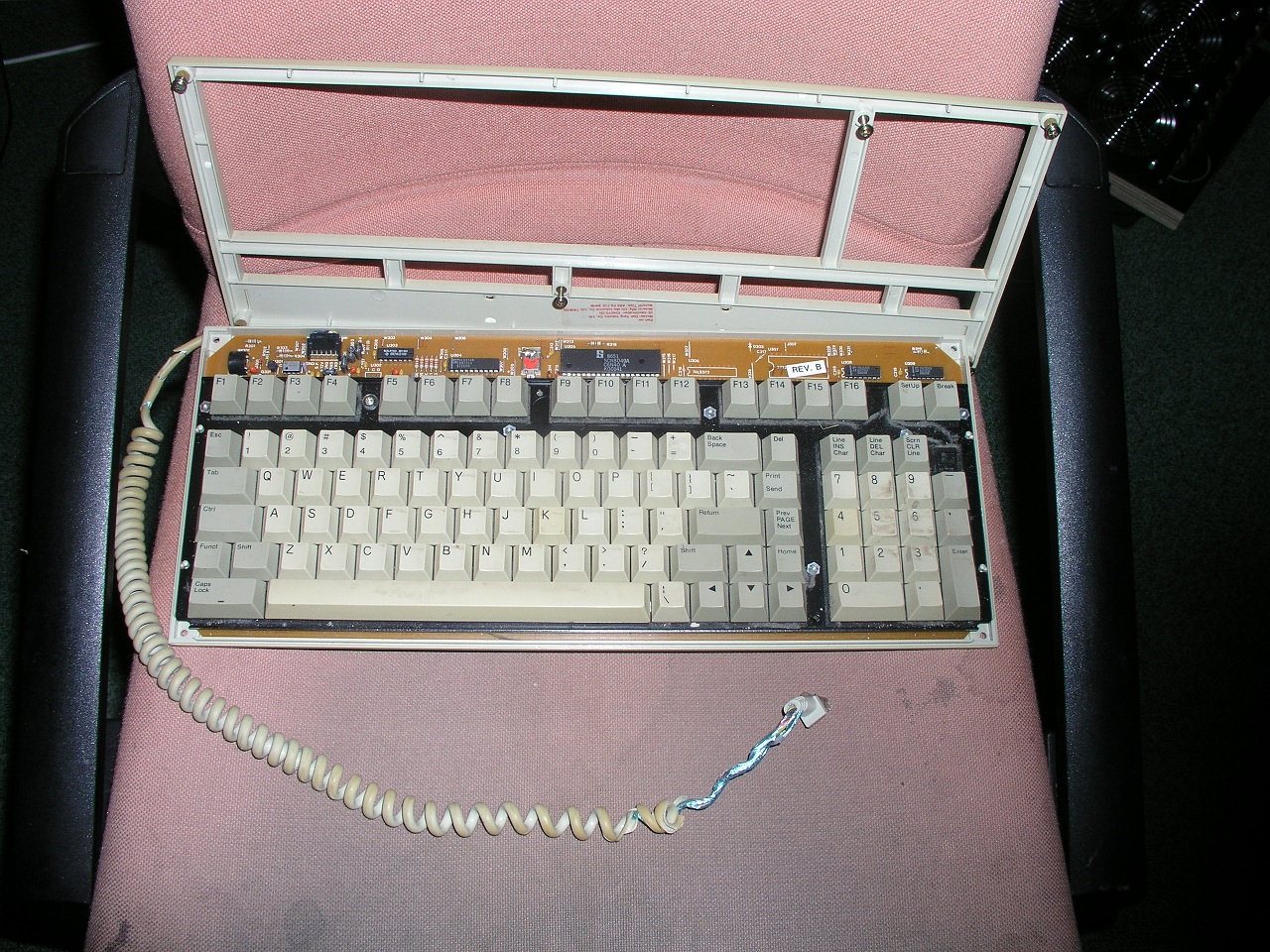

Just opened the case. Damn, look at this baby :D Solid black eloxated aluminium (?) base and the electronics - see for yourself.
Btw powered up the terminal, keyboard working perfectly althouhh the layout is really something you have to get used to.
The information on the PCB is interesting, the keyboard gets a straight 12V input, whereas USB gets +5V i believe? Adapting this will require an own PCB with voltage regulators etc, and maybe I will have to program my own microprocessor to convert the information sent by the keyboard. Well, challenge accepted, I always wanted to do this on my own :D Would be fun to develop a PCB.
