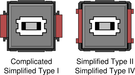

I've done some measuring on Types I, II and IV and come up with the following:
Alps recognition chart.png (21.03 KiB) Viewed 9219 times
Basically, simplified Alps Type II (called "[wiki]XM[/wiki]", for Xiang Min Co., Ltd) is completely identical on the outside to Type IV. Type II switches have a narrow tactile/click leaf, and Type IV switches have the same wide tactile/click leaf as Type I and complicated switches.
It would stand to reason that Type IV came before II, and that XM just wanted to use less metal.
What I'd really like, is for people with XM keyboards to open a switch (pick something you never use, like scroll lock) and check whether the tactile/click leaf is narrow and copper-coloured, or wide and made of steel. Photos wouldn't go amiss, especially as we presently have no internals photos, and I only have linear XM switches (so I can't photograph the one thing that makes them different!)
Basically I want to get a better understanding of these two switches. What I think has happened, is everyone has said "yep, four small tabs" and assumed Type II/XM, without realising that Type IV is completely identical from the outside.
Cheers
Daniel.

I'm starting to suspect that Type II and Type IV are both made by Xiang Min, and that both are just knock-offs that Alps Electric had nothing to do with. In which case, we could rename them XM narrow leaf and XM wide leaf respectively. Since they both suck and they're both undesirable, they can both be "XM" for short.
Possibly Type IV is the older design before they decided to make a cheaper click leaf?
That just leaves figuring out whether Strongman and Fukka switches are knockoffs ("clones") or licenced products.

21 Oct 2012, 22:03
Type III, potentially made by Strongman, is externally identical to Type I and complicated switches.
Fukkas are confirmed to be real Alps switches – Fuhua (Forward Electronics) is what was Alps Taiwan. Same factory. So Alps Electric themselves presumably created the simplified design first, and Fuhua just continued making the same design.

II (XM) and IV are stiffer, XM especially so, even if you hit them in the centre. Most of the keys on my Type IV board respond well enough to off-centre presses, although some of the number pad keys don't.

Not that I can tell personally. So far as I can tell, Types II and IV are externally completely identical. Likewise, original complicated, Type I/Fukka, and possibly Type III (possibly Strongman) are all externally identical. At a guess, if there's an "ALPS" logo on the upper shell, it won't be Strongman, but it could be Fukka, although by the time of the Tactile Pro 3, the ALPS logo was seemingly removed. These companies were very good at completely ripping off each other's designs, it seems, right down to the nearest mm. Type II and IV contact mechanisms aren't quite the same either, but unless both are made by XM (Xiang Min), then someone blatantly copied someone else with the design. Type III also has an identical contact mechanism to one of the other two, but the upper shell of a complicated switch. They're all very closely related.
Here's a lot of what you need to know (the page has since been deleted, it seems):
http://web.archive.org/web/200904290739 ... s_sw2.html
There are some photos of his on a different page showing very subtle differences in the upper shell, but I'm not sure what those refer to, and certainly not Types I/Fukka, II (XM) or IV. The page isn't machine translatable – comes back as hilarious nonsense.
Unless someone can translate that into English, it's not a whole lot of use to the western world …

Well, that officially ends the concept of Types I–IV. Forever.
The "XM"/Type II ends up being a large number of different types (T1–9). OA1 seems to be the closest to "Type IV".
If Matias is reading, there is definitely glory for whoever translates all of that and puts it on the wiki.

I'm thinking — maybe what we need is a colour chart. For each slider colour, one mini picture of each form factor (classic shell, classic shell + ALPS logo, XM shell) along with known switches for that colour + form factor. For example, are there any known simplified/clone switches in the same overcast sky blue as complicated blue switches, or are all blue clones all vivid blue?
However, at the moment, I'm not sure what to do about 002's discovery. Certainly means that we need a lot more switch opening to be sure what anyone's got … Not that I'm sure we'd ever really find out anything much at the end of the day: I sense that it's now physically impossible to find out who made all nine varieties of the "mantis" switches, since they're probably not all from Xiang Min. I also don't believe for a second that enough people have enough of each type to get any realistic assessment of keyfeel for each of the types discovered.
For the record, is there any evidence to suggest that Alps Electric ever made any other simplified variety besides Type I? Is everything besides complicated and Type I simplified, guaranteed to be a clone?
I've also noticed something else. There are really subtle differences in slider shape. Type IV switches have the same shape slider as vintage Alps with sharp corners in the surface cross section, but modern XM switches have a more rounded shape. Annoyingly, the page 002 found doesn't show the top-down of all the sliders, and it's hard to tell how much variation there is from the angle and focus of all the images on that page.
I think my most recent revision to the [wiki]Alps_CM[/wiki] page is fair. I'm still a little hesitant on whether all the details of simplified real Alps should go on the Alps CM page (after all, it's an Alps design) or the Fukka page. Did the term "CM" refer to Alps's simplified range as well, as if not, it would be due its own page anyway.
