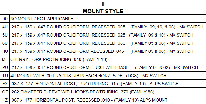

From Melissa at Signature Plastics: "Back in the late 1970's Comptec Incorporated (the parent company before we had a management buyout in 2001) created a 14 digit intelligent part number to aid in the production of various styles of keycaps. The 4U, EX, 1Z descriptions were created to designate the mount style."
So there you have it. I should be getting a full list, but some specific details are lost in time now. I've asked her specifically whether "U mount" is even a valid term for all 4 mm cruciform caps, or "Z mount" for all 5 mm slot caps. Possibly, but probably not, in which case we may be looking at needing new terms, and that's going to be a LOT of edits across the wiki if we do. Same as if/when we rename "Alps CM" to a less controversial name. Probably will just keep U mount and Z mount anyway; we may get some more terms too.
However, this means that people need to measure their Futabas, SMKs etc to check the mount measurements, as the list won't contain what keyboards/switches they fit, only a description of the mount itself. (There are so many switches with unknown mount spec/mount compatibility, in particular vintage Alps and Cherry equal cross (+), tall cross (┼), bar (|) and tee (⊢) mounts.)
27 Dec 2012, 23:44
Have a screenshot from Excel. The table system in phpBB is horrible beyond belief. I would be here all night.
I've asked, but I imagine these are current products only.
Note that mount "GZ" is for family 86, which is "CHERRY G86 STYLE KEYS". Clearly Alps is not Z at all.
Current mount types.png (23.5 KiB) Viewed 10948 times
27 Dec 2012, 23:56
GZ? 1Z and EX says Alps mount.
27 Dec 2012, 23:59
Alps has one that's not Z, and there's a Z one that isn't Alps. Therefore "Z" cannot stand for Alps. Nothing there can. I guess modern Alps keycaps are usually or always 1Z (hence "Z mount") but it's neither a systematic nor a logical term.
