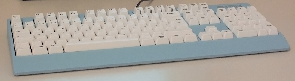

Example of my cheap lasered PBT Cherry set --> http://i.imgur.com/px87D.jpg
I have extras of that one, unfortunately it has an ISO enter but ANSI left shift. Which language are you looking for?

He's from Germany and the picture shows DE layout, too.
So I guess he's looking for a German set.
You could use the keycaps from a newer Cherry G80-3000, but the Spacebar and Capslock will not fit the Zowie.
If you manage to find some Doubleshots from an older Cherry board, the rest of the bottom row will also don't fit (because of the 1.5x Modifiers).
