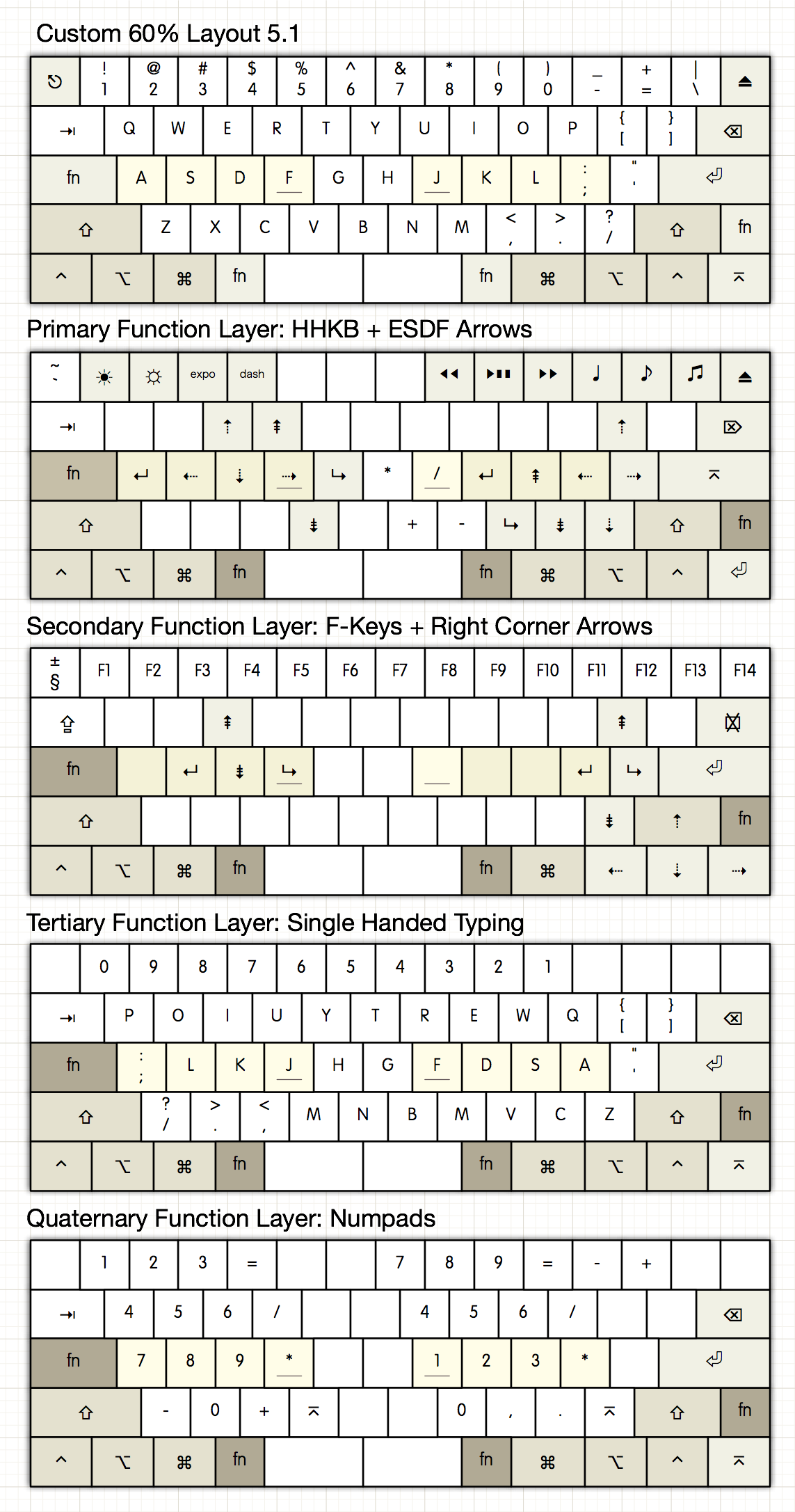

I've been playing around with layouts for my first custom keyboard build. It's a little 60%. The HHKB's function layer is what inspired me, and I've gathered up several ideas for different layers since.
But before Matteo puts anything into metal, I should really ask about what is possible with a custom controller. I've got several function keys across my current design. Two are down at thumbs' reach by the space bar, while another two are at the sides in higher rows. So I should always be able to reach one (or more) of them quite easily.
This is currently what I've got:
Custom 60% Layout 5.1.png (317.8 KiB) Viewed 9419 times
A lot of layers! The symbols are the crazy things I'm used to on the Mac (like ⌥ Option instead of Alt) and there's two space bars as I doubt I can source a 5u or smaller cap. In fact I could be very wrong about row 1 as a whole, do feel free to educate me!
The flipped QWERTY layer is for single handed typing. I heard about someone doing this as a half sized hardware keyboard years ago, but a quick search doesn't find it. But I did find a good description of doing it in software at xkcd. The idea is you use symmetry to find your way around. Looks crazy but I've had success with some basic experiments.
As for the controller, I'd like to know:
  • Are 5 layers (including the default) doable?
  • Are 4 function keys okay?
  • Can I make fancy logic for locking into a layer? I'm thinking about the numpad and single handed layers in particular.
  • Can I change my mind later, and reprogram the controller when it comes to function keys? Example: say I wanted to change the function key above left shift into Control.
I'd like all the function keys, when pressed alone, to do the same thing: engage the primary function layer. It's the layers after that I'd like to get inventive with. Perhaps something like pressing two function keys and a number to select one to engage and lock, until I press two function keys again to get out of it?
This kind of internal state seems like a good fit for using LEDs to indicate what's going on, too.

04 Jun 2013, 12:53
1) you can have up to 32 layers
2) you can have 32 FN keys, from an usability standpoint I dunno
3) There are a couple of options (tap, toggle, ...), but don't worry you can update your layout (and fn layer) at any time
4) yes, anytime, and you don't even need to open the keyboard to do that
Muirium wrote:Perhaps something like pressing two function keys and a number to select one to engage and lock, until I press two function keys again to get out of it?
There's a "layer toggle" function, but I never tried something like what you suggest.

04 Jun 2013, 13:03
matt3o wrote: 1) you can have up to 32 layers
That's the stuff! Three or four function keys is plenty enough for me. I would go with just the central two, around the mini space bar, if I weren't so intrigued by HHKB style arrow navigation. The key above left shift is essentially to be decided. It's a prime spot, and I'm pleased to hear I can do whatever I like, whenever I want with it! One thing it won't be is cAPS lOCK on the primary layer.
The hard part remains the caps.

05 Jun 2013, 16:33
Some Ideas.
Thumb Fn keys are nice, other fingers can move freely enough even while pressing Fn with thumb. Thumb keys are precious estate to be squeeze out its potential. I think you can handle 4 layers with two thumb Fn keys, like this.
Layer 1: pressing left FN
Layer 2: pressing right FN
Layer 3: pressing left FN then right
Layer 4: pressing right FN then left
And there is another idea I want to introduce. With this dual-role trick you can place Fn key on non-dedicated normal key(even on space!) without losing its original funciton. I usually place Fn key on ';' to use hjkl cursor layer with this trick. This is too tricky to recommend to everyone but it is worth giving it a try at least.
http://geekhack.org/index.php?topic=41685.0

The single handed keyboard I read about some years ago – the inspiration for my flipped layer – used space as a function key: F = F and Space + F = J.
The more cunning the layers, the more useful LEDs are beneath the keys. I think they would make a great feedback system when learning how to use this kind of keyboard.

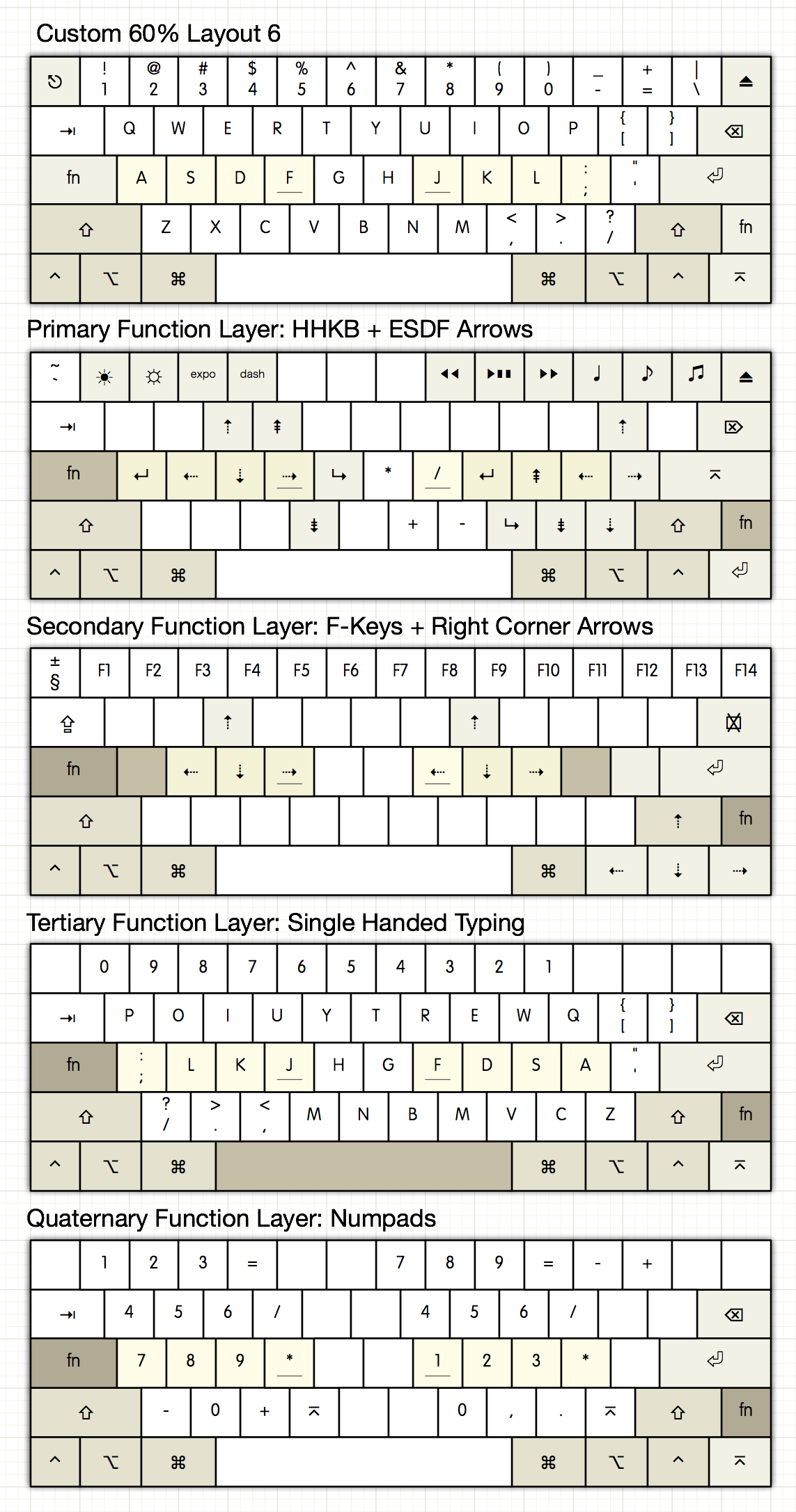

I had to redesign, as Matteo's sweet thin layered case actually requires a long enough space bar to put the Teensy under! Glad he reminded me.
So, reworking row 1 for a 6u space bar, I could either jam in the function keys and the rest I had before, all at 1u; or accept that there's no way to keep them all within thumbs' reach and drop the function keys. I did the latter. But look at the dark grey keys in the secondary layer.
Custom 60% Layout 6.png (309.22 KiB) Viewed 9182 times
Hasu's suggestion got me thinking. How about non-dedicated embedded function keys? I like ESDF for arrows, so, staying on home row, I could use A+D for down etc. and the same for ;+IJKL on the right. Matias' idea for the space bar in mirrored typing mode is definitely worth a shot. What I'm losing in keys, I'm compensating for in sneakiness.
Besides, it's all for this:

05 Jun 2013, 21:26
hasu wrote:Thumb Fn keys are nice, other fingers can move freely enough even while pressing Fn with thumb.
Heh, I use palm-Fn-keys. And since my model F XT only has the right "Alt" key available for Fn, I had to use Alt + Space as AltGr. It works, but it takes some time to adjust and even then you have to stop and think which keys you have to press.

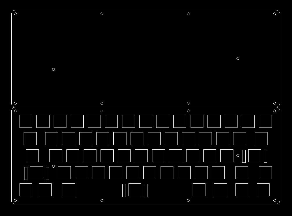

06 Jun 2013, 08:39
This would be your plate with 6.25 spacebar, though. All mods to the right are 1.25. Should be easy enough to source all the caps this way. Actually I'd probably make all the mods to the left 1.25 as well.
note: stabs for spacebar are not yet ready

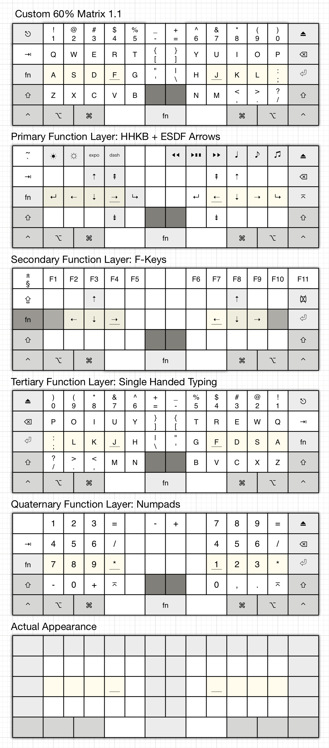

Now that I have a sensible layout ready for production, it's time to go crazy with Plan B. What better than a wild, unstaggered matrix? I've also pushed harder for symmetry.
Behold!
Custom 60% Matrix 1.1.png (332.43 KiB) Viewed 9072 times
The advantage of a custom controller and a matrix layout (with blank caps) is that I can just move the home row around if I find this kind of split layout impractical. Note the split space bar (each half is 2u, and they're separated by another 2u function key, which makes the three the only stabilised keys on the board) and the To Be Decided keys dead centre. This is still a work in progress. But for a wild child, I kinda like it!
dondy
09 Jun 2013, 15:23
i would increase the size of (1,1) to (1,4) and (14,1) to (14,4) by 0.5 and add that width (+0.5*2) to the space bars. though that would mess up the layout a little it would look more comfortable to me.
also, i would try to merge layers as far as possible instead of having f.e. the arrow keys mirrored in 2 layers (that's a awful lot of redundancy). additionally, for the one handed layout i'd use a operating system software solution rather than having it as part of the layout.
it could be explored if having wasd-type arrow keys or hjkl-type arrow keys in a layer (hjkl would maybe allow to have function keys, media crap-keys and arrow keys on the same layer).
just a little output from me :)
09 Jun 2013, 15:34
Thanks for the suggestions. I pick up all my best ideas from other people. As do we all!
I'm trying to stay within the 15x5u dimensions of my main plate. That way I have one case that fits both*. The layers are all highly speculative: they are the thing I can change any time in the future with ease. What I'm really after is the physical layout in which they are contained.
*Not that I expect plate swapping to be a simple matter. But laser time is nigh!
