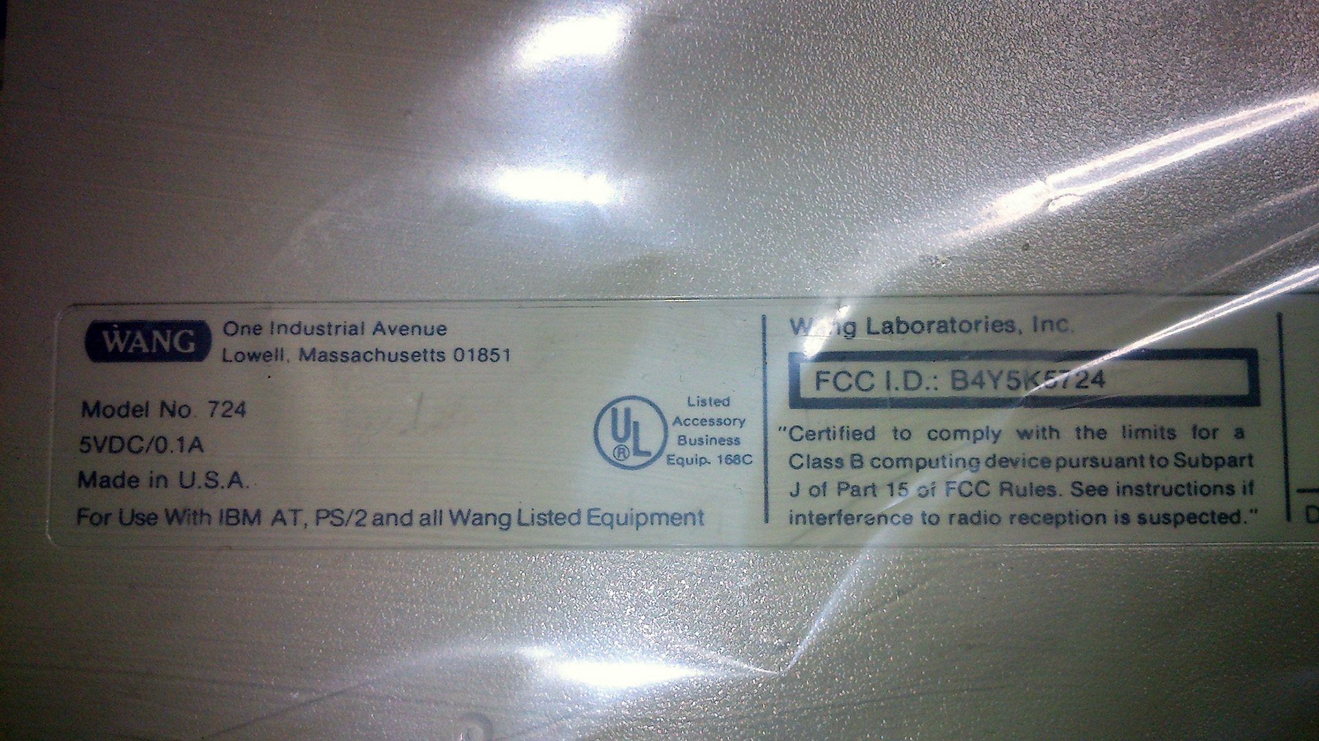

Label for "Model 724". No years. The small barely readable label on the right reads "Wang 8925" or "Wang 8935" and "725-3770-US".

webwit wrote:Label for "Model 724". No years. The small barely readable label on the right reads "Wang 8925" or "Wang 8935" and "725-3770-US".
I imagine that's week 25 or week 35 of 1989. The FCC ID is dated to 1988, so this is an early production run.
Interestingly, MouseFan has salmon Alps as being last seen in 1991, while the Wang 725-3770 and 725-3771 I've found have salmon Alps from 1992. Orange Alps are listed as 1987–1991. I've added both dates here:
[wiki]Keyboards and switches by year[/wiki]

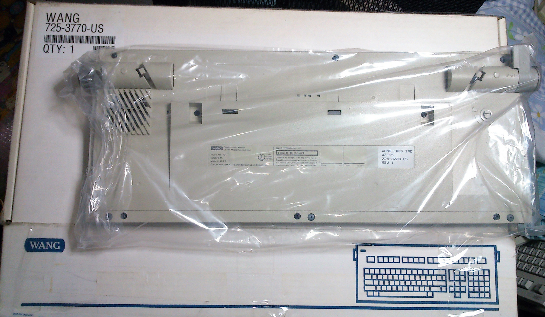

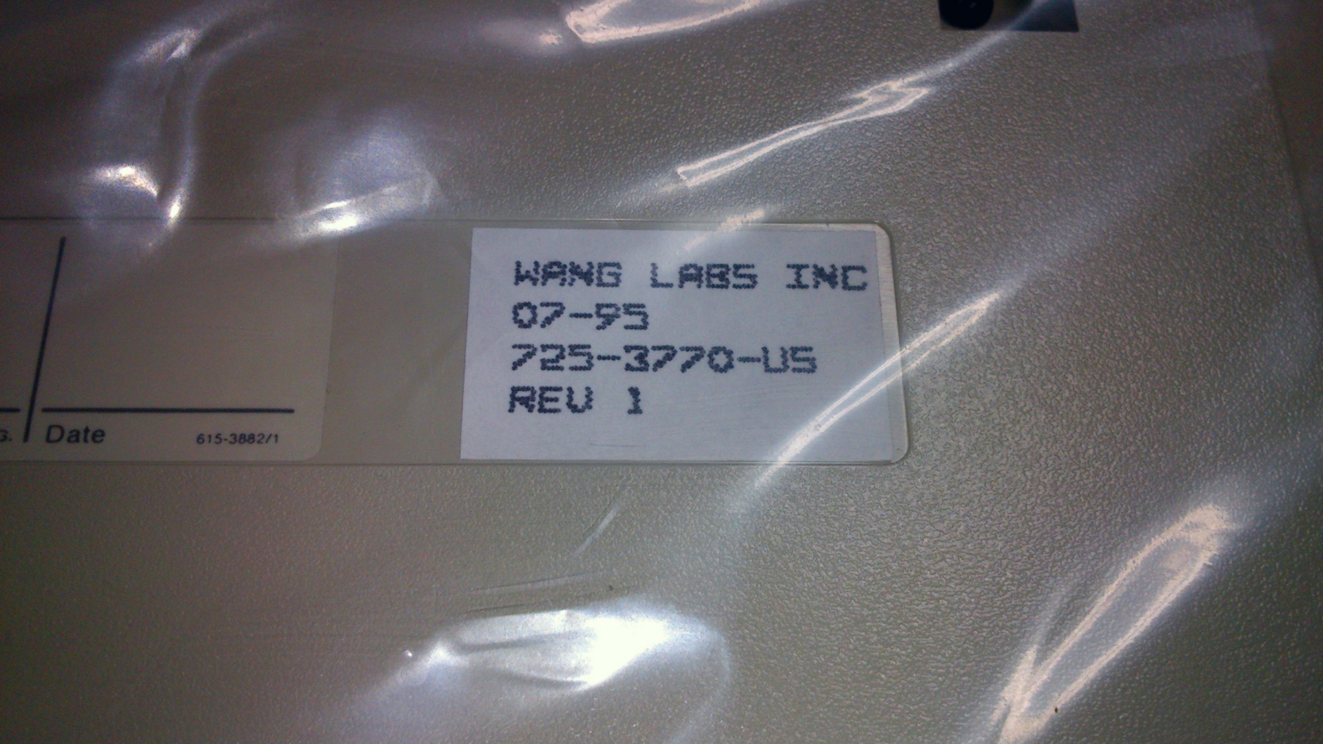

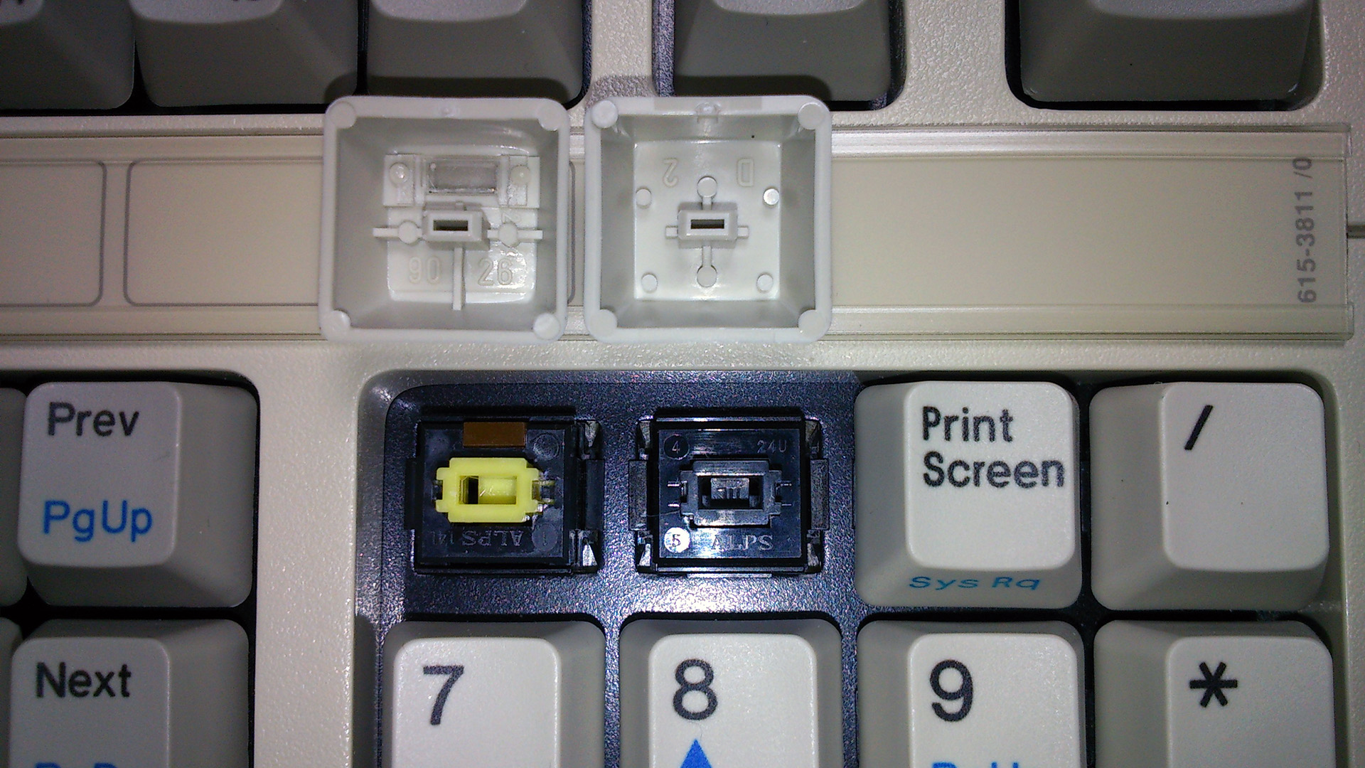

24 Mar 2014, 16:28
1995-07
Alps SKCM Black , LED Alps SKCL Yellow

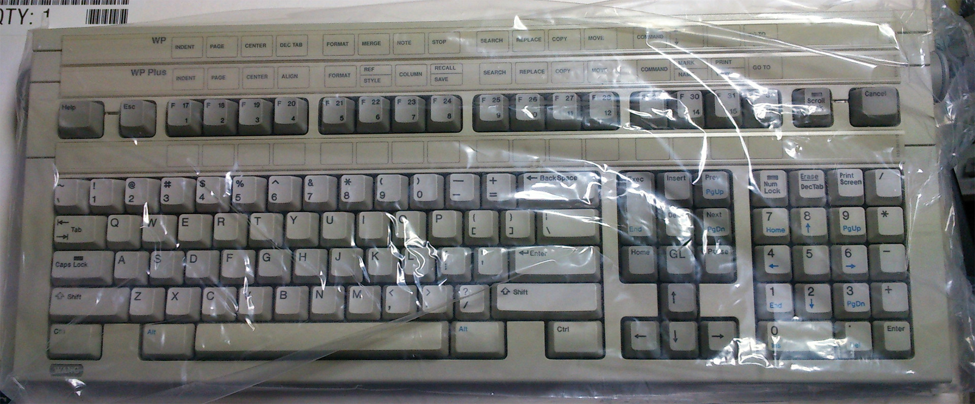

Nice. I should have the ISO version of this board on the way soon.

Thanks rzwv! I have used this topic as a reference instead of KBDMania for the black+yellow Alps version, since we have a part number available.
[wiki]Wang 725-3770[/wiki]
It will be interesting to see a 1993 example: it should be black Alps.

I got one of these from some trips to Electronics Plus. There were only a couple of them there. Fantastic keyboards. The speaker based click sound is a riot. It's like a cost reduced version of a solenoid. I've found that I really enjoy Alps Salmon switches. They are my favorite of all the Alps switches and may even be my favorite switch period. I just wish they were damped. I really wonder how the Matias quiet switches compare. I hope they are similar.
This keyboard, like some other Alps based keyboards from the era, has extremely scooped F and J homing keys. I think I would prefer a tactile line to the deep scooping. It means I need to lift my index fingers higher to get to G and H, or run them over the edge of the (sharper than usual) key cap.

I thought the orange ALPS had a grey switchplate? My Salmon/Pink ALPS don't have the grey switchplate and I thought that was the difference? Or Since this is such a late Orange ALPS did the switchplate change?
EDIT: Or is that a grey switchplate and I am blind?
