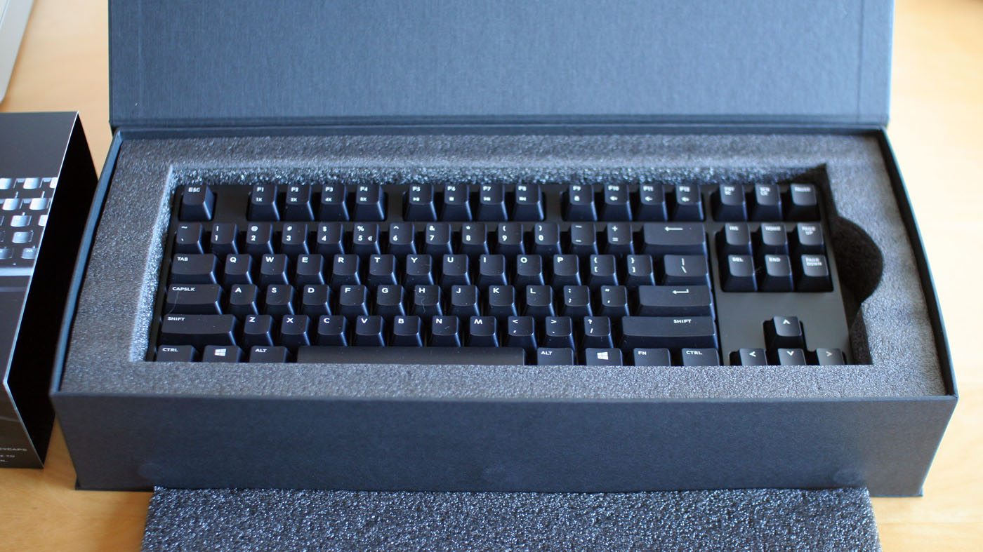

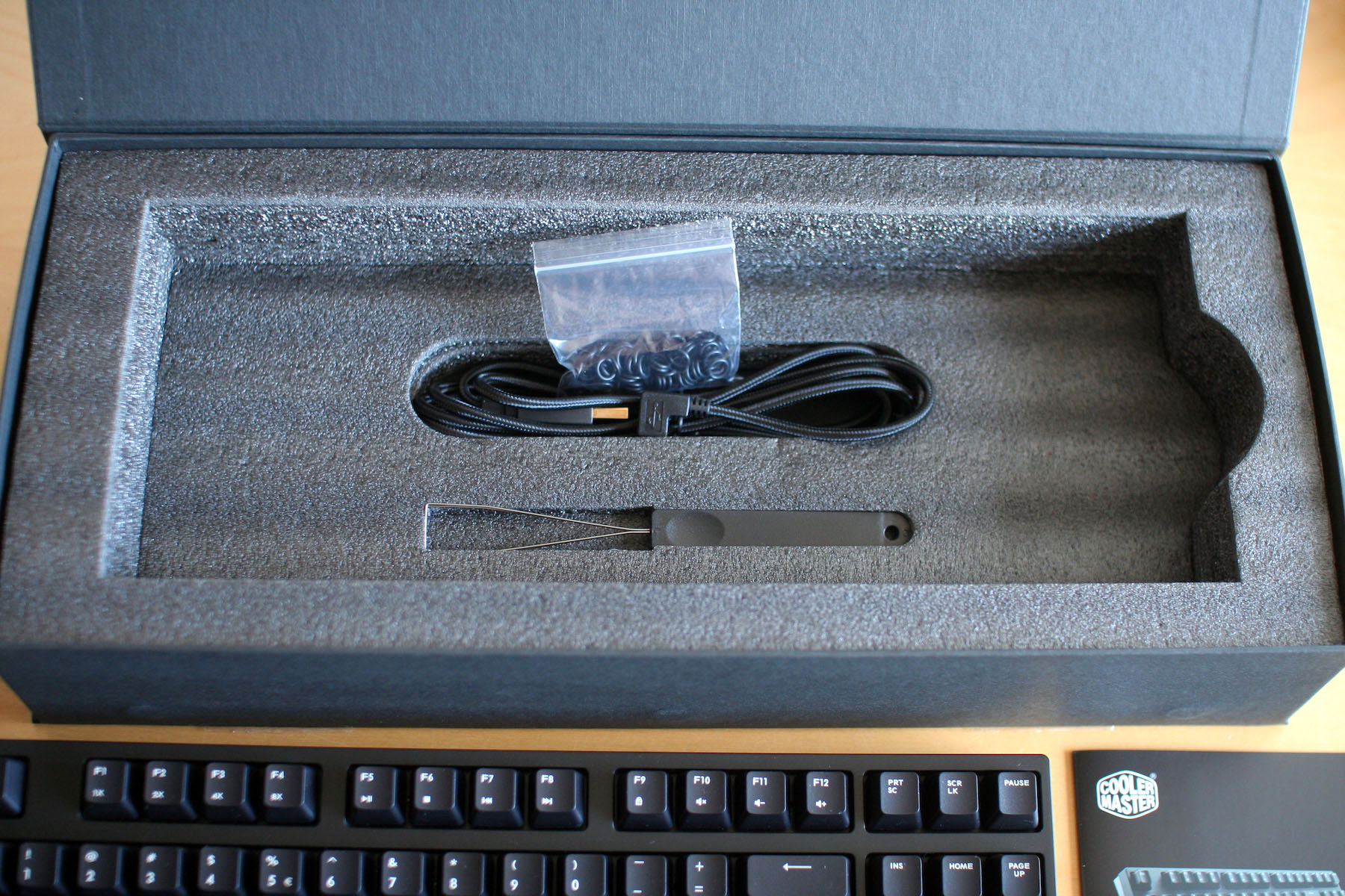

The NovaTouch ships inside a surprisingly big, black, quite luxurious box which looks fairly elegant in itself. Undo the magnetic latches, and inside a great chunk of protective foam lurks the beast. The first impression is positive: sleek, black, and free from flashy, tacky distractions. This is one tight little TKL.
Also in the box is a fancy braided USB cable, a good keypuller and a bag full of o-rings.
Box Extras.JPG (472.26 KiB) Viewed 29790 times
Interesting, the manual doesn't even mention the o-rings. Or indeed Topre! CM calls this keyboard's switches "hybrid capacitative" every time it comes up. Didn't Topre allow them to use their name? Maybe CM didn't want to. Confusing corporate politics…

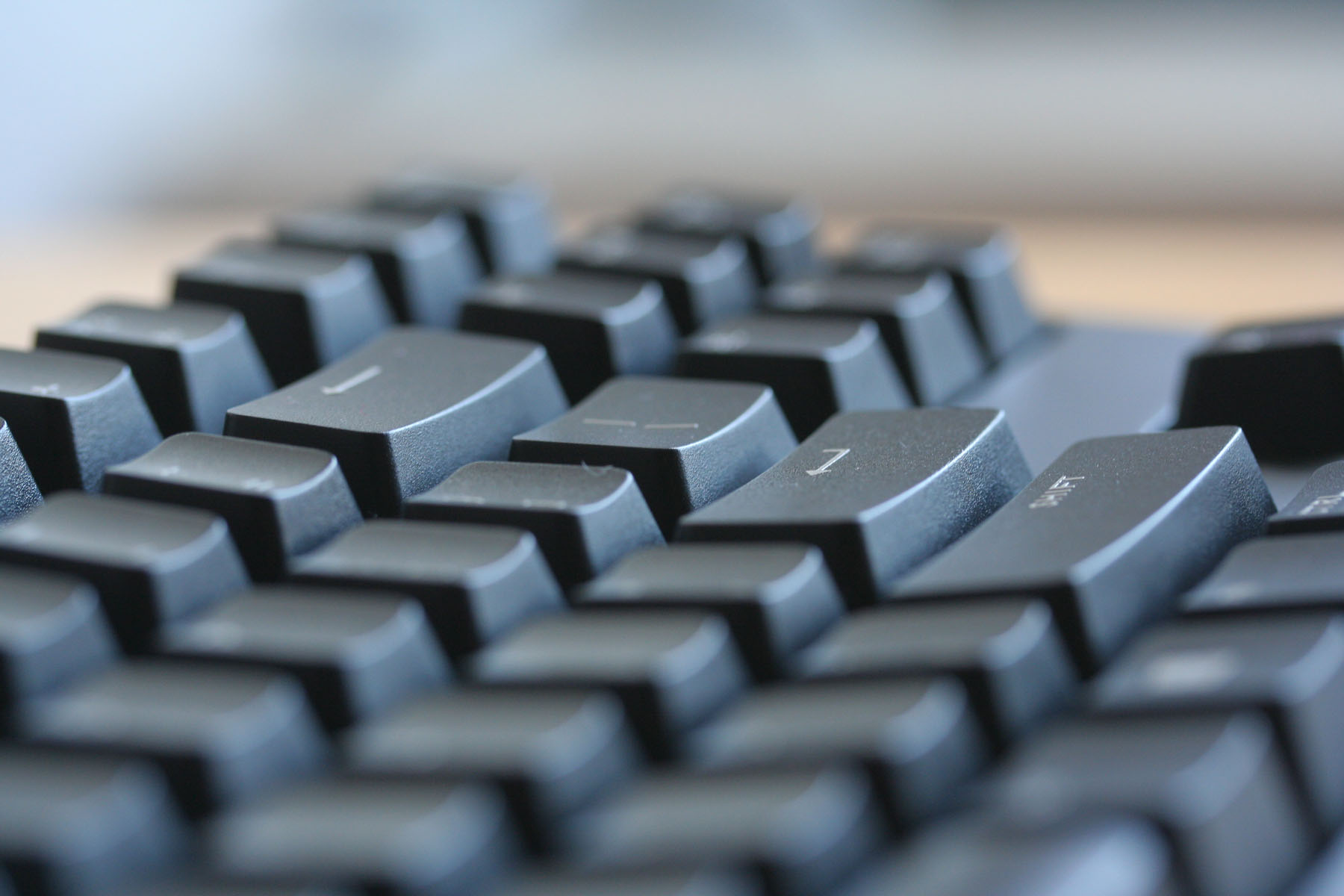

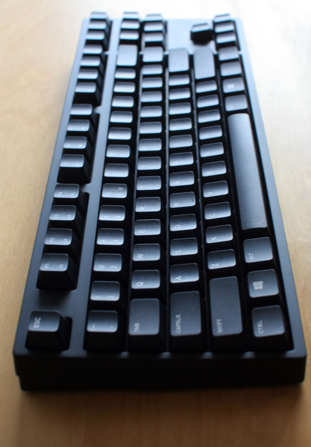

Pulling the keyboard out from its comfy home, it's a fair slab of tough and thoroughly modern TKL. The case is smart and small, albeit covered in a slightly rubbery finish that's not quite my style. Still looks good though, after a lot of use. It's a similar but improved design to CM's popular QuickFire Rapid TKL, with less rubber and less branding. The fold out legs, smartly, have rubber where you really do want it: on their feet. Nice touch. Many boards forget all about stability when their feet are extended.
Stock Caps Profile.JPG (177.44 KiB) Viewed 29790 times

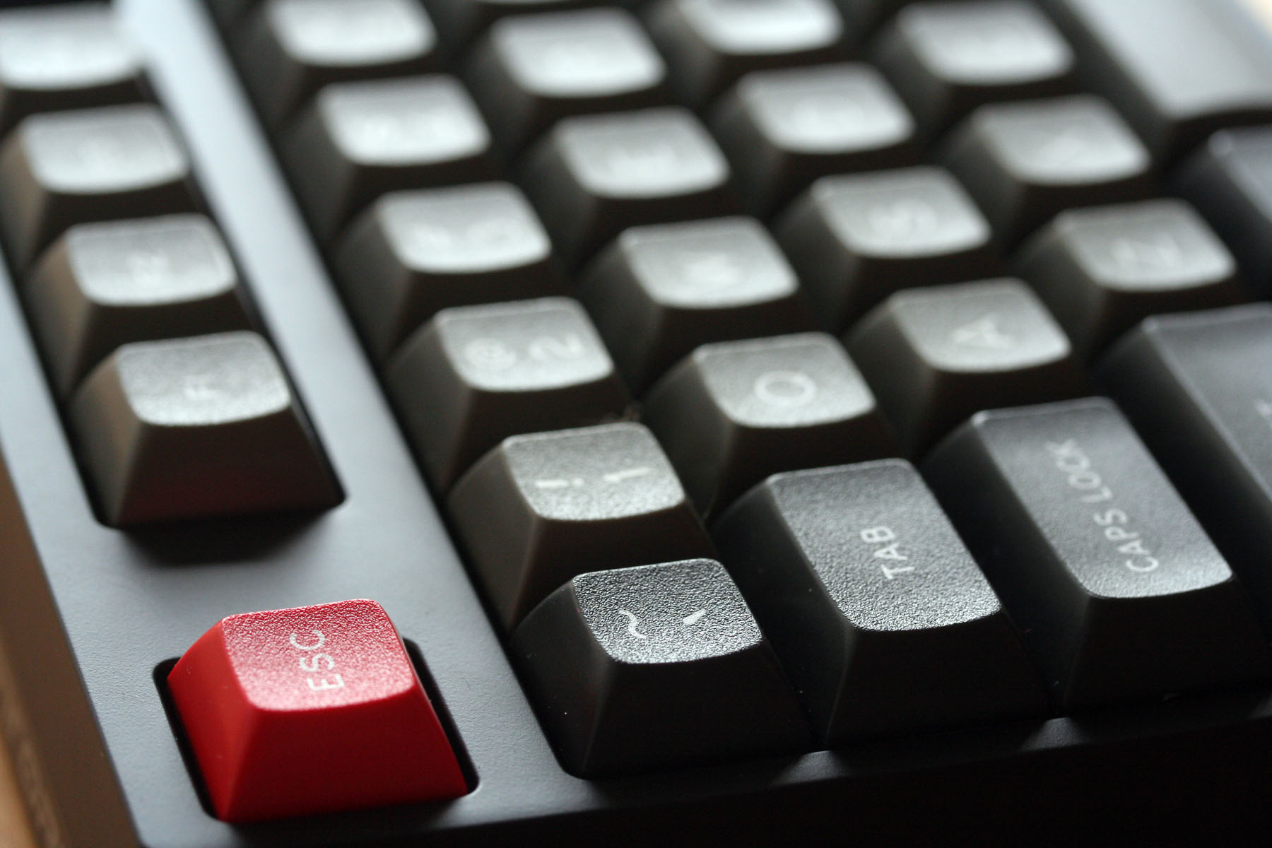

The NovaTouch's stock caps are, well, okay. Nothing great here. They're not horrible, and I do like the choice of Futura for the legends, but the alignment is puzzling and they're far from the dyesubs or doubleshots a caps snob like me is accustomed to. They're nowhere near as good as the stock caps you get with a Topre Realforce or HHKB, either. The very first thing I wanted to do, naturally, was pull them right off.

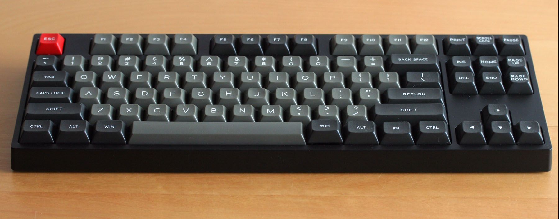

Dressed to Impress
As forum regulars have noticed well by now, I've been testing a NovaTouch prototype for months. It is, without any exaggeration, the best canvas for showing off caps that I have in my possession. The NovaTouch is very well designed to generate envious drool in onlookers! It gets out of the way and just lets you focus on your glorious caps. My goodness, have I done some of that!
Round 4 SPH with limited edition Ducks.
Ducky's thick PBT blanks.
PBT Granite, with Round 1 exclusive Cyrillic.
The final production model is just as handy.
DSA Dolch Front.JPG (159.97 KiB) Viewed 29790 times
DSA Dolch.
DSA Dolch Texture.JPG (219.6 KiB) Viewed 29790 times

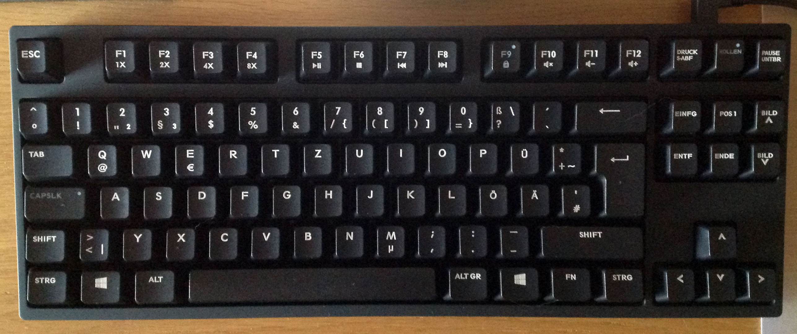

My prototype is ISO layout, while my final model is ANSI, so you know. I prefer ANSI in general, for caps as well as feel, but the NovaTouch comes in whichever one you want.
The NovaTouch keeps its branding low key. It's all about the caps.

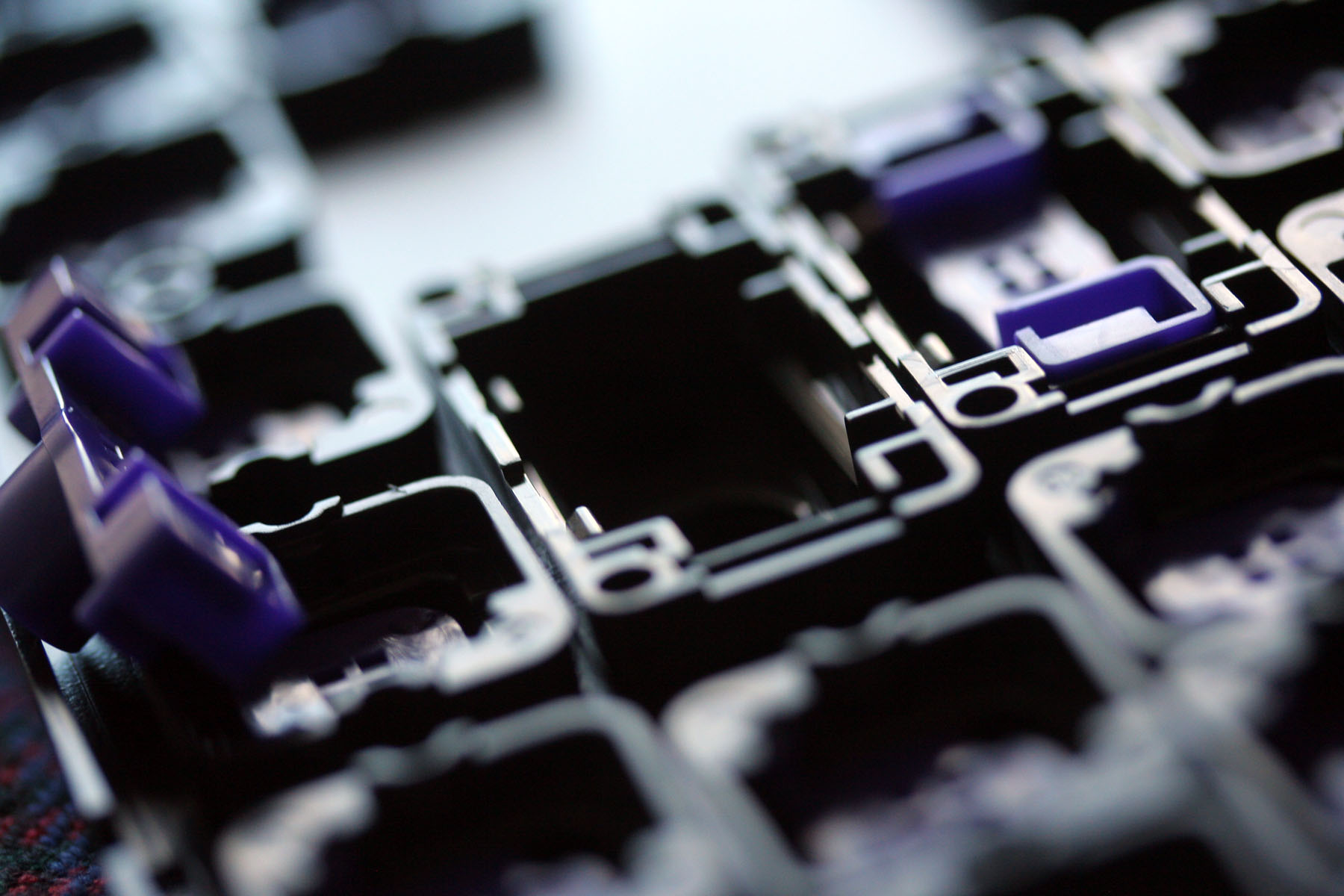

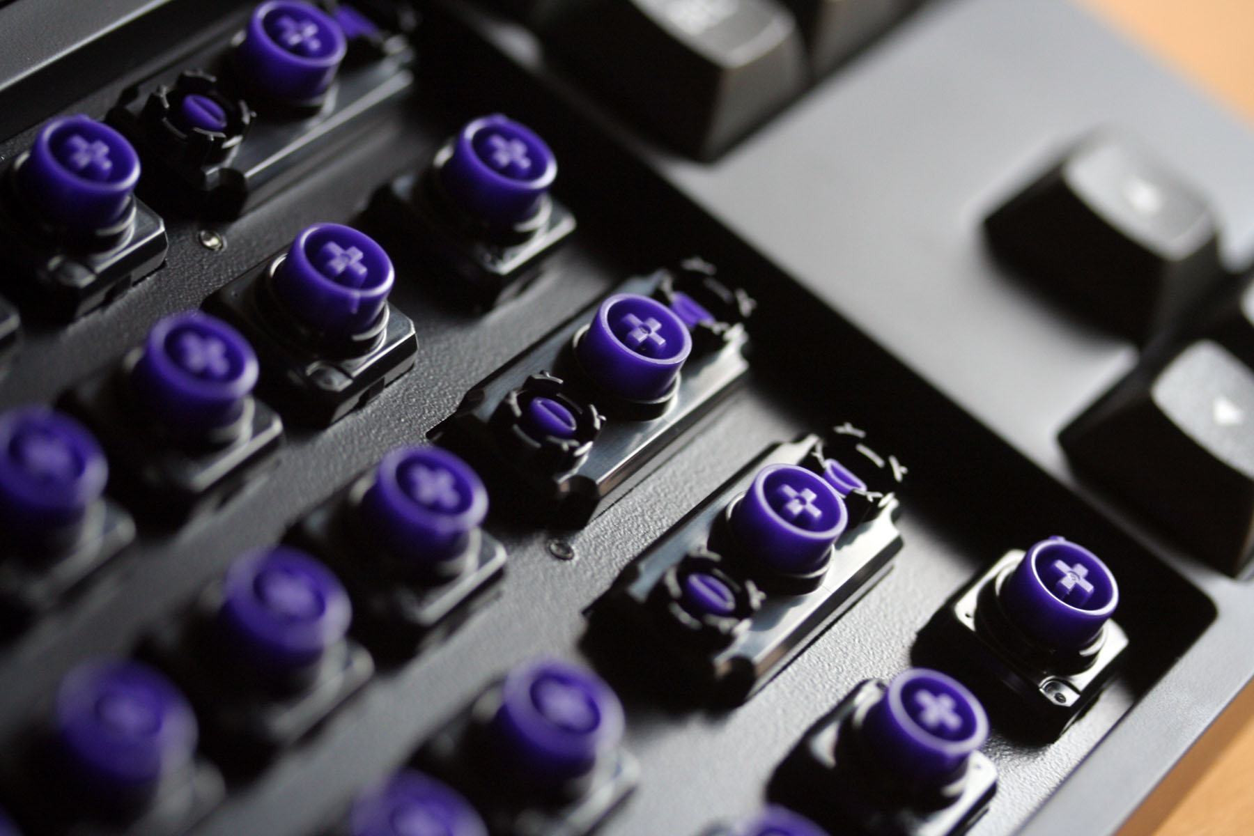

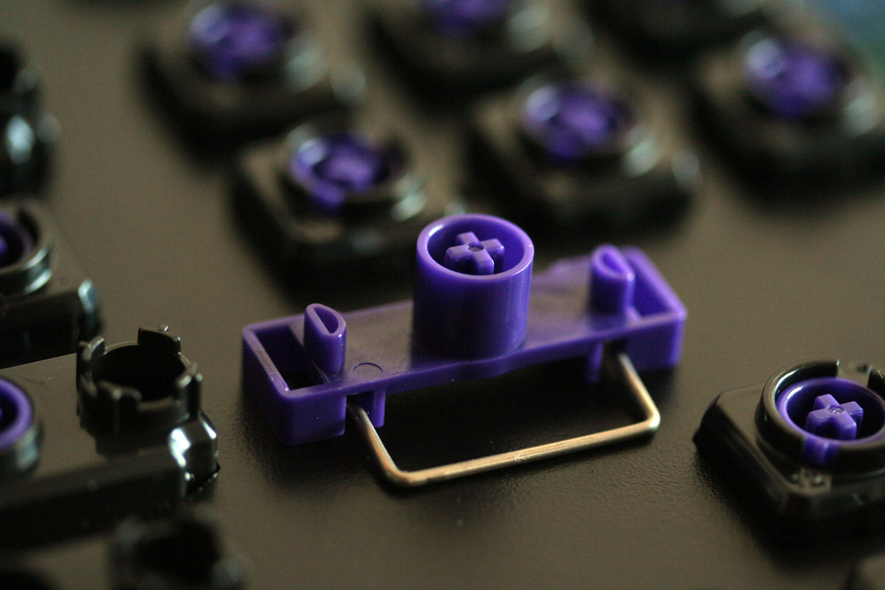

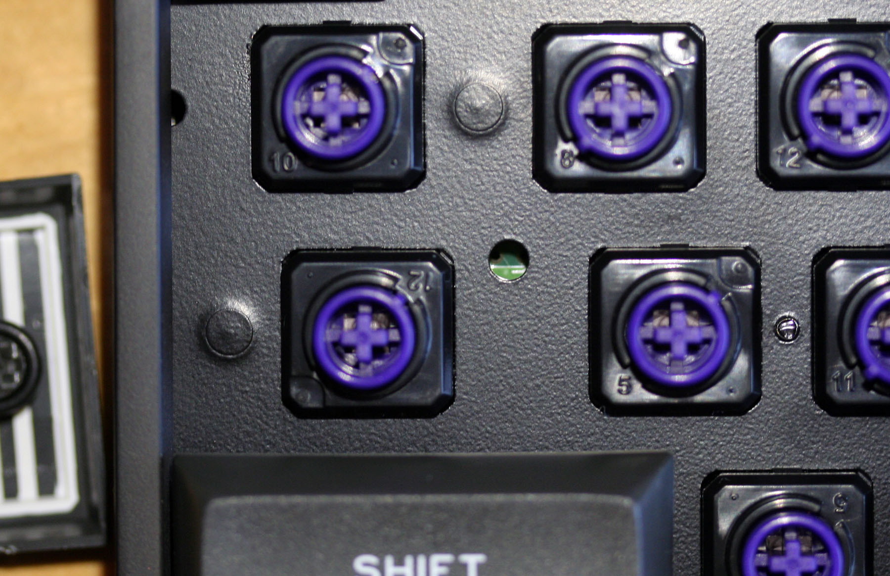

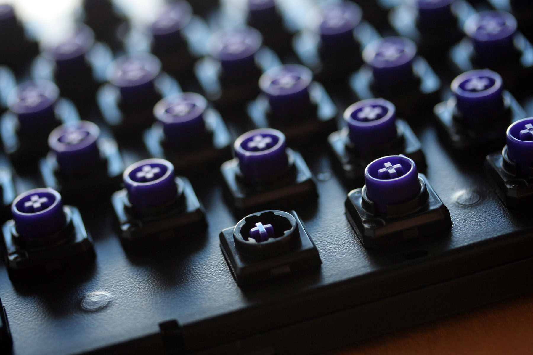

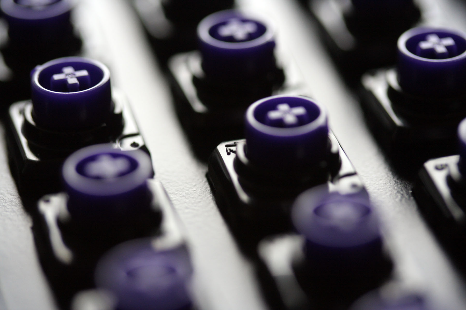

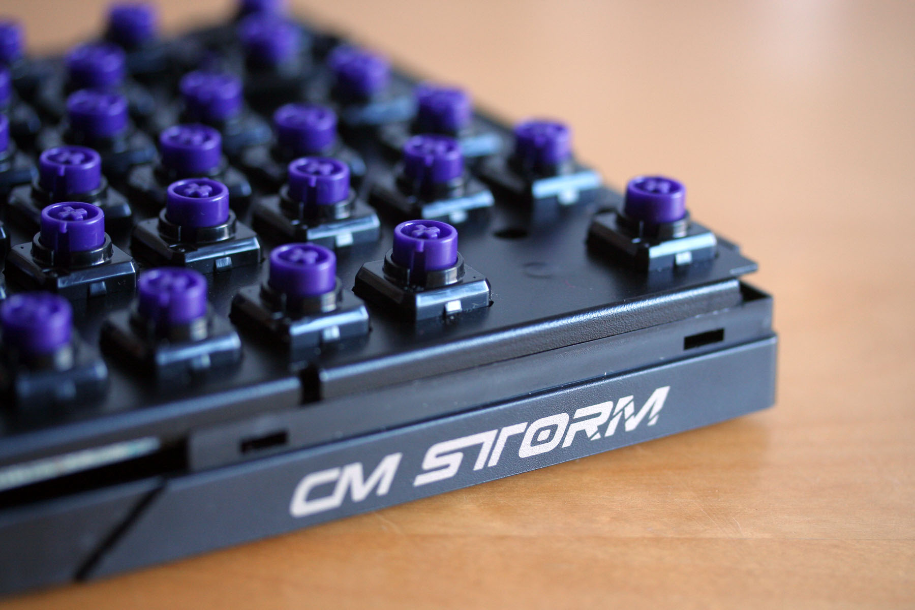

Anyone into Topre is forgiven for being confused at the sight of these stems. Purple? They're Type-S! Well, no, they're not. Only the highest priced of Topres have that damping, and the NovaTouch definitely does not. These are regular weighted 45 gram plain Topre switches, with MX compatible stems. In purple. Because it's CM's favourite colour, apparently.
Shiny ANSI Stabs.JPG (219.93 KiB) Viewed 29787 times
Swapping caps is very easy. The NovaTouch uses stabilisers which are similar in simplicity to Cherry stabs. You simply pull the space bar or the other large caps off, and replace, without any fuss about separate inserts. Fantastic!
Spacebar Spring.JPG (197.27 KiB) Viewed 29790 times

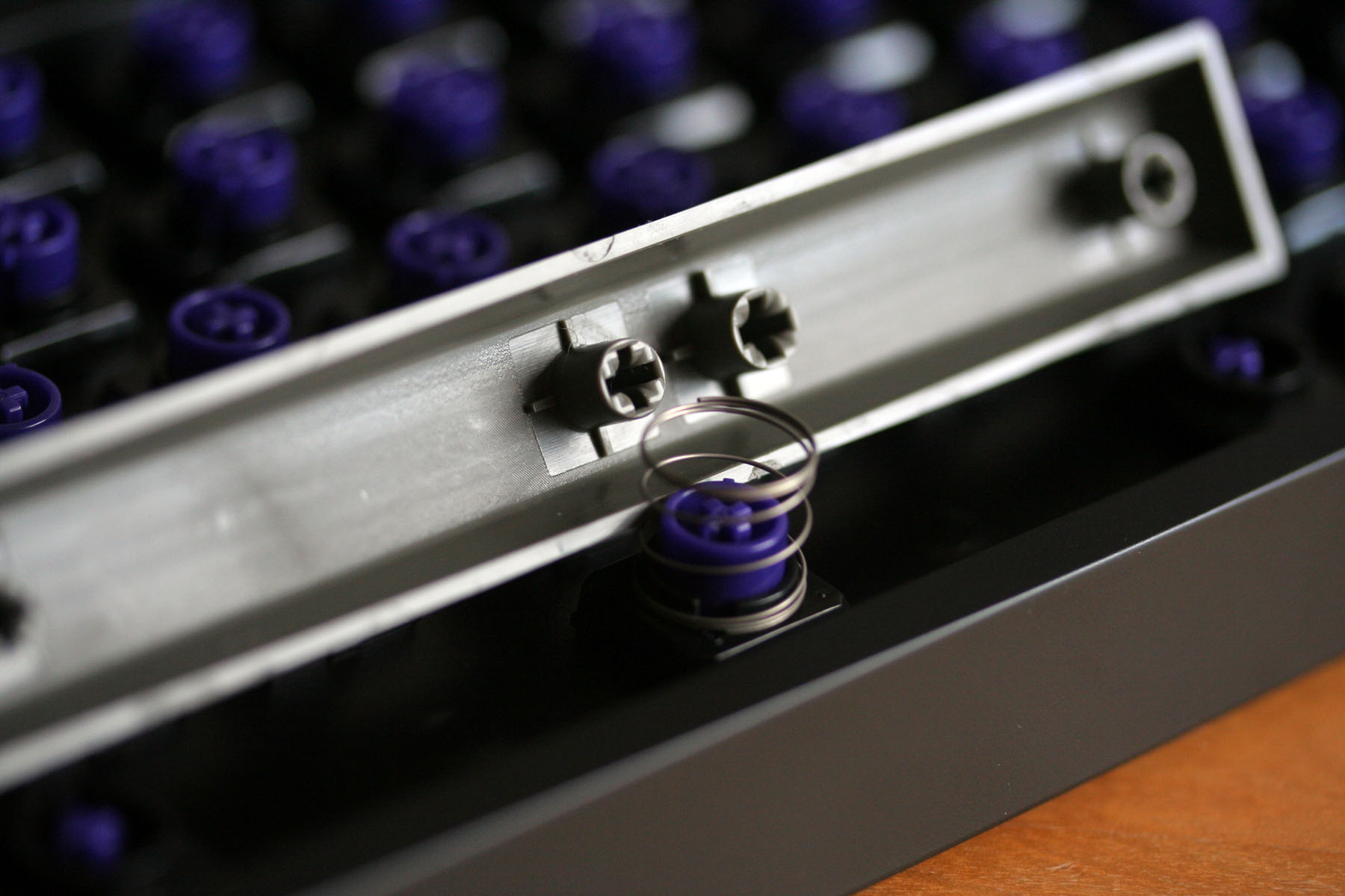

Watch out for that spring beneath the spacebar. It's a classic Topre addition, to give the spacebar a bit more weight. Don't lose it! Or if you really prefer to go without, mine went flying and I've still not found it.
If you're into photography and aftermarket cap sets, the NovaTouch is amazing. Full stop. Sleek, simple, and in the ideal colour that goes with everything. It is the little black dress of keyboards.

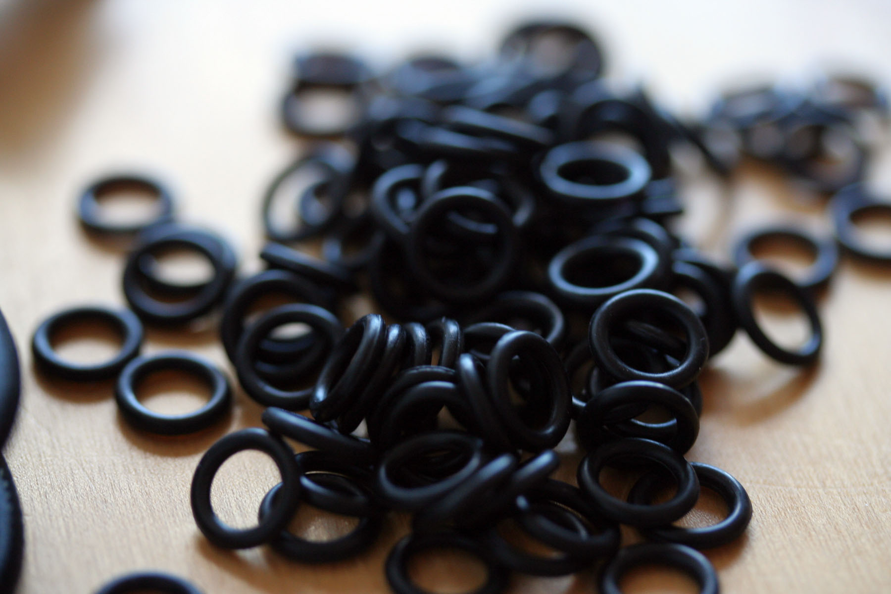

Here's where that bag of o-rings comes in. CM doesn't mention them in the documentation, but you can guess why they come as standard. We testers mentioned we were using our own to attempt a fix. Because if you pop o-rings on your caps, there is a difference. It depends on the caps, but you can get some edge off that rattle.
Conveniently bundled…
Lord of the Rings.JPG (206.44 KiB) Viewed 29790 times
The bag has more than enough rings for the entire keyboard. So when I put on my DSA Dolch set, I went a bit agressive. After putting an o-ring on every key besides the function row, I stacked two o-rings under all the mods, and no less than four under the rattliest key of all: the space bar. Two went on the middle, and one on each of the stab mounts. DSA seems to be a great profile for trying this, as it's been quite successful. I'm still short of the choral Topre thock on my NovaTouch, but it sounds much sweeter to my ear than it did with no rings at all. The space bar's actually quite nice. Well, if you're used to MX and not a Realforce.
To be fair, this is all subtle stuff. But then we are keyboard conoisseurs! As I have my NovaTouch right now, the function row has no o-rings at all and even those keys are more pleasant to me than MX brown or clear. (Or blue or any other MX switch in all honesty.) Yet they feel a bit lacking compared to the ringed keys, and sound it too. And surely all the more compared to native Topre boards. This all seems a bit odd on a high end keyboard.
O-rings are definitely a hack. But at least they come for free.

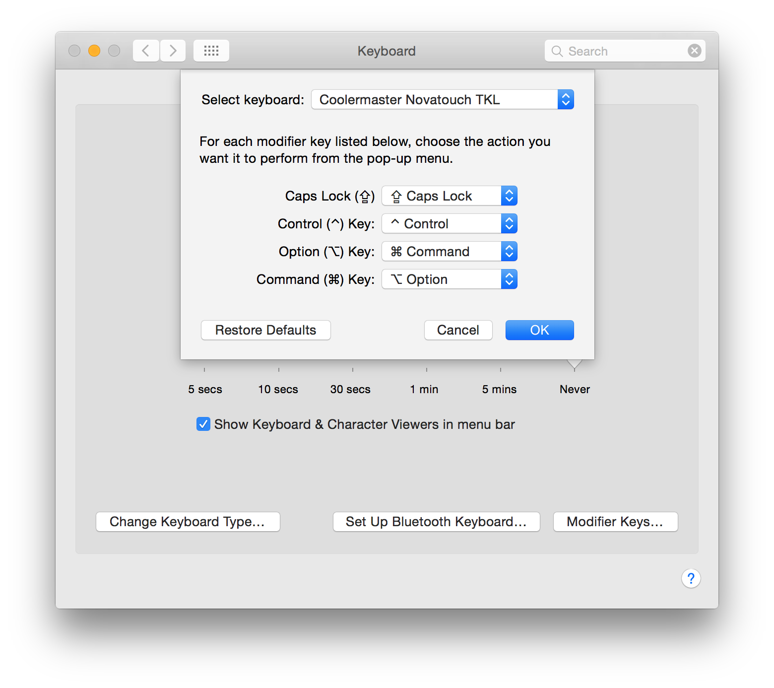

Speaking of mods, the NovaTouch behaves quite nicely on a Mac, with a tweak. The one thing it's missing is a set of DIP switches underneath, so you can't swap the mods around in hardware. Instead, off you go to the Keyboard panel in System Preferences:
Mac Mods Config.png (220.42 KiB) Viewed 29790 times
Command and Option are reversed. PCs like to put Alt either side of the spacebar, but Macs keep that spot for the all important Command key. Flip 'em and you're done.
That's fine on OS X, which will remember your settings between different keyboards. But iOS lacks such a feature, so if you do hook up a wired keyboard to your iPad, you'd better watch out. It does work perfectly well within such mobile hardware's tight power draw limit, unlike the surprisingly hungry HHKB. Sometimes it helps not to pack a hub.

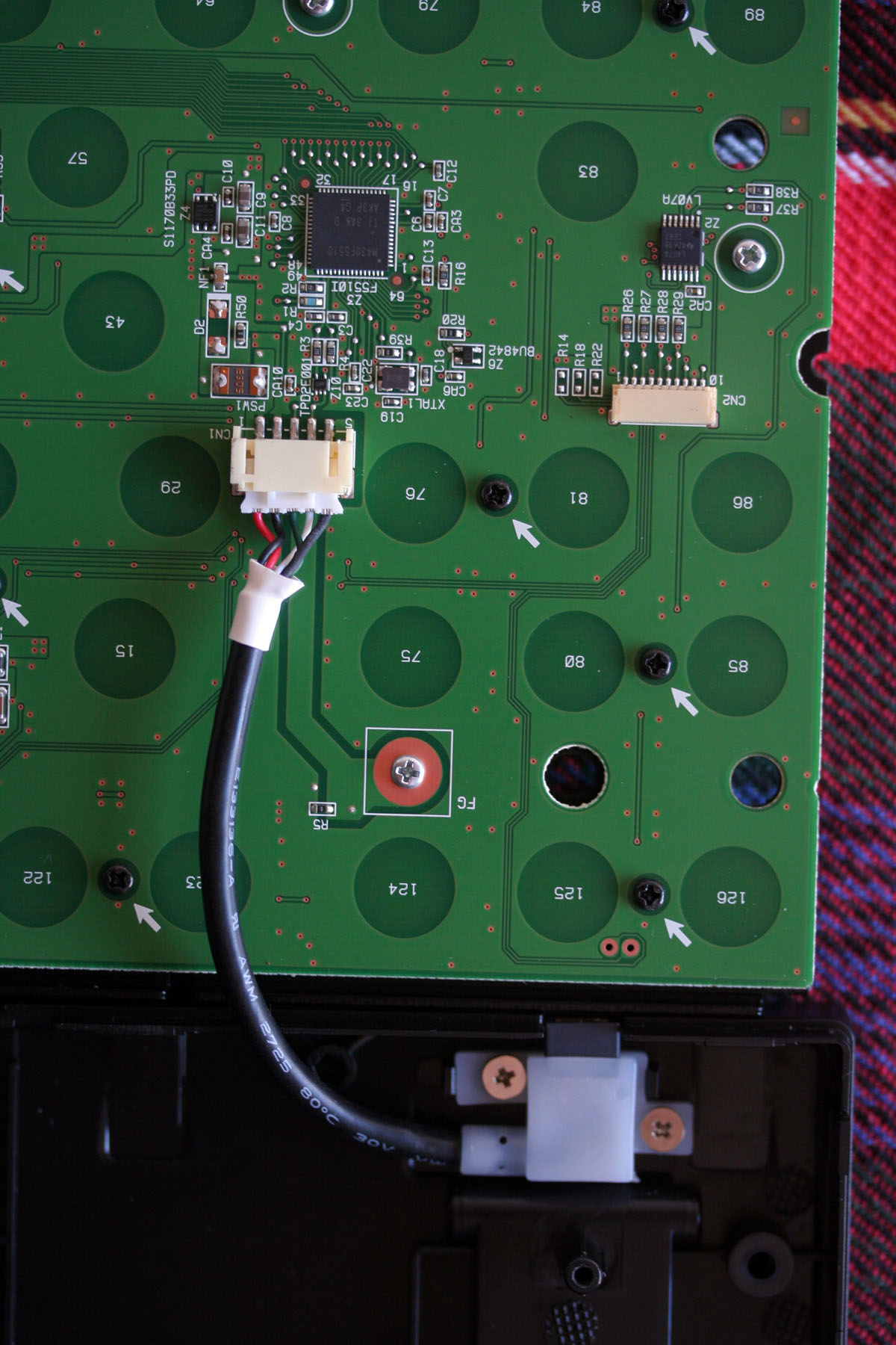

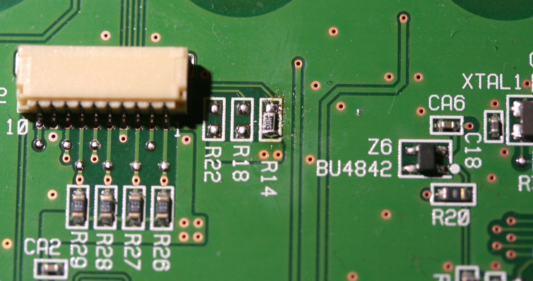

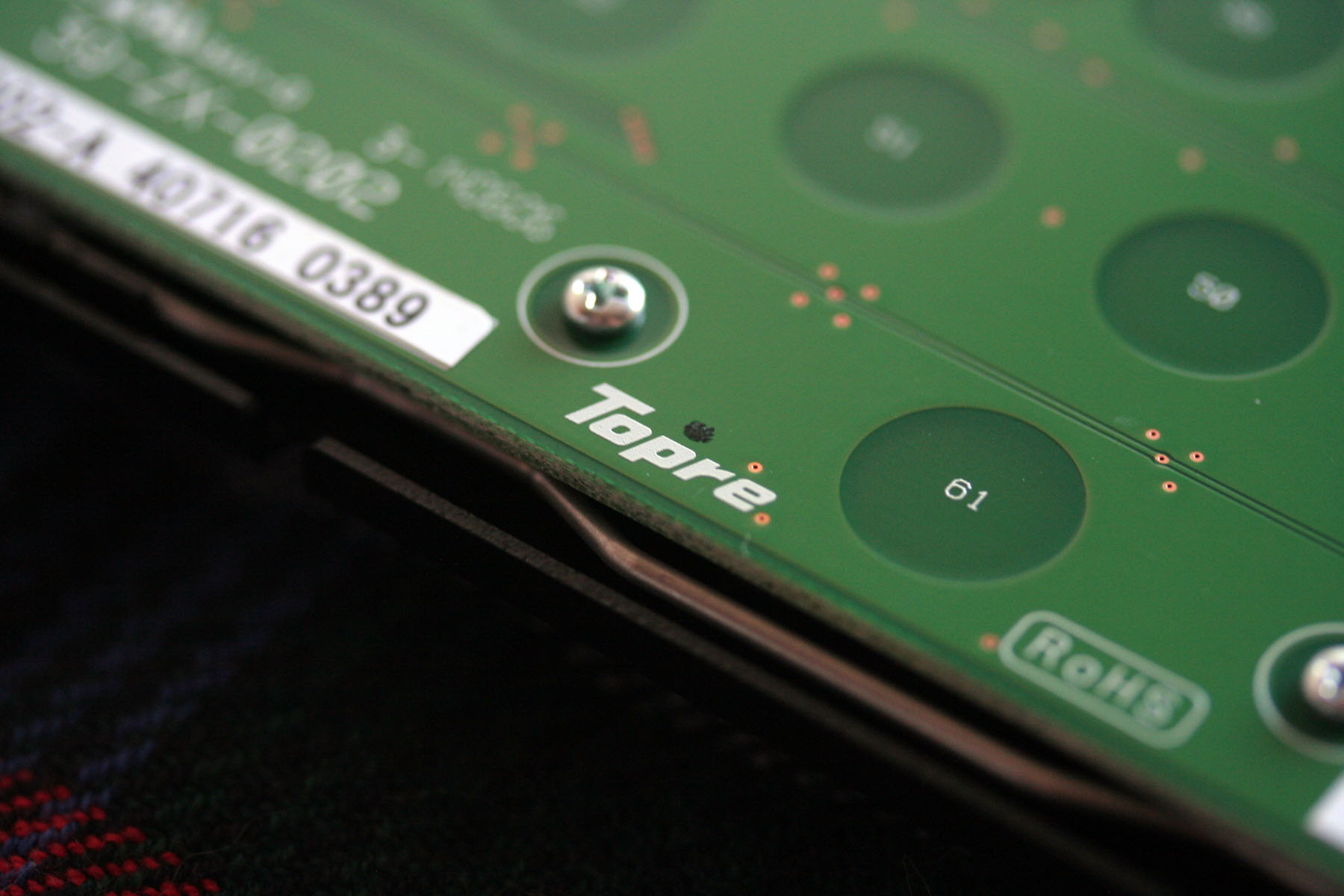

The NovaTouch is a joint development between Cooler Master and Topre. Here's the PCB.
Topre sighted at last!
I don't know the inside story of its development, but I can see the result. The rattling didn't get any better, despite our feedback. Given how long this board has taken to ship, there was time to do something about it. I really expected the final version to be reworked. Because, if not for that clatter, the NovaTouch would be a nigh perfect keyboard! The case design is sterling. The prototype had every element of potential greatness about it. If only they'd improved it to the final release, the NovaTouch would be that champion I considered at the start of this review. But it ain't quite so.

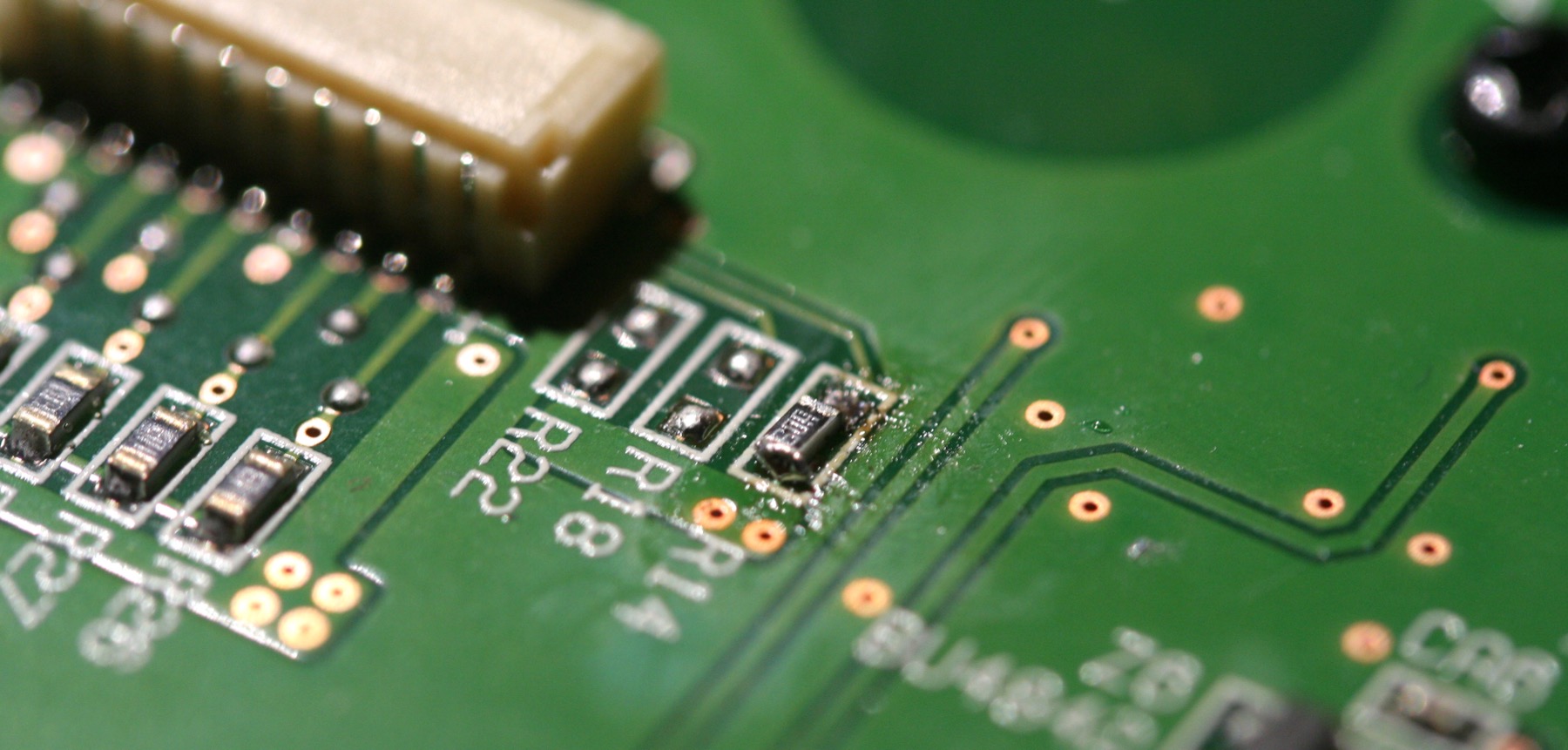

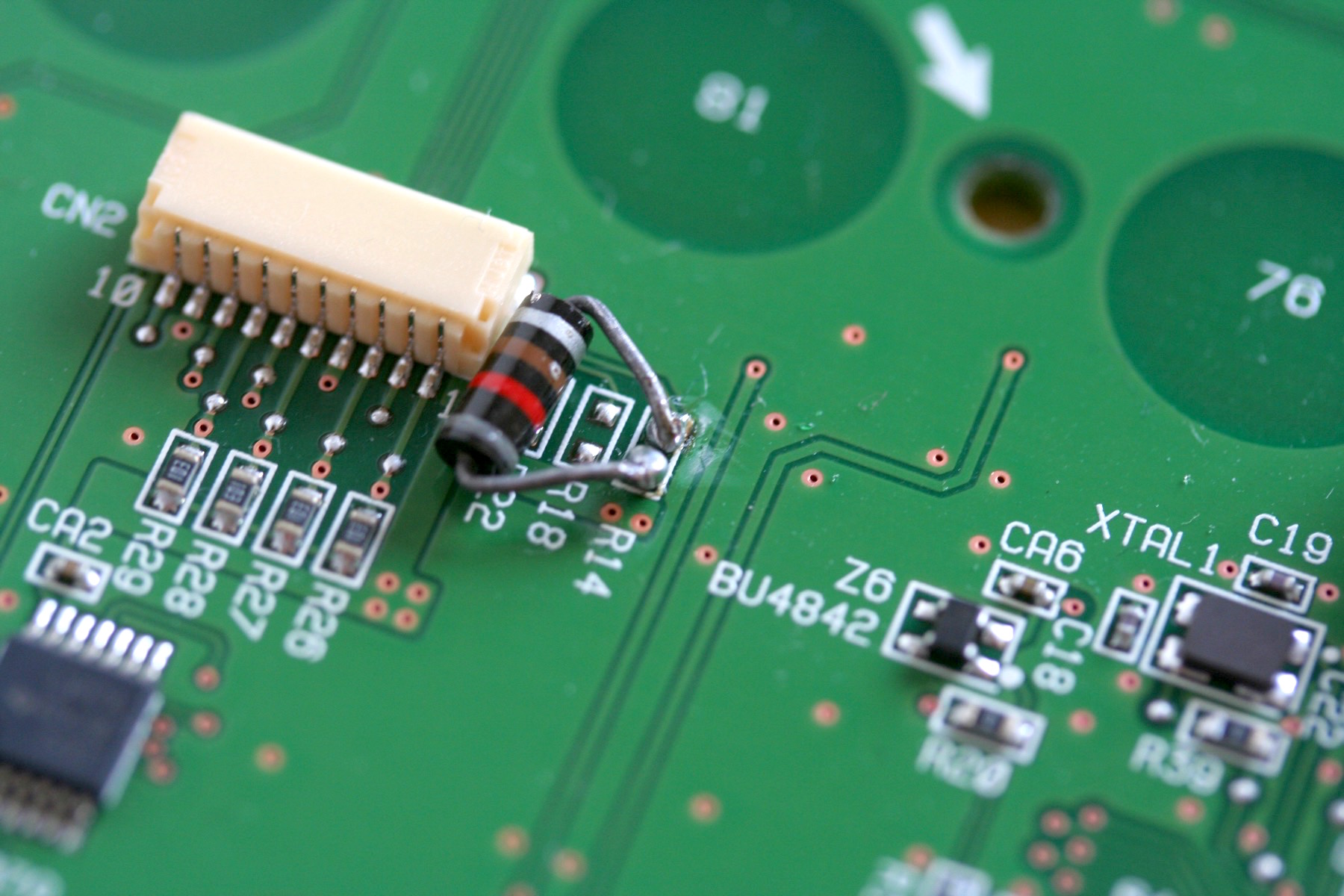

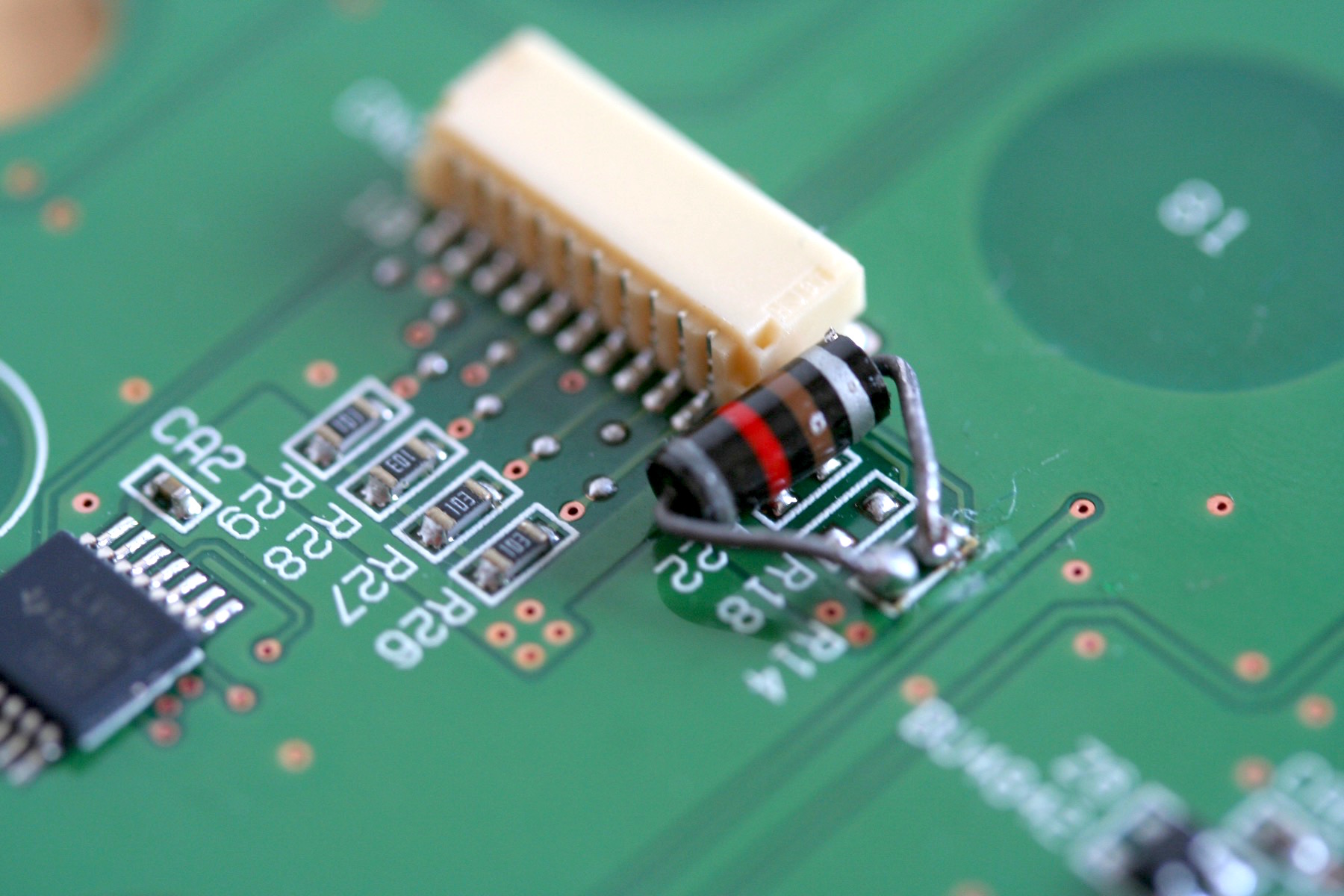

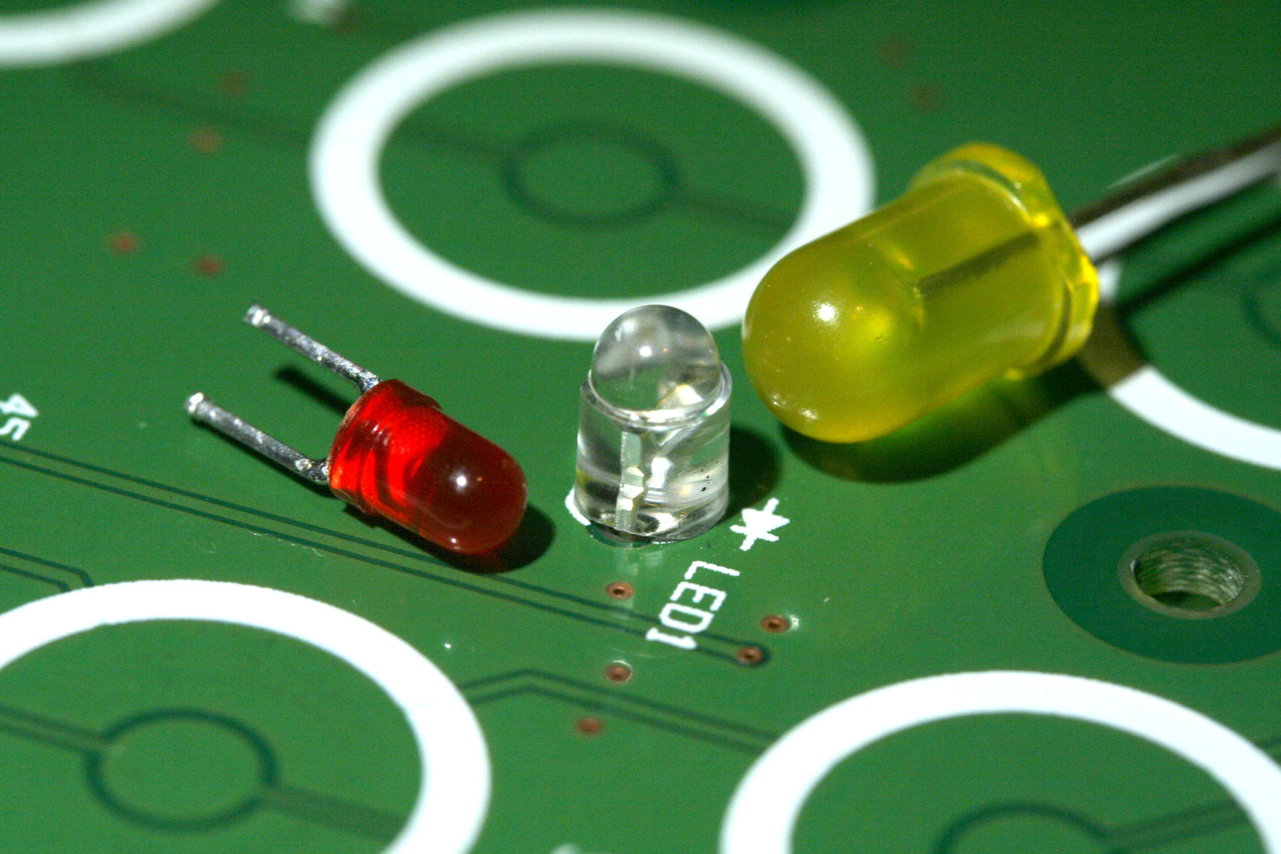

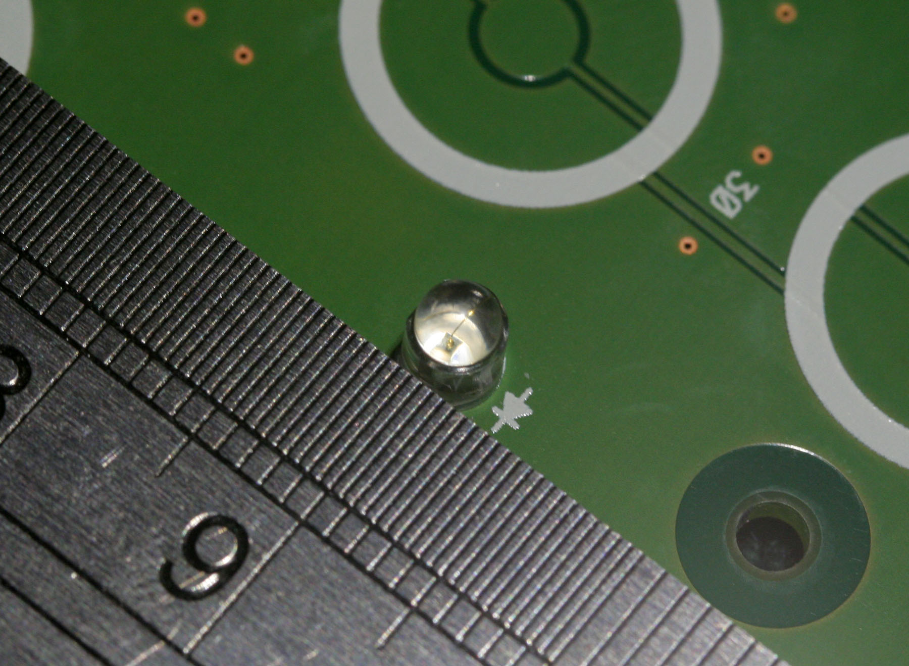

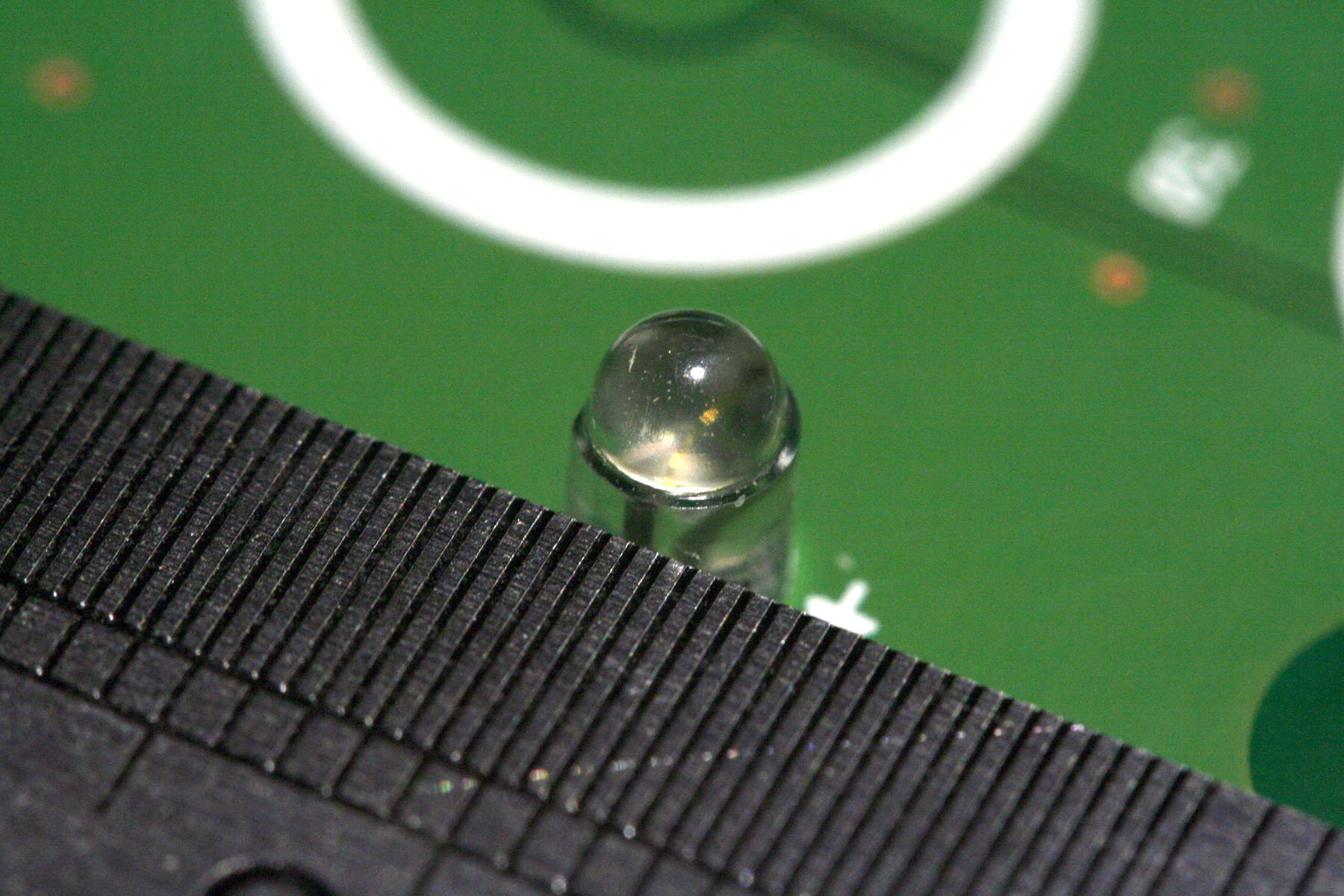

The one thing that got worse was the lock lights. The NovaTouch smartly goes without a dedicated area on the top to display them, like many larger boards. Instead, on the prototype anyway, the NovaTouch has lock lights tucked down with the keys. So the Caps Lock indicator lives under the Caps Lock key, just where it should. Great. They were blue LEDs, but they hid away under my fancy caps quite nicely, with just a glow creeping out around the edge. I could see when I'd accidentally hit Caps Lock, that most useless of keys. I was pleased.
Pleased until the lights plain vanished on the final model! CM just removed them. You can still even see the footprints for the LEDs. I'm told this was because they weren't happy with the 3 transparent caps they were using on those keys: Caps Lock, Scroll Lock, and F9, the Windows key lock lock mode I mentioned on Fn + F9. The prototype warns you with a blue glow when they're engaged. But the final NovaTouch keeps it secret. The first you realise you hit caps lock IS WHEN THINGS TURN SHOUTY!
Please Insert LED.JPG (341.12 KiB) Viewed 29790 times

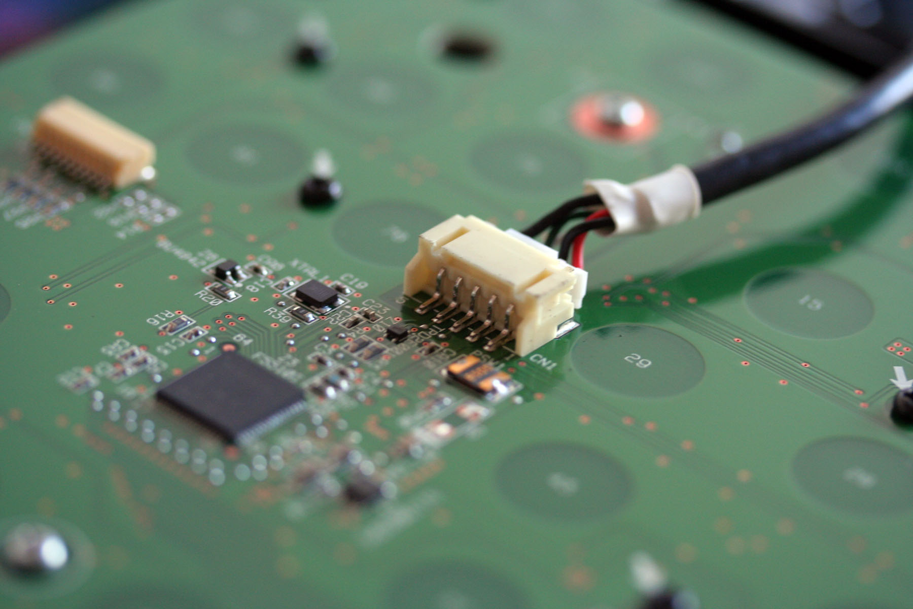

Watch out for the internal USB cable. The little micro USB socket is well anchored in the case, so even nasty tugs on the outside cable won't harm the NovaTouch within. This is how CM flipped the socket around so easily, too.
Socket and Controller.JPG (290.28 KiB) Viewed 29790 times
Here's the vital capsense controller, dwarfed by the hookup to the off-board USB port. It's tiny. So much smaller than the 1980s hearts of my old IBMs, but the same fundamental idea.

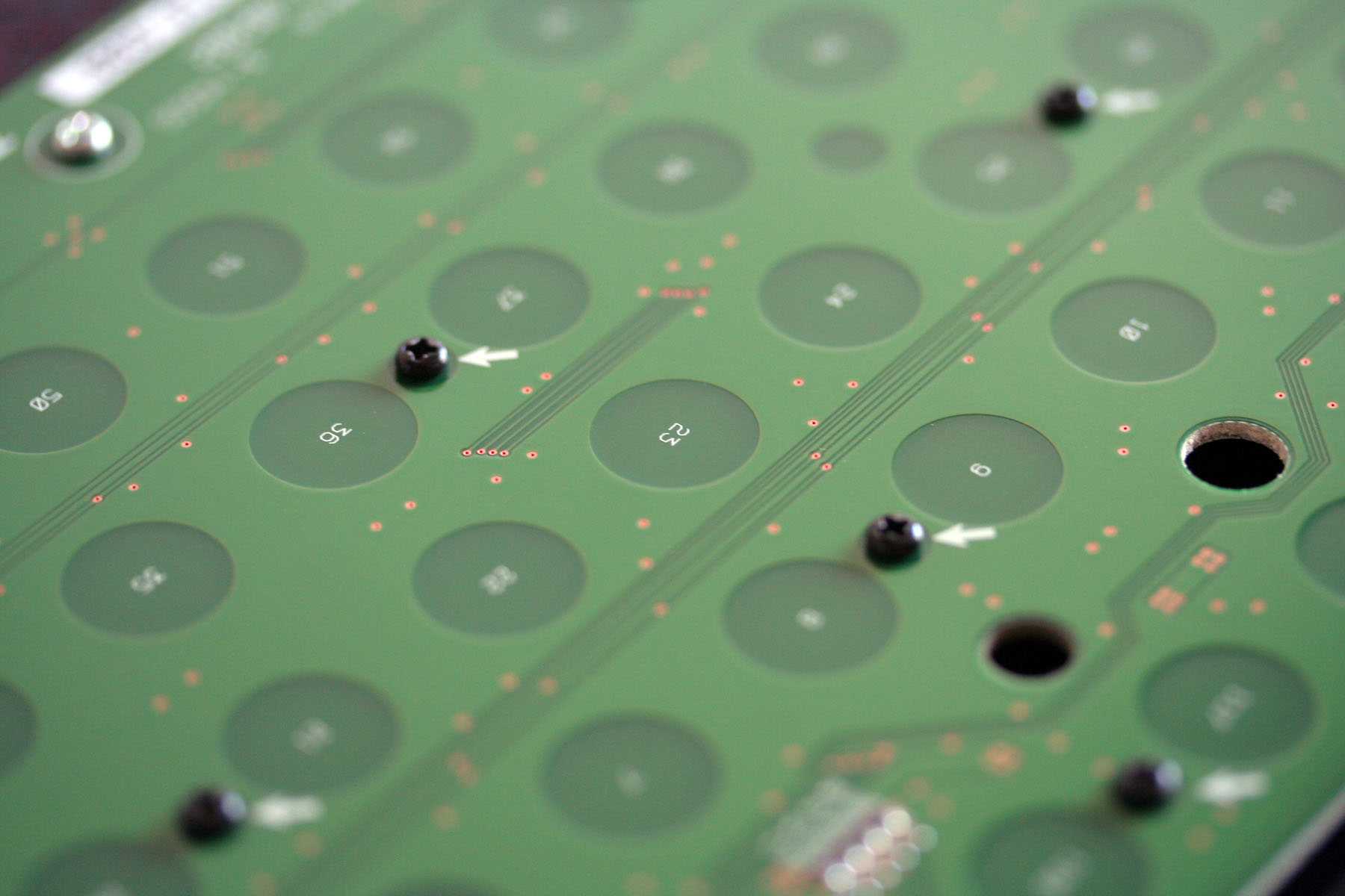

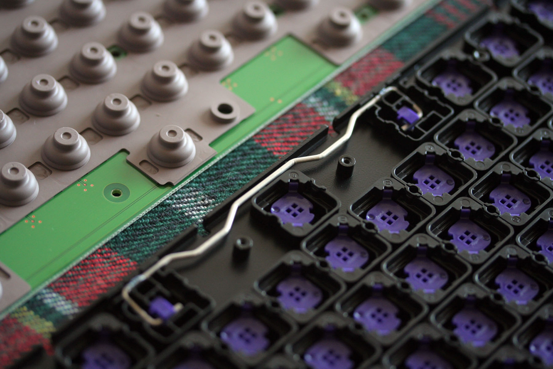

The PCB is well attached, to put it lightly. Two different families of screws hold it down, in their dozens. Make sure you've got a good little screwdriver. It's in for a workout.
Those circles are the capacitance sensors which make every Topre tick, one dedicated for each key. The controller probes all of them for changes, at 1000 Hz.
With the screws all removed, now you peel the PCB up from the chassis. It's not flimsy, by any means, but you'll see.
Underneath the PCB, you finally get a sight of Topre's secret sauce: the domes. The rubber sheet sticks to the underside of the switches, and you may well have a shower of springs when you peel them free!
Domes and Spacebar Stab Wire.JPG (261.18 KiB) Viewed 29790 times
Topre switches are that most elusive of things: a premium rubber dome. The feel comes entirely from those domes. The cone shaped springs are just for electronic sensing. In fact, I kept the spring out from the Insert key on purpose, and it feels just the same as the rest; but never fires a keystroke.
Topre feels so good because they don't cheap out on the dome material, and more important still: the switches fire near the top of travel. You don't have to bottom out like you do on traditional, cheap, rubberdome membrane keyboards. Topre is capsense: the spring inside each switch sits above a circular sense pad on the PCB which measures its capacitance a thousand times a second. Once a threshold is reached, the key fires. You don't have to bottom out to press it. In fact, these are among the highest firing switches in existence. Brilliant for flying around lightly on the keys.
"A feeling of oneness with cup rubber", as Topre puts it, rather mysteriously. Trust me, you might just find out what they mean!

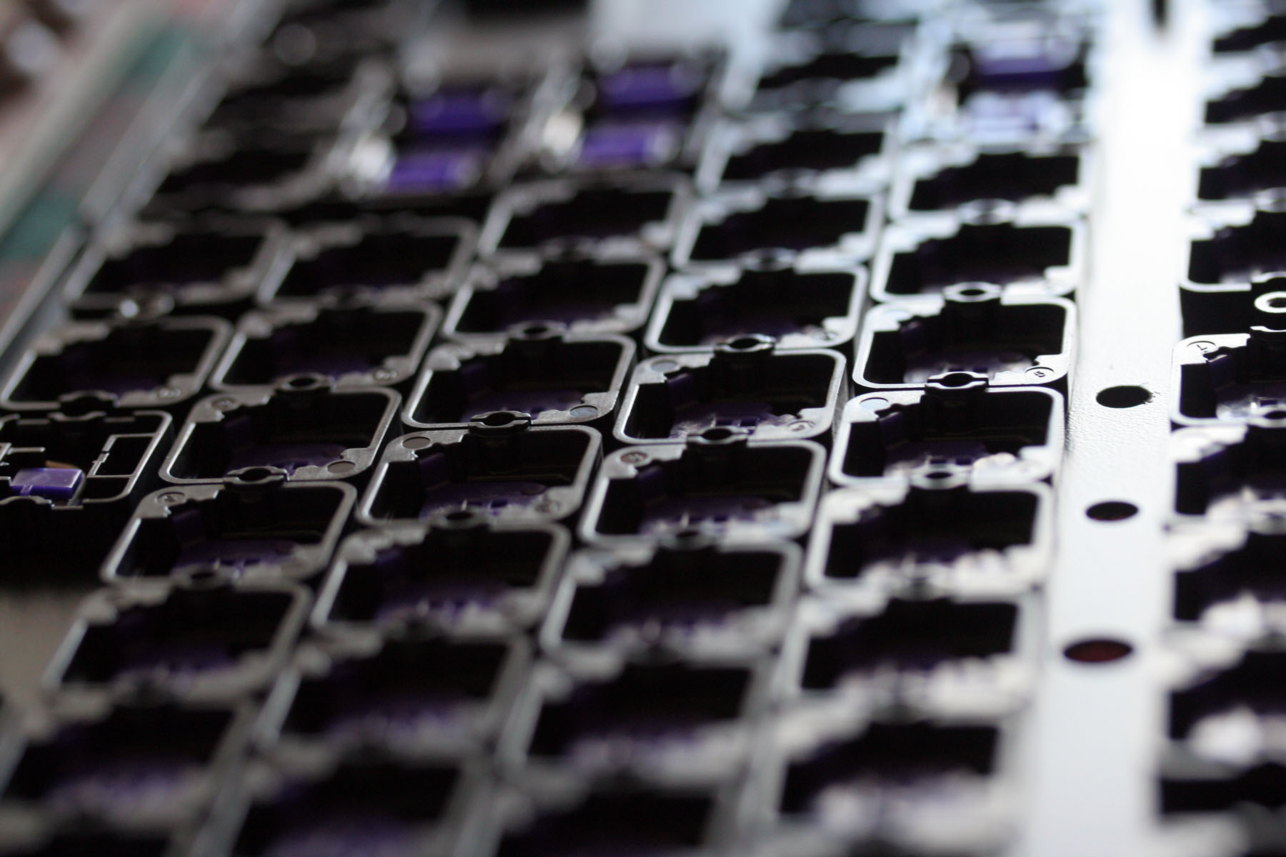

The NovaTouch differs from other Topre boards in its sliders. Here they are, viewed from underneath.
The stabs are rather smart. Like Cherry stabilisers, the wires lie underneath and you don't have to worry about installing inserts when changing caps.
The stabs under the Shift, Return and Backspace keys are essentially just larger sliders.

The spacebar's stab is very much like a Cherry stabiliser. It's the loudest of the bunch, unfortunately.
Spacebar Stab.JPG (224.86 KiB) Viewed 29790 times

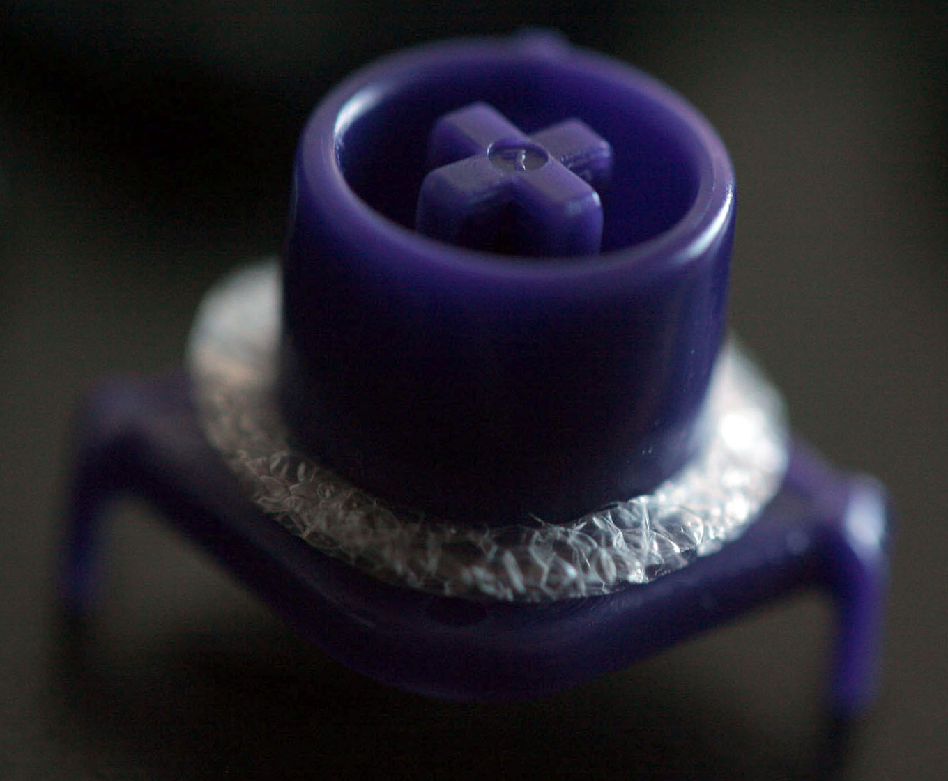

I took my NovaTouch apart because I had a mod to try. Cookie sent me some "Ghetto Topre Type-S silencing rings". Simply put, they're a quick hack to add the damped, silenced, Type-S premium Topre feel to regular Topre switches. He uses them on his HHKB, and saved a pretty penny!
Frilly Collared.JPG (156.76 KiB) Viewed 29790 times
Finally the purple slider doesn't lie. This chap is now one silent switch.
Installing these dampers is a little fiddly, as you have to prise the sliders out of their housing while squeezing a little catch on every switch. A fair old bit of effort then, yet it does help quite a bit. I only have a handful, so I couldn't silence the entire keyboard, but the thin foam circles are very effective under regular sized sliders. They work a bit on stabilised keys, too, but not the space bar. I need to devise a different shape for that.
Since CM is generous with o-rings, I even tried one of those instead! A rubber ring is much thicker than a foam pad, and the right Shift key is visibly shorter now that it's installed. I wouldn't advise this as a real fix, but it's a harmless experiment to try if you do delve inside. And I'll empathise if you'd rather not.

You're right about the rattling of course, Cookie. For all of the promise in the NovaTouch, it really falls short compared to a fully developed Realforce. It sits somewhere in between MX and Topre keyboards, quality wise, but with that superpower of handling the other guy's caps. Definitely first generation kit.
I'm all ears about your new dampers! I need to get inside this keyboard again, for a few more experiments, including trying an actual Topre slider to see if that makes a difference. Still not quite sure what exactly is slapping what!
And you are spot-on about the caps. If only CM bundled a nice PBT set. That would go a good way to earning the NovaTouch the higher price point it is placed at. We need to get them in on one of our group buys…

How it feels with SA?
21 Oct 2014, 14:46
The best, as always! They are my favourite caps. Always nice to be able to use them.
Much like on MX, you also get this effect where the switches feel lighter with taller keys. The NovaTouch feels heavier when I put on short DSA. But in reality, it is always 45g.

Cookie, is the material you're experimenting with anything like this? It appears to be designed for mounting displays in mobile devices and is very thin. I'm trying to duplicate your silencing efforts on a HiPro and have samples of that material coming in 0.1, 0.15, 0.25 and 0.3 mm thicknesses.
ماء
21 Oct 2014, 15:41
cookie
21 Oct 2014, 16:08
@mtl What you have posted is very interesting but I think 0,1 and 0,15 could be a bt to thin. I'd go for the 0,3mm thickness tbh. The goal is to to reduce the sound as much as possible without a noticable impact on the key travel. 0,5mm was a nice thickness and I will stick to it for now.
I am experimenting with this:
These are table tennis sponges, and I am looking for a verry fluffy one.
I am currently in touch with a seller and I asked him for some samples, if you are interested I could produce some "Dampering Kits" for you guys. But we should discuss this in a different thread. I really do not want to highjack Mus awesome review thread for that :)
@ماء I don't think you will get pleasing/consistent results with this method. Those O-rings look way to thick.

Can you tell me what size LED that is? I'd like to mod mine to have a lock light on it.
29 Oct 2014, 20:34
great review Mu, my conclusion form your in depth look at the NovaTouch is that this might be a really great keyboard one or two generations down the production line. Let´s hope so!
29 Oct 2014, 22:35
Thanks. I've heard a rumour that work is indeed underway on just that. So we'll see!
@piegoesmoo: I've got my NovaTouch stripped down to the PCB right now to investigate this, along with swapping around some of Cookie's dampers. Looks like 2 mm to me, but I'm guessing based on the handful of loose LEDs I have. Apparently blues shine brighter than other colours, so maybe the red one I intend to put in will be a bit dimmer; which is fine by me. Guess I'd better get the prototype stripped down to the board as well, so I can really see the originals.
chzel
29 Oct 2014, 23:03
The led is most likely 3mm. Leds smaller than 3mm (2mm, 1.8mm, 1.5mm, etc) are used in quite special applications and most have square bodies with a cylindrical protrusion, in lieu of a light guide.
29 Oct 2014, 23:22
Okay, here's a couple of my LEDs lying next to the prototype's original:
Definitely smaller than the large round ones I've got plenty of. And maybe just a little larger than the lonely red 1.8 or 2 mm fella in my random collection. I'm tempted to desolder one of the prototype's less interesting two LEDs, and pop it into the final NovaTouch's empty Caps Lock position. Juding these PCBs, both naked side by side, the other components (resistors and such) all appear to be in place, although things are a little different between the two as one is ANSI and the other ISO. Not identical layouts for component footprints; just similar.
Now, what's the best way to get the polarity right on these wee chaps again?
Nuum
29 Oct 2014, 23:26
If you look trough the transparent plastic head, the side with the big metal "flag" is the negative pole.
29 Oct 2014, 23:31
Right, the "big" side is the cathode, I think I've heard of that. Harder to tell with deep coloured ones like my red, though!
I don't have calipers, but here's a ruler:
The scale is half millimeters. And it's dark here, so the little lamp I was using for lighting gets in the way of overhead pictures.
I wonder if it's safe just to pop in my own red one? I would prefer a dimmer, redder Caps Lock on my final ANSI NovaTouch.
chzel
29 Oct 2014, 23:33
Muirium, 99% the red in the pic is 3mm, so I'd think the lock led is just a funky shape.
If you look closely, one of the two metal bits inside the led is larger with a "cup" on top. That is the cathode (-).
edit: in your pic the red's cathode is the top one.
edit 2: crappy cell phone pic for led size
5mm 1.8mm 3mm

05 Nov 2014, 13:27
So, here's where I'm at. The prototype's whole PCB is populated with components, while the final model has a trio of empty footprints, one for each of the 3 supported LEDs. These are right beside the internal cable socket which leads to the micro USB port on the back. I measured them at 150 ohms, if I recall.
Here's what my final model PCB looks like just now, as I installed an LED in the Caps Lock position, and tried to graft on a standard sized through-hole resistor of my own. The scale gives you an idea how small the SMD components are! It doesn't work, but that's likely because I used too high a value resistor (>900 ohms I think).
Looks gnarly, right? But I did test for shorts of course. I likely just need a better value resistor.
My brother gave me some surface mount resistors, so I'll measure them and see about fitting one instead.
Quick question: given the same voltage and resistor, do blue LEDs shine brighter or do red? I transplanted a blue LED from my prototype in to avoid making value mistakes. But I do prefer red really!

I'd put a bridge instead of a resistor and measure the voltage and amperate with an ohmmeter.
After that you can calculate what resistor you need for a certain LED.
That should be the safest way to do this.

Muirium wrote: Quick question: given the same voltage and resistor, do blue LEDs shine brighter or do red? I transplanted a blue LED from my prototype in to avoid making value mistakes. But I do prefer red really!
Nothing set in stone, there are high/low efficiency leds, so it depends.
As a general rule, greens are the most visible (our eyes' sensitivity peaks at green), and blue/white are the easiest to find efficient ones (needing less mA for a given brightness).
But don't forget, blue leds for indicators are the equivalent of Comic Sans in a formal document!
BTW measuring resistors in situ is not always correct, you could be measuring parallel resistances. Go by the markings!
08 Nov 2014, 17:56
Caps Lock LED installed and working! My brother brought around some SMD resistors and kindly installed one with a value of 200 ohms (so a bit higher than the stock resistors would have been) which is marked with the code 30A. This immediately brought the blue Caps Lock LED to life when I tested with the bare PCB hooked up via USB. (You can actually trigger Topre switches with your bare fingers on the capsense pads, without any need for springs. Or mine work at least!) I'm using a bright blue LED, taken from the prototype NovaTouch's redundant Scroll Lock position (ignored on Macs), and 200 ohms works well with it. Could probably even dim it down with a higher value. But SMD is fiddly and I'm fine to leave it at this success!
So: install an SMD resistor (in position R14) and your own LED, and your NovaTouch can indeed have a working Caps Lock indicator. Tada.

My final production NovaTouch had no LEDs either, until now. I borrowed the Scroll Lock LED from my prototype, which has all three. That's the reason there's three resistors too. R14 is the one for Caps Lock. R18 and R22 hook up to the other missing LEDs. Although the final NovaTouch has no holes in its case for those LEDs to be installed so easily.
Here's my brother's SMD handiwork, spied by the macro lens:
The "30A" (aka 200 ohm) resistor he installed is even smaller than the PCB's footprint was intended for. But with tweezers and a soldering iron, he got it in place in mere seconds, on the first attempt.
The fluxy mess is from removing the gigantine (regular sized) resistor that I'd installed before! That one was just too much resistance. 200 ohms works great.
Meanwhile, as I had it apart already, I installed a genuine Topre slider into the Esc key position on my NovaTouch. The sliders are externally different too! This Topre cap wobbles more than any of the MX ones on the board, and when I reassembled the Topre donor switch (a lonely tester from Mr. Interface's sample kit) that switch has way too much resistance, even without the dome. Looks like Topre / CM had to make these hybrid sliders wider than standard Topre, probably for the MX mount to fit.
