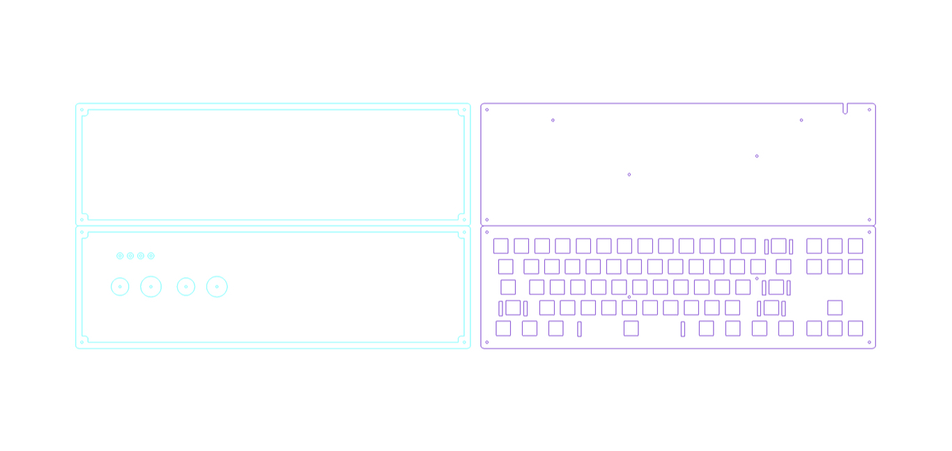

Design

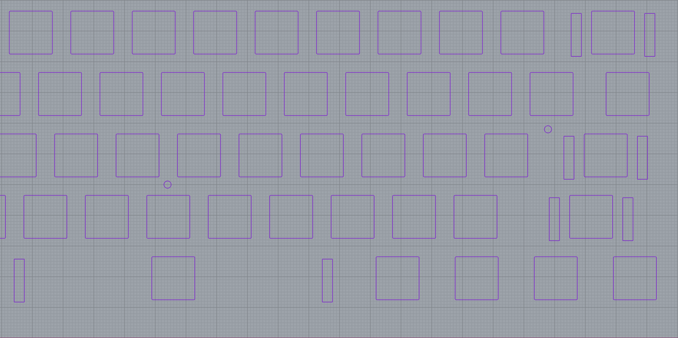

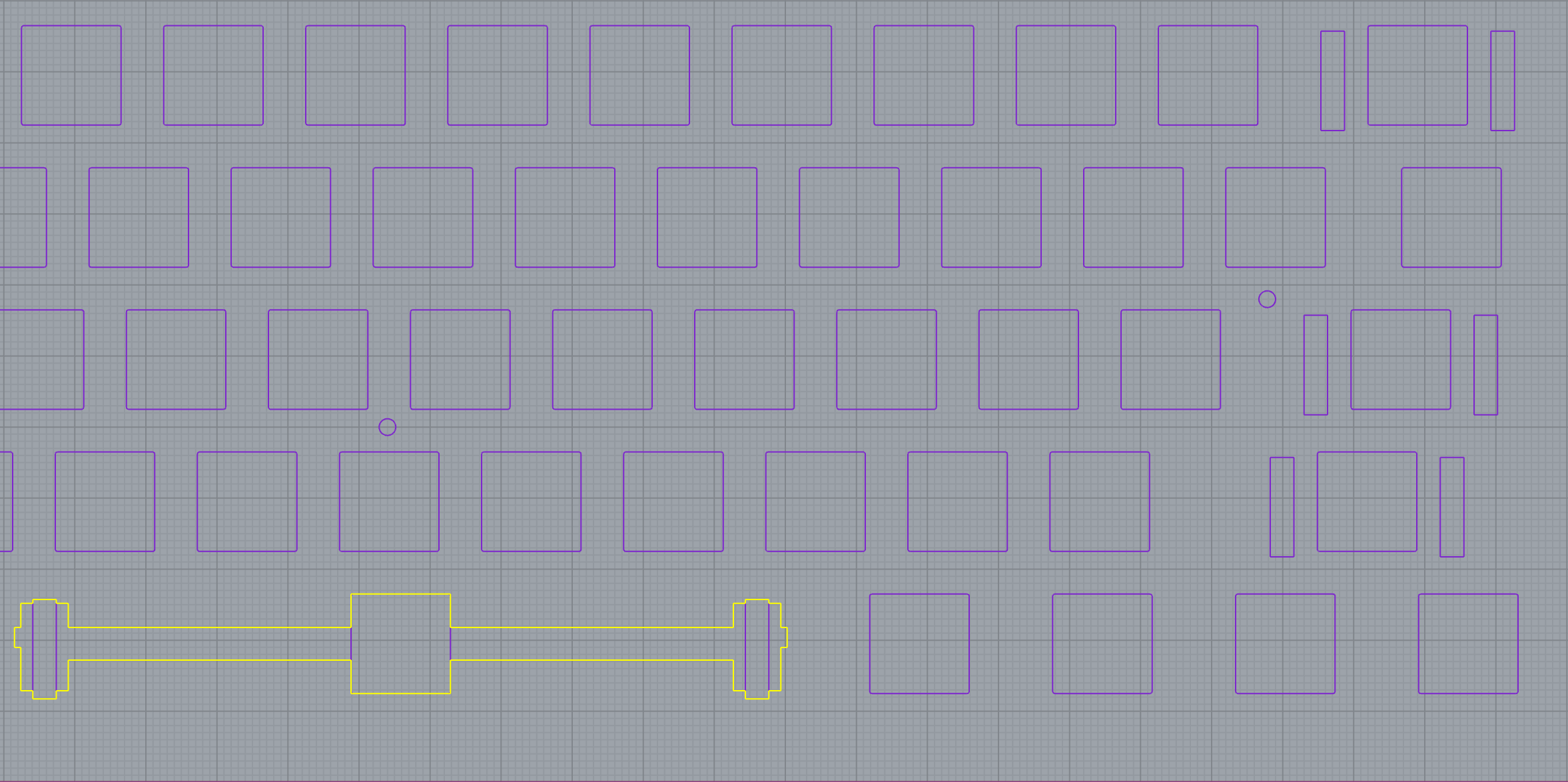

I design with Rhino - learned in college for 2D and 3D prototyping. If it ain't broken...
Decided to go with laser cut materials for cost reasons. 3D printing is so incredibly tempting, but also so incredibly expensive. Before really thinking about what material I wanted to use, I knew the sandwiching idea from prototyping experience I've had in the past would work best:
Key Layout v2.jpg (165.49 KiB) Viewed 13082 times
  • Right, or magenta colored line work are the bottom and top case files
  • Left, or aqua colored line work are the in-between sandwich pieces and the circular spacers as well as feet
I knew I needed a lot of time to consider design aspects and dimensions of this - I have wiring, switches, and key caps all to consider that I would prefer to have tech drawings of rather than measuring by hand. The geekhack forum post includes files that can provide everything you need.
After getting specs directly from the Cherry MX pdf on the cutouts for the switches, still needed to figure out how to get dimensions for the stabilizers. This ended up being the most confusing and hardest part. Cherry's pdf is helpful, but all the while only provides advice for Cherry stabilizers. I ended up wanting to use Costar (http://deskthority.net/wiki/Costar) style stabilizers from WASD keyboards, and wanted to minimize cutting on the top case - more cutting = more cost.
Below comparison images show how to pull out the Costar/narrow cutouts you might see in other posted custom jobbers. The highlighted/yellow lines are from Cherry's specs, but copied over from another generous geekhack dwg that included all sized stabilized pieces (shift, backspace, enter, space).
Screen Shot 2014-11-16 at 10.33.54 PM.png (203.89 KiB) Viewed 13082 times
Screen Shot 2014-11-16 at 10.34.25 PM.png (206.81 KiB) Viewed 13082 times
I was experimenting with using Cherry made stabilizers, but it proved to be difficult to find them in stock without a minimum order larger than I was willing to go for. Besides, Cherry doesn't make a stabilizer for common spacebars (or one that I was able find - either too big or too small). Most all spacebars are 6.25 units (read more about unit sizing here: http://deskthority.net/wiki/Unit) so I instead went for the Costar style that has very simple installation. WASD supplied all those components http://www.wasdkeyboards.com/index.php/ ... parts.html.

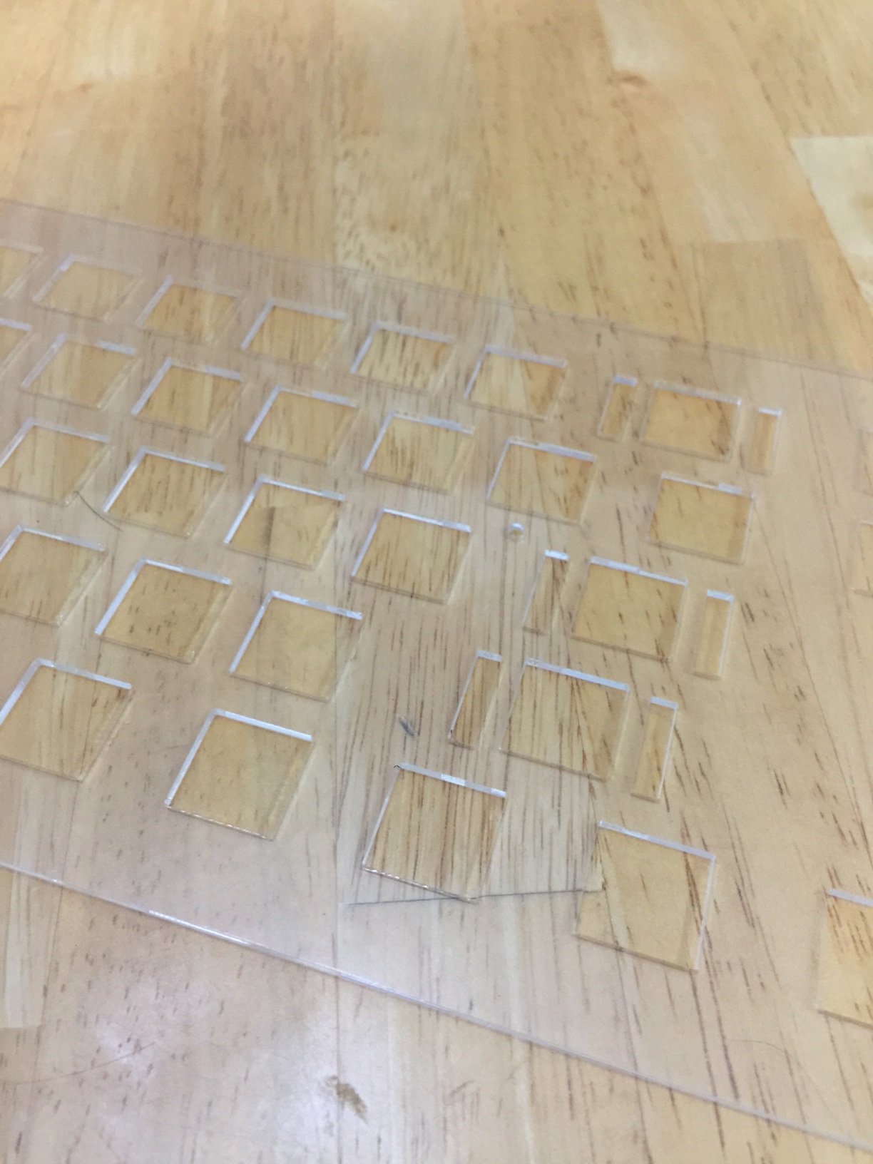

  • I initially wanted metal, such as matt3o or many other folks have used. Acrylic ended up being cost effective and the most accurate material for the thin 1.5mm I needed for the top case. For this, Ponoko had black and clear. Clear is the obvious cool-factor choice, right?
  • The middle sandwich layers needed to be thicker - Ponoko has a wider range of thicknesses for acrylic, but I decided on MDF for compressive strength, economy, and that I'd only have to use 2 layers instead of 3 or 4.

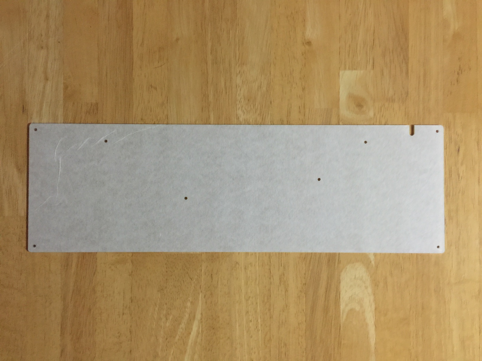

Check out the photos for the materials once they arrived from Ponoko! I took the protective covering off the top case immediately before snapping a photo, so it's harder to see - the bottom case has the visible channel cut for the USB cable to exit in the upper right.
Top Case
Top Case
Bottom Case with protective film

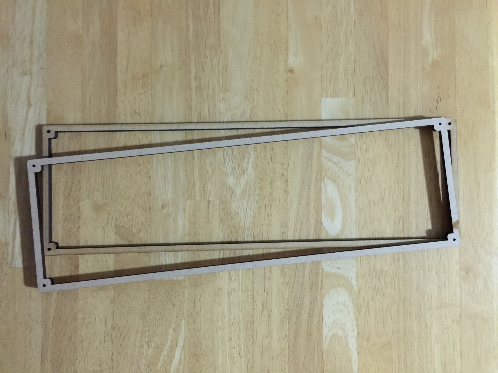

Corner of sandwich pieces

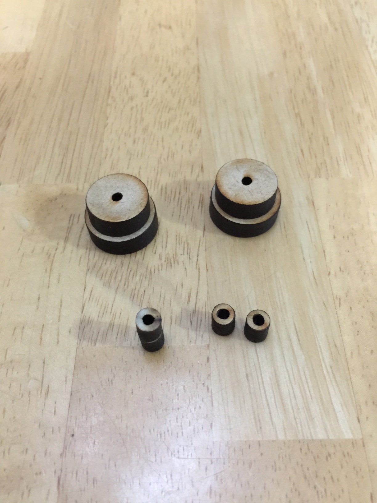

2-layer feet and standoffs for the center of the case

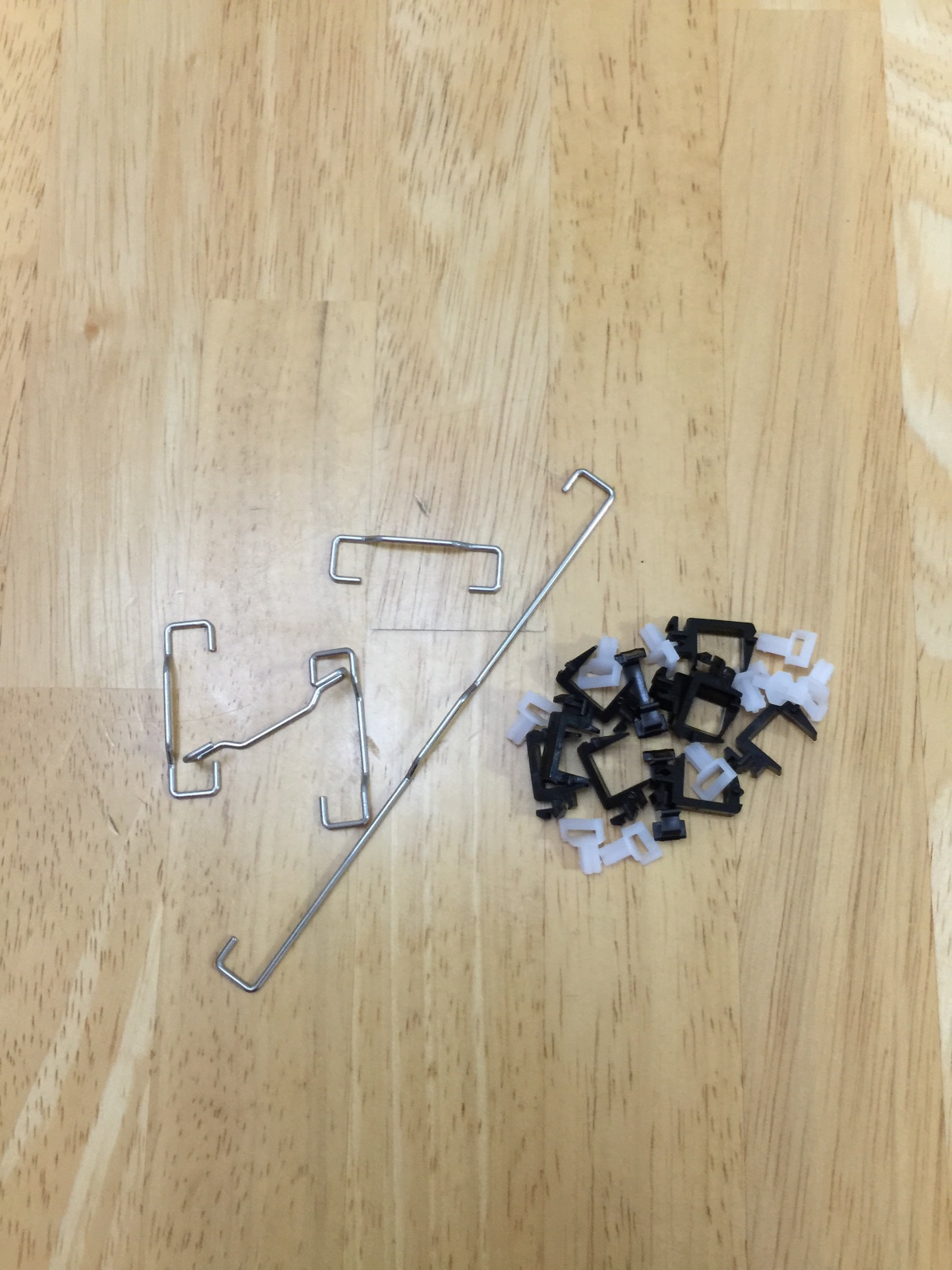

Stabilizers! Four springs for 2x shift keys, enter, and backspace (all 2x+ unit keys). One spring wire for the space bar (commonly 6.25x units). White pieces are for the key caps, black pieces are the base pieces going into the top case. I'll talk more about this assembly later. From WASD Keyboards
Stabilizer components!

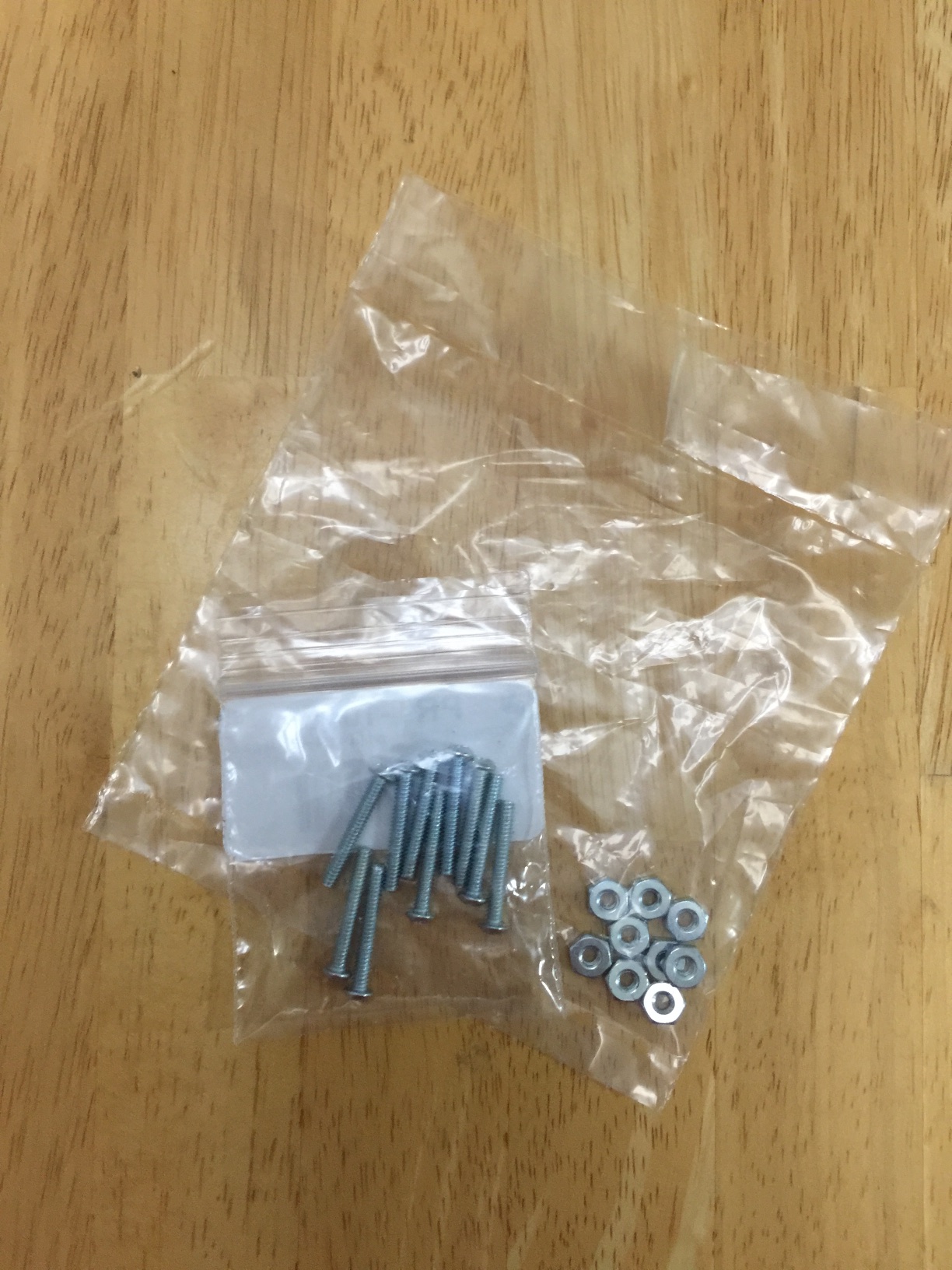

Nuts and bolts - I chose 4-40. However, if you're laser cutting, cut the holes slightly wider than what the thread widths are supposed to be (ahem, slight modification needed...) From Sparkfun
4-40 Nuts and Bolts
4-40 Nuts and Bolts

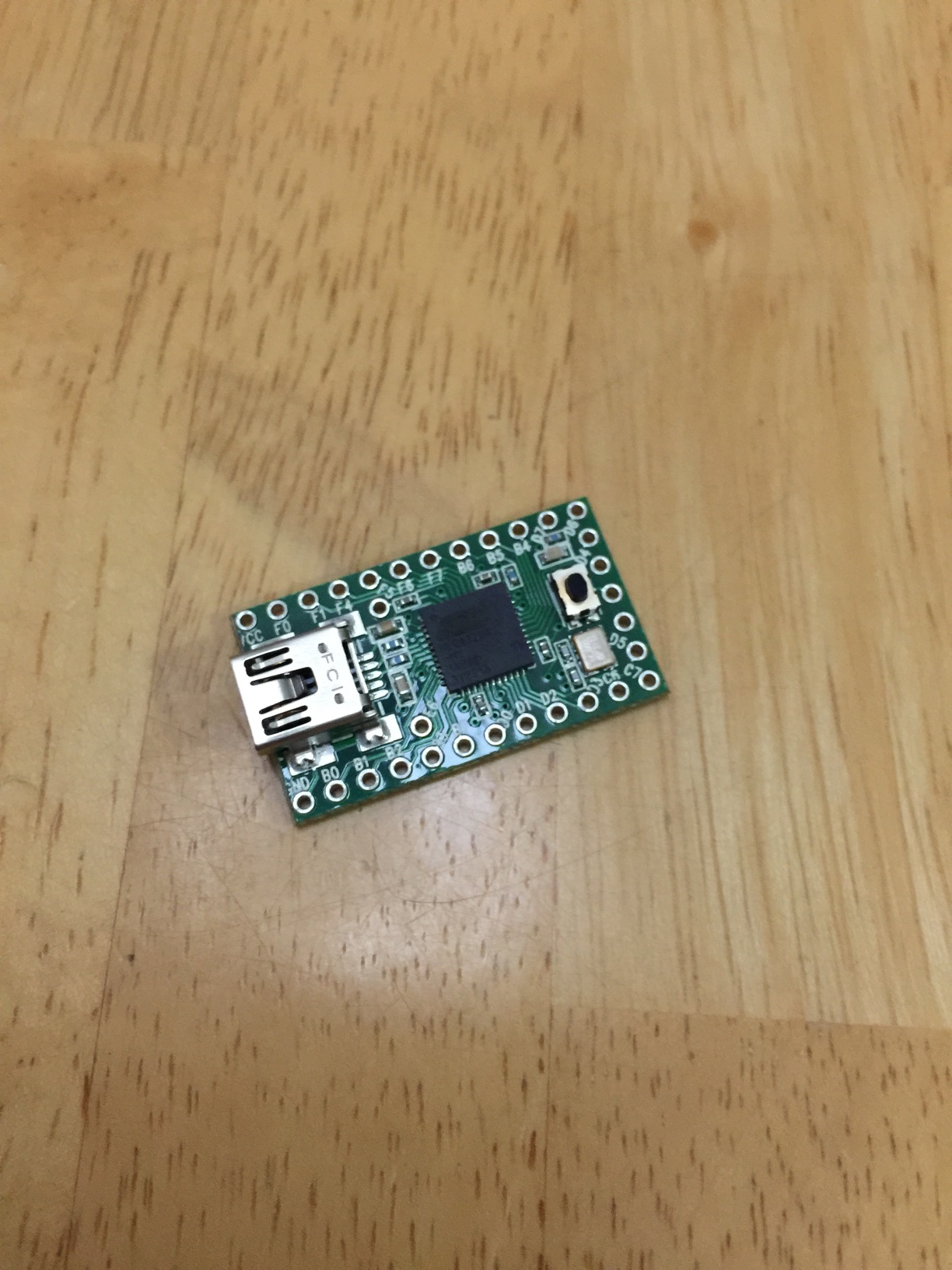

For the microcontroller, the all-famous Teensy 2.0 should do the trick. From PJRC (Sparkfun)
Teensy 2.0
Teensy 2.0

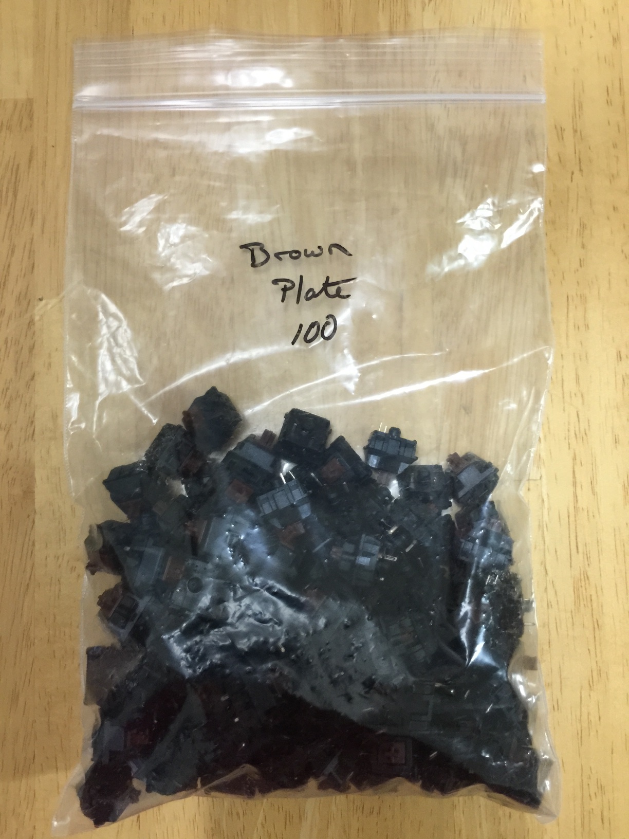

Cherry MX Brown! Switches of choice - from MechanicalKeybaords
Cherry MX Brown
Cherry MX Brown

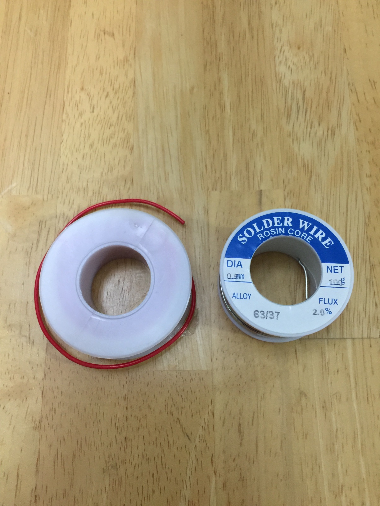

Solid 22AWG wire and leaded solder. Solid wire helps keep shape while I shakily solder them on the switches from Sparkfun
22AWG and Solder
22AWG and Solder

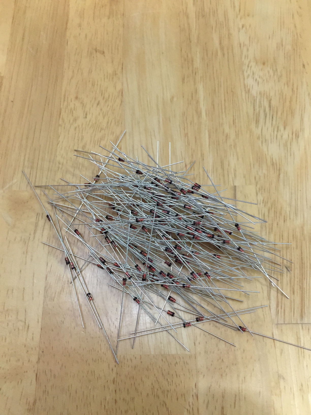

Diodes... 1N4148 are the ones of choice. These help the matrix electrical signal remain one-way. More on that from matt3o's build (and hopefully from some basic electronics knowledge) from Newark/Element14.
1N4148 Diodes
1N4148 Diodes

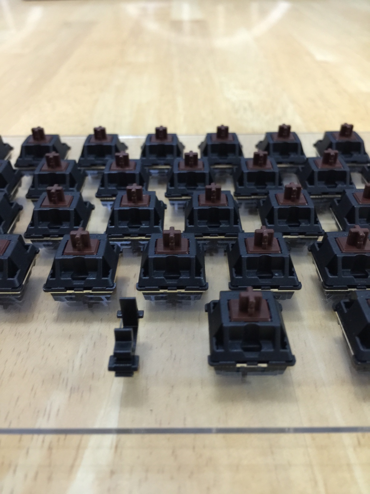

What a relief that the cuts were perfect for the Cherry switches
Cherry MX Brown!
Cherry MX Brown!

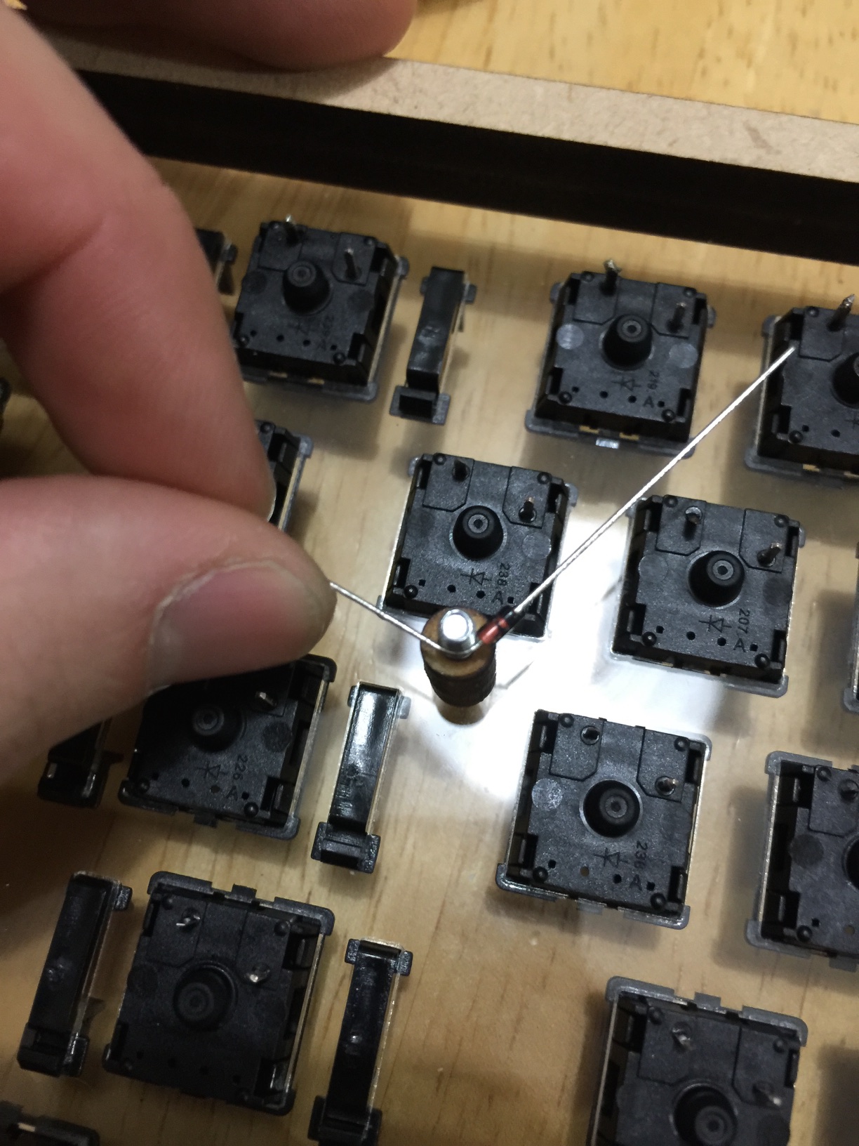

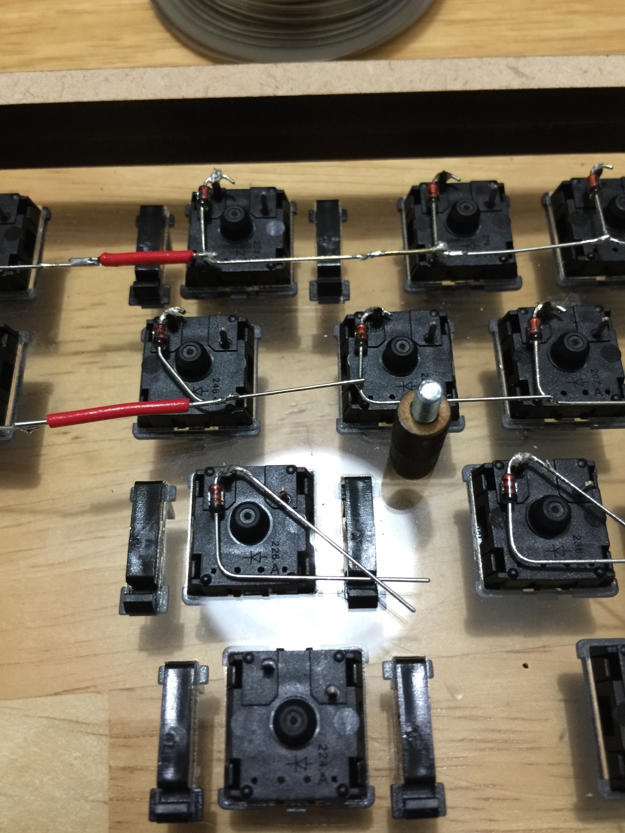

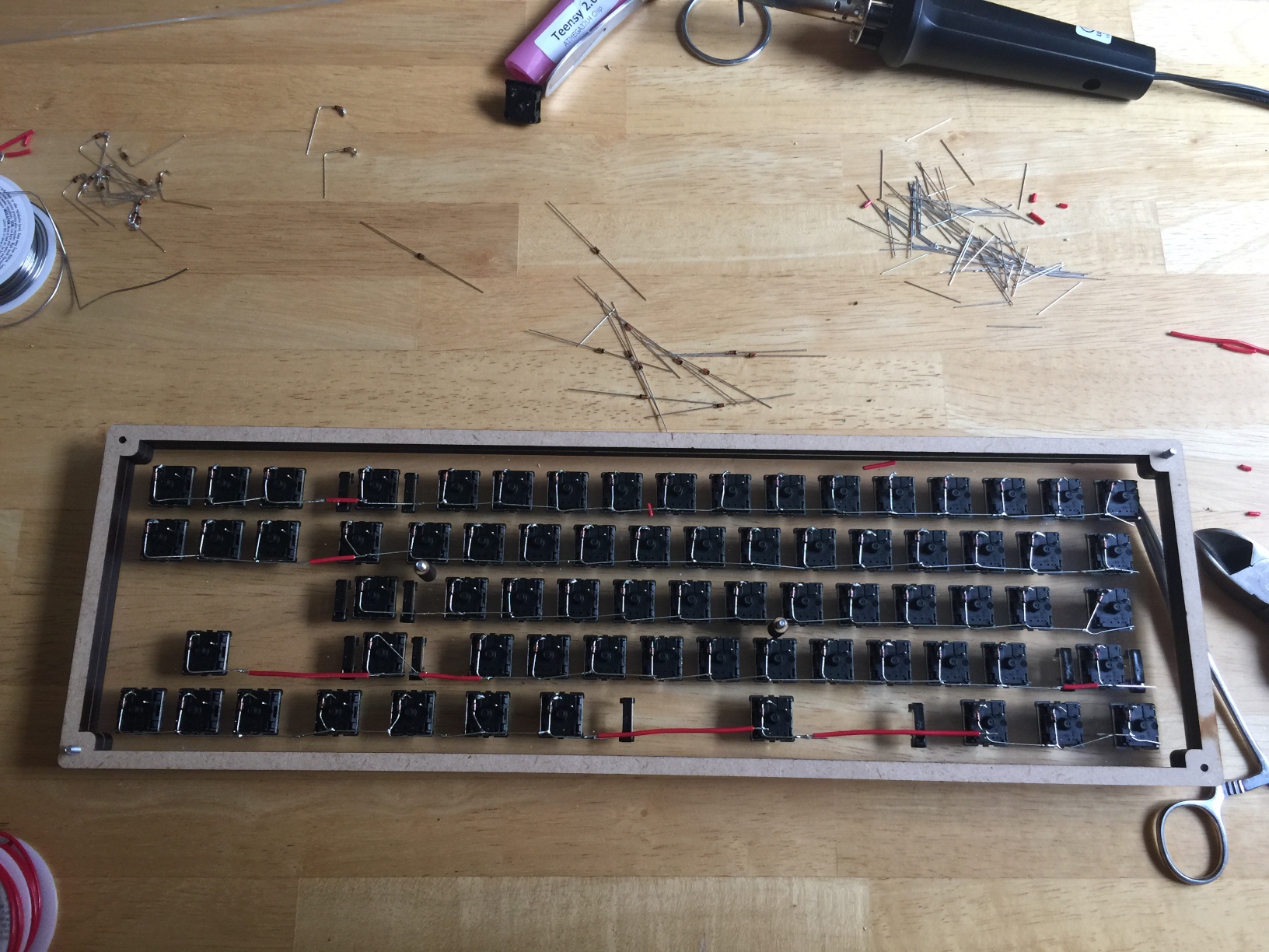

Unlucky for me, Newark shipped the diodes all individually in a bundle. If you buy 100 or more, you can often get them all rolled/taped together so you can bend them together. Lucky for me though, I had a handy built in screw in the case I could perfectly bend them around.
Diode bending
Diode bending

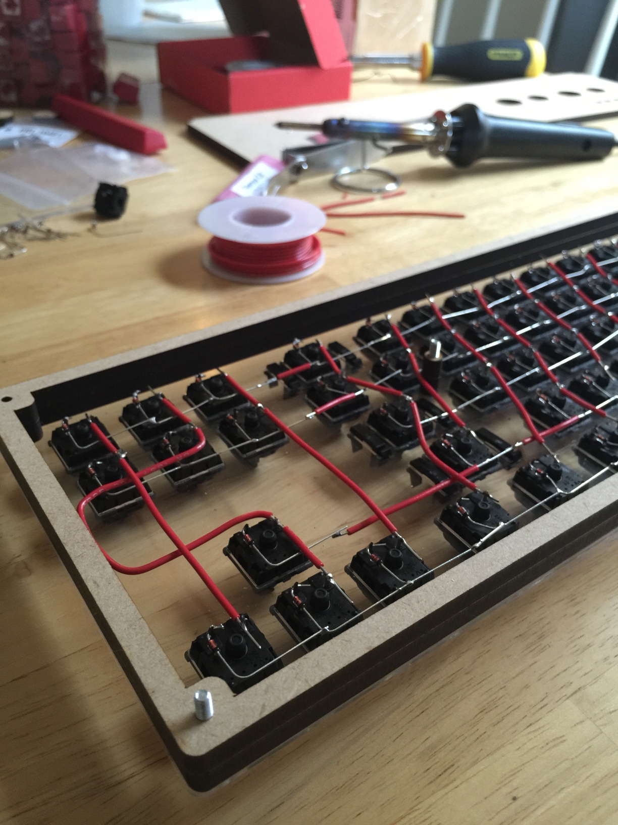

With a little wire and the diodes soldered together, the 5 rows started coming together.
One row at a time
One row at a time
Phew - 5 rows, lots of patience and a new soldering iron later, it's all ready for the next step.
Soldering and mess later, phase 1 is complete

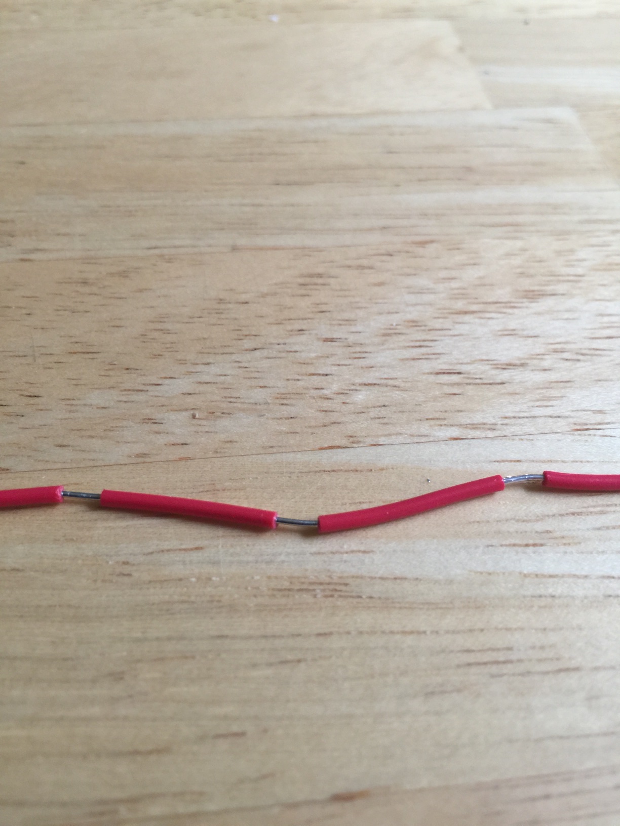

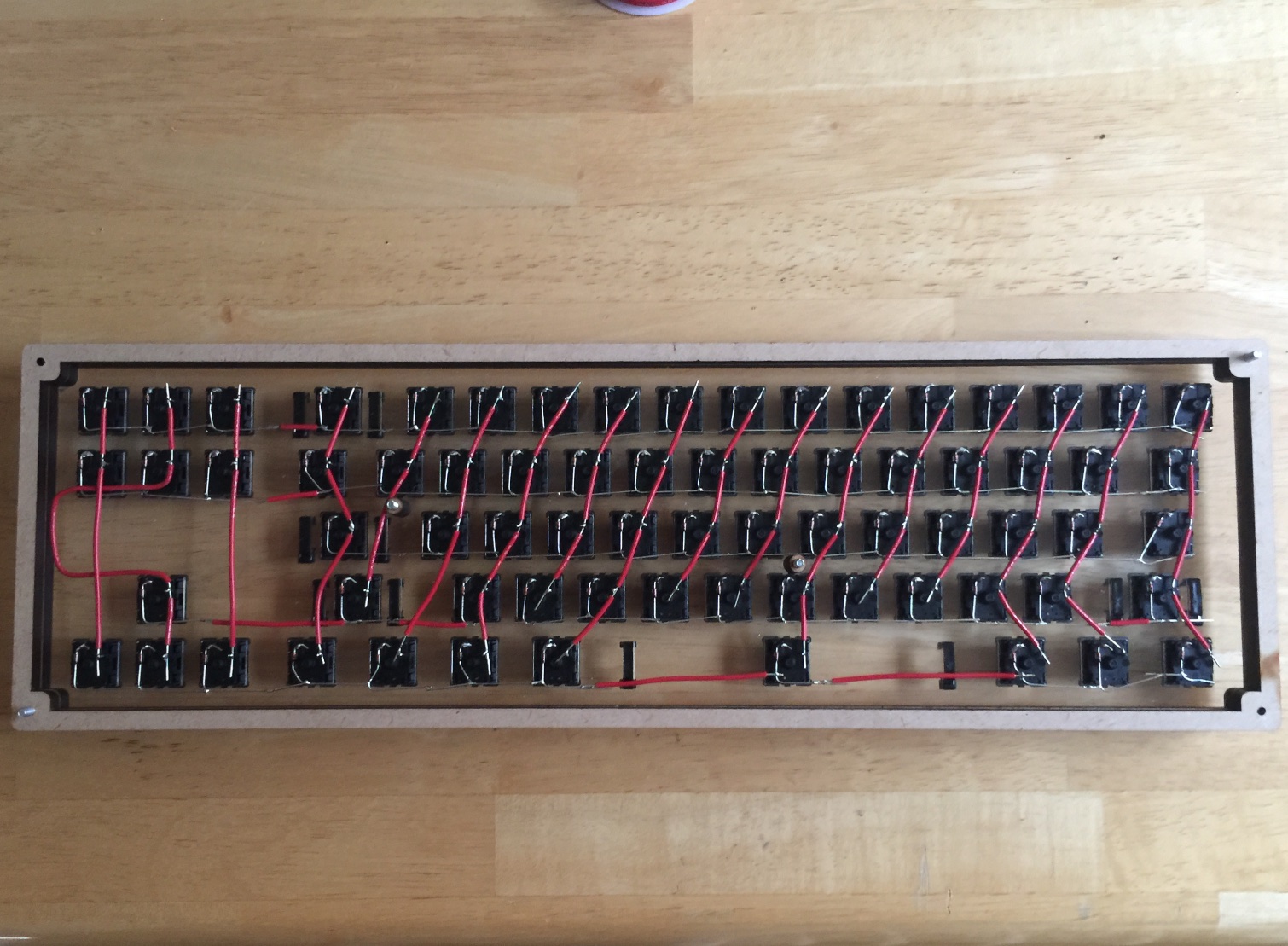

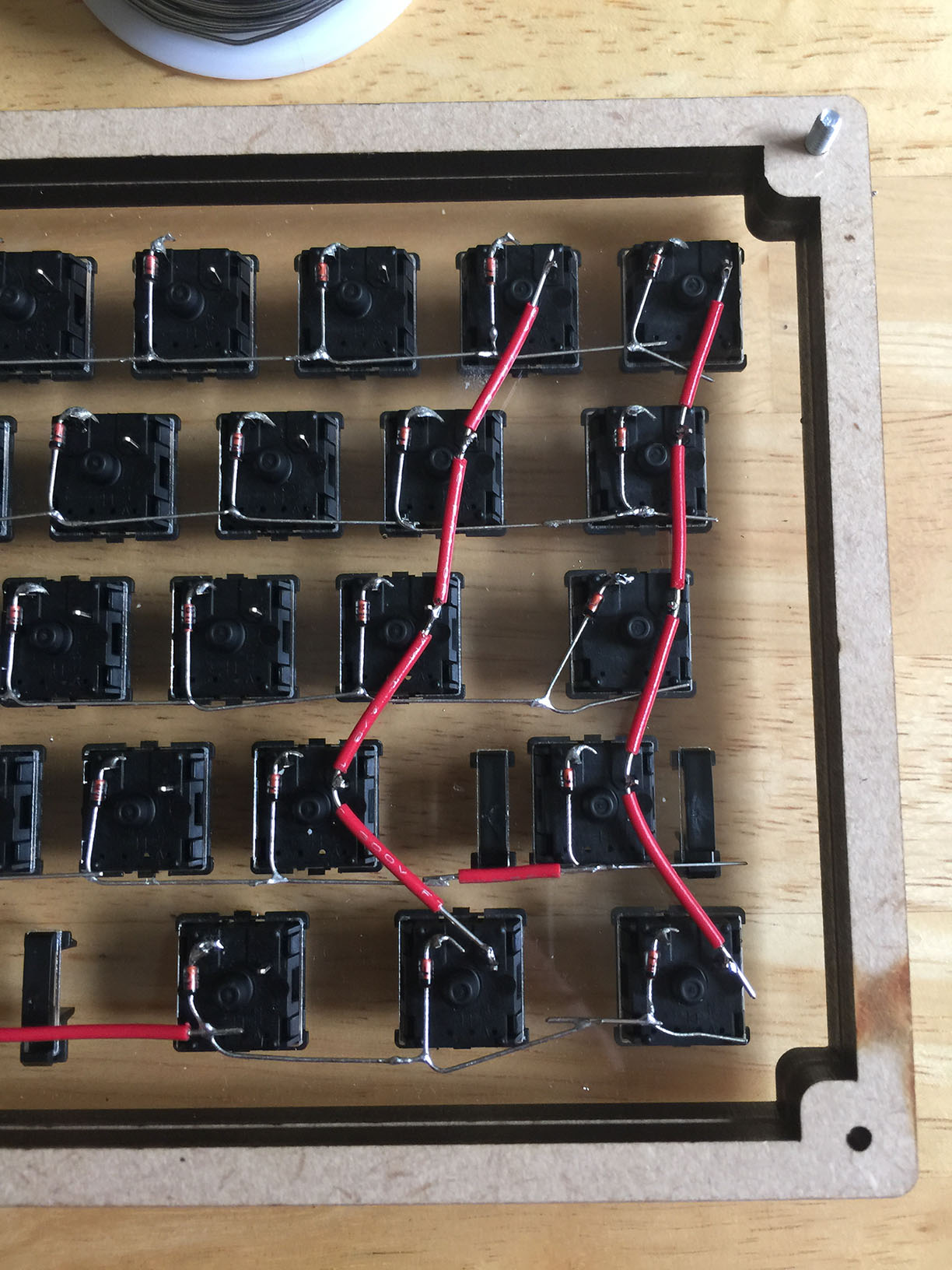

Now, of course the rows are assembled on one of the leads from the switches, now on to the hard part... 17 columns?!?!
Pulling off wire insulation from the middle of wires with an xacto knife is... meditative.
Column wires
Column wires
Eye-ball estimates of length and marking spots with a sharpie to remove insulation worked pretty well. 2 of 17 done...
2 of 17
2 of 17
Holy cow. 17 columns later. Cutesy c-shape on the left was made for the Teensy to sit.
17 Columns
17 Columns
Dramatic process shot with mess in the background.
Cool!
Cool!

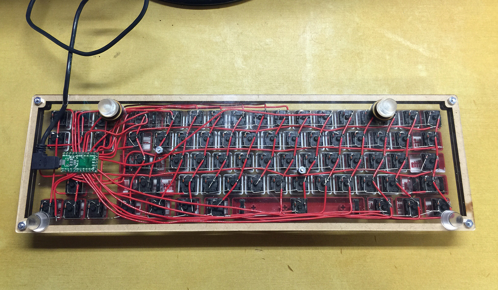

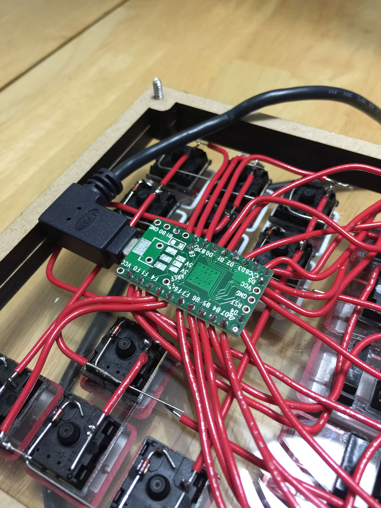

Now, the columns and rows needed to be wired up to the Teensy. No way in hell am I showing that. But I will show you the gory photo of the spaghetti afterward:
Yikes
Yikes
Yikes. Ok! Next time, on to putting on the key caps and to see it in action!

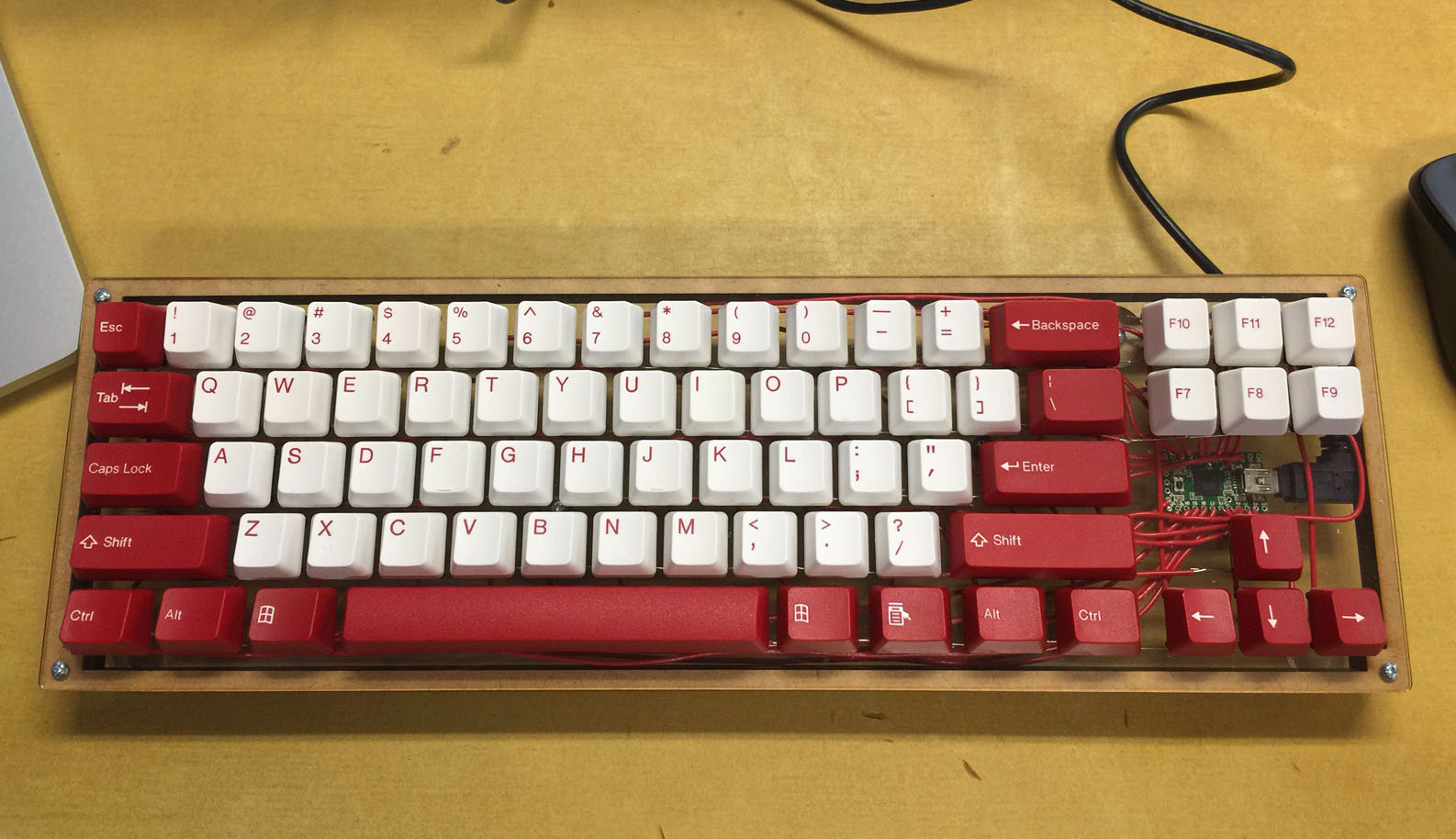

Conclusion
Finally! Keycaps on and all assembled. Red/White scheme looks good on the desk at work.
Thinking sometime soon I should get the function keys that are dedicated for volume/music control.
Feedback I have for next time:
  • Should have added screws mid-way through the frame for support. Bends a little too much for my liking.
  • Planning the wire routing better would have helped prevent the spaghetti mess, but it really doesn't bother me sitting on the desk as it is now.
  • Cut-outs for the stabilizer clips were slightly too small. I added tolerance for the Cherry switches, but not the clips. I had to trim just a little from the inside of the holes to get them to sit correctly and prevent the stabilized keys from sticking down.
  • Screw holes were also cut too small. I specified them the exact diameter of the threads, which usually ends up not playing nice with the acrylic. Also had to trim out these holes with an x-acto (only one tiny, tiny crack in the plastic!) ;)
Success!

This looks great! I particularly like the window to see the teensy. Any chance of seeing more details like the back and the mdf sides?
03 Dec 2014, 16:09
the best thing about it is that the caps match the wire :P
03 Dec 2014, 16:11
Looks really good!
neverused
12 Dec 2014, 01:18
Any more pics?
12 Dec 2014, 01:28
That's really nifty — the keys appear to just float in space.

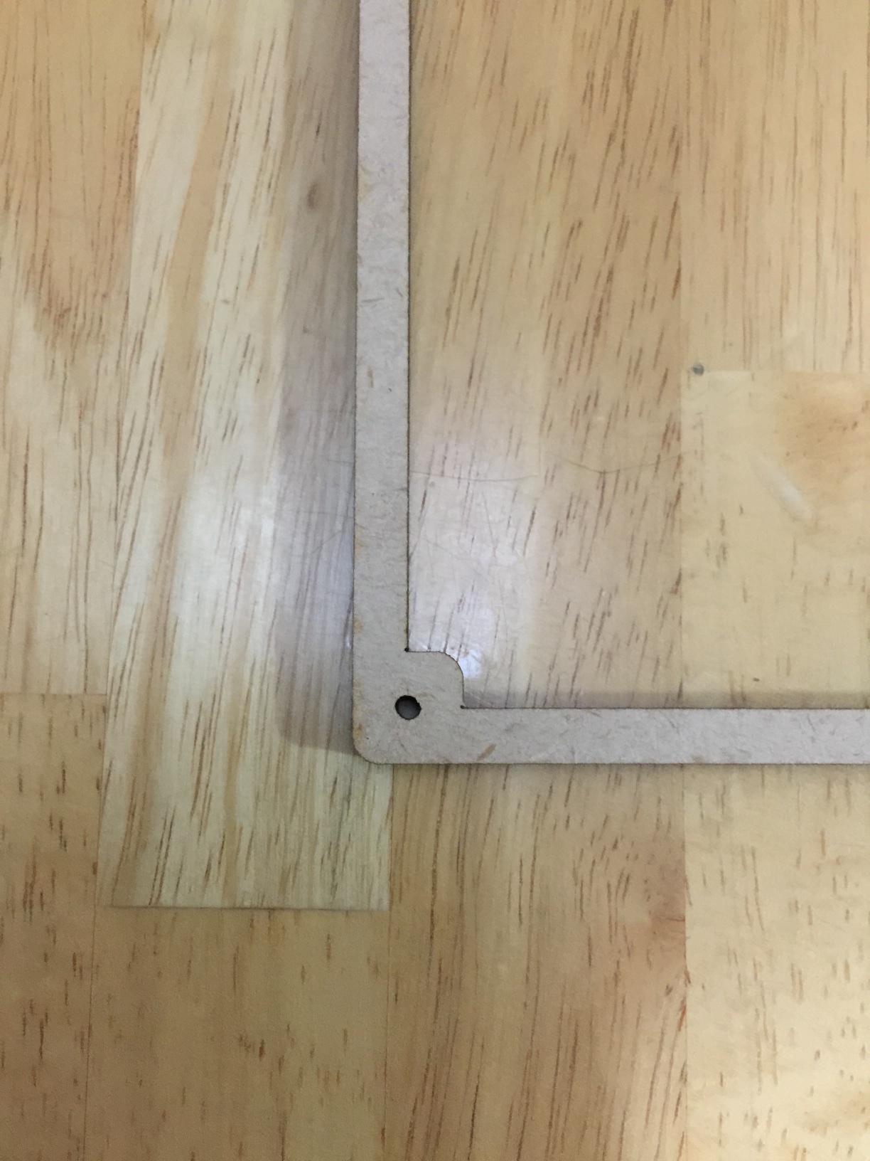

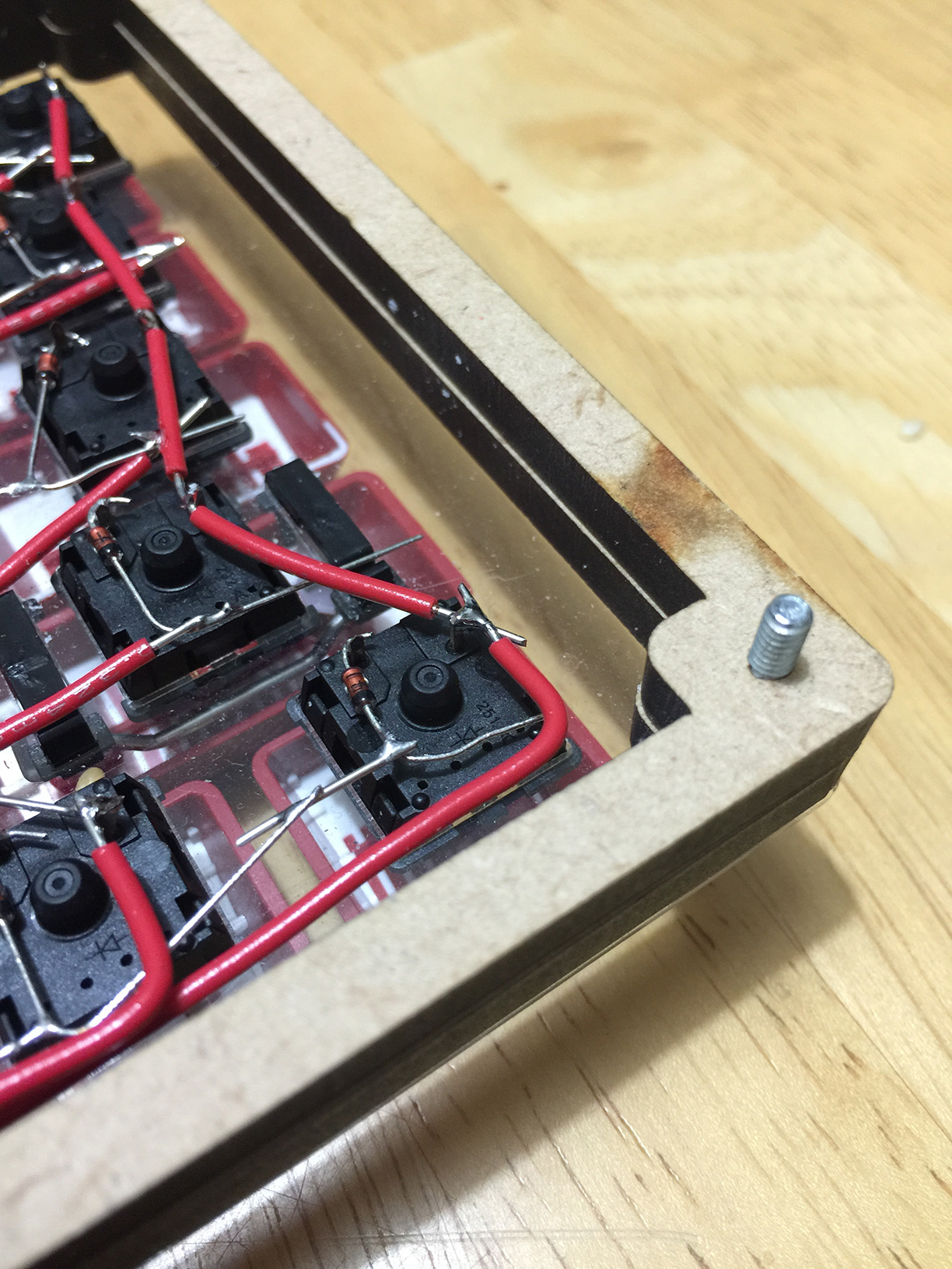

Here are pics of the spaghetti wiring and the MDF corner. Some scorching made its way to the top during cutting.
So far, it's been working extremely well - I just have the back plate off tonight to fix a solder joint I should have paid closer attention to! :?
