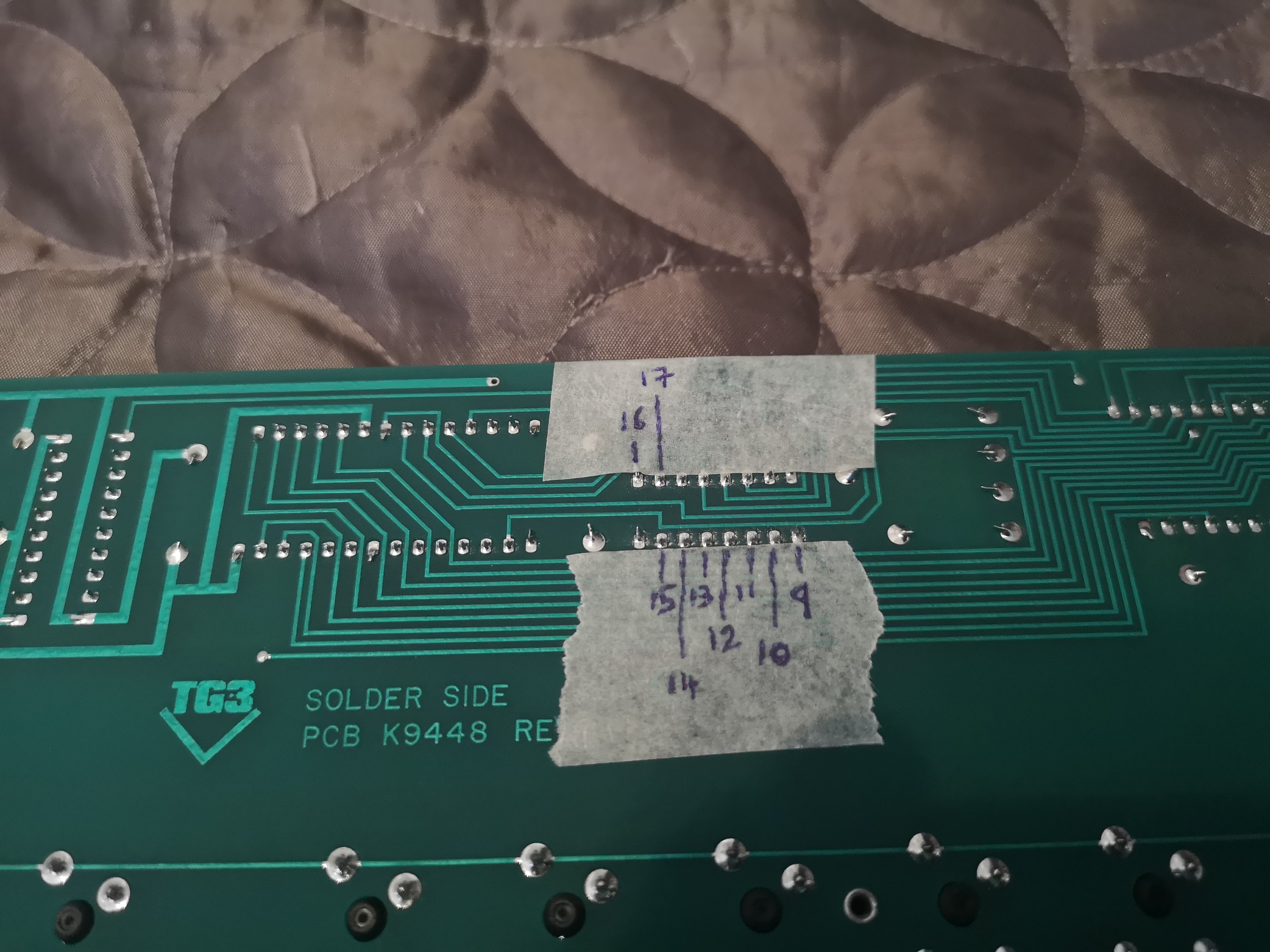

OK Thanks for all the help last thing what pin on the teensey would I solder the keyboards caps lock LED to?

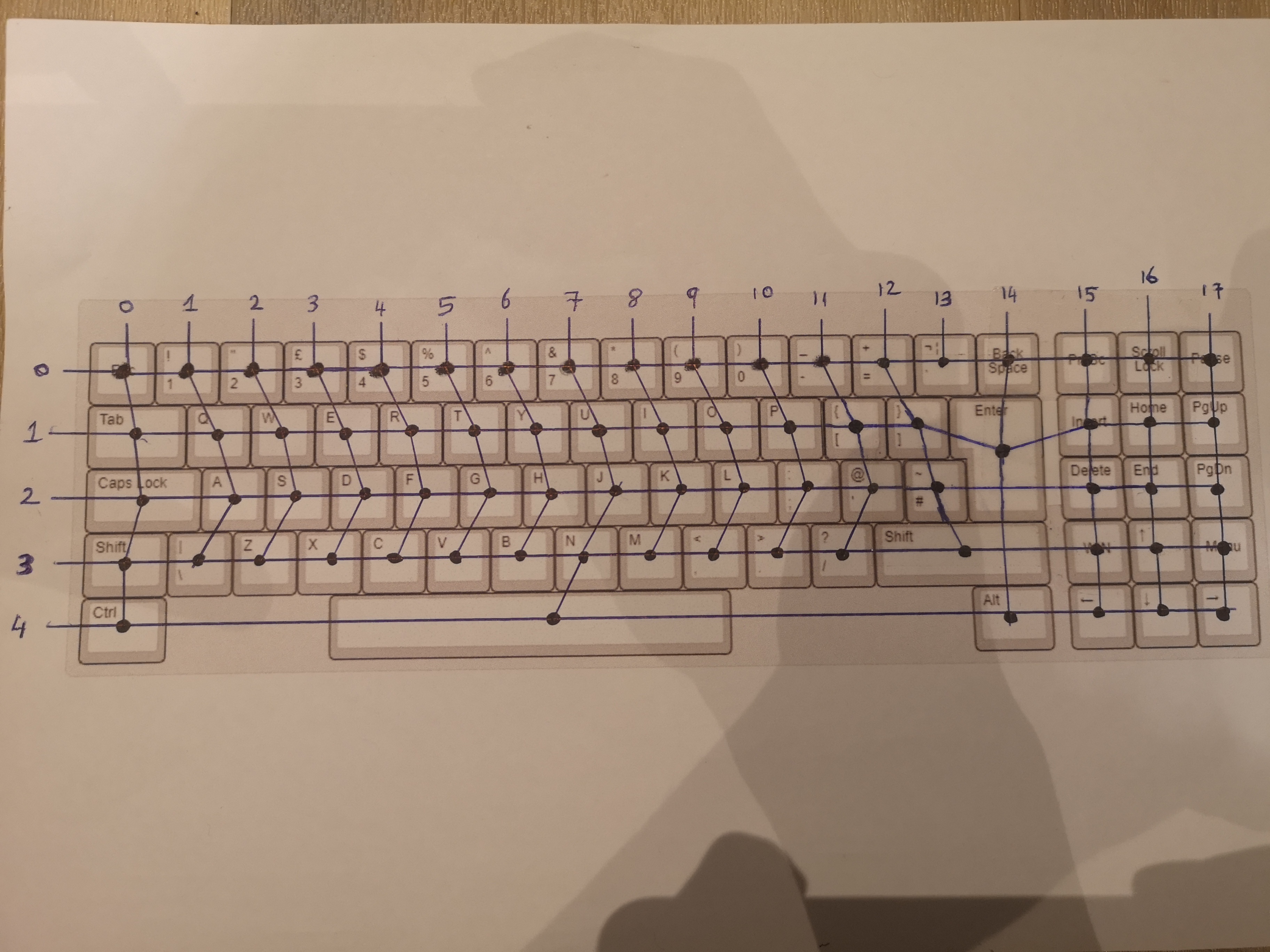

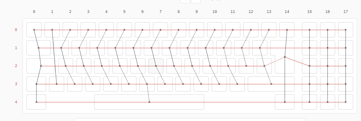

When I made my layout in kbfirmware.com I checked the matrix It said my keyboard had. I noticed its slightly different from what I drew up which one is correct just wondering as it could be possible my matrix i drew is slightly inaccurate? But I'm not really sure Thanks for all the help it is so appreciated.
Below is the matrix it said I have let me know your thoughts.

it will generate a matrix based on the layout, you would need to manually edit each switch to make sure it matched the matrix that you drew out. otherwise you would get errors like a f when should be a g etc

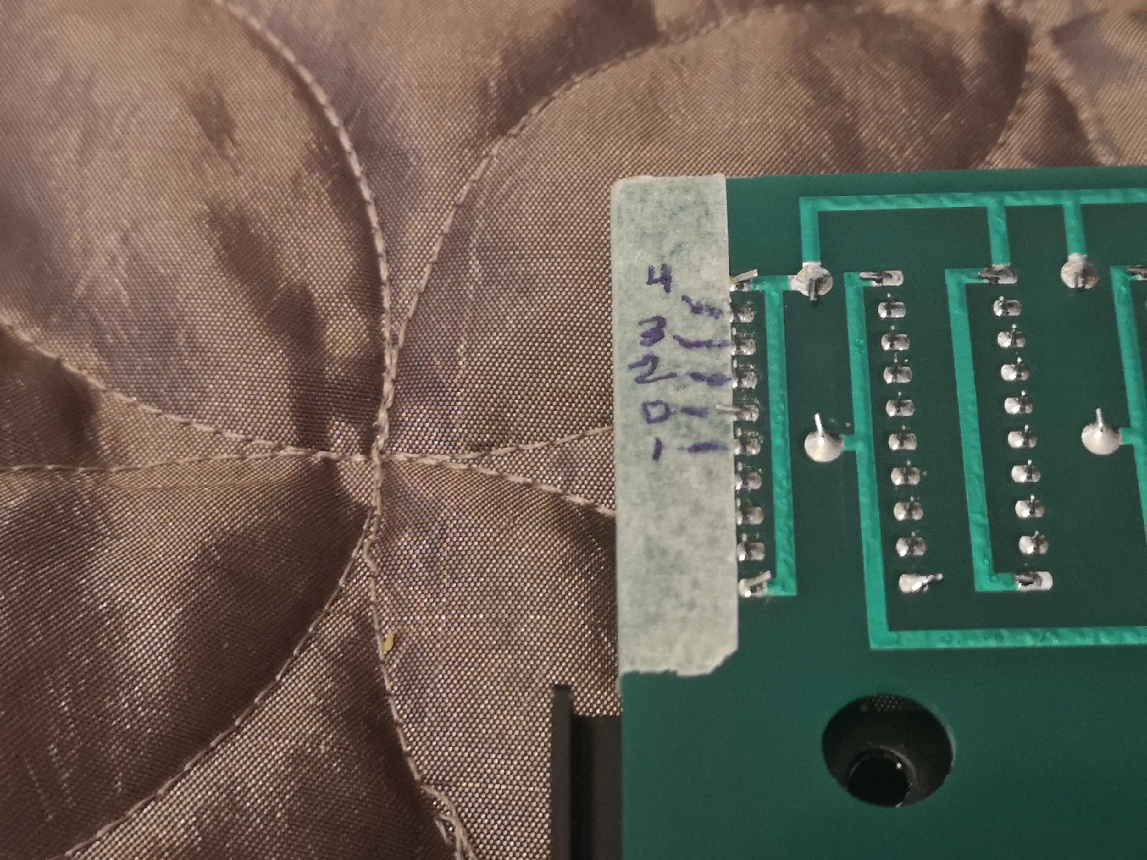

Ok just confirmed the matrix for sure and neatened up some of the pin labels.

Here’s a good trick: use letters for the rows. So you don’t mix them up. Then you’ll know for sure where C4 is, etc. instead of potentially messing up 3x2 for 2x3.

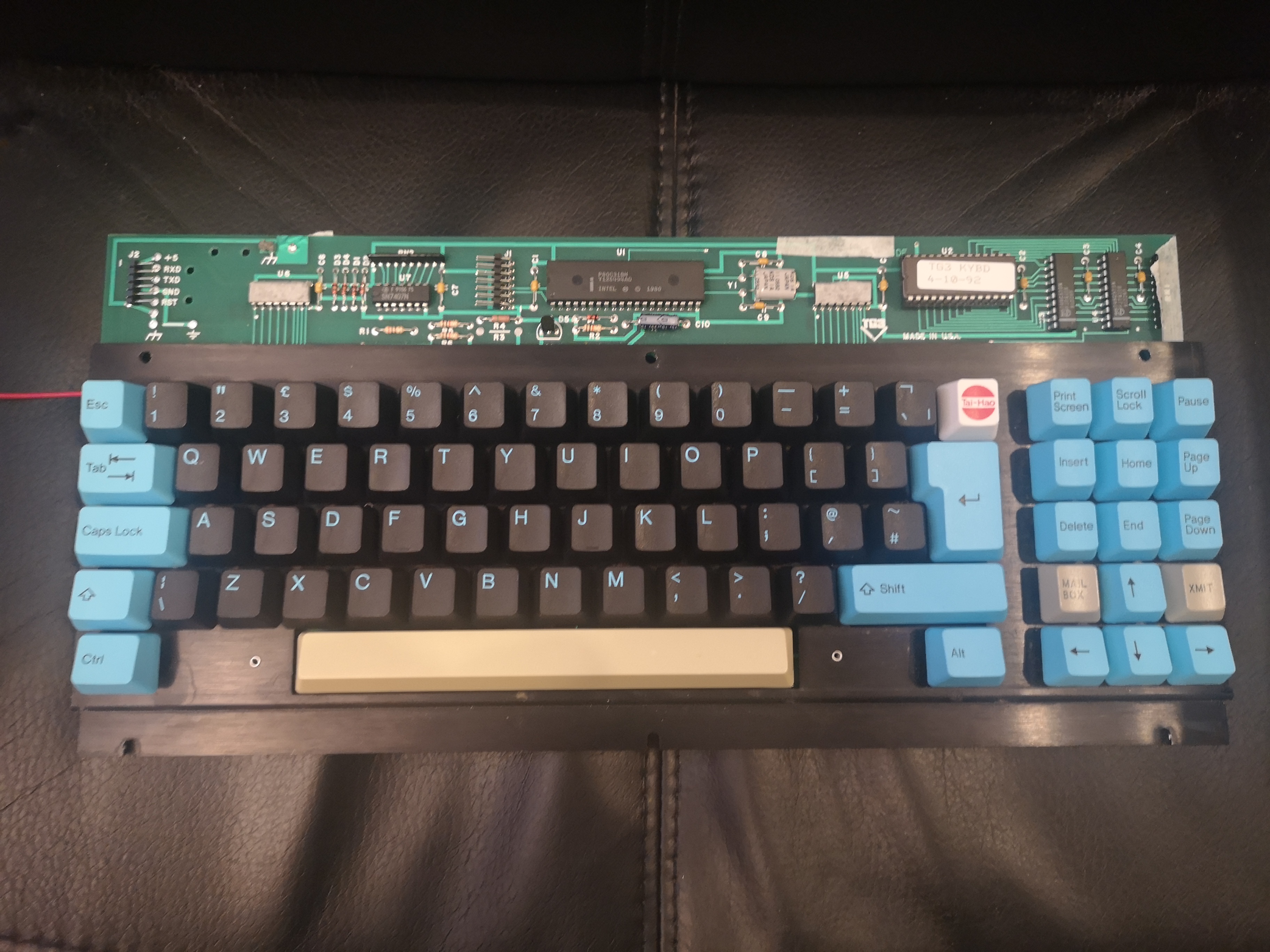

Thought I would throw on the Tai-Hao keys as I am so close to converting this keyboard let me know what you think picture posted below also any ideas where I could source a big space bar in black to match the other keys?
Very high quality doubleshot ABS keycaps below is some close ups of the moulding.

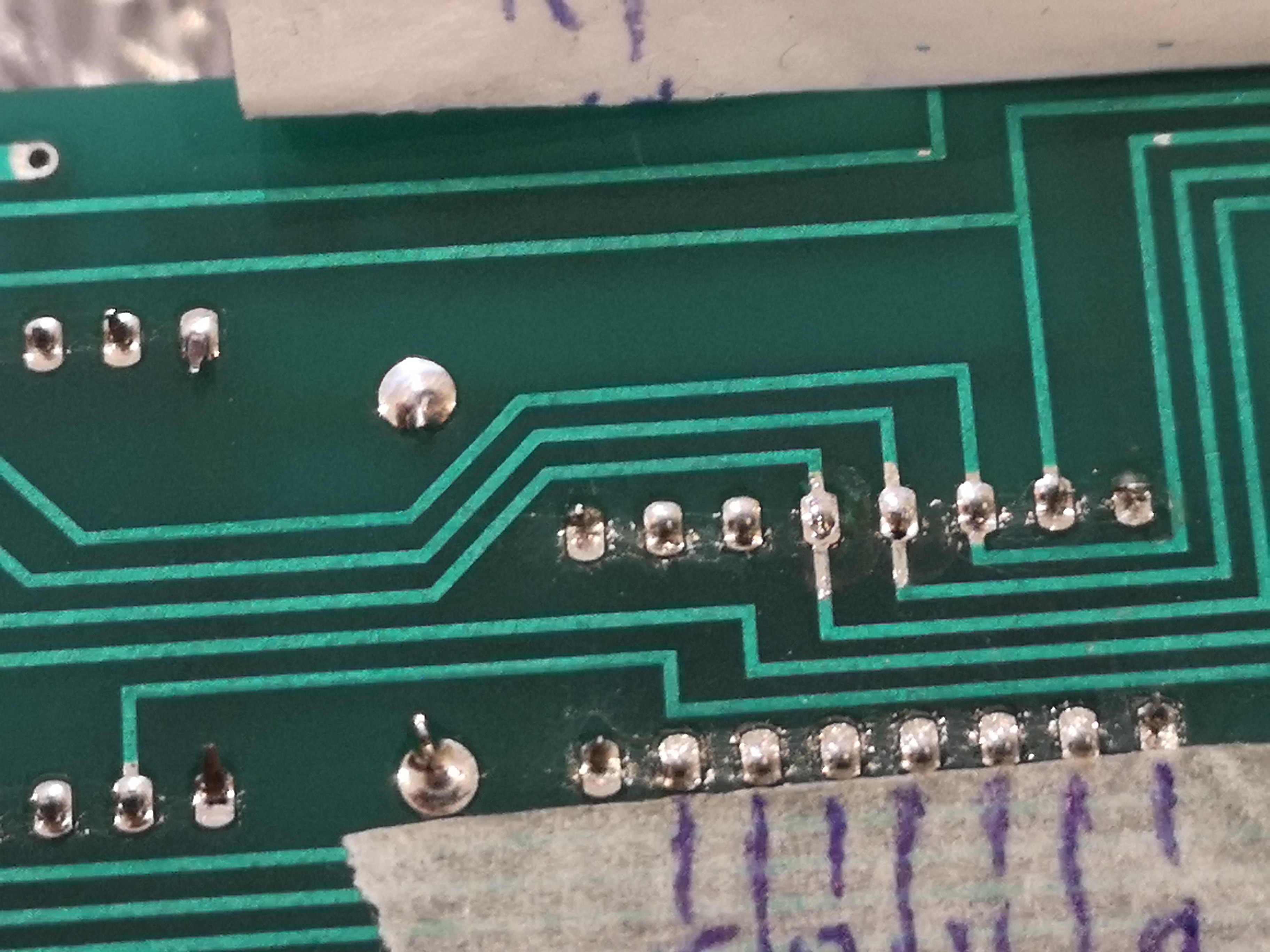

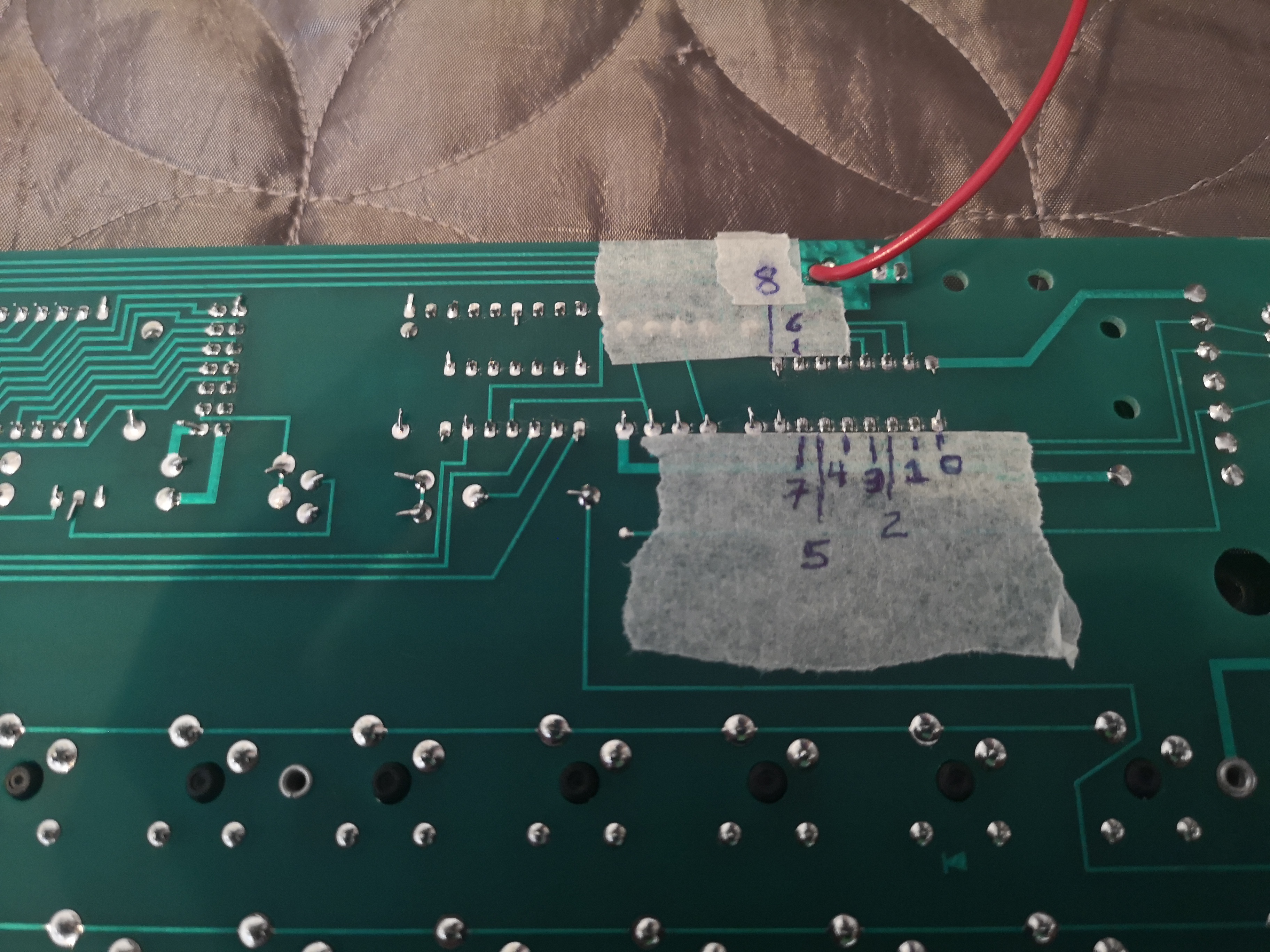

OK so update I tried to desolder those 2 chips for the columns and the coating over the traces started to come off. Not the actual traces the coating over them in fact after looking closer into it I can actually scratch the coating off with just my finger nail. So what do you guys recommend now Please help.

Ok that's good news below is a picture of what I am taking about.

I will try not to. As this coating came off whilst trying to desolder the chip. How should I go about removing the chips now. Or should I just solder directly to the chip and cut the power pins?

you can still desolder the chips just do not take the coating off beyond that. Actually looking at it again all the traces going to the keyboard are on the opposite side so the traces you have shown will not be connected to the teensy anyway

Well I tried desoldering again yesterday with my desoldering gun and same thing the thin coating on the traces just keeps scratching off. I have never seen this before with a keyboard PCB. I have only ever seen these thinly coated PCB's on one router that I repaired few years back. I really don't want to ruin the PCB. As you say though the traces for the matrix are on top of the PCB so should i just ruin those obsolete traces whilst trying to desolder the chip as I think that would be the only way anyways let me know your opinions.
