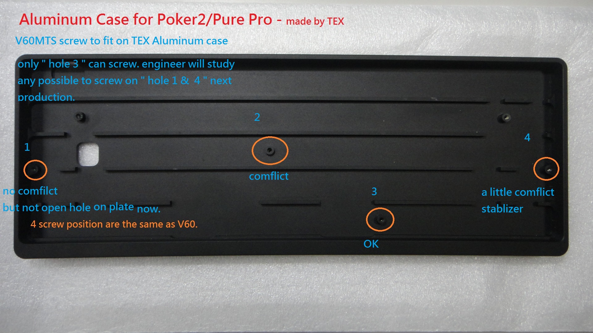

Based on accounts of installing the Tex aluminum case for 60% keyboards, I had erroneously assumed that the case would work on the KBP V60MTS keyboards (the ones with Matias switches). The version of case that I tested was the "thin lip" design.
I just found out the hard way that this will not work, unless you are willing to trust securing the case with only a single screw.
The keyboard PCB and plate fit into the case, and the USB connector and all 6 of the DIP switches are accessible through the cut-outs in the case. However, it appears that only one screw-hole is available though the PCB and plate -- the one just to the right of the spacebar. All the other mount points are blocked by the PCB and/or plate.
I do not have a KBP V60 with Cherry mx switches, but from what I have seen posted online, it appears that these keyboards can be installed in the Tex aluminum case for 60% keyboards, although accounts vary about the number of screws that can be used (3 to 5 out of a total of 6).
Although I have not tried other cases, I think that the mounting holes are the same in other cases for 60% keyboards, such as the Tex "fat lip", Vortex CNC, Vortex cast aluminum, and MKC.

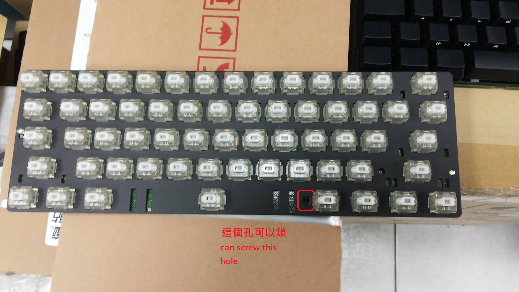

There is one mounting post in the aluminum cases that lines up with an existing hole in the PCB and plate of the V60MTS. There are 3 additional posts that are potential candidates, but there are no corresponding holes in the V60MTS plate (I am not sure about the PCB). It might be possible to drill the necessary holes in the V60MTS if there are no conflicts with switches, stabilizers, or PCB circuitry.
I've been in touch with mechanicalkeyboards.com, and they have in turn been in touch with KBP. The engineers at KBP are looking into the feasibility of drilling the necessary holes and whether they might put these into future versions of the keyboard.
I suppose another alternative is to find places in the keyboard where holes could be drilled with no conflicts and then add the corresponding mounting posts to the case as suggested by Charger and chzel.

Here are pics from KBP sent to me by MK. There are 4 potential mount points in a standard aluminum case for 60% keyboards for the V60MTS. As shown in the illustration of case mounts, only #1 and #3 have no conflicts with essential components in the keyboard, and #4 is a "maybe".
Currently, the V60MTS keyboard has only one hole through the PCB and plate that lines up with a mounting post in the aluminum case (#3).
The KBP engineers are looking into the problem to see if it will be feasible for them to make the necessary openings in the PCB and plate so that at least 3 screws could be used to secure an aluminum case (#1, 3, and 4). In the meantime, I suppose those interested in putting the V60MTS into an aluminum case could try drilling the necessary holes in positions #1 and #4.

Hypersphere wrote: In the meantime, I suppose those interested in putting the V60MTS into an aluminum case could try drilling the necessary holes in positions #1 and #4.
MechKB.com have published a build log on drilling the holes in positions #1 and #4.

I also had a recent reply from KBP on this issue. They said that they will soon release a new batch of V60MTS boards that have two additional holes drilled (three holes total) for mounting the keyboard in an aluminum case.

They did it. Looks like KBParadise delivered on their promise to drill these additional holes:

Recently I also received confirmation from the US dealer, Mechanicalkeyboards.com (MK) that the latest shipment of KBP V60MTS boards now have sufficient mounting holes to enable the keyboards to be installed in standard aluminum cases.

This weekend, I installed a new version of the V60MTS-C into a TEX thin-lip aluminum case. I confirmed that this post-January-2016 version has 3 out of 6 mounting holes for these aftermarket cases.
