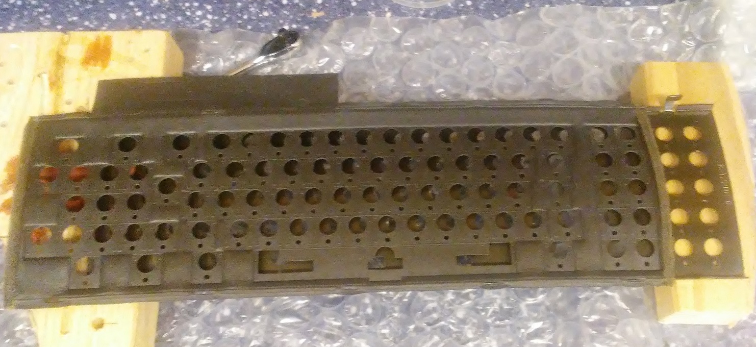

Unscrew the two screws holding the back. Inside backing metal plate has some rust:
Oh dear:

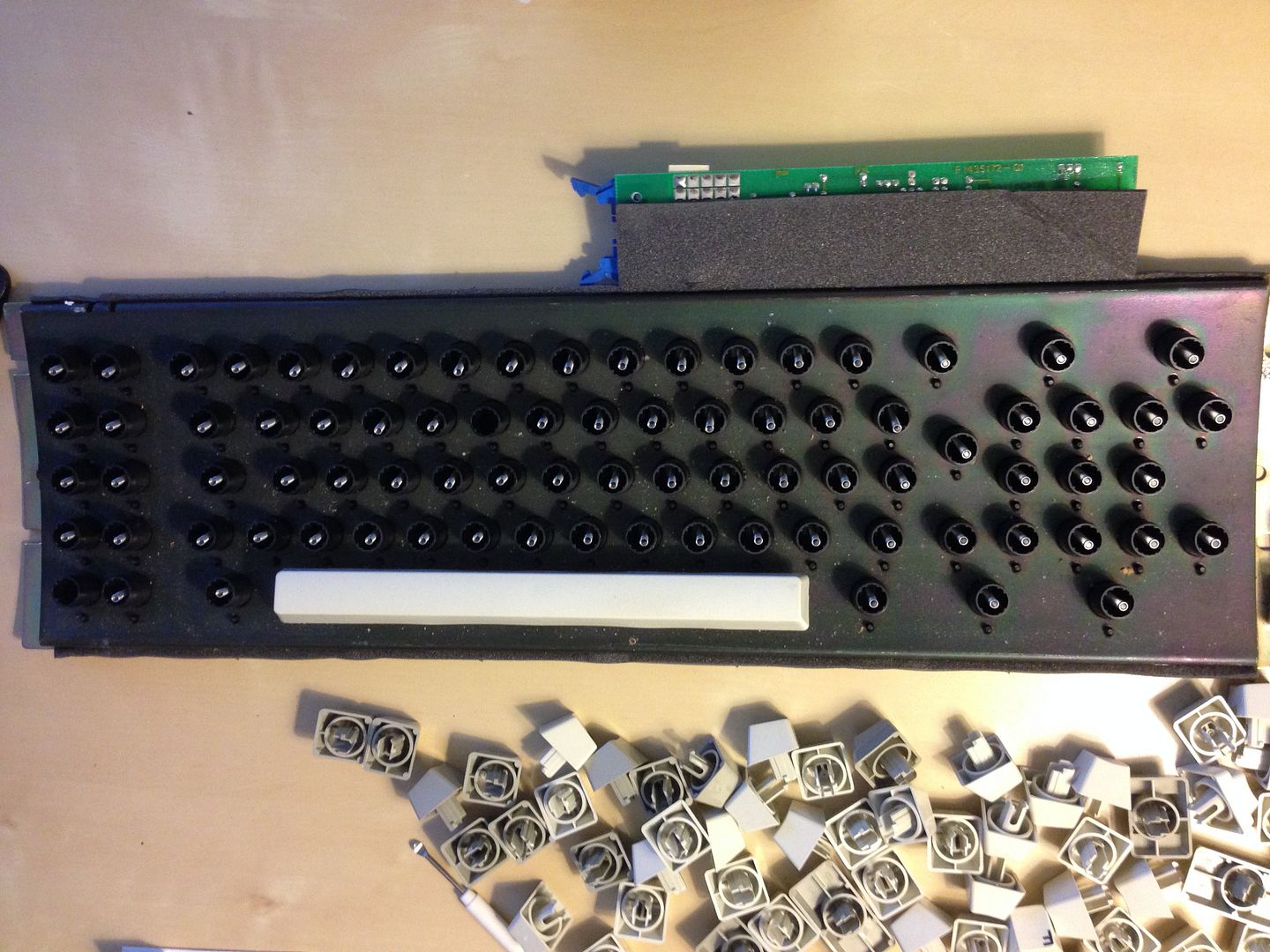

Taking off all of the caps:
Do not remove the spacebar. The backing plate needs to be separated first before this can be done. Rust patches can be seen throughout the top plate:
To detach the plates, remove the one bolt holding them that's visible on the controller:
To separate them fully, one of the metal tabs (the only one that's bent in) must be unbent and then some serious force must be applied horizontally, along the length of the keyboard. A hammer here works quite well. Think of it as sliding a panel door off your PC tower - same kind of mechanism.
Quite gorgeous:
As you saw before, there was some onset of rust along the exposed edges.
Luckily once sanded away there was no pitting. Anyone have recommendations on how I should treat this after sanding? I feel that leaving it exposed this way is a surefire way to invite more rust.
Removal of the spacebar must be done through the back. Detach the stabilizer bar on each sides of the spacebar. Once this is done, the actual keycap can be removed from below.
Close up of the stabilizer tabs:
Remove the spring mechanism:
The foam needed only minor cleaning and still holds up quite well. Will reuse to avoid the headache that others have had to go through.
This top plate requires the most attention. My initial approach is to submerge it in vinegar, scrub with 180 grit sandpaper and then coat in rustoleum. Are there better methods?

1) Figure a way to remove the existing rust on top plate and provide some sort of anti-rust protection for future. Same for bottom plate edges.

I would vinegar that front plate, sand all the rust away, and paint it well on both sides. The internal heat-treated plate could probably be clear-coated or finished lightly where you touched it up and left alone otherwise. Honestly, I doubt that rust has much real effect, but it is a nag in the back of your mind to know it is there.

You could also coat it with a bit of Fluid Film, which is a lanolin based rust inhibitor that won't evaporate.

Definitely agree with Fohat, if you can it's nice to de-rust the plate, either chemically or mechanically.

When I've soaked the barrel plate in vinegar, I didn't need sandpaper at all. The vinegar completely removed the corrosion and the paint overnight. It was really kinda cool to see that!
180 grit seems like it might be a bit rough IMO. On other vinegar/metal paint removal jobs, I've had to soak the item in boiling vinegar and use a brass wire brush.
And Rustoleum to seal the barrel plate is a great choice.

Used the vinegar bath to leave the top plate in for around 36 hours. Took the paint off and ate through some rust but some pitting remained. Image
Here it is removed with no sanding. The orange is new rust setting in from exposure to air and water after a quick wash. Image
Sanding it down with 150 grit to ensure paint adheres to the surface
Painted black with Rustoleum rust protecting paint (2 coats)
Reassembly process. Started with putting back in the barrels and spring/hammers.
Assembled the spacebar mechanism without any string or dental floss
Found out why people complain about putting back together these XT boards. I didn't have any clamps but had these little guys lying around. The size was perfect and was able to hold them together while I hammered the back plate into position

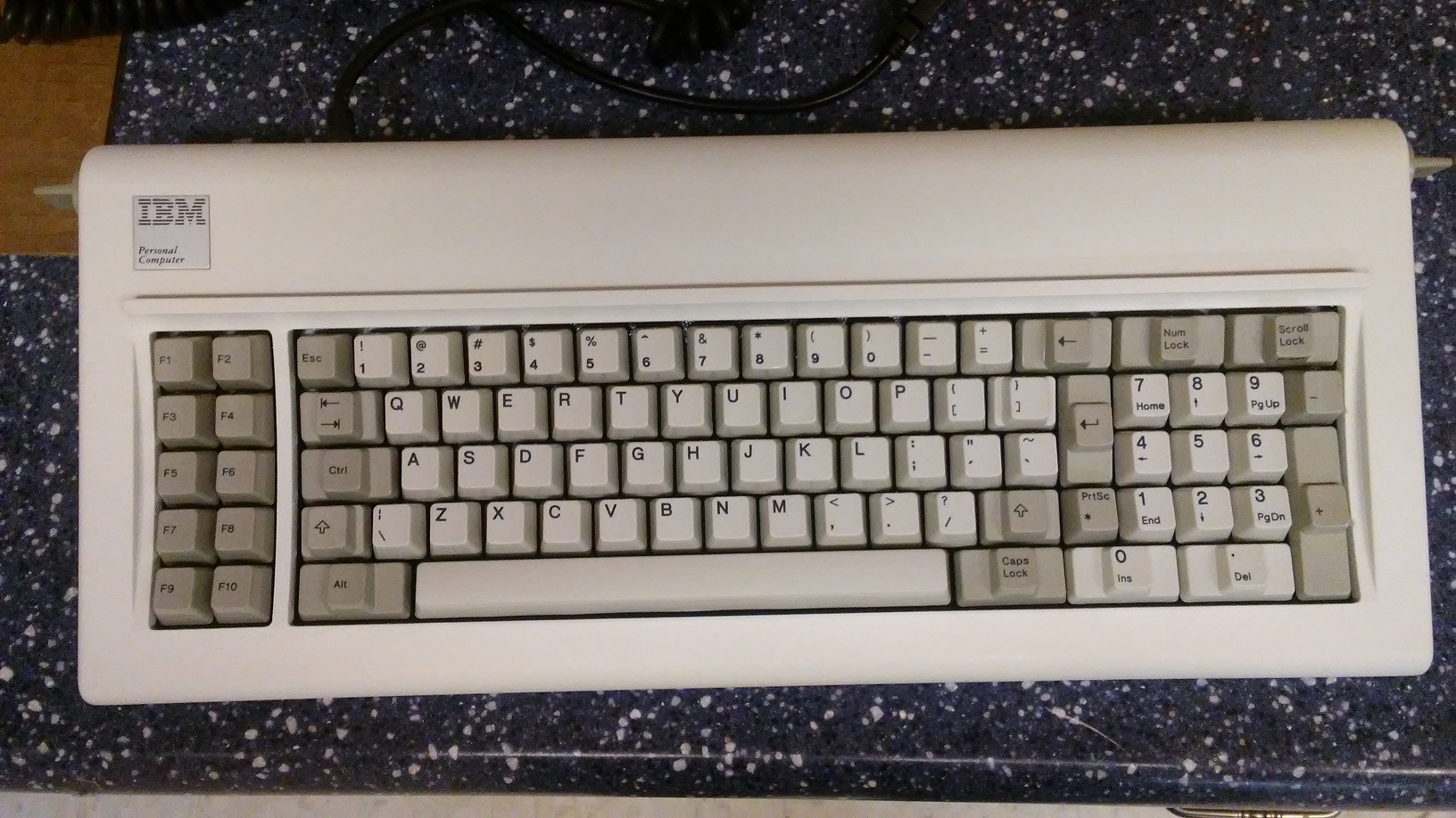

Putting back all the keys
The keys cleaned up super nice
Assembling the top and bottom covers and the reconditioned cable makes for a very good looking board
Can't get over how clean these keys are.
