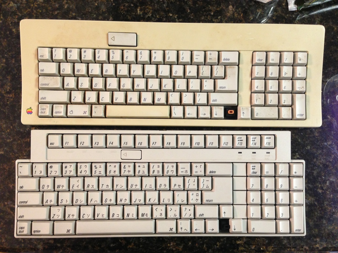

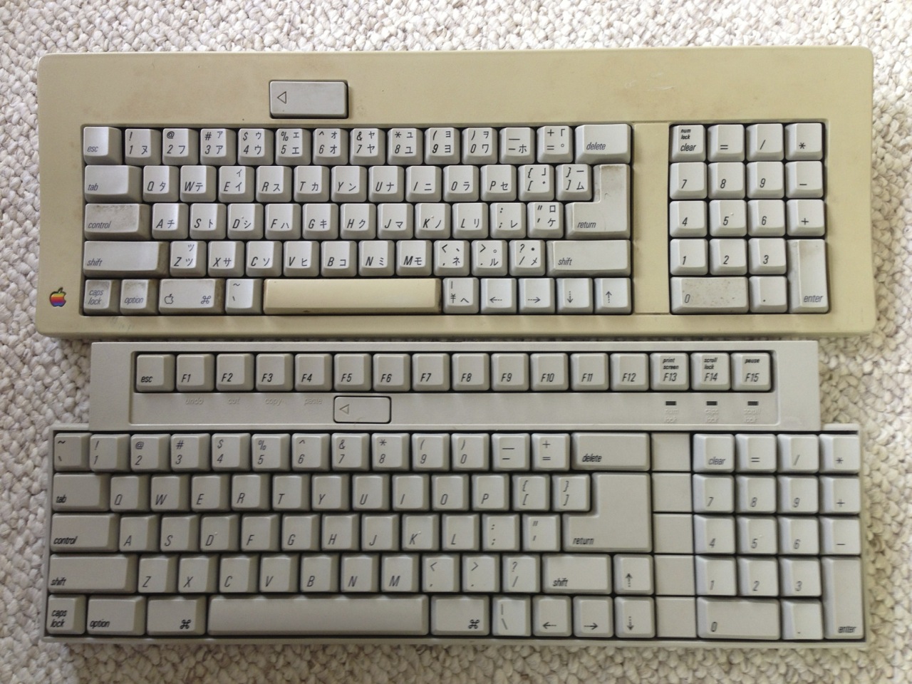

Attempt 1: Weird, but not crazy.
Before:
Before: M0116 and Elecom
After:
M0116 and Elecom keys swapped

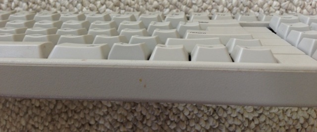

Elecom keys have lower profile:
M0116 Keys higher profile than Elecom
I am actually disappointed that the difference in keys wasn't more noticable. functionally, it works well. I'm not going to say I like the cursor arrangement, but I am guessing I could make it work. maybe.

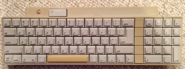

Apple ADB Keyboard:
Apple ADB Keyboard
Apple ADB Keyboard

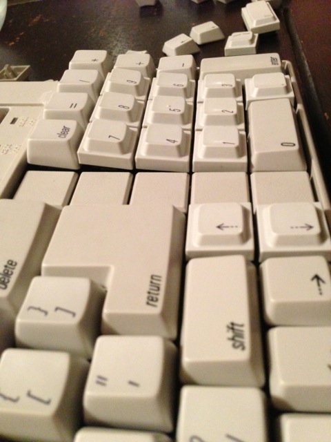

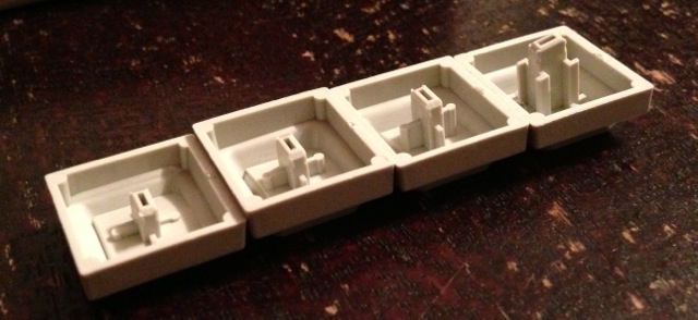

So the first layout wasn't that interesting, how can I make it weirder? Ah, yes, add weird chiclet keys from the IIgs keyboard. So this was a massive FAIL, but it did reveal something interesting: the IIgs keyboard has a "fake" curve built into it. The board appears to be flat, and the curve is added by making each row of keys higher/lower. On the top row, the switches are rotated 90 degrees! (which was a bummer, because my first plan was just to convert the ` and entire numpad to the IIgs keys). I tried to take some pictures showing the backs of the key caps.
Apple ADB Keyboard - Rotated Alps
Stems have variable height:
Apple ADB Keyboard - variable profiles

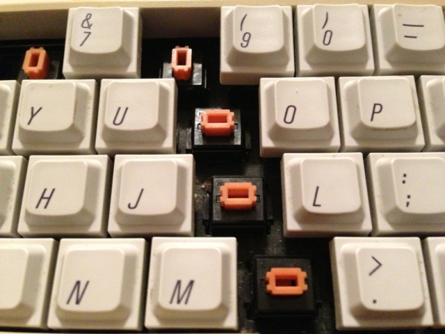

warty wrote:Both the M0116 and IIGS keyboard look the same orange/salmon to me, but if there's a way to tell (other than disassembling a switch, let me know and I'll try to confirm.
It's the natural pink colour of salmon, not the orange colour of smoked salmon. See the colour chart here:
http://deskthority.net/wiki/Alps_CM#Less_common_colours
Also, this is an M0116 with salmon switches:
http://deskthority.net/wiki/Apple_M0116
It's a colour that's hard to describe; some people say "pink", which it is, but "pink" suggests maybe hot pink or magenta instead of Caucasian flesh tone or salmon.
Your keyboards have orange switches.
warty
21 Jul 2013, 15:21
Thanks for the links. I agree on the salmon/pink/orange thing: after seeing those, these can't be "salmon". The color is definitely less orange than the one shown on that page (it is more "faded"), but it also doesnt' have "ALPS" on it, while that page says salmon is branded with ALPS.
I checked the black in the Elecom, and it has raised alps lettering, so according to that page it is indeed a simplified black.

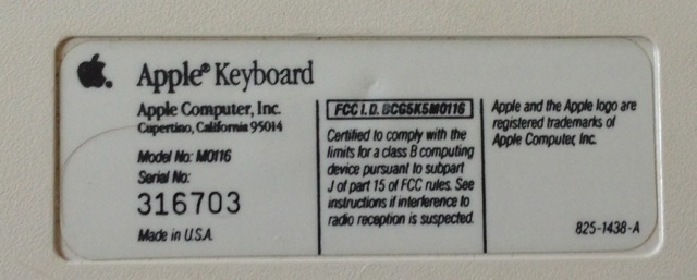

Here are the backs of the 2 apple keyboards:
Label on Apple M0116
Label on Apple ADB Keyboard (IIgs)
