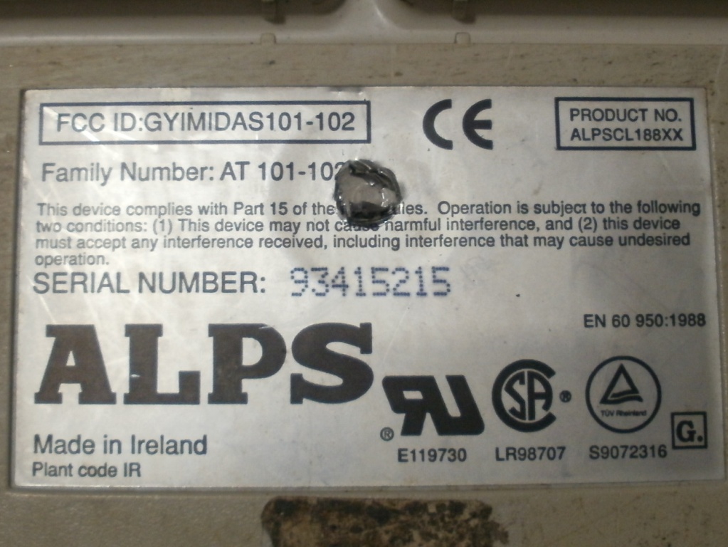

The first one is made by Alps in Ireland and its FCC ID is GYIMIDAS101-102. Its case looks identical to Dell AT101. I suspect it uses some kind of Alps switches, am I right?

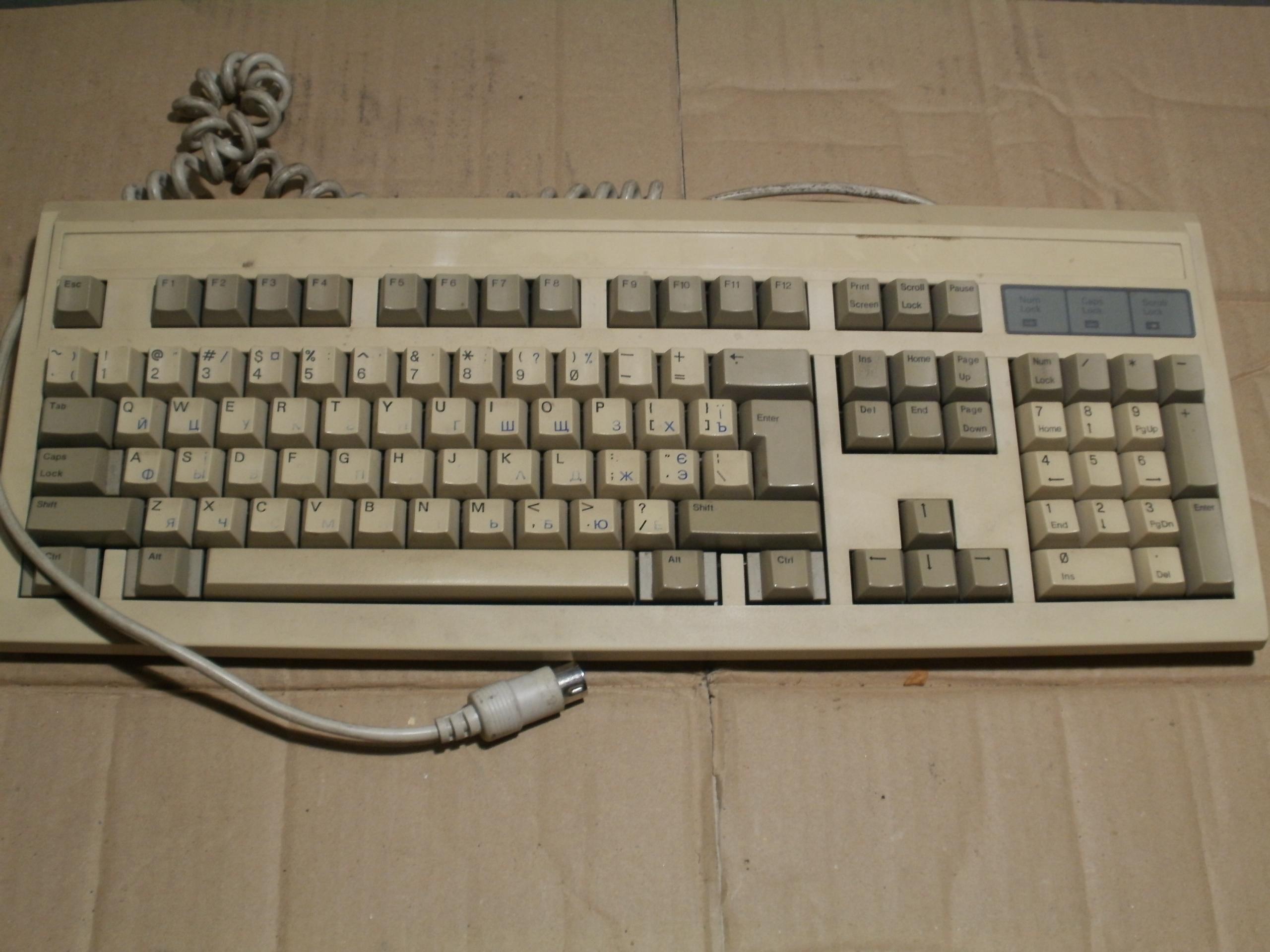

The second one is a complete mystery. It has no markings whatsoever except for the serial number. It looks very old and its Ctrl and Alt keys have a very distinctive shape.

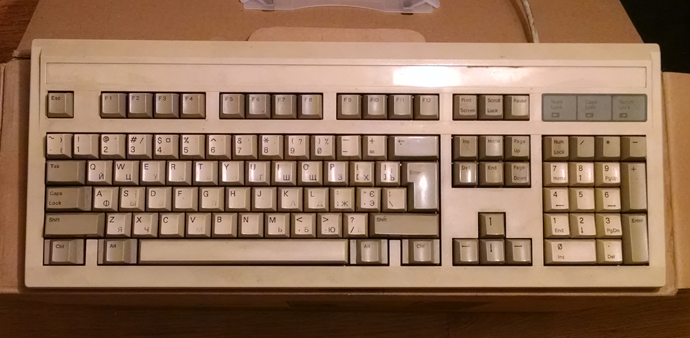

The third one again doesn't have any markings except for FCC ID which happens to be HQK RB-2001. Googling it yields a single link to Geekhack where it's listed as having some kind of blue tactile switches (?), but sadly without any pictures.

The Alps board is likely to be good. And the fourth one could have space invader switches, which I like a lot:

I think the first keyboard is some kind of dome kb.

The second looks really familiar, but I can't place it.

crunch wrote: I think the first keyboard is some kind of dome kb.
I suspect you are correct. I was caught out by the "ALPSCL" (as in SKCL), but it has a reverse curve case, not a banana case. It's the same shape as this:
http://sandy55.fc2web.com/keyboard/wang-5181.html
Rubber domes with sliders.

Daniel Beardsmore wrote: I suspect you are correct. I was caught out by the "ALPSCL" (as in SKCL), but it has a reverse curve case, not a banana case. It's the same shape as this:
And it actually has the same FCC ID. Well, I guess it's still a rather good keyboard for $1 :lol:

1) Alps AT101-102 is very mediocre, even for a rubber dome, but the keycaps are very good. They are thick, made of PBT, and both Latin and Cyrillic legends appear to be dye-subbed. I will definitely save them for future use.
2) The second keyboard is still a mystery, its manufacturer is unknown (maybe later I'll find some clues inside). My guess is that it uses sliders over rubber domes. The keycaps have a very distinctive shape. They are much higher at the bottom than at the top, and all their edges are very sharp. Like the front edge of my MacBook Pro. They are double-shot and appear to be Cherry MX-compatible.
3) The third keyboard (HQKRB-2001) is the biggest surprise of the bunch. It appears to be made by a Taiwanese company called Key Mouse Enterprise. It also uses sliders over rubber domes, but it's actually rather awesome to type on. I don't know how they did it, but the keys are very light, but with a pronounced tactile "bump." The return action is strong and swift and the keys emit a very satisfying "thud" as they return to their initial position. The keycaps are double-shot ABS and they appear identical to the keycaps shown here: http://deskthority.net/photos-f62/click ... t4861.html They even use the same god-awful font for Russian legends (with letters З, Я, Ж and Б being especially ugly). The only difference is that they use Cherry MX mount instead of Alps mount.
However, the most distinctive feature of this keyboard is that it has a built-in speaker which beeps every time you press a key. As you can imagine, it gets annoying pretty quickly. One day I will open it up and rip the speaker out, because otherwise it's a very good keyboard to type on.

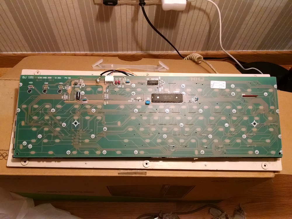

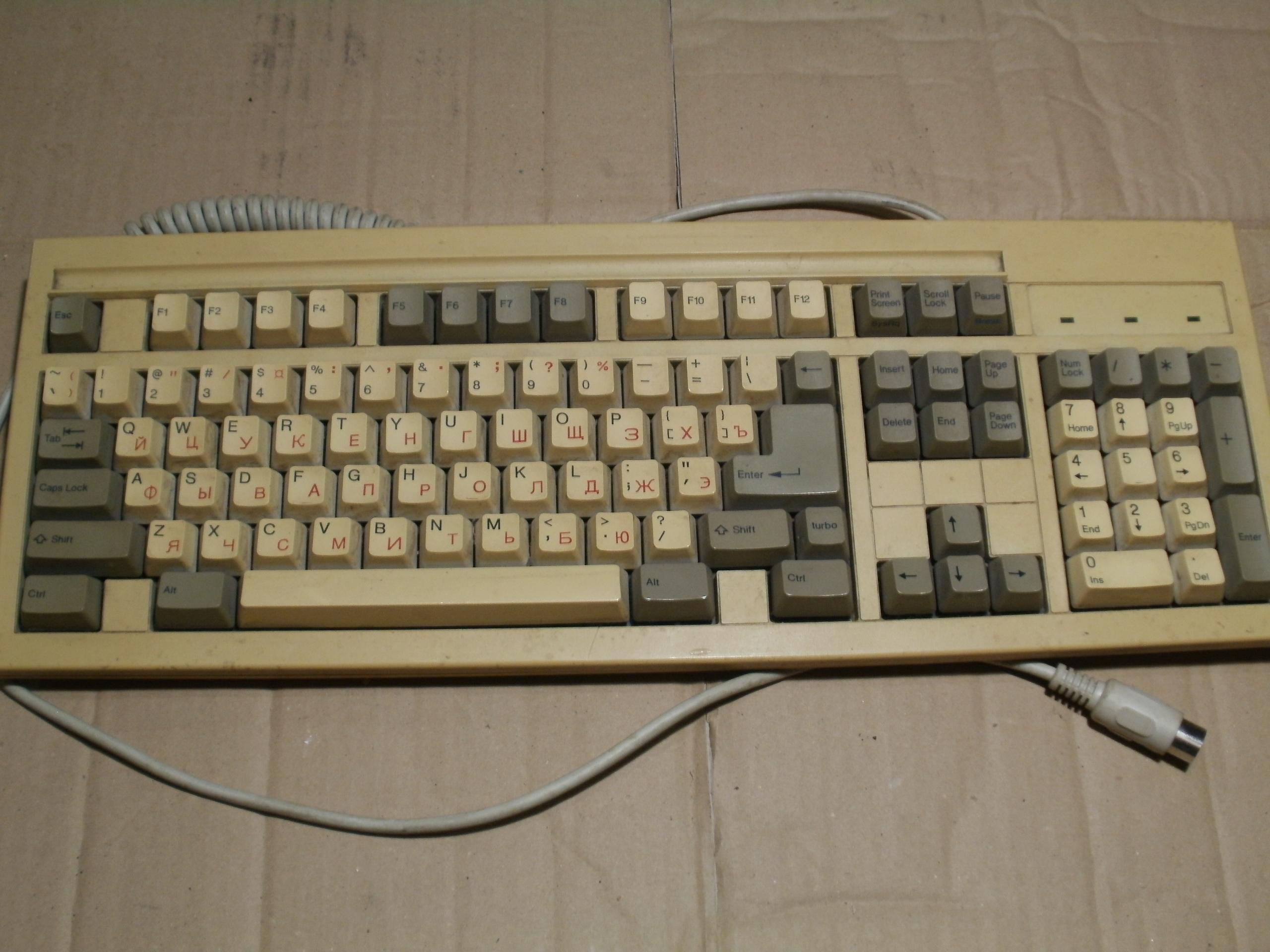

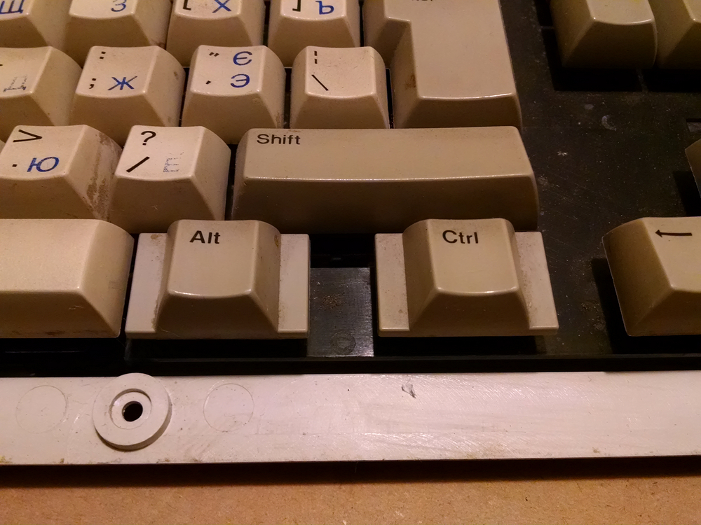

So, about that mysterious keyboard...

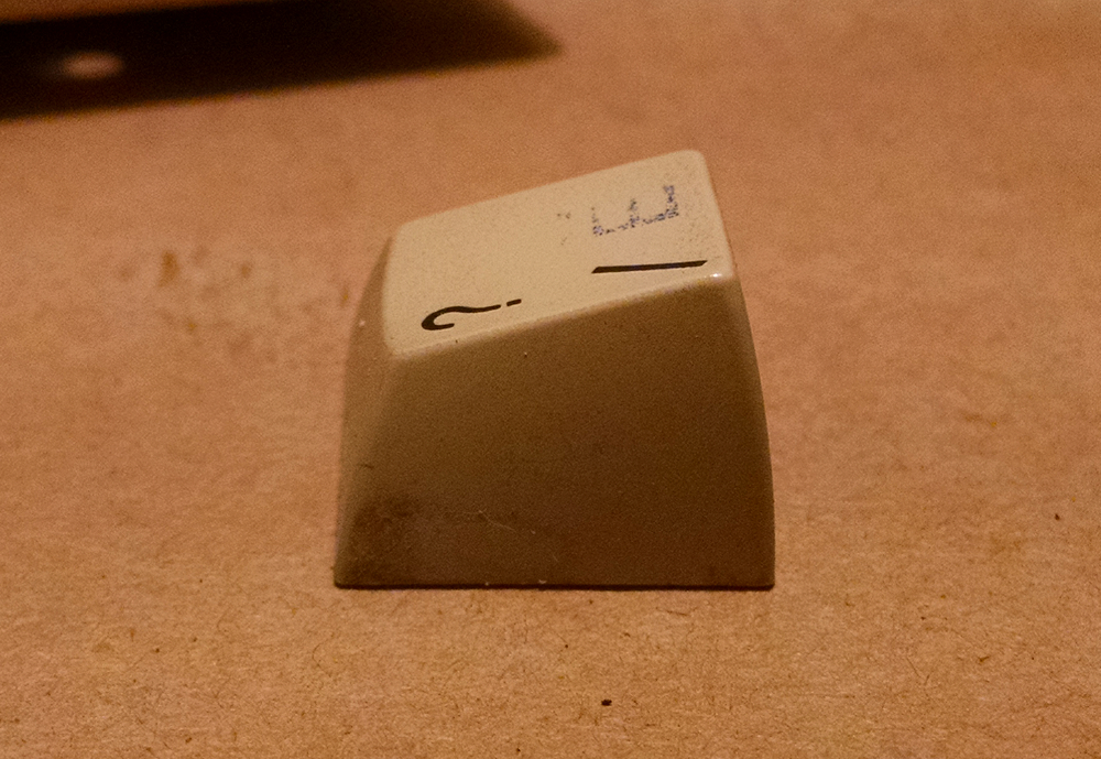

Its Ctrl and Alt keys have a very distinctive shape.
No, screw that. All the keys have a very distinctive shape. They are very angular, with a sharp profile.
The keycaps are double-shot and appear to be Cherry MX-compatible.

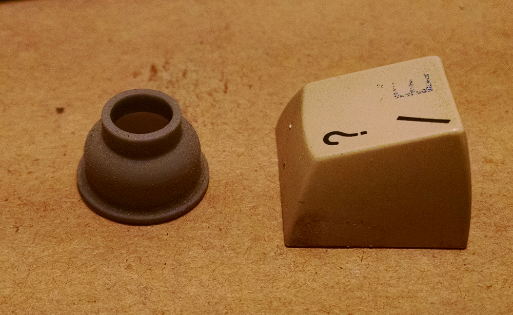

That's one hell of a rubber dome. The rubber part is almost as big as the keycap itself!

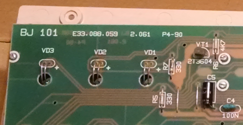

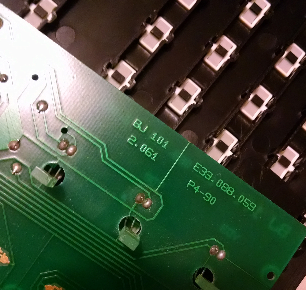

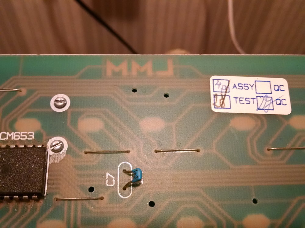

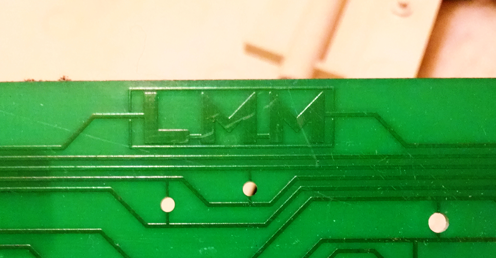

This board has no stinking membranes. It uses a high-quality PCB instead. I believe the sliders have conductive feet and simply bridge the contacts on the PCB when the keys are pressed.
The PCB is marked "MMJ" and "BJ 101", but googling these markings returns nothing.

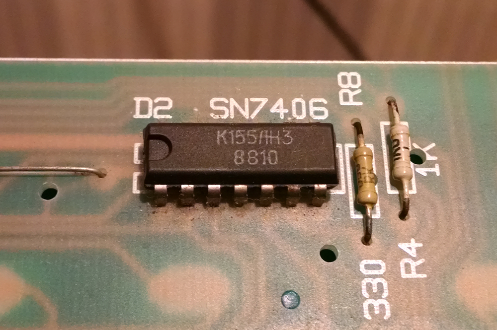

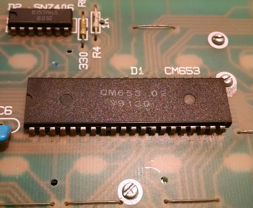

The controller...
If you're an observant person, you have probably already noticed one very strange thing.
Yes, my friends, say hello to this Soviet (!) IC. The К155ЛН3 (K155LN3) is a six-element logical inverter. Made in the USSR in October 1988.
Overall this keyboard is a very strange beast. But undeniably this is one of the nicest rubber domes out there, both in terms of construction quality and in terms of feel.

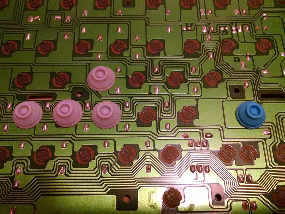

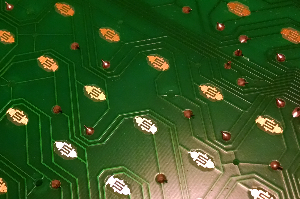

Nice Soviet board! More closeup pictures of the top of the PCB (the side facing the domes and caps) in higher resolution would be good. I'm thinking this may be capsense after all, but can't tell from just the one small picture.
See, Topre has done both capsense and conductive domes:
Topre Capsense PCBs
Topre Conductive PCB
http://deskthority.net/wiki/Topre_switch
They're much better known for their capsense domes, of course. And there's definitely more than one way to do either technique. A good close look of yours is in order! And check for conductive patches on the bottom of your domes. Conductive switches need a conductor, obviously. Capsense does as well, but it's usually a spring and doesn't have to touch the PCB, just come very close.

If activation (the key press gets detected) happens anywhere above bottoming out, it should be capsense and you've got something very nice!
As for the mods, they're in the IBM Model F "hatted" style:
A popular shape before the Model M came along and redefined everything ever since.
19 Feb 2015, 14:30
stratokaster wrote: No, screw that. All the keys have a very distinctive shape. They are very angular, with a sharp profile.
All keys? Not just the bottom two rows?

This mysterious keyboard of yours... it seems i have one using the same "switch" but a very different layout.
(with "rubber cups" removed) (ignore the sloppy lube job)

More photos...

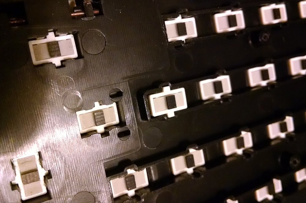

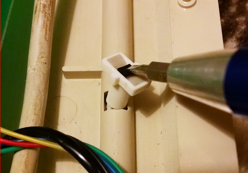

So it's "LMM" and not "MMJ" after all. Which is about as cryptic, if you ask me.
These are conductive "switches" after all. The plungers have conductive pads on their feet.
By the way, the part number (E33.088.059) looks very similar to part numbers used by Acer. But I'm sure it's a coincidence.
Conductive pads are mounted on tiny rubber strips and they can go inside the plungers. So what happens when you press a key: you have a strong tactile bump when the rubber sleeve buckles, at the same time the conductive pad strikes the circuit board and activates the switch. But there is still about 1.5mm of travel after this point.
BTW, while the inclusion of a Soviet-made chip is very interesting, there is no way this keyboard is Soviet-made. I have owned a large number of Soviet-made electronic devices and I think no factory in the Soviet Union was capable of producing circuit boards of such quality.

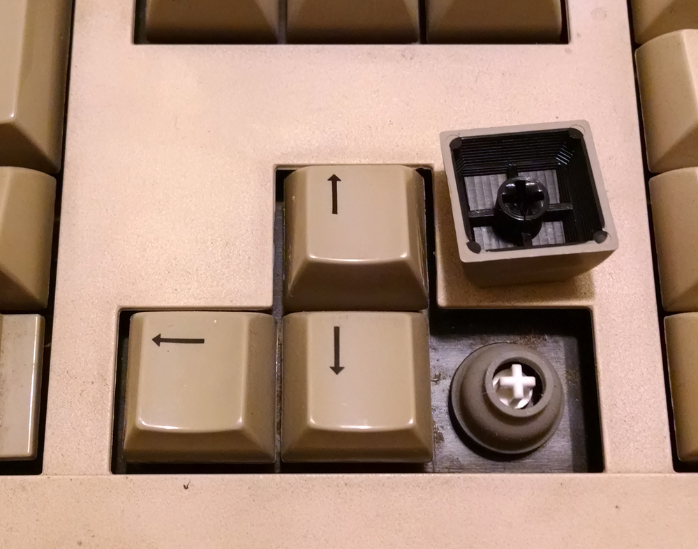

This is what I found inside the keyboard I thought was "rubber dome, but rather awesome."
Not too dissimilar to conductive Topre switches pictured above, isn't it?
19 Feb 2015, 22:41
Not bad! From what I've heard, Topre didn't make conductive domes for long. But other companies have tried it, and you might have found another one of them.

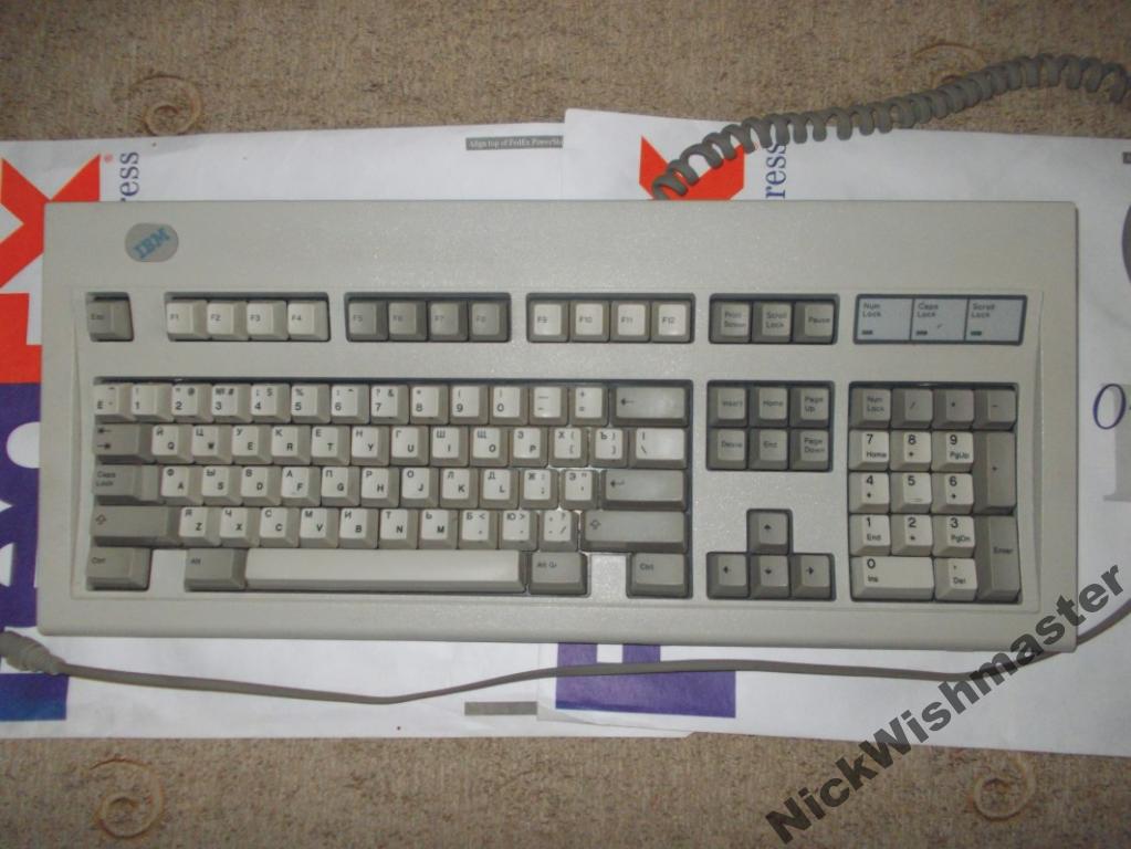

28 Feb 2015, 02:06

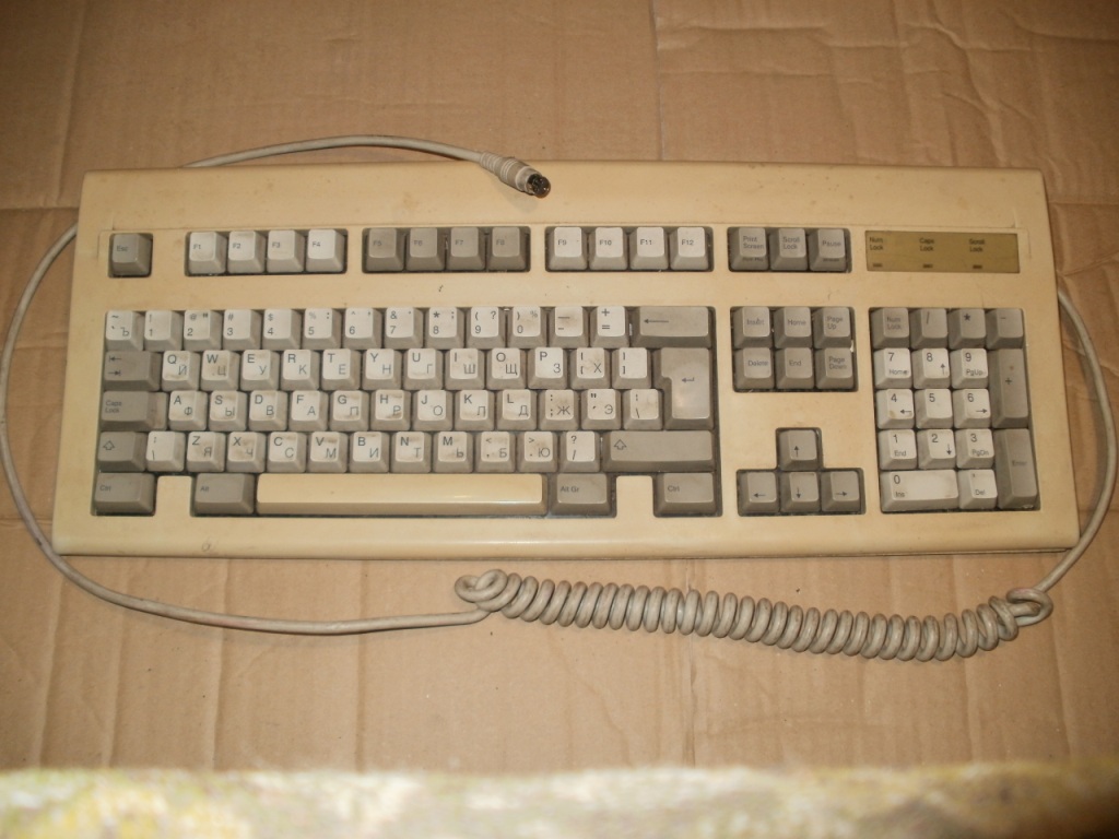

Is this what I think it is? :o Looks nice and clean!
28 Feb 2015, 02:11
WOW! I had no idea that IBM made Cyrillic Model Ms... :shock:
